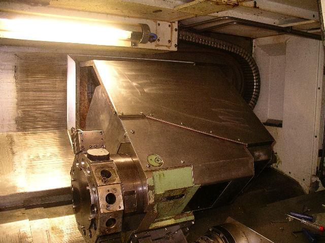

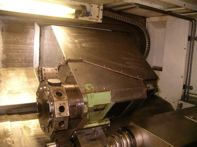

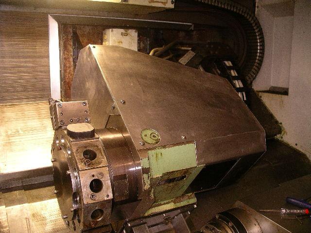

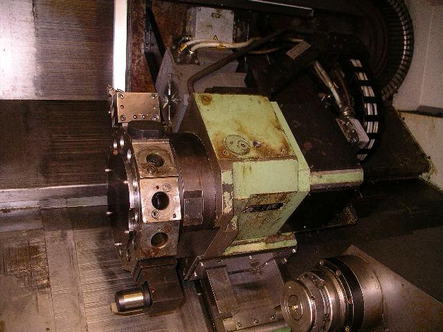

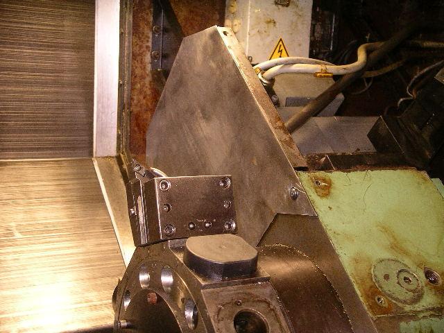

Today's Task: get the tin work back on the 'X' axis turret slide.
So this:
« Reply #302 on: July 11, 2013, 06:19:09 AM »
Needs covering up with this lot - anyone remember what goes where and in what order  :bugeye:
« Reply #303 on: July 11, 2013, 06:20:13 AM »
Trial offering up sorted out the conundrum, so we start with the left cheek piece:
« Reply #304 on: July 11, 2013, 06:21:04 AM »
Followed up by the smaller boxy shaped thingy:
« Reply #305 on: July 11, 2013, 06:21:55 AM »
Followed by the bigger boxy shaped thing:
« Reply #306 on: July 11, 2013, 06:23:00 AM »
And finally the outer left hand cheek which was the panel I had to make - will it fit ....
« Reply #307 on: July 11, 2013, 06:27:14 AM »
Yes it did - so it should !
Rightly or wrongly I decided to lather the entire inside of the metalwork with undiluted soluble cutting oil. My argument being that the bare metal had already shown signs of corrosion, the soluble cutting oil has corrosion inhibitors in, and it seems to cling to my other machines pretty well as the water evaporates. Also I didn't want to introduce other oils as the whole machine will be awash with soluble oil when widget production starts.

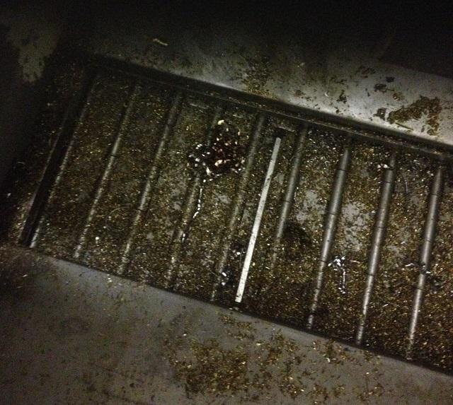

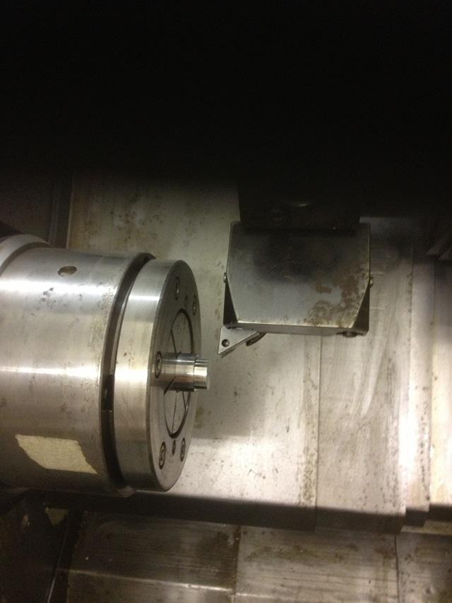

We have SWARF
  :ddb: :ddb: This may not be the most impressive demonstration in the world, but it IS the first time this lathe has produced swarf in probably over 3 years  :ddb: :ddb:
I had to cheat as the tool setting issue is currently defeating me. I wrote a diddy program to start the main spindle at 1000 rpm then used MDI to do the turning - up until now I hadn't found a way to set the spindle running other than when running a program, but I found that you can actually pop out of the program leaving the spindle running and operate the machine either under MDI or jog mode.
Anyway a highly unimpressive picture of a 1" stainless steel bar reduced to 21.14 mm and the resulting swarf:
