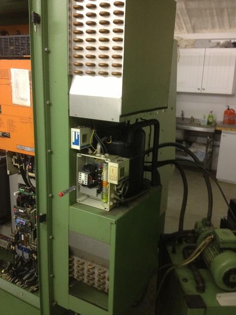

The cooling system has been a bit of an unknown - a big lump called a Schroff RHB 3000 bolted on to the end of the cabinet, taking in warm air from the top, and blowing it out cooled at the bottom of the cabinet. Certainly lots of air flow but I wasn't convinced it was actually cooling. I had thought that the whole thing was a factory sealed item, but yesterday when showing a nephew the lathe I realised that in fact it had a totally enclosing cover that could be removed. Hence creeping away this morning to investigate.

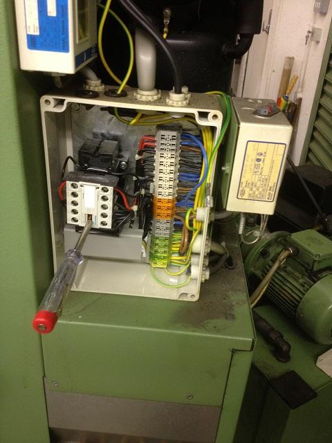

Taking the cover off let me gain access to a termination box that among other bits houses a contactor - contactor not pulled in, cooling compressor not running! Jamming contactor armature over into the 'made' state with a screwdriver the compressor starts up, and air coming in at the top at 25C is now exiting at 14C !
The problem can only be either one of the thermostats, possibly the contactor coil, or one of the various trip devices in series with the coil, but daren't start investigating now or my absence will be noticed!
This may account for the failed X&Z axis servo as it is first in line for the cool air.

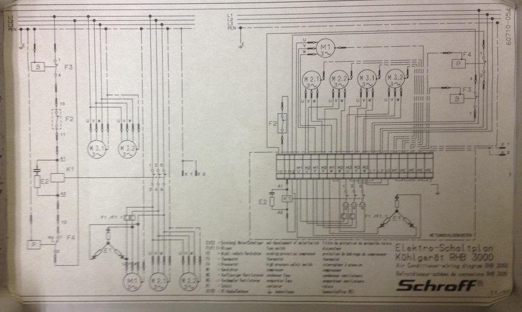

c/Circuit diagram thoughtfully provided by Schroff and glued to lid of control box!

Anyway:  :ddb:  Chiller issue now resolved   :ddb:
It was high resistance contacts on the thermostat.  A bit of contact cleaner and tweaked the trip point up and down a few times and it's back working. It has probably sat for years with open contacts awaiting that hot spell to close and start the compressor, and when it did the contacts had oxidised. Must have been quite a build up as the coil it switches is 415v, so a good wetting voltage you'd think.
Now as the cabinet doors are still off it is trying to chill the entire workshop, and drying the air, producing a stream of condensate from its run off pipe such that I've had to put a bucket under it. Long term I'll plumb it outside, and duct the hot exhaust air outside as well (perhaps with a diverter flap to inside for the winter!)
