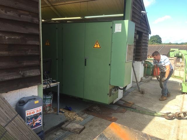

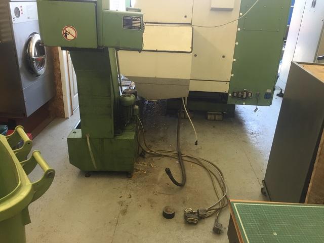

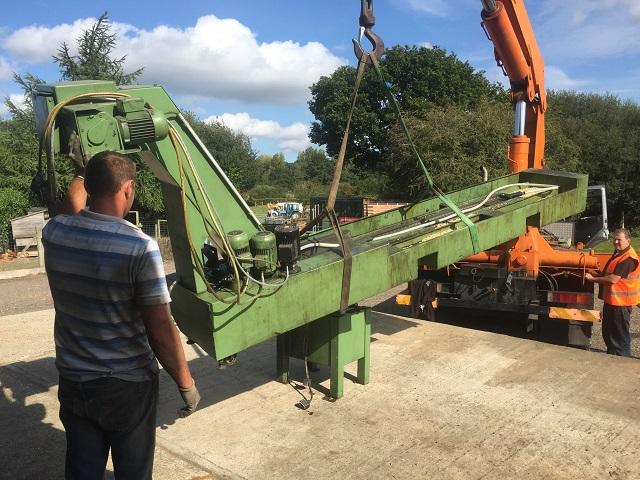

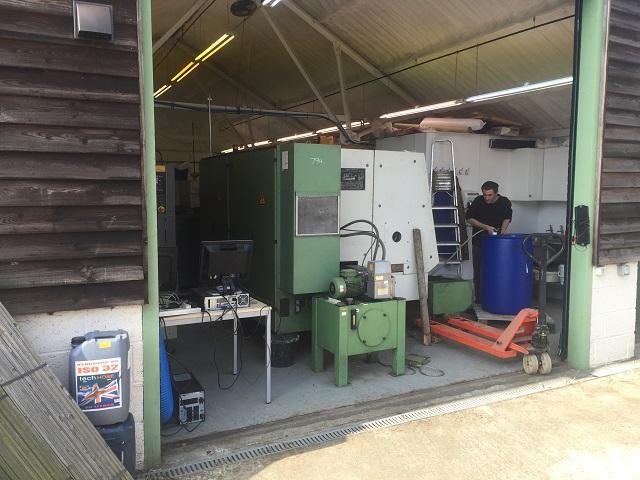

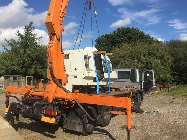

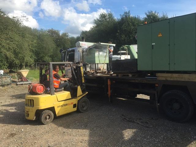

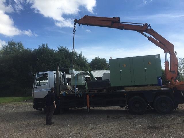

« Reply #657 on: September 22, 2016, 09:36:19 AM »

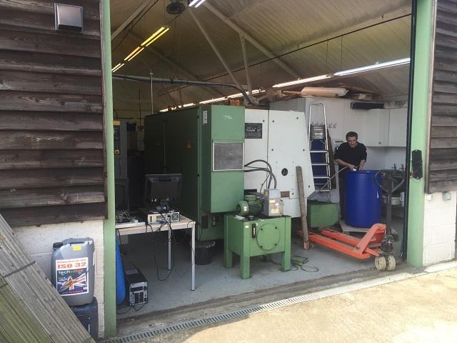

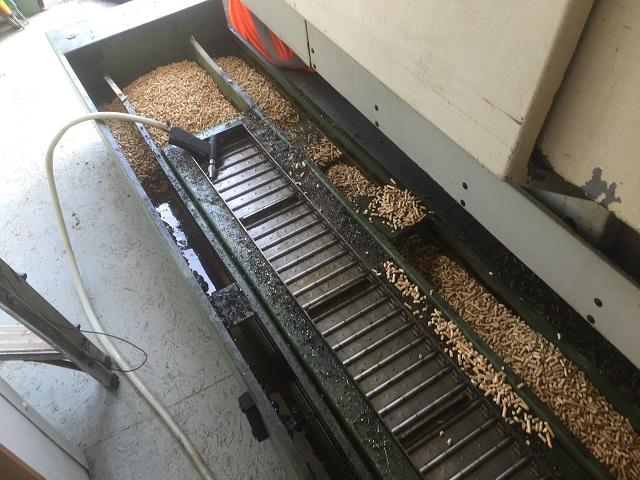

Well today was the day for the machine to go to it's new owner. Big lorry with Hi-Ab ordered for 11 am so Phil (new owner) turned up a bit earlier to start getting it prepared.
Firstly the Swarf Conveyor, which incorporates the coolant tank, needs pumping out. This holds 205 litres of soluble coolant, and the only practical way to pump it out is to use the 'wash down' pump I'd installed. Towards the end we had to tilt the tank to keep the pump submerged - got most out then dumped sawdust pellets in to soak up the rest so it doesn't swill about on the lorry.
  • Posts: 9051

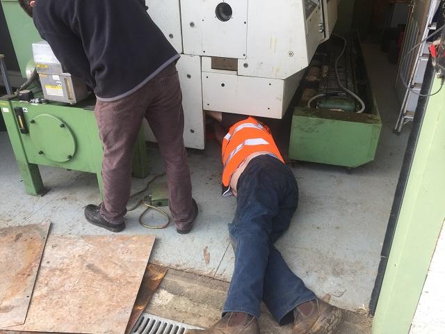

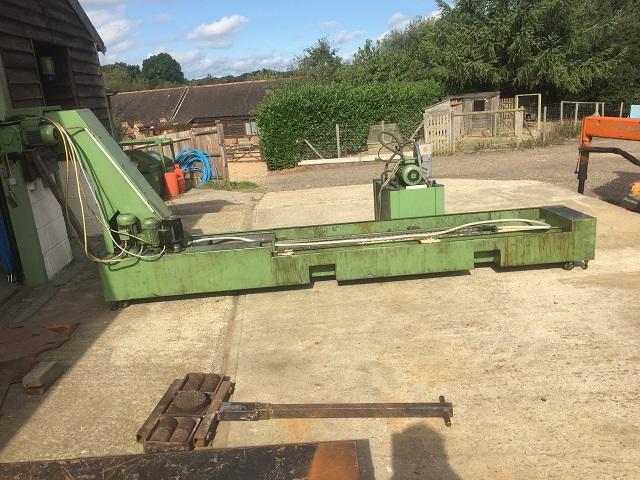

« Reply #658 on: September 22, 2016, 09:39:37 AM »

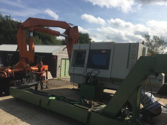

Then the Hydraulic Power Pack could be disconnected and wheeled out side leaving room to start jacking the machine onto skates an roll it out.
  • Posts: 9051
« Reply #659 on: September 22, 2016, 09:41:21 AM »
So that wasn't too bad - a few moments when I did wonder if thing could go badly wrong, when one of the professional movers had his upper torso under the machine  :bugeye:
  • Posts: 9051

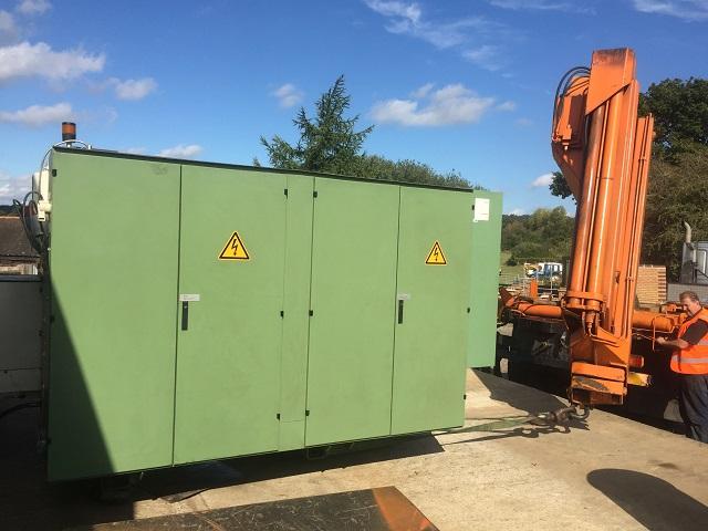

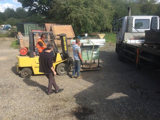

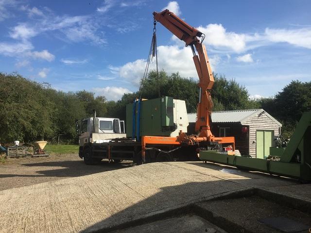

« Reply #660 on: September 22, 2016, 09:45:26 AM »

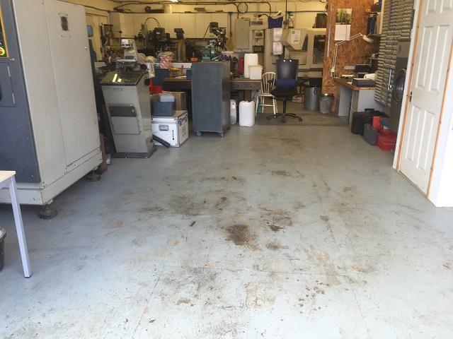

Then they had to pack it all onto the flat deck of the lorry - there was no spare space !

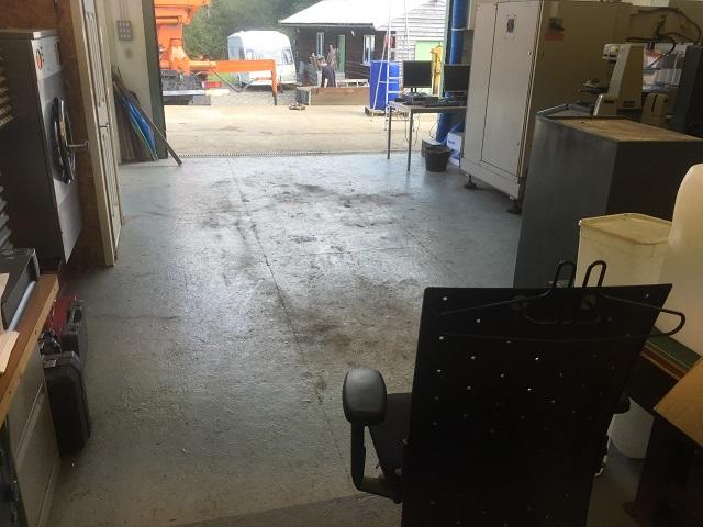

  • Posts: 9051

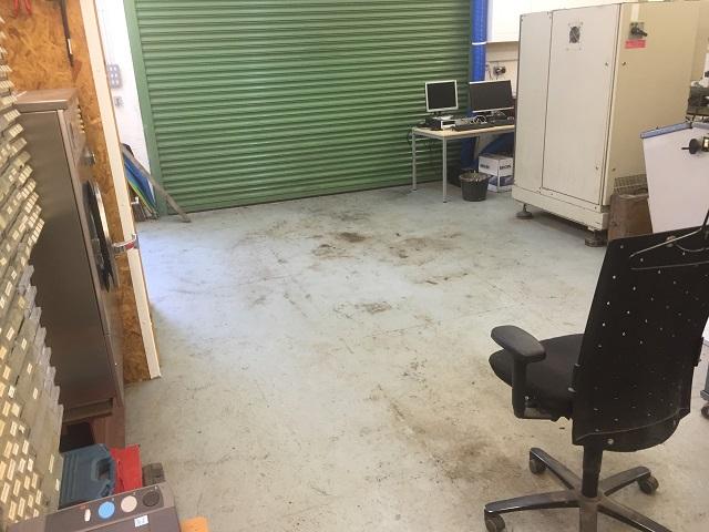

« Reply #661 on: September 22, 2016, 09:50:06 AM »
So this leaves me with a few acres of space - all ready for the next project  :lol:
In fact the next thing into the 'project space' will be that 6 foot heavy duty grass flail that needs a rebuild.
Slight misgivings parting with the Traub - but it has been an interesting thing to get my teeth into, and it's very satisfying to think it will now go on to have a further productive life, whereas it was destined for the scrap yard before it fell into my clutches.

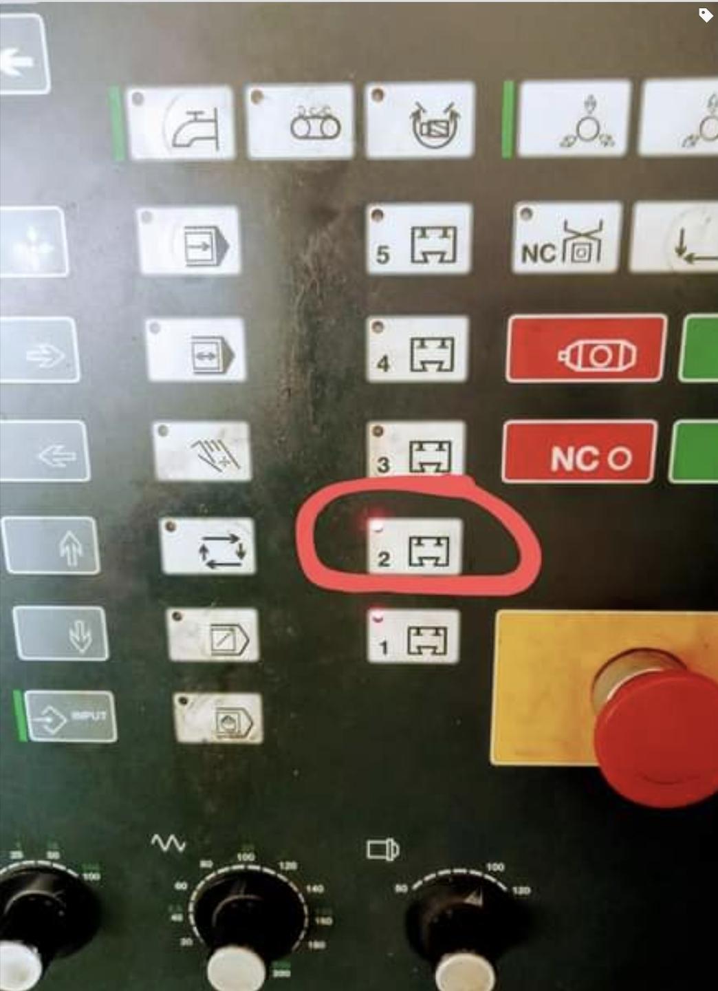

« Reply #666 on: November 22, 2021, 08:52:15 AM »
We have TRAUB TND 300 CNC lathe (2 axis) with System TX8 controller. Computer type: FCA330HLX-VThe following problem has occurred:At start-up in the morning, the Part 2 system button on the control panel illuminated. So far, No. 1 has always been lit. For some reason, we can’t get out of No. 2. The keyboard works, but Even if I press the button, it doesn't turn it off.
Can a parameter loss be the cause? How do I turn off System 2?Is there a way to fix this error?
Error code H012 - 2 Teilsysteme angewahlt
Thank you in advance for your response
  • Posts: 9051
« Reply #667 on: November 22, 2021, 09:21:49 AM »
I'm afraid that I sold my Traub several years ago and all the documentation went with it.
I always found the Traub help Desk very helpful, especially so after I sent them a bottle of Whisky following a particularly knotty problem solving session !
It's so long ago I've no longer got their contact details, but I'm sure Google will find them
