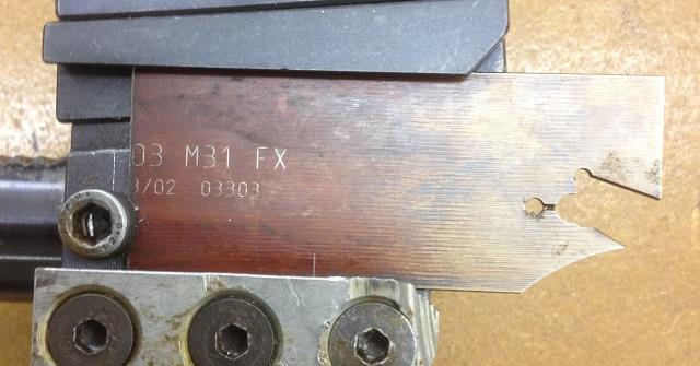

Talking of tools, does anyone recognize the letters and numbers on this parting tool holder - I want to identify which tips it takes. It's obviously a cut down 'double ended' self retaining type and is 31mm high and 2.5mm thick the insert 'gap' is about 7mm tall:

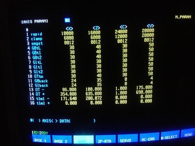

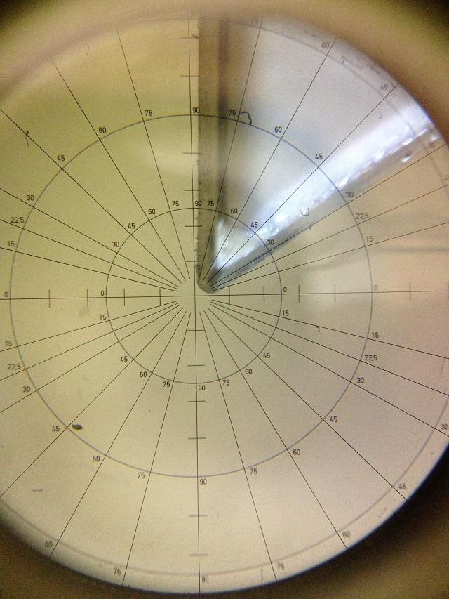

Just some photos I've sent to Traub to hopefully prompt a response to the tool setting issue:
#425 - The parameter page that gives the co-ordinates of the setting 'scope (#15 tlml-)
#426 - View through the 'scope on tool #10

Thanks John. Those photos sent to Traub did prod them into action and I got a response but they are stumped as to the cause. They got me to re-format the memory which made not a jot of a difference. No big issue - I can live with moving a decimal point three places left !
« Reply #348 on: July 18, 2013, 08:33:47 AM »
Is it a firmware vs software version problem? Or a peripheral version recognition problem?
« Reply #349 on: July 18, 2013, 11:40:00 AM »
Well Traub have no idea about the x1000 issue!
