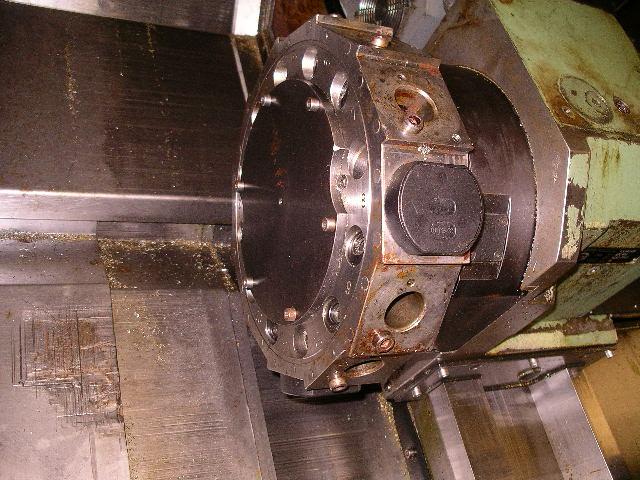

A bit of web browsing leads me to suspect that the Sauter design works by indexing round to the 'hole'  for the solenoid locking pin, before a tool position, firing the pin into the hole, then reversing the drive motor which allows two plates with wavy surfaces and a set of rollers between them to force the Wirth Coupling together by cam action. Release is by popping the pin in, and driving the motor. This is conjecture based on a problem someone had on the Practical Machinist site:
http://www.practicalmachinist.com/vb/cnc-machining/sauter-turret-fagor-8055-dont-seem-like-each-other-266023/
« Reply #251 on: July 02, 2013, 04:48:35 PM »
I've not doubt that you'd carry a spare John, if you could find it in your den of iniquity  :lol:
After recently selling or scrapping 7 machines I have a semblance of clean floor, mind you the fact that I have rushed out after suffering from clean floor syndrome and bought three new machines has helped slightly.
I do have to be careful and keep in close contact with Tim Leech over disposals and acquisitions or the east / west fulcrum of the UK is going to suffer.
As it is all aircraft flying into East Midlands have been advised to re-calibrate their compass's
« Reply #252 on: July 03, 2013, 05:22:42 AM »
Overnight, the nice man from Sauter has emailed me the complete 24 page manual for the Tool Turret disclosing all it's little locking secrets.
This has revealed a screw that you can remove to let a hex key be inserted into the motor shaft, to allow manual locking - basically you turn until the locking pin drops in, then holding the pin in, reverse direction until the cam rollers lock the Wirth Coupling, then the pin can be released. This explains why in the locked mode the locking pin isn't in the lock hole! In fact they call in a pre- indexing pin so all is forgiven.

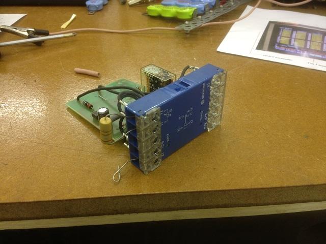

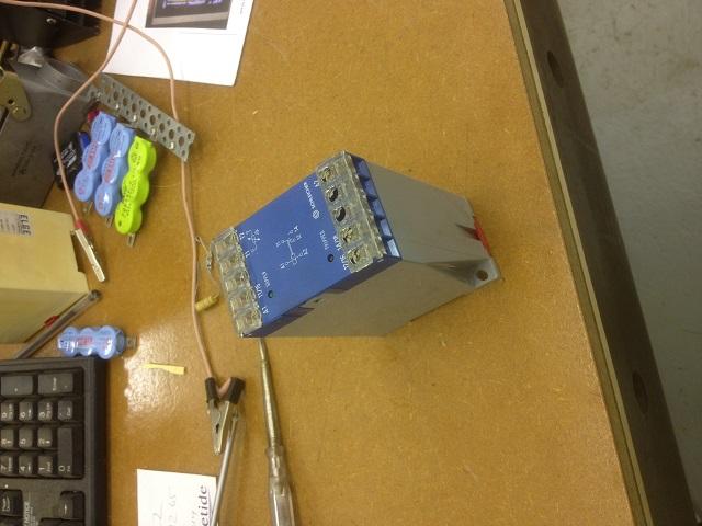

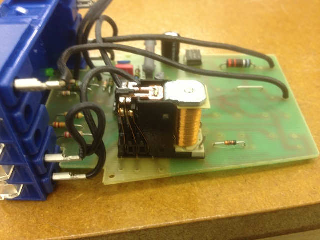

Now the Tool Turret rotates to the selected tool on command from the Operators Panel. The rotation from station to station is by an in built three phase motor, with the usual arrangement of two contactors, one for forwards and one for reverse. However this system has a third contactor feeding the first two, and should be pulled in by the logic line 'motors on' However this is routed through a Platinum Resistance Temperature sensing relay box, with its Pt sensor embedded in the tool post somewhere. Lights on the front of the box claimed all was well  - but it lied! The supposedly closed contact was open, hence no power to the tool turret.
This is the box of tricks:
« Reply #254 on: July 03, 2013, 09:44:03 AM »

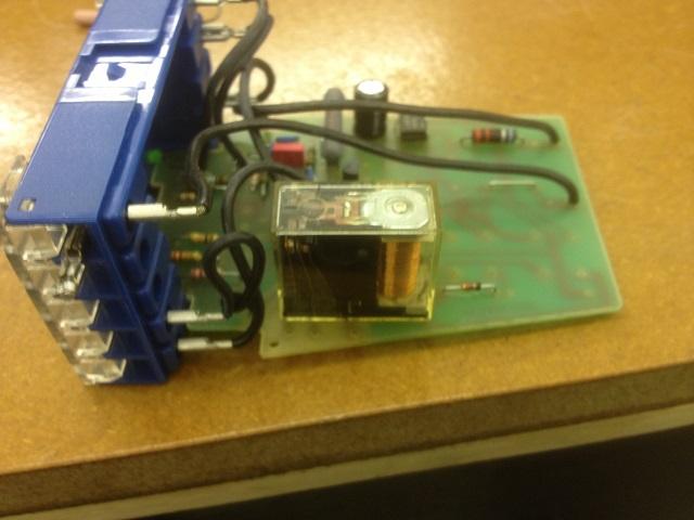

Fortunately an openable unit susceptible to tinkering! Here I've substituted an 180 ohm resistor for the pt element and opened it for testing
« Reply #255 on: July 03, 2013, 09:46:38 AM »
The offending part is a pcb mounted relay - yet more bad contacts - I've had a few  :bugeye:
This one was easy to fix - with gentle persuasion the plastic cover pops off, and I could scrape the contacts and spray them with contact cleaner:
« Reply #256 on: July 03, 2013, 09:57:22 AM »

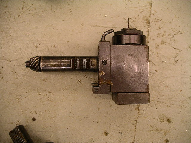

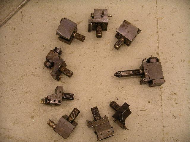

Today my task was to remove all the VDI tooling from the tool turret to ensure that none of the driven tools were seized before I spun up the tool power motor.
VDI tools are retained by a stout pin sticking into a socket on the turret, with a rack shape cut into the pin. A similarly racked wedge piece pulls them onto a mounting face and is secured by an allen headed bolt. To remove them the bolt is loosened, and the top of its head bears on a washer that in turn bears in a circlip acting as a shoulder. This pulls the racked wedge out releasing the tool.
Several of the circlips had been lost. It turns out that the tooling was so firmly in, and the wedge so tight, that it wasn't coming out without a few stout raps from a copper mallet on the tool block. Eventually they all came out:
« Last Edit: July 04, 2013, 02:07:48 PM by awemawson »
« Reply #266 on: July 04, 2013, 12:52:56 PM »
It turns out that there was only one powered tool installed:
« Reply #267 on: July 04, 2013, 01:00:41 PM »

Firstly that temperature relay failed again for no good reason - I temporarily linked it out of circuit and got on with it, but I've just again dismantled it, cleaned the relay contacts, re-soldered the pcb joints and put it back with no definite fault found apart from it can only be the relay contacts or wires going to them, as the relay was energised when the fault was present.
Secondly the monitor screen went blank, then came back - loose mains connection found in its sealed box (only 14 screws and a gasket :) )

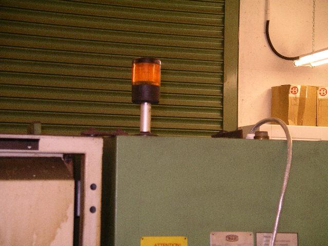

As I was testing the drive, I also played in MDI mode starting and stopping the main spindle - hey what's that odd clicking noise :( It turns out that while a program is running the amber beacon that I repaired yonks ago lights up, and when it ends it flashes - the clicking was its relay  :clap:
Have an amber beacon:
« Reply #268 on: July 06, 2013, 06:54:38 AM »
I eventually got to the bottom of the Temperature Relay issue - in fact the relay contact wasn't being pushed firmly enough against its partner. Although I've given it a tweak and it now works fine, I've ordered a replacement relay for better reliability - only £2 off ebay !

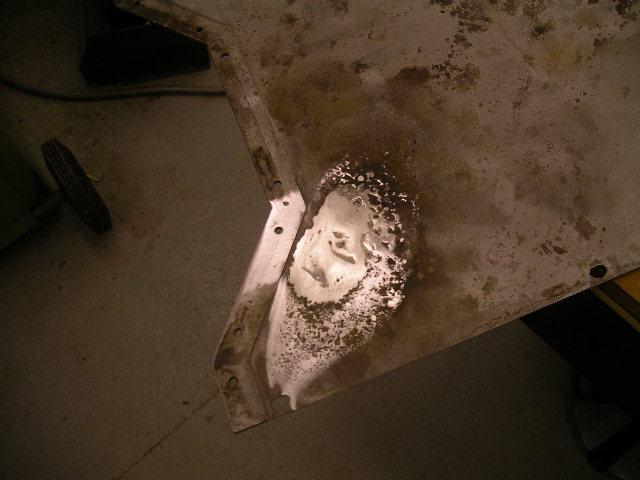

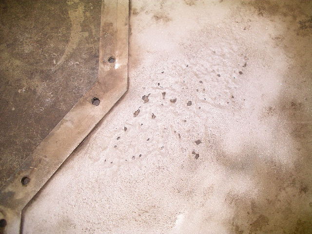

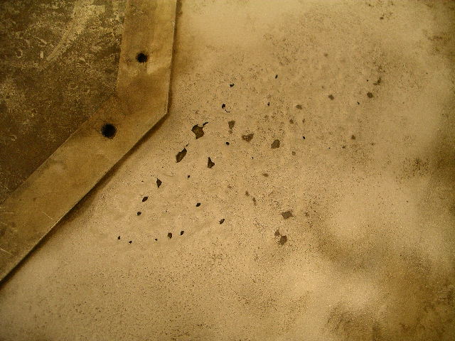

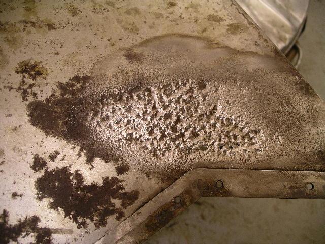

So time to start putting the tin work back round the X axis and Tool Turret. It needs a clean up before fitting, and close examination shows one part has some horrid corrosion - Very odd as it is limited to one small location, some swarf must have got trapped there that they had been machining that set up an electrolytic reaction with the steel:

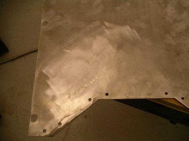

« Reply #269 on: July 06, 2013, 06:59:52 AM »

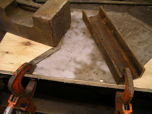

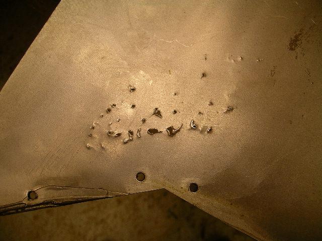

Options -  Cut out the offending bit and mig in a replacement, or re-make it
I decided to re-make this part - but when I checked my stock I had no 1.5mm sheet, only 1.0 & 1.2 - as this mounts wipers to keep the coolant out I don't want to go any thinner.
I thought I'd had a go at 'lead loading' - the old fashioned bodywork repair method - not done it since the mid 1970's when I did the doors of my late brothers MG TC !
So - sandblast clean:
« Last Edit: July 06, 2013, 09:04:13 AM by awemawson »

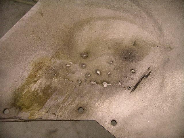

« Reply #270 on: July 06, 2013, 07:00:53 AM »
Clamp it down against a wooden backing sheet:
« Reply #271 on: July 06, 2013, 07:02:07 AM »
And solder it. I used a blow torch and 'leadfree solder'
« Reply #272 on: July 06, 2013, 07:03:04 AM »
Then clean it up a bit:
« Reply #273 on: July 06, 2013, 07:03:51 AM »
I decided that the result was less than brilliant, and I've ordered some 1.5mm sheet  :bang:
