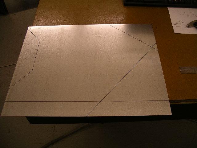

« Reply #286 on: July 10, 2013, 06:39:43 AM »

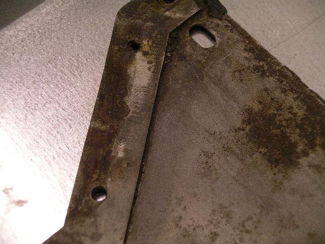

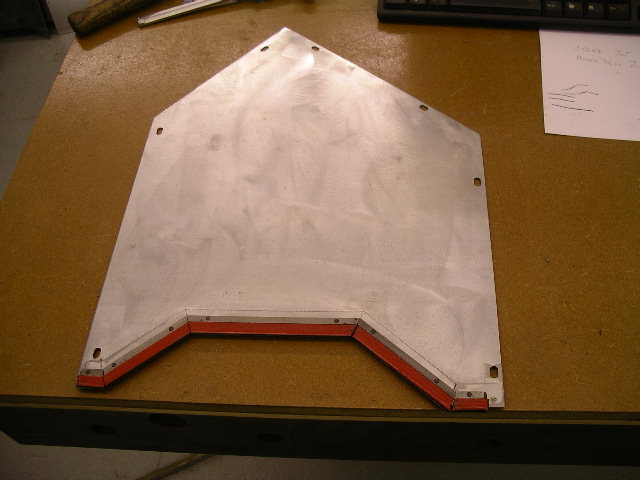

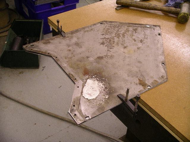

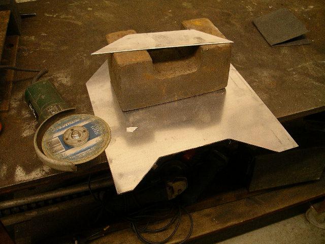

Today's task: Make a replacement for the corroded side cover for the X axis and turret slide
Make one of these:
« Reply #287 on: July 10, 2013, 06:40:31 AM »

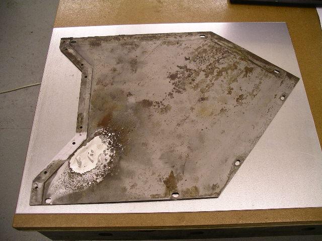

Into one of these:
« Reply #288 on: July 10, 2013, 06:41:49 AM »
Fairly easy, except that there is a thickened mounting for the 'way wipes' for the other half of the cover@
« Reply #289 on: July 10, 2013, 06:43:10 AM »

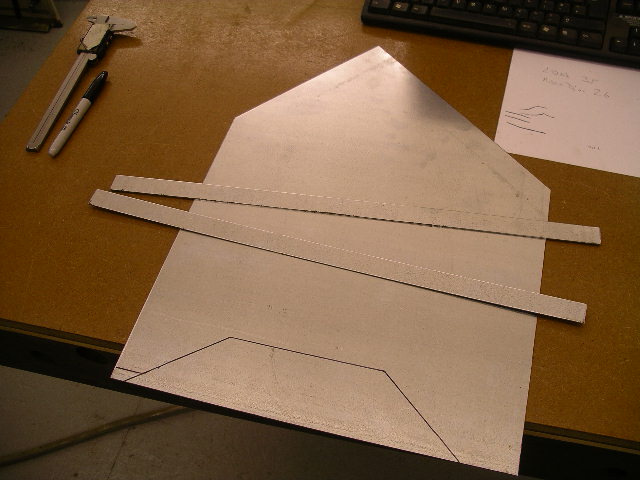

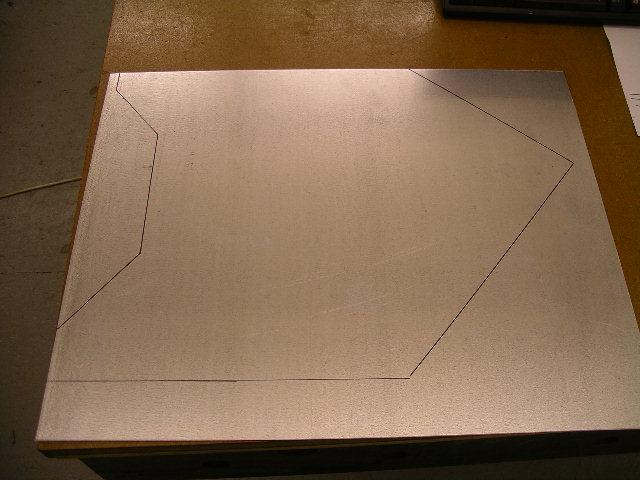

So first I traced it, then extended the lines to the edge to ease cutting
« Reply #290 on: July 10, 2013, 06:45:43 AM »
Then guillotined the easy bits, remembering to cut strips from the waste for the thickening at edge while it's still big enough to hold. The other cuts had to be with a thin angle grinder disk

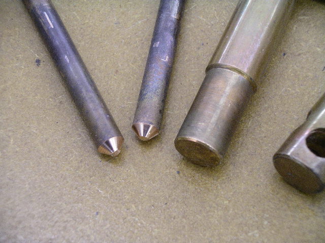

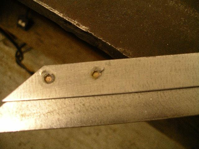

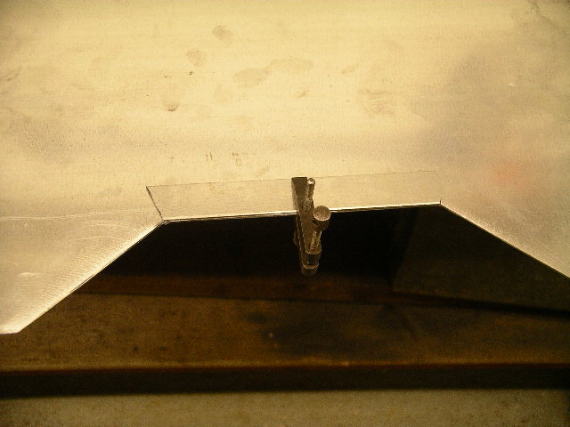

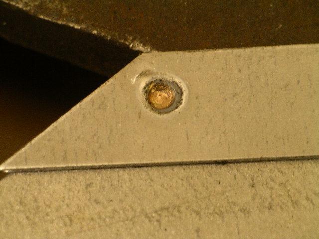

« Reply #291 on: July 10, 2013, 06:46:39 AM »

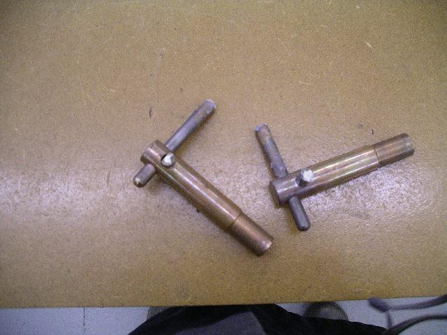

I decided to spot weld the strips to the edge but these tips need a clean up:
« Reply #292 on: July 10, 2013, 06:47:29 AM »
A quick trip to the lathe did the job:

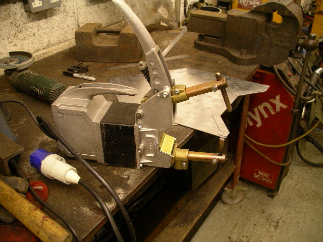

« Reply #293 on: July 10, 2013, 06:49:26 AM »

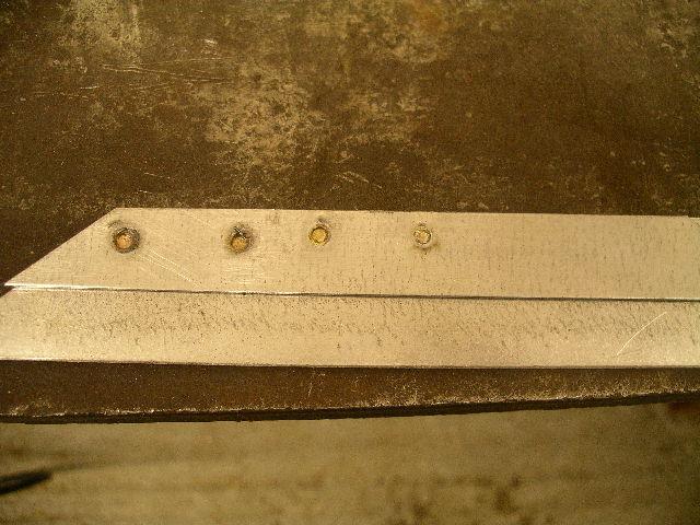

I made a few test welds with some scrap of the same thickness to make sure the spot was properly welded but not too unsightly adjusting the welding time between welds:

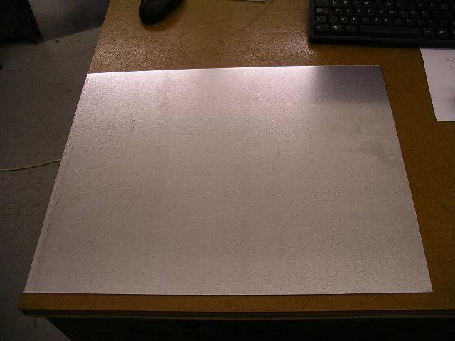

« Reply #294 on: July 10, 2013, 06:50:56 AM »
Then clamp it up and weld it:

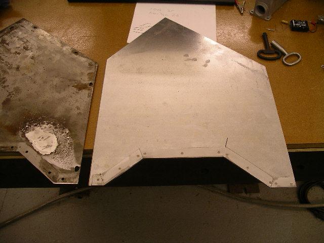

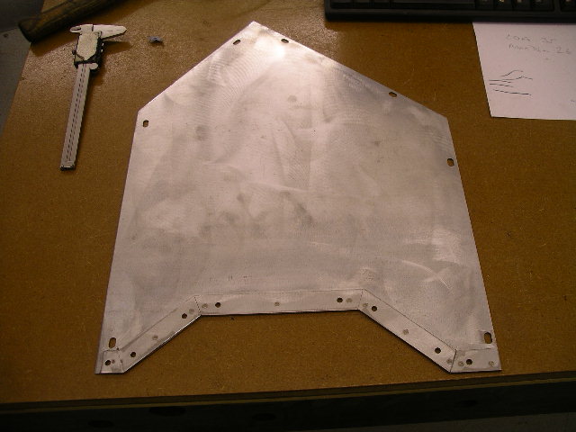

« Reply #295 on: July 10, 2013, 06:52:13 AM »
Then use the old one as a drilling and filing jig to get the holes in the right places:
« Reply #296 on: July 10, 2013, 06:53:13 AM »
Then re-assemble with the way wipers ready to fit back on the machine:
« Reply #297 on: July 10, 2013, 07:03:49 AM »
All went quite well really - another example of tools that don't get used for weeks on end being indispensable for some jobs. The spot welder is rarely used but does make things so easy when the need arises. Similarly the guillotine, although used a bit more, usually just gathers dust.

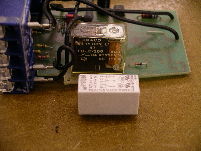

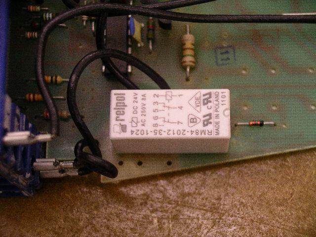

Spare relay arrived today for the Platinum Resistance Thermometer Relay box that had kept failing. It's been ok since I bent it's contacts but I've changed it anyway. £6.40 for 5 of them brand new off ebay and they're not made in China ! How do they do that?
