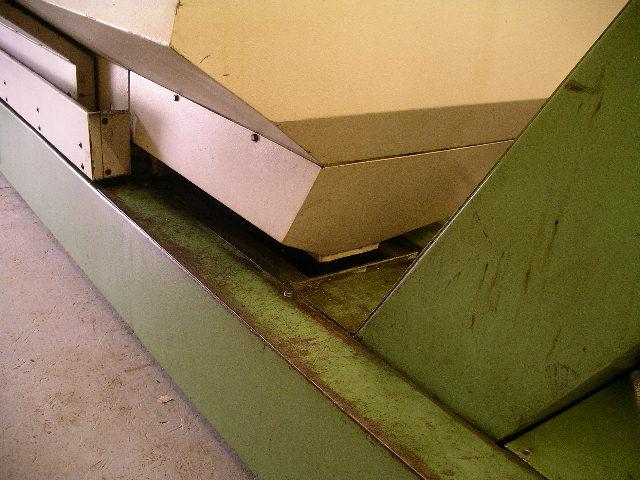

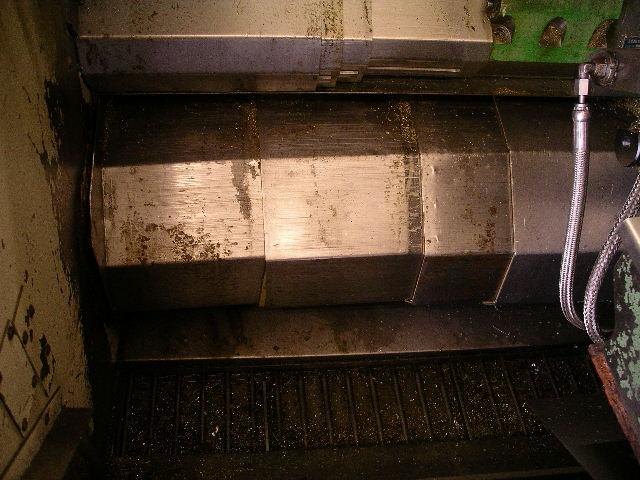

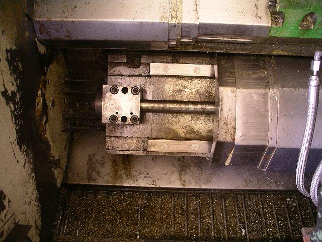

So today's task: Reset that V axis overload clutch.
Obvious thing to do is expose the drive to the ball screw, and hand rotate it in the opposite direction until the overload clutch clicks back into place. Only one problem, the drive servo motor is low slung at what would be the tailstock end of a conventional lathe sitting just above the huge swarf conveyor. There does seem to be an access cover however this involves moving the swarf conveyor to get it off. As this took four of us a couple of hours to maneuver into position when I got the machine, I'm loath to do that.
« Last Edit: June 28, 2013, 03:19:34 PM by awemawson »

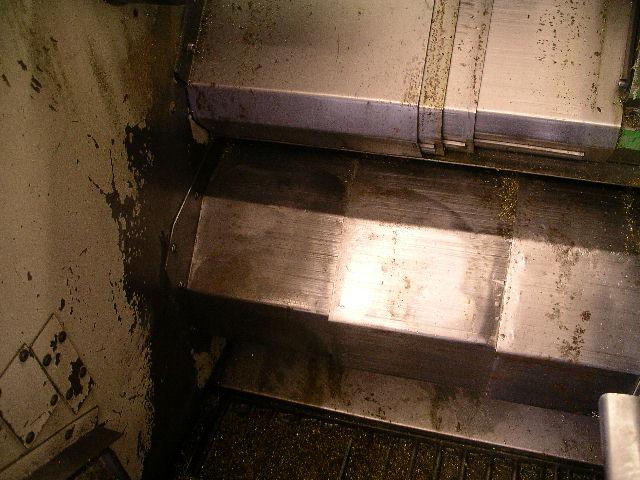

« Reply #230 on: June 28, 2013, 05:07:13 AM »

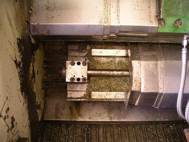

So maybe I can get at the ball screw from the other end? It's under this way cover:
« Reply #231 on: June 28, 2013, 05:08:28 AM »
Yes sure enough, removing the suspiciously loose screws that retain it reveals the ball screw and LOADS of brass swarf.
« Reply #232 on: June 28, 2013, 05:10:37 AM »
Cleaned it all up a bit, and grasping the ball screw easily managed to bring the V axis assembly back towards the headstock end. After a turn or two there was a satisfying 'clunk' as the overload clutch dropped back into position.
« Reply #233 on: June 28, 2013, 05:15:09 AM »
So put it all back together, cleaned up the way cover a bit and tried starting up.
Sure enough V axis overload error is now cleared and I can bring the beast to a 'ready' state, get the hydraulics running and jog X & Z. Jogging V it won't go towards the headstock, and when trying to jog towards the tailstock it carries on going after I take my finger off the button. Emergency Stop button prevented another V axis overload error.
So my next task is to fault find the V axis - it could simply be a sticking 'go right' button, but I don't think so as same button is used for the Z axis jogging.
As those retaining screws were only finger tight I suspect someone has been in here fault finding just prior to me getting the lathe.

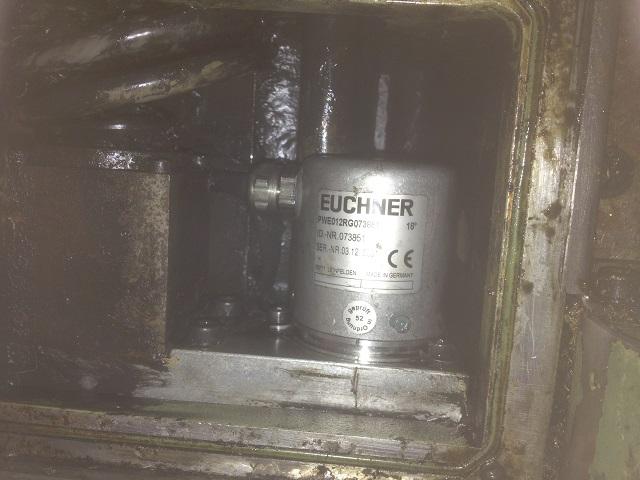

« Reply #241 on: June 30, 2013, 05:30:39 AM »
Yes it was a referencing issue preventing the V axis moving towards the headstock end. Had a good look with a torch to find the proximity sensor and it's associated lump that it detects - can just see it looking down an access panel at the tailstock end. This showed it was set to reference at the extreme rightwards travel, and I was thus given the confidence to fast (not very!) travel it to close in jog mode then do a final approach in reference mode. Lo and behold the V axis value was then set to a sensible figure (it had been at something like -24000 mm) and I could then move the axis in jog mode in both directions.
All axis reference points are the same mechanically - a three terminal magnetic proximity sensor on a bracket looking for a simple cylindrical collar that is fixed with a set screw on a shaft parallel to the axis motion. Seems crude, but I suppose that the sensors are very repeatable.
I think that there is still a 'funny' to solve on the axis servo drivers - the absolute axis position is supposed to be retained on power off, and on two axis it is being lost despite the battery measuring ok, and also having been changed anyway. Not the end of the world if I cannot solve it - just means I'd have to re-reference after a power down.
Next thing to investigate is the tool turret - see if I can get a bit of time later today.

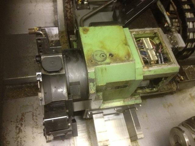

So on to the the Tool Turret. It is saying 'Turret is not locked' at the moment. This is the tool turret:
lordedmond
« Reply #244 on: July 02, 2013, 11:46:51 AM »
well done it will not be long now , it does look as if the major hurdles are behind you now
Stuart
« Reply #245 on: July 02, 2013, 11:50:57 AM »
Apart from the obvious mechanical assembly that holds a twelve station tool carousel, buried in the works there are all sorts of goodies. There is a solenoid for locking, a feedback sensor to say 'locked', an encoder to say where the turret is rotationally, a motor to turn the turret either clockwise or anti-clockwise to select which tool to use, a motor to drive the 'driven tooling' (end mills, drills etc) and finally a valve to control the through tool coolant. Pulling off the two cover plates doesn't give very good access One reveals the wiring connections and the other the solenoid and encoder.
« Reply #246 on: July 02, 2013, 11:57:56 AM »

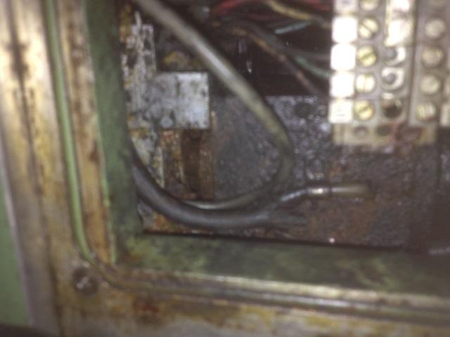

The reported 'not locked' status is entirely correct - I can turn the carousel by hand. Oddly to my mind the locking solenoid seems to be biased to the 'unlocked' state, and powered to 'lock' this doesn't seem right to me. It all looks rather rusty and grotty, but the solenoid moves freely enough and if I push it into the 'locked' position, the digital input for the feedback sensor changes state. Also if I rotate the turret by hand, the encoder bits count up in binary correctly.
I now need to devise a way of powering the solenoid remotely so I can see what is happening. It's the old case of 'the actions round the front, and I need to be round the back'  :bang:
Have a picture of a rusty solenoid:
