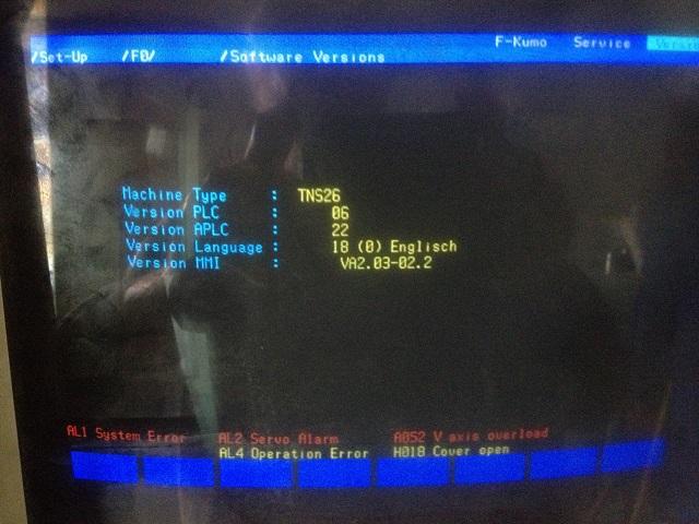

Then there has been a bit of a break through on the controller front. Readers may remember that I could not get the original '6 slot' controller to work. I was getting 'bus errors' reported when the 'user plc' was run. The machine obviously needs the correct software to run correctly - this comprises an eprom set on the main processor card, an eprom set on the 'Mem A0 & MemA1' cards that hold the system PLC program, and an eprom set on the 'MC481' 'User PLC Cartridge'. I had been advised that I needed V18 of this later unit - this is the label on it:
« Reply #201 on: June 04, 2013, 02:26:01 PM »
I wrongly assumed that the V 018 was version 18 oh no that's V 22  :bang: :bang:
With the correct user plc cartridge now when I try the 6 slot controller I no longer get the 'bus error' which I assume was the program addressing non-existant memory.
Whilst all this was going on, my mole on the Traub help desk decided to go on a fortnights holiday so it is only today that I can confirm various points. I suspect that one of the axis servo amplifiers is faulty but haven't had the time to get my teeth into it. Now the software issues are hopefully behind me it may just be a parameter issue.
The system reports it's firmware state when eventually you find how (!) and the first picture is how it was, and the second how it now is

Good work! Particularly with all the other concerns. Gratifying screen!  :thumbup:  :clap:

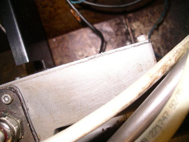

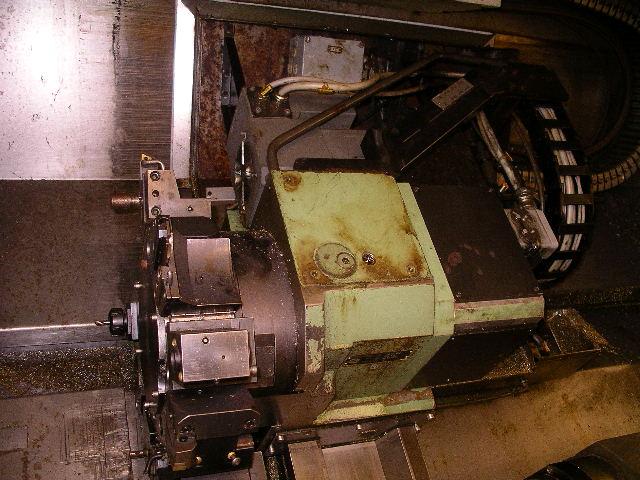

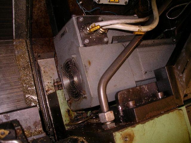

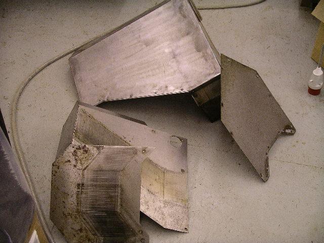

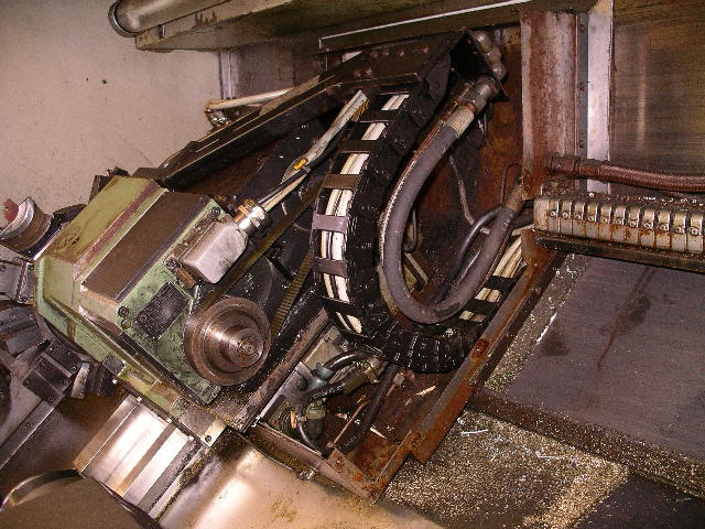

 I decided that one issue I ought to be able to fix relatively easily was the 'X Axis Overload Trip' error. I had already proved that the proximity sensor for this was indeed giving an output, so the error report was genuine, and if I fiddled the output electrically the report was cancelled. So the task was to expose the sensor and see if either the sensor was faulty or the overload clutch had tripped. Easy to say, but the X axis assembly is a huge enclosed lump that holds not only the servo motor for the X axis drive, but also the rotation drive for the tool turret, and also the motor that powers the active tooling in the turret. All this is enclosed in tin work to keep coolant and swarf at bay, and is swathed in screws (why use so many different head styles  :( Three hex socket sizes,  slotted screws and bolt heads!)
Eventually got the covers off:
« Last Edit: June 23, 2013, 03:11:04 PM by awemawson »
« Reply #208 on: June 23, 2013, 01:36:03 PM »
To expose the innards:
« Reply #209 on: June 23, 2013, 01:41:04 PM »
Can you see the sensor?
No - nor could I !!!!!
I could feel it, I could see it and the overload clutch using a mirror, but only by climbing inside the lathe and standing on the swarf conveyor.
Clutch had not tripped, but sensor was loose in its clamp, had rattled too close to the bit of the clutch it had to monitor and hence had given the error. Quick tweak with an allen key and error now cleared - only took two days of odd hours to get at it  :med:
Still it's IS progress :)
« Reply #210 on: June 23, 2013, 03:17:37 PM »
The inductive proximity sensor shows up in picture 1448 in case you haven't spotted it. (Camera being held over the back of the assembly)

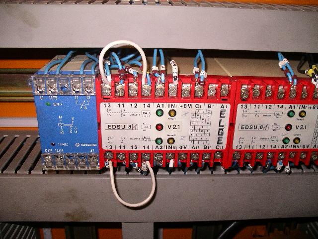

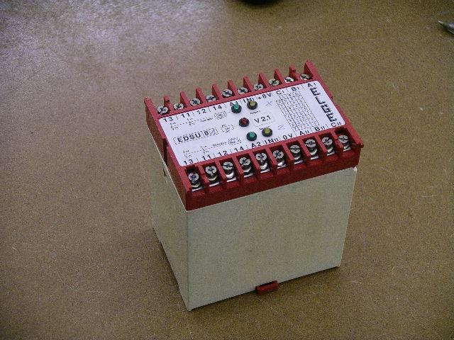

Well in fairness I never expected it to be an easy fix. The previous owner had sporadically tried over a period of more than a year. He did involve the makers who diagnosed some of the problems with the controller, but he couldn't afford their quoted estimate of about £7K for parts to fix the controller. Unfortunately I think I'm now finding not only the original problems, but those introduced by the several people who have gone this way before me. However I'm pretty sure now that the hardware of the controller is ok - I'm down to the options & parameters that tell it what to do, and it's various peripheral bits and bobs like servo amps, sensors, etc. However I WILL GET THERE (someday!)
There are two dual 'zero speed relays' that monitor the various axis servo motors and form part of the safety chain preventing the cabinet door being opened when they were turning. I know one at least is faulty, and currently I have linked  all four sections out in the relay logic so I can continue fault finding. They are rather obscure however eBay in the US has produced one for me which arrived today. I suspect they are fixable, and now I have a spare I'll venture inside a faulty one and see if they respond to diagnosis.
This is what they look like:
« Last Edit: June 24, 2013, 05:06:52 PM by awemawson »
« Reply #215 on: June 27, 2013, 07:29:37 AM »

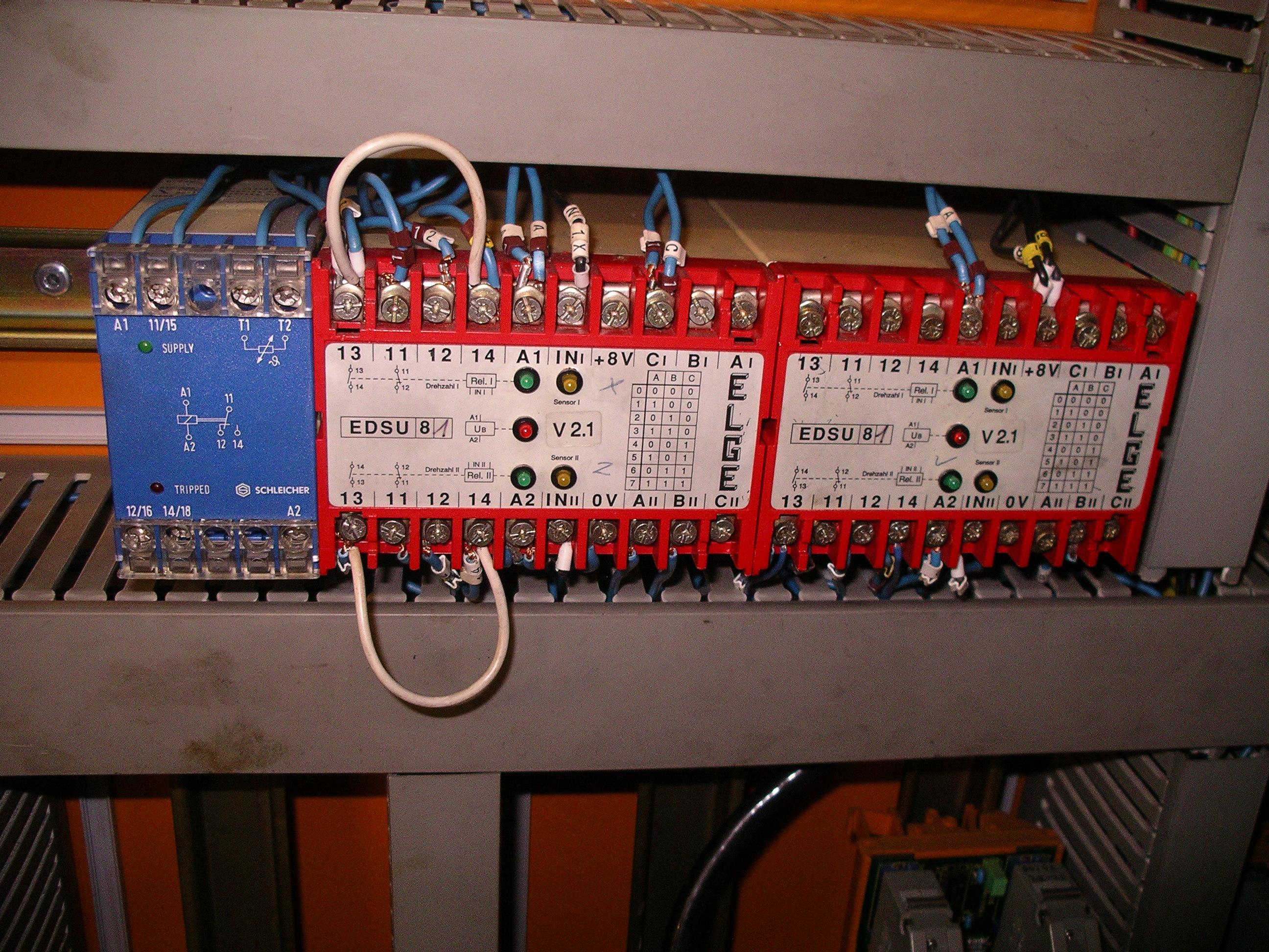

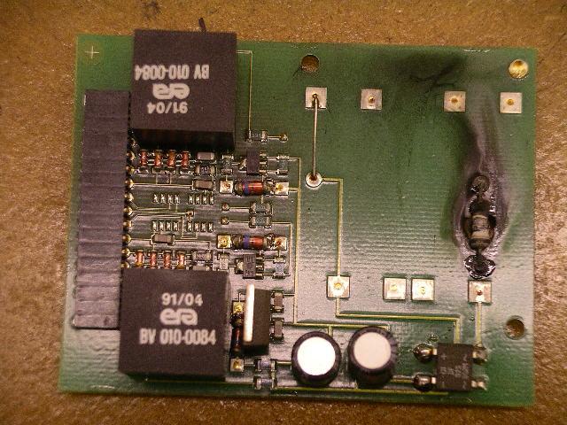

Managed to get time this morning to fit the spare "Zero Speed Relay" and as far as I can tell with the machine static, it seems to do what it is supposed to.

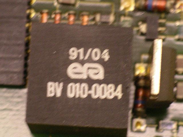

Having removed the faulty one this has allowed me to open it up and investigate - this is how it is constructed:

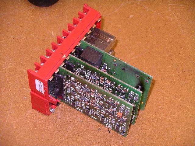

« Reply #216 on: June 27, 2013, 07:30:28 AM »
The cards unplug :
« Reply #217 on: June 27, 2013, 07:31:26 AM »
And seem to comprise two identical detector cards:
« Reply #218 on: June 27, 2013, 07:32:18 AM »
And what I assume is a Power Supply card:
« Reply #219 on: June 27, 2013, 07:33:42 AM »

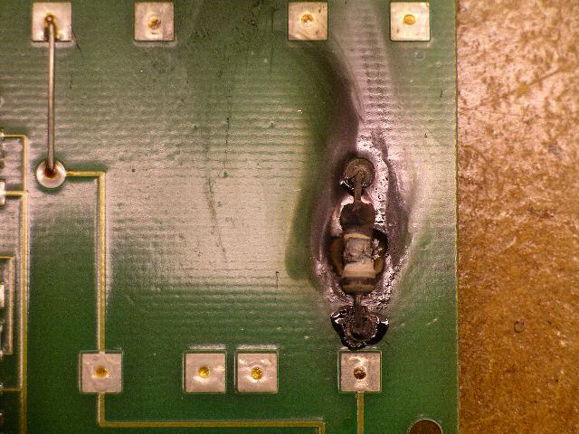

This is pretty certainly the fault as there is what I assume was once a resistor looking rather sorry for itself:
« Reply #220 on: June 27, 2013, 07:38:00 AM »
The unit runs off 24v DC but the sensors, which are two terminal inductive ones, are biased by an 8v internally generated supply that currently is giving 24v !
I think it must be a chopper / switched mode type but as yet I've not done anything other than a visual inspection. There is a pair of mystery components that will probably end up being transformers, but that's just a guess at the moment - my googling on the numbers hasn't given me any pointers:

The two 'Zero Speed' relays form two chains of contacts in the safety interlock circuit. A 'normally open' chain, and a 'normally closed' chain. The previous owner had wired out one half of the faulty relay. When I installed the replacement, I decided to strip out the wiring for both contact chains, and re-wire them. I did this mainly as the wiring was a bit tatty and several wires were not numbered and identified - it was easier to start again and do it properly. Turns out the previous chap mixed up two contacts.
Having finished the re-wire I powered up  and started the controller, and thought - hang on that start up sequence sounds unfamiliar. Different relays clicking etc, then all the servo and axis drives came up with an unfamiliar code on their displays. I went round the front to the operators panel, and what do you know - the system had gone READY  !
I went quite wobbly at the knees - I now desperately need to work out a safe sequence to start things up without causing loads of damage from my ignorance. It is complaining now of low hydraulic pressure - hardly surprising as the hydraulic pump isn't running. I know that the pump works as I've previously manually operated its relay to check its direction of rotation, but there must be some sequence to get the controller to start it.
