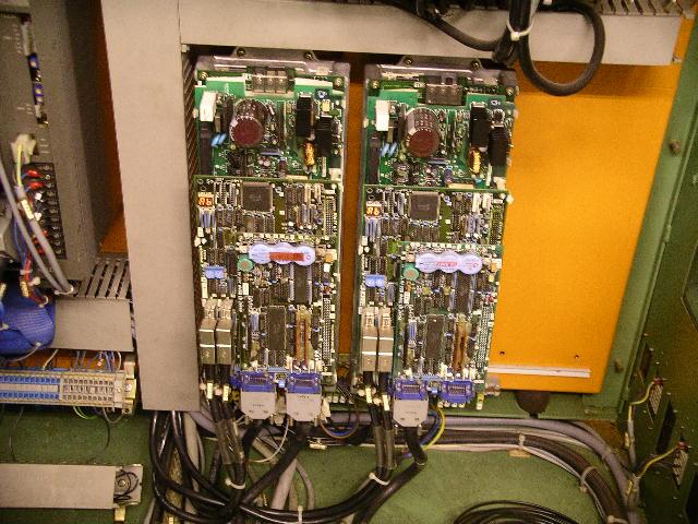

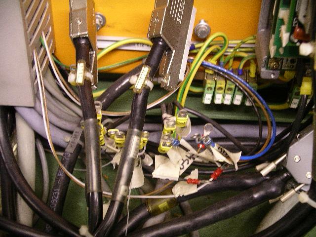

Now where do all these wires go ? :Doh: :Doh:
« Reply #151 on: May 04, 2013, 06:12:29 AM »
We're ok - all back in and wired up next to it's twin, and making sense in it's conversations with the TX-8F controller
 :clap: :clap: :clap: :clap: :clap: :clap: :clap: :clap: :clap: :clap: :clap: :clap: :clap: :clap: :clap: :clap: :clap: :clap: :clap:
Now perhaps I can get back to sorting out that relay logic problem :scratch:
Pictures:
A/ In and still "A6" before the controller speaks to it
B/ Controller wakes it up

« Reply #152 on: May 04, 2013, 07:02:47 AM »
that is good news Andrew  at least they are talking to each other ( in the same language I hope )  :)
can you not link out all the safety switches and relay in one go to prove the logic is ok then the sort out the rats nest  :zap:

« Reply #153 on: May 04, 2013, 07:40:51 AM »
Thanks Stuart.
I've linked out the spindle 'zero speed' interlinks, but this door system is cunning  :borg: The controller needs to see the sequence of 'Door Closed' then 'Door Open' Then 'Door Closed' it then shoots in a locking bolt and needs to see feedback that the bolt is locked. Then it needs to see 'Estop removed', then 'Drive Power On' before it will go 'Ready'. Anyone would think they were trying to design an interlock system that couldn't be easily defeated  :lol:

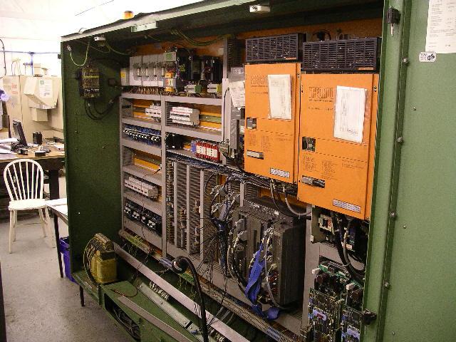

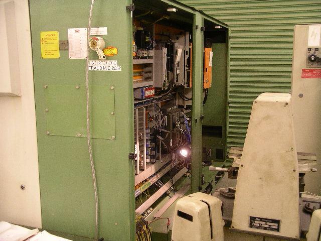

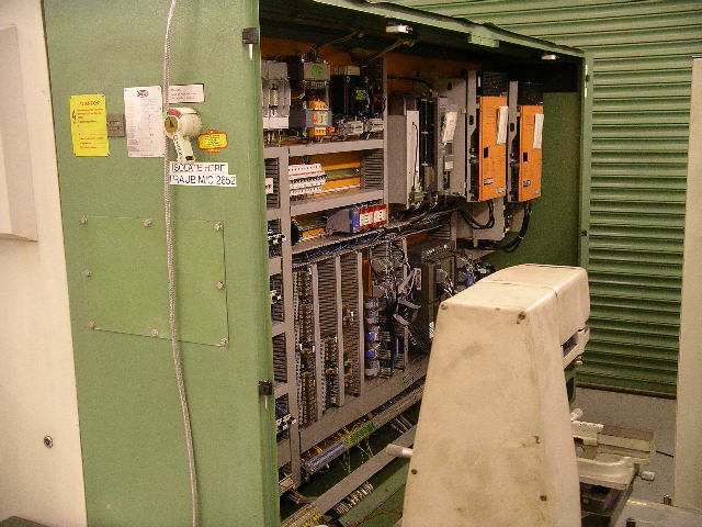

Spent quite some time today clearing away the electronic debris in the way of bits of test equipment etc to clear the deck for attacking those relays.
It suddenly dawned on me that the pain in the neck of having to keep squeezing round those doors all the time, and the fact that there was no place to put documents to read near enough could be solved. Take the bl***dy doors OFF - silly - should have done it weeks ago. The number of times I've caught my belt in the handle of the optical comparator that sits close behind the machine doesn't bear thinking about.  :doh: :doh:

Originally this lathe had a bar feeder shoving working stock up the spout on demand from the controller. As I haven't got the bar feeder I need to work out how it interacts with the digital inputs and outputs of the TX-8F controller and also the relay logic. The Emergency Stop chain went through the bar-feeder, and I traced that today and linked it out of circuit. There are three digital inputs originating from contacts on the bar feed, and I think I'll make up a diddy test box so I can count through the 8 combinations and see what the software response is.

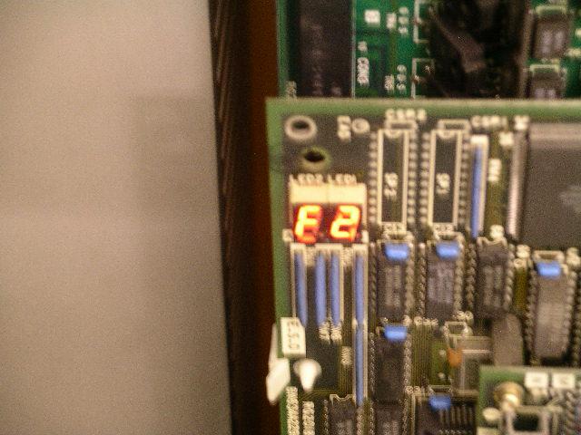

« Reply #170 on: May 09, 2013, 03:16:56 AM »

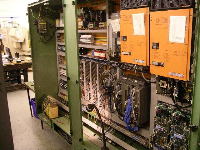

Still chasing my tail with the relay wiring on this machine - it just doesn't anything like conform to the wiring diagram that I have in the ESTOP chain and various complex safety circuits. I have discovered that there is a diagram dated '06/93' in existence (my machine delivered 07/93) whereas my drawing dates from 03/93 so perhaps they made some significant changes in that period. Next issue is persuading my contact to part with the drawing, which is proving a tough nut to crack at the moment :(
>> Later edit: OK it's a public holiday in Germany - maybe that's why no replies !!! <<  :doh:
However, if you recall the controversy  regarding using the 10 slot controller rather than the six due to suspected addressing conflicts I think I have nailed it. The attached memory map for both controllers fell into my lap yesterday - sure enough there are differences, but A/ the I/o cards fall in the same range, and b/ where that pesky MC465 BRAM sits in the map is covered by a 1 Mbyte MC472 which came with the 10 slot controller. The net result is that the CPU 'sees' memory and input output devices at all the addresses it expects so I 'think' I can eliminate this from the list of suspects generating the various error messages I have.

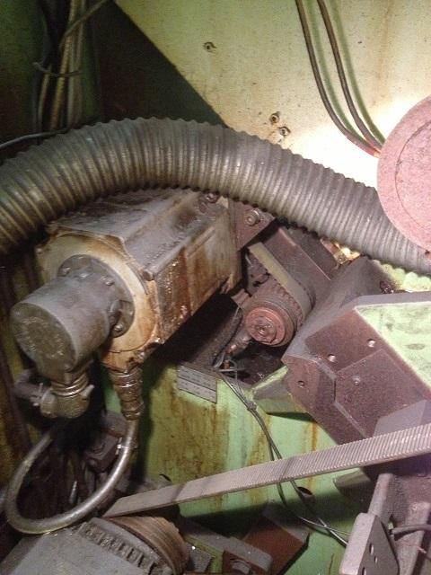

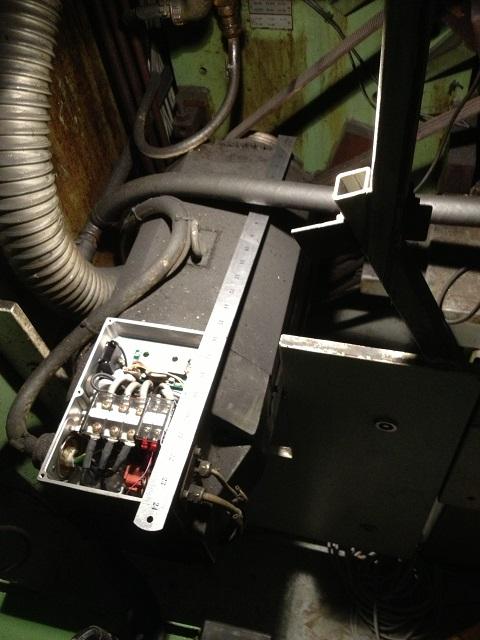

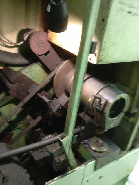

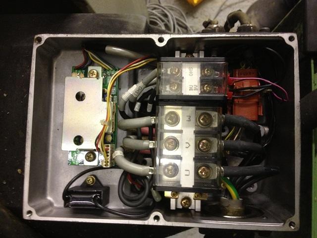

Still no circuit forthcoming from Germany, so I thought I'd try and track down some of the sensors that allegedly are reporting error conditions - this involved a bit of dismantling so I took a few pictures.
Main spindle drive is reporting an over temperature alarm - it has a sensor within it, so I dug down into the casing and got the wiring cover off the 18kW spindle servo motor:
....  needless to say the sensor says all's OK !
« Reply #172 on: May 10, 2013, 09:51:13 AM »
To give you an idea of the size of this servo motor, here it is with a 24" ruler laying on top:
« Reply #173 on: May 10, 2013, 09:52:47 AM »
It is belt driven, has a brake disk attached, and also a hydraulic clamping / un-clamping mechanism :
« Reply #174 on: May 10, 2013, 09:53:57 AM »
