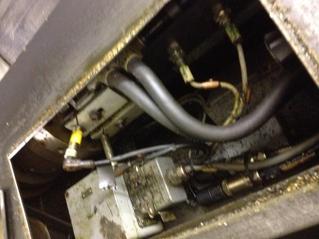

And this is the complexities of the 'opposing spindle' ie the one facing the main spindle. It has again a hydraulic clamp / un-clamp set up, with a host of proximity sensors:

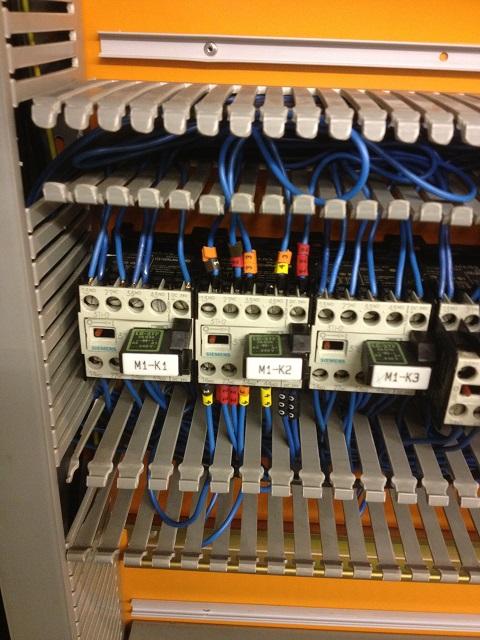

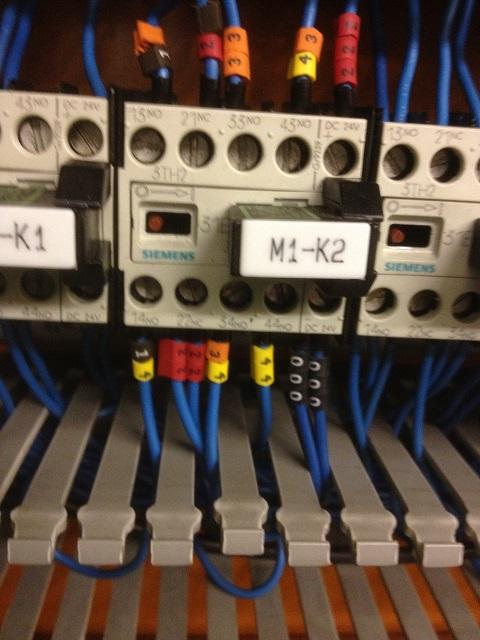

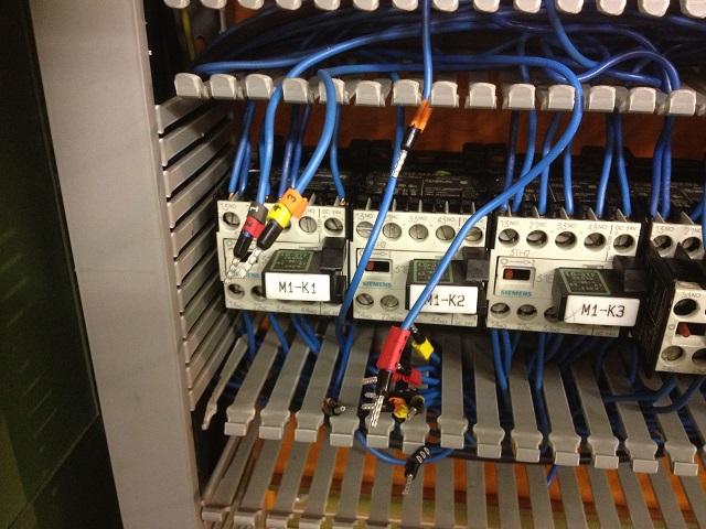

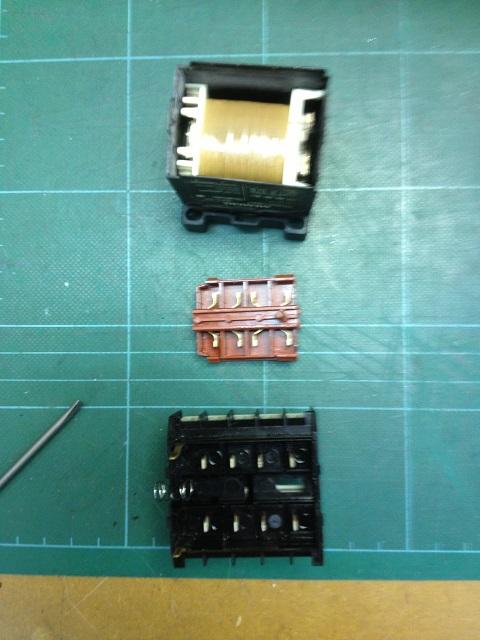

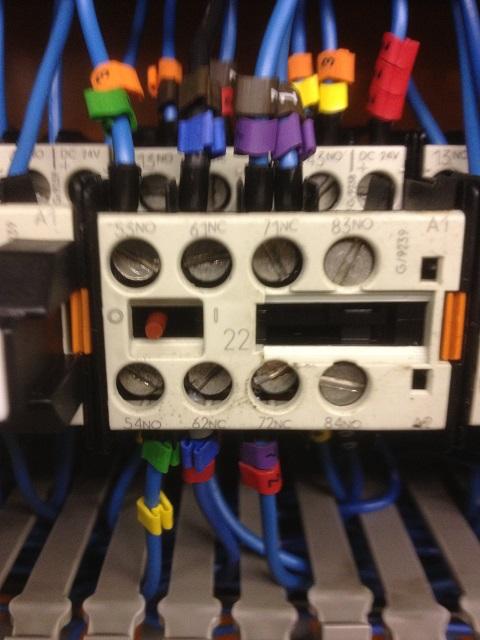

Late yesterday brought an email with a large pdf file attached - yes at last the correct (hopefully) circuit has arrived. Printed out all 169 pages on my A4 laser printer, but I decided that now I have it as a pdf  I would print out the relay side of things at A3 (old eyes you see - or rather don't  :(  ).
So this morning back into the fray: The relay in the following pictures had been giving me particular problems, and was causing other relays to chatter due to poor contacts. I can buy them still but firstly they are about £50 each, and secondly the contacts bear different numbers which will lead to future confusion, so - it has to come out and be cleaned.
First - remove all the (unlabeled) wires, and label them, putting a 'boot lace ferule' on each

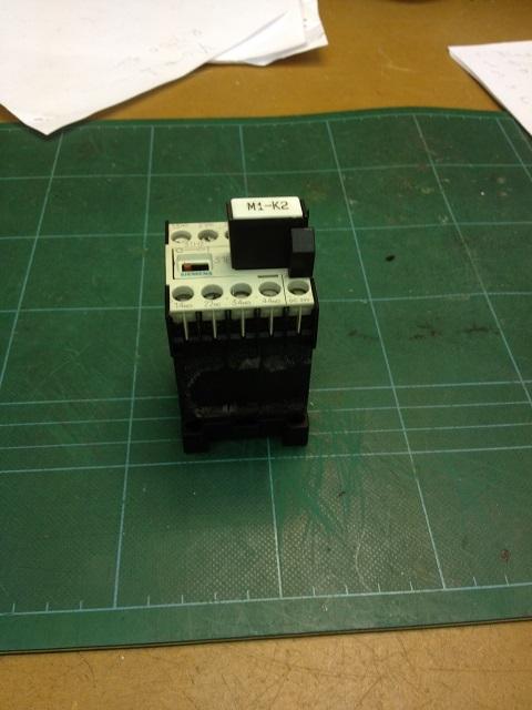

« Reply #179 on: May 11, 2013, 06:26:45 AM »

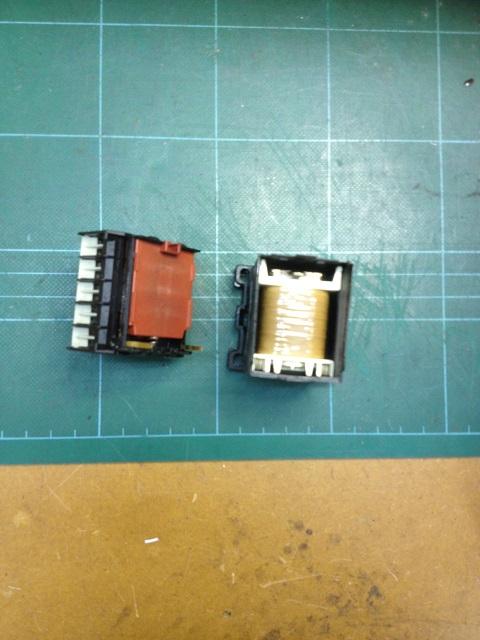

Then remove the relay, and take into the operating theatre:
« Reply #180 on: May 11, 2013, 06:27:39 AM »
Separate the coil from the contact pack
« Reply #181 on: May 11, 2013, 06:29:47 AM »
Open up the contact pack and carefully clean each contact with a scalpel. You could get special contact cleaning slightly abrasive pads for this job, but I've not seen any for years!
Test operation before replacing !
« Reply #182 on: May 11, 2013, 06:30:52 AM »
Then pop it back in. Whole operation took just over an hour - now there are a further how many relays  :bang:
However glad to say it's cured the chattering so a bit of progress  :clap:

Glad the relay is functioning again, awmawson! :thumbup:
I still use the old writing paper trick -- slid between contacts held closed for cleaning carbon from breaker points on my old tractors, and I have a point file or two in case of spikes and pits. I think you can still buy point files here at automotive supply stores.

Sadly the contacts on these relays are recessed so the paper trick doesn't fit :(  The contact surfaces are rare metal plated so I don't want to be too harsh with them - there seems to be a powdery deposit on some of them. Possibly oxide but I don't think so. I did another relay dismantle this afternoon, this time one with an auxiliary contact set added on the top. Doing the relay was just like the last one, but I could find no way of getting at the auxiliary contacts short of busting the  plastic moulding. The contacts were bad, which is why I pulled it out, but I had in the end to try and flood the inside with contact cleaner / de-oxidiser and even getting that 'inside' was flaky - obviously essentially sealed. However working it by hand with the switch cleaner floating around in the end gave a good contact, but not a satisfactory solution really.

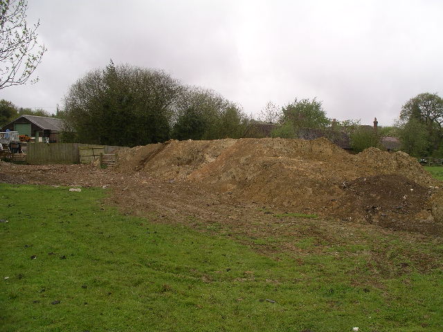

Not much activity recently on the machine - I've been called away to sort other things. We've got some large scale building works going on here, and the builder (who I've employed for over a year now) has gone to pieces over the potential loss of his mum who is having heart troubles. This gives scheduling issues so for instance I have to get 1100 tons of earth shifted tomorrow!
Lucky I'm not using a shovel and barrow:

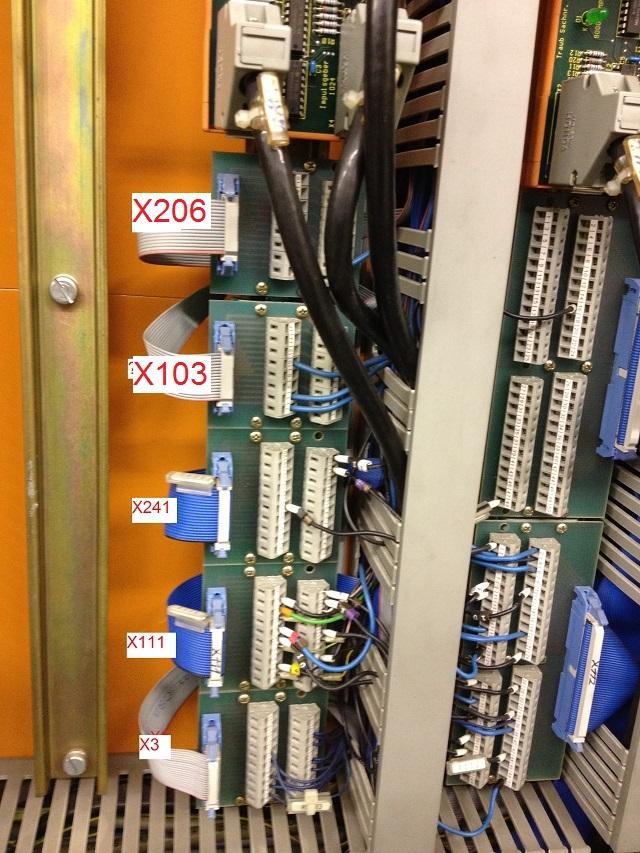

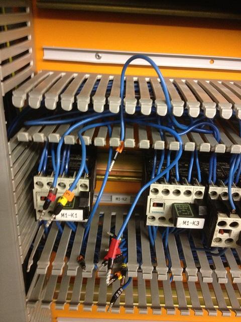

I made good use of my enforced imprisonment in the farm office to go through all 160 plus pages of the circuit diagrams pulling out all references to inputs and outputs to and from the NC controller as I was sure something was missing. I put them all in a spreadsheet, which has allowed me to sort them by i/o address and also by terminal number. Sure enough I've found five inputs that are not documented and contacting Traub, they also don't know what they do  :bang: So next job is to put the cable tracer on them and plot them out.
If you are having a really boring day have a read of the spreadsheet:

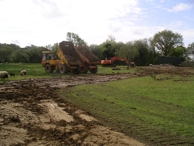

And to keep Adev happy - yes the earth moved for me! It took four of us from 07:00 to 22:00 non stop.  My shovel and barrow are in the second picture!  Just need to let the place it was dry a bit then harrow and re-seed.

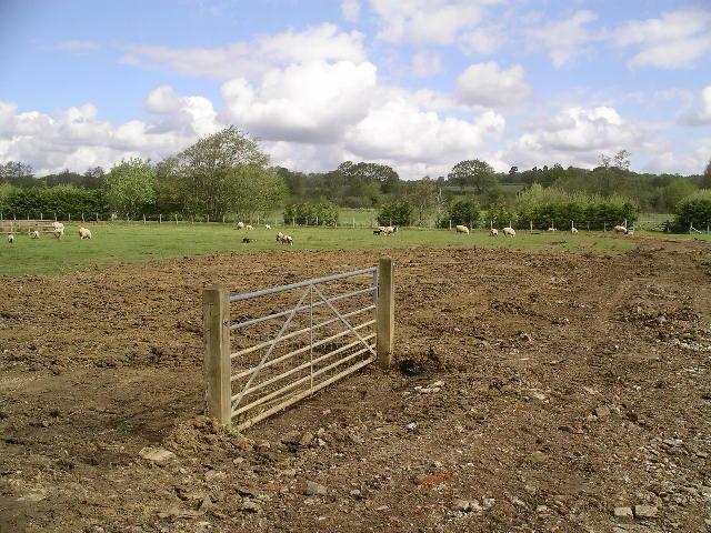

We call that 'The Gate to Nowhere' - it used to be the access to a smallish paddock, but we took the stock fencing down to let the dumpers better access when we dug out the ditches and stream a couple of years ago. The paddock will be reinstated soon, with a double stock fence with hedging between.
Anyway - back on topic: Tonight I've been buzzing out those elusive input output lines. It turns out it's down to two manufacturing errors  :bang: all be it slight ones. Firstly two of the termination blocks on my machine were incorrectly labeled, and secondly the 'survey' printed in the circuit diagram showing physical locations also has an error. In the attached picture the upper terminal block, which is 'X206' is labelled 'X103', and the block below it is actually 'X103' but wasn't labelled.  :bang:
Makes a lot more sense now.

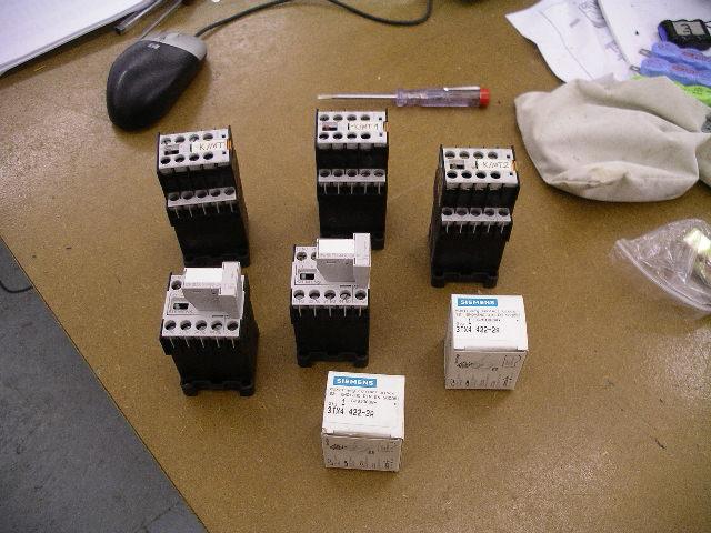

I think I alluded to this is a previous posting, but we are coming to the end of a major refurbishment here involving rebuilding the farm house, renovating two cottages and some substantial landscaping, and the poor old 'main contractor' has had a bit of a breakdown, meaning I've had to take on his role. Fortunately I've been able to use his sub-contractors (some of which are his sons) but it takes up all my play time :(
However there has been some progress on the machine. Firstly I think I've solved the relay issue. I now have the correct circuit as far as I can tell, and have sourced some identical relays from German eBay:
