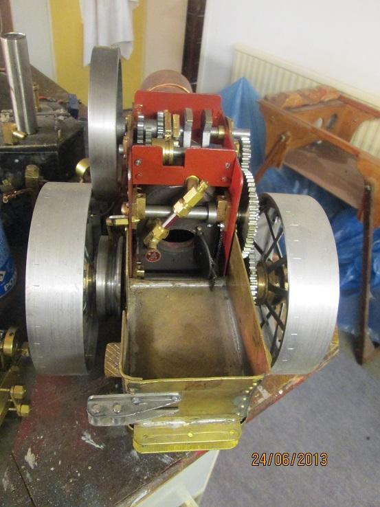

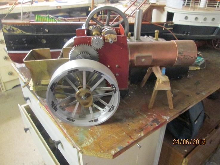

That's a grand job you are doing Joe. :bow: :clap: I am taking the liberty  of posting my long term project hear. I am not as clever as yourself, having bought castings, gears & boiler, every thing down to the last rivet. Someone's retirement project, which he never got to enjoy. It is just a thing to do in between other jobs. R.G.Y.

« Reply #24 on: September 01, 2013, 11:30:54 PM »
Hi gang..
Home for the long week-end, so back to the forum for a few minutes.  A belated thanks to Tekfab and R.G.Y., and thanks for the photos.
Got a bit done while I was here... :update: finished making the stays & nuts, and got the stays in and soldered
http://i235.photobucket.com/albums/ee257/240283/100_4689_zpsedd54d84.jpgMinnie TE Long term project
http://i235.photobucket.com/albums/ee257/240283/100_4687_zpsc8c23ed6.jpgMinnie TE Long term project
Away again for two more weeks, and then back to stay, so some progress coming soon :ddb:
Cheers, Joe
