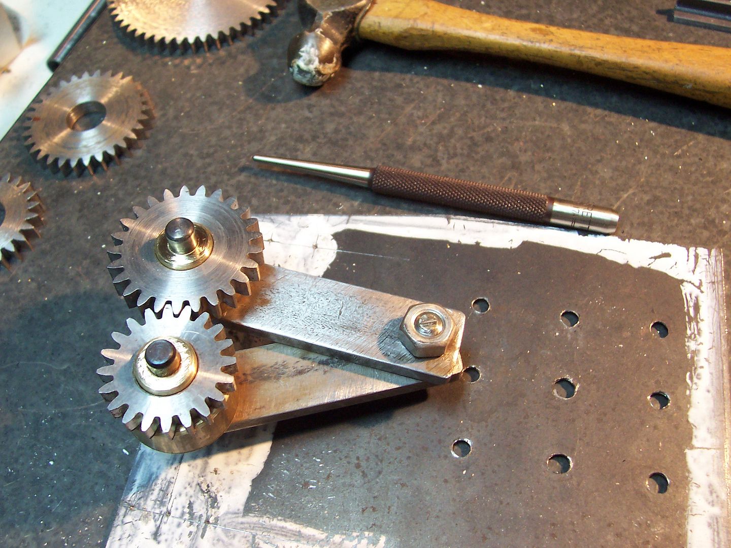

Made up a depthing tool to set out the locations for the various shafts
http://i235.photobucket.com/albums/ee257/240283/100_4720_zps390658b4.jpgMinnie TE Long term project
once the gears mesh properly, tighten up the nut at the joint, and use the pointed ends of the shafts underneath by setting one at a known location, and using the other as a scriber to mark the spot for  the next shaft.
http://i235.photobucket.com/albums/ee257/240283/100_4722_zps00dc4494.jpgMinnie TE Long term project
I'll fasten the two hornplates together, and drill & ream the shaft holes through both at once, so hopefully they line up!
Cheers, Joe

« Reply #47 on: October 08, 2013, 03:12:16 PM »
Very clever! Must remember that.  :thumbup: :thumbup: :thumbup: :thumbup: :thumbup: :clap:

« Reply #48 on: October 08, 2013, 03:47:33 PM »
So simpleI had never thought of that, Filed it away now for future use. :clap:

« Reply #49 on: October 08, 2013, 06:45:49 PM »
Thanks guys, but I cannot claim any responsibility for the idea, it's in Mason's book on building the Minnie. :thumbup:
