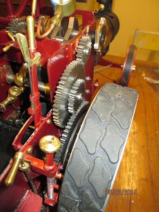

  • Posts: 44
Re: Minnie TE Long term project
« Reply #62 on: February 09, 2015, 03:23:26 PM »
Looking great Joe. Just a small slip with the bearing block. As the saying goes, he who never made a mistake, never made anything. My father always told me, any one can make a mistake, only a good man can get over it.
Now one of mine. :doh: I put the water tank filler in the wrong place. Counted the wrong rivet holes. I just managed to squeeze the brake, bypass & reversing controls in.  Only by pinching a 1/16" here and there.
At the moment I have rubber on the wheels, undecided about the cleats. RGY.
Offline Joe d
  • Posts: 251
« Reply #63 on: February 09, 2015, 03:37:27 PM »
RGY
That looks good from here!  I've still got lots to do to catch up to where you're at, so lots
of opportunities for more chances to make things twice.... :bang:
Joe
