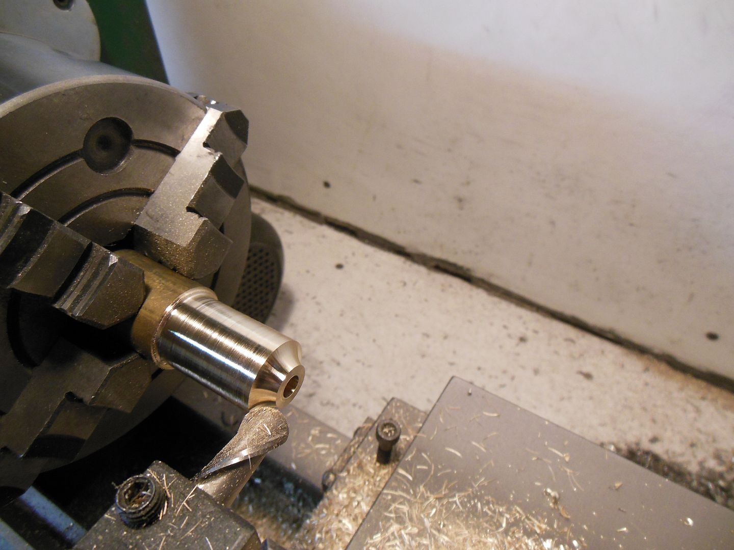

then turned the 3 part hubs, only interesting thing there was using a ball nose mill to form a radius on the inner piece
http://i235.photobucket.com/albums/ee257/240283/DSCN3278_zpsnqivhnlz.jpgMinnie TE Long term project
Now I do like that little idea  :beer: Why the hell I have never thought of doing that I really don't know  :doh:
