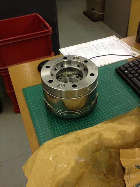

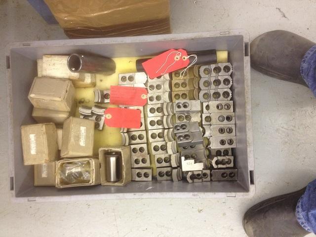

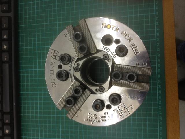

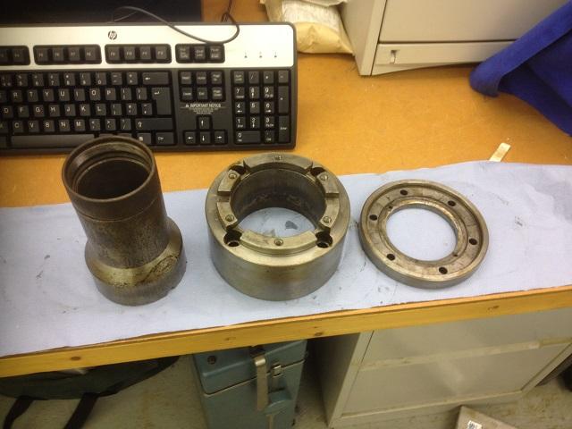

Sorry to revive an old thread chaps, but I'm using this as a way of recording what I've done to this machine - a sort of blog I suppose:
Some of you may recall that I managed to pick up a very nice, apparently unused, 'Hydraulic Power Chuck' complete with masses of jaws. I never fitted it as when I came to remove the collet chuck that came with the lathe, I was a bit stumped as to how it came off.
As I was just playing learning to program the machine it didn't matter, wasn't at the top of the list, and I let it be.

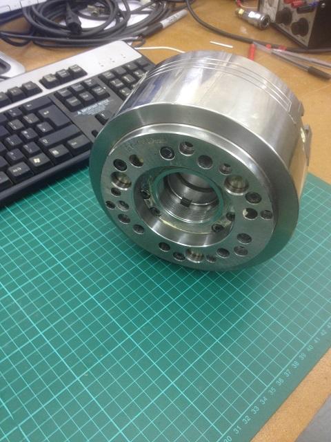

To refresh your memory this is the chuck with its jaws:
« Last Edit: August 26, 2014, 03:45:54 PM by awemawson »

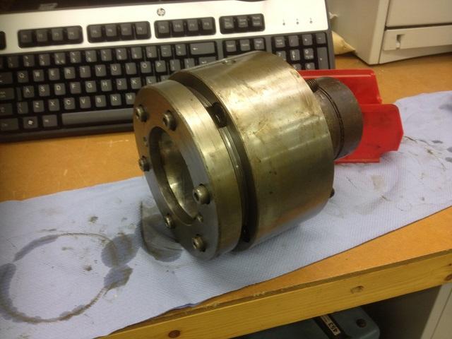

  • Posts: 9036
« Reply #534 on: August 26, 2014, 03:27:16 PM »

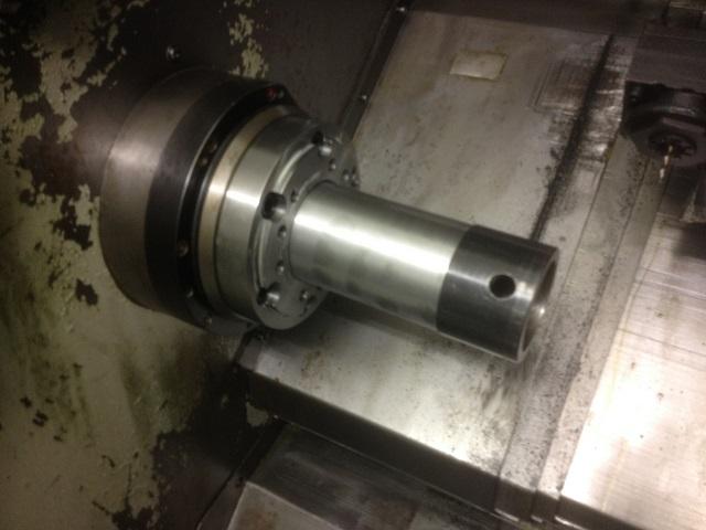

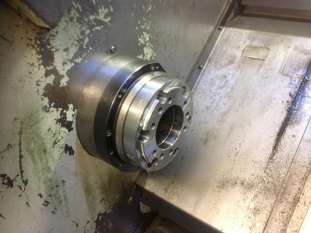

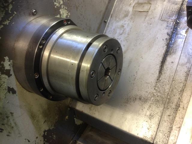

Now what had stumped me was that I knew that the Collet Chuck fixed to the main spindle with four M12 bolts, and the socket caps for these bolts were covered by the collet closer front plate, itself retained by a ring of M8 socket cap bolts. I'd removed the closer, removed the collet, removed the four M12 cap heads, and could NOT budge the actual body of the collet holder.
Yesterday, I awoke to pouring rain, and decided that being a Bank Holiday I'd actually get up in a more leisurely way than normal. So there I lay, drinking my coffee and going through my list of things that needed sorting, and this conundrum came to mind. Then, in a flash of inspiration it came to me  :coffee:
I'd always relaxed the collet before removing it, and on this lathe the collet is PUSHED to close onto the collet closer front plate, not pulled like a normal collet. This meant that the mechanism was in this instance PULLED backwards, as was the bit I was trying to remove (despite the power being off)
So today I had a couple of hours free as the sides of bacon I had to slice were chilling in the freezer. (Never try slicing bacon at room temperature, as it goes all over the place!)
So off to the workshop, CLOSED the collet, powered down, gingerly removed the closer plate that now was being pushed off), removed the collet and was able to unscrew the collet closer from the operating tube and remove the body of the collet

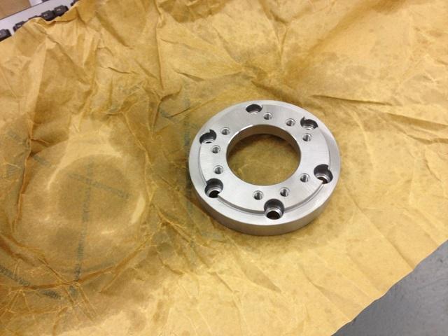

Shortly after I had bought the chuck, I'd identified and sourced the correct adapter flange to fit it to the spindle nose, so in theory all that I have to do, is turn up and thread a draw tube adapter that takes the hydraulic draw tube at one end, and the chuck operating 'ring nut' at the other.
It involves some careful length measurement and probably won't happen for a few days

Anyway it's progress, and I'm relieved to say that the adapter flange fits the spindle nose, which until today I hadn't actually seen  :scratch:

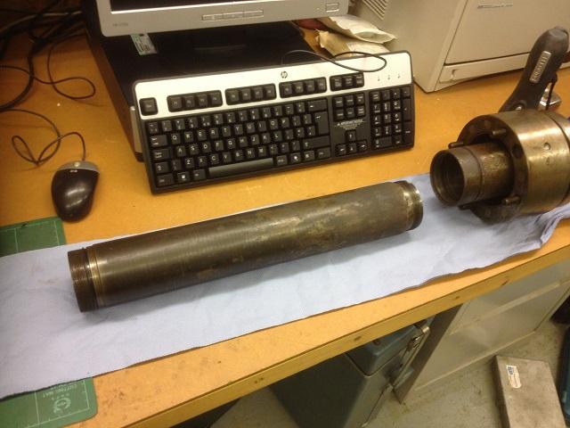

« Reply #538 on: August 27, 2014, 04:31:41 PM »
Thanks Steve.
Just a little bit of progress today. I managed to withdraw the co-axial hydraulic cylinder chuck operating tube from the main spindle of the lathe so that I could measure it's diameter and pitch. That well known standard 74 mm x 1.5 mm  :ddb:
It unscrews from the co-axial cylinder, but to lock the spindle meant I had to have power on the machine and use it's hydraulic spindle brake. Upside was that the correct tubular spanner was in the bits that came with the machine.
I also measured the chuck operating nut that the other end of the adaptor will screw into - another nice standard at 53 mm x 1.5
So now I know that I need an adaptor with a female 74.0 x 1.5 mm thread at one and, and a male 53 mm x 1.5 at the other, with an outer diameter of no more than 78 mm. with the biggest bore I can get away with.
Just need to determine the exact length. Gets slightly complicated as the chuck needs a different length of movement to the collet chuck that I've removed, and the 'far' side of the co-axial hydraulic cylinder has a proximity switch checking the movement and determining if the chuck is locked on safely or not - so the length has to fall within fairly close limits.
My thoughts at the moment are to err on the long side of the male thread and adjust to fit.

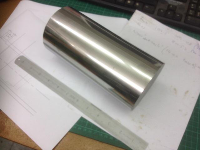

Today I dug deep in my pockets and ordered a length of 4" EN8 steel to make the adaptor - I did have an end of 5" mild steel that was long enough but I prefer to have a slightly better steel for this component

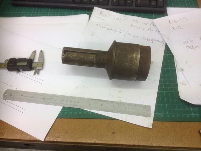

  • Posts: 9036
« Reply #541 on: September 04, 2014, 12:56:48 PM »

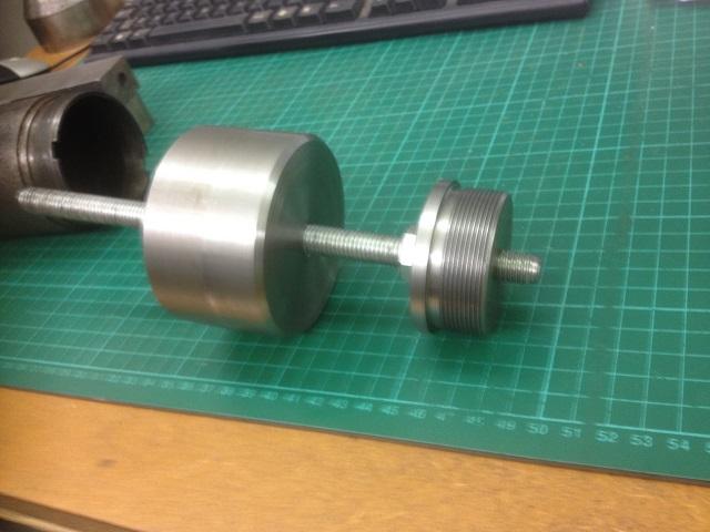

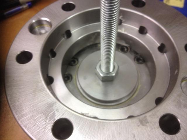

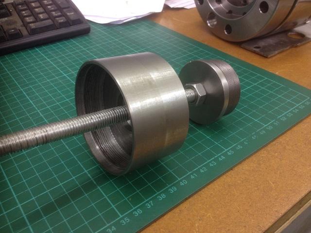

Well quite a bit of progress today. That huge chunk of EN8 steel arrived, and I decided before I started hacking it about, I would make up a functioning mock up from bits from the scrap box. So that I could adjust the length 'in situ' I decided to make a separate male and female thread, both unbored save for a 12 mm threaded hole so they would screw onto 12 mm threaded studding.
This way I can adjust it and check the chuck fully closes and fully opens while still operating the proximity sensor thus keeping the TX8-F controller happy.
  • Posts: 9036
« Reply #542 on: September 04, 2014, 12:58:34 PM »
I started with the male thread, dug out a bar end of mild steel and started making swarf:
  • Posts: 9036

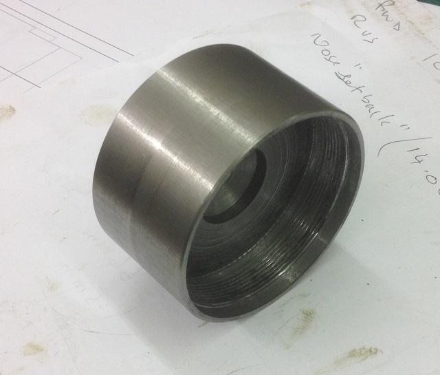

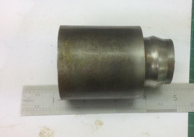

« Reply #543 on: September 04, 2014, 01:00:39 PM »
Then I attacked the female thread. Stock this time was the end of a roller scraped from a paper mill.
  • Posts: 9036
« Reply #544 on: September 04, 2014, 01:02:39 PM »

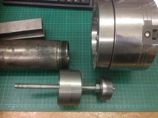

The two bits then screw onto a length of 12 mm studding, allowing me to adjust their separation in a 'suck it and see' fashion

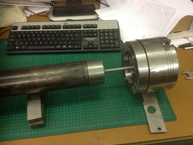

  • Posts: 9036
« Reply #545 on: September 04, 2014, 01:03:39 PM »
And then putting the hydraulic draw tube, my mock up, and the chuck together we get this:
  • Posts: 9036
« Reply #546 on: September 04, 2014, 01:05:32 PM »
So tomorrow I hope to assemble this lot back in the lathe spindle, which will allow me to make adjustments and trials to finalise the length of the 'proper' adapter.
But first I need to make some tubular spanners so the bits can be tweaked in place.

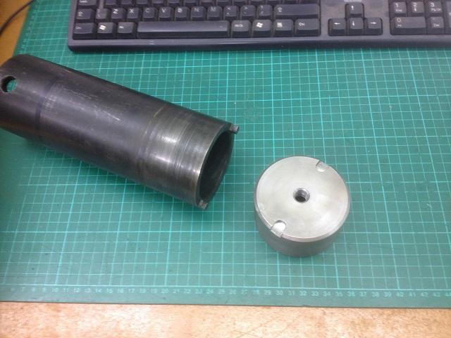

Nothing complicated Steve - just heavy wall tube with projecting lugs.
So I started today by milling pockets in the female threaded part to match the big tubular spanner that came with the lathe

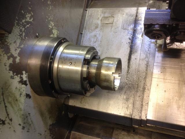

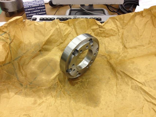

  • Posts: 9036

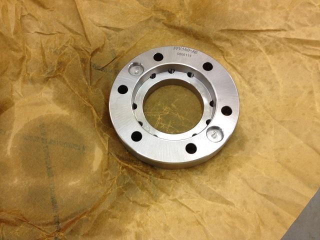

« Reply #549 on: September 05, 2014, 06:26:48 AM »

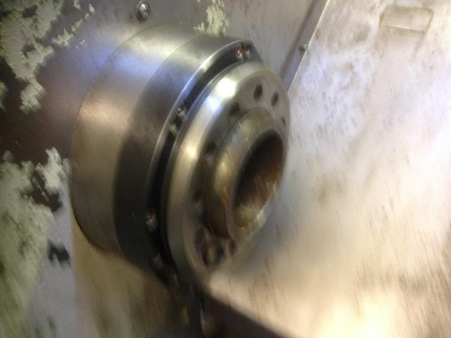

This spanner fits 'up the spout' of the lathe and was intended to tighten the tube that couples the hollow hydraulic cylinder to the chucking device.
Next task was to fit the adapter on the spindle nose that converts the A6 nose to this particular chuck (A5) - easy task, but then I discovered that the bore through the adapter was a tad less than the spindle bore, no issue functionally except that the big tubular spanner won't go through it  :bang:
But that's why we have lathes . . . . modify the spanner  :ddb:
Rather a lot of over hang here - but it's very thick walled tubing - I had to reduce it by 1.5 mm diameter
