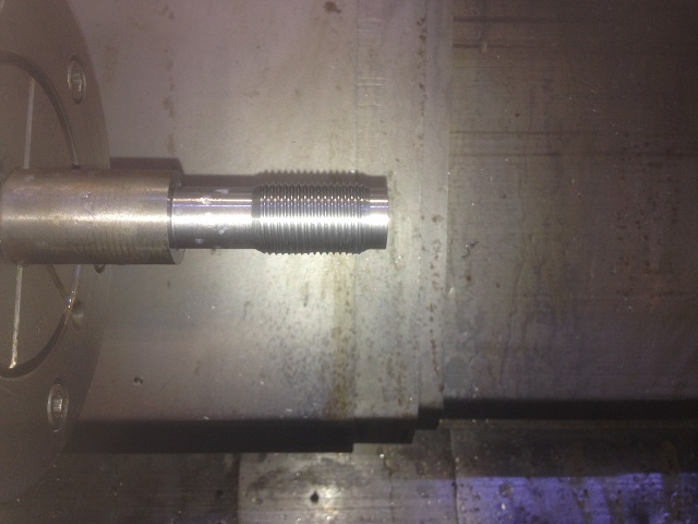

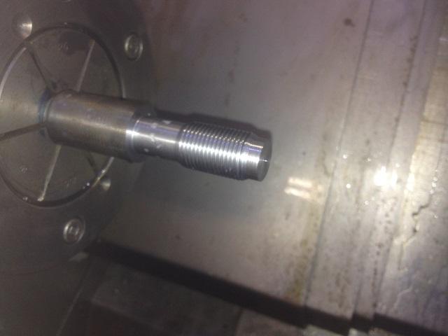

Anyway back on topic.  :ddb: I cut my first thread today  :ddb:
It may only be simple but it took a long time coming  :clap:
This is the first 'real' operation sequence since I got the lathe running. First I cut the profile of the thread, which is 20 mm o/d by 25 mm long with 45 degree lead in and lead out, cut from 25 mm mild steel stock. Then I cut the thread itself, which is 1.75 mm pitch using a 'partial' thread form insert as that was the only one I had on a tool holder! Then profiling was an exercise in "G96" roughing cycle following a defined profile. Then the thread was a "G76 thread chasing cycle"
Made my head spin understanding all the parameters but we seem to have got there!
Only slight down side is that I've had a few 'trip outs' on the axis drives - no real rhyme or reason and so far they've always reset, but there's something lurking there still  :(
Anyway on a more positive note have some pictures, and a video will follow as soon as it's uploaded
lordedmond
« Reply #481 on: October 21, 2013, 11:27:33 AM »
that looks a fine thread ( I mean a well curt thread ) was it on spec ?
better get down to chasing those pesky bugs , but I fear that you may well have a few more to sort the more you use the beast
Stuart
Stuart, well it's what I aimed for  :clap: I don't think 20 mm x 1.75 can be a standard by any means. The pitch is as right as I can measure it, and the o/d is dead nuts on at 20 mm as I specified, whereas if it was being made for proper the o/d would be slightly under nominal size. Thread form is down to the insert, but looks ok in comparison to a thread gauge. I've bought a new set of metric full form inserts, but didn't want to mount them and wipe them out whilst learning  :bugeye:
