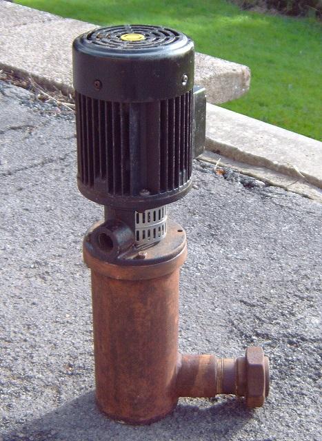

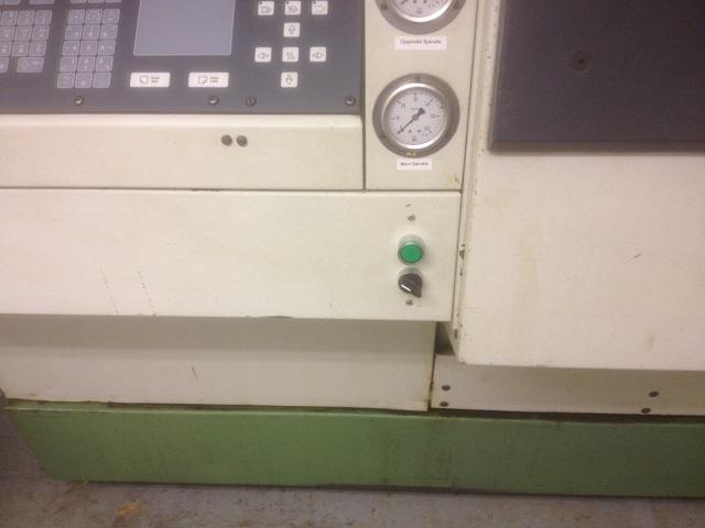

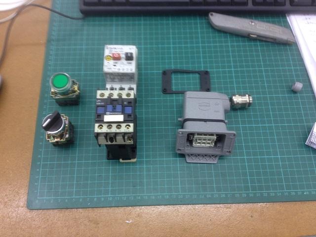

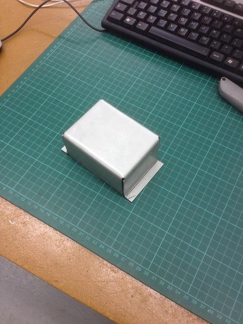

I've been gathering together what I need for the coolant wash out system that I'm adding so that I can hose things down inside. I've sourced the pump, the contactor to control it, the cut out to protect it, the panel switch and indicator to start it. This morning the 105 mm Starrett hole cutter arrived and I've cut out dummy pump flanges in 3mm plastic on my Beaver Partsmaster to check that the pump will fit where I intend to put it as it's a bit tight. Spent far far too long trying to remember how to set tool offsets on the Partsmaster as it's sat idle for too long and my grey cells are dying, but I've got the hang of it now.
The control switch will go under the console so that it is convenient to use, but this means that the wiring passes through the rather exposed and oily hydraulic section. I've bent up a little 3"x 6" x 2" box to surround them so I can bring conduit or possibly SY  armored wiring with a gland, but I'm not happy how the box has come out.
Currently contemplating cutting some suitable sheet half way through with a centre drill on the CNC mill to get sharper bends.

I had planned just to weld up the corners of this box, and I may still do that, but as I have the Partsmaster currently set up with a 'spoil board' for cutting sheet held down by sticky tape I may experiment engraving deep lines for folding using a centre drill. However it's a bit of a bind as two of the bends are on the under side so it means location pins I suppose

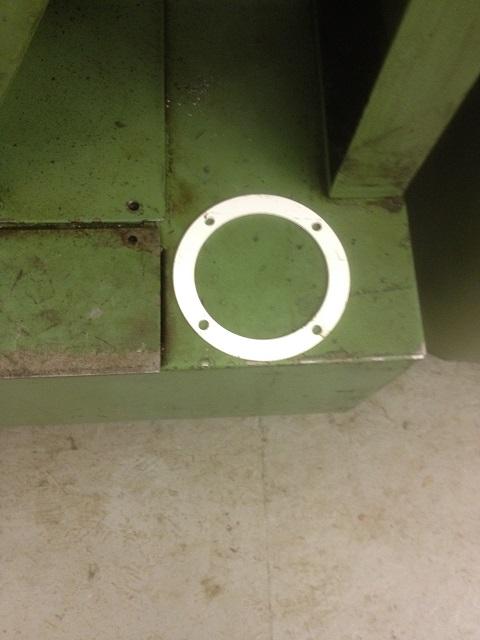

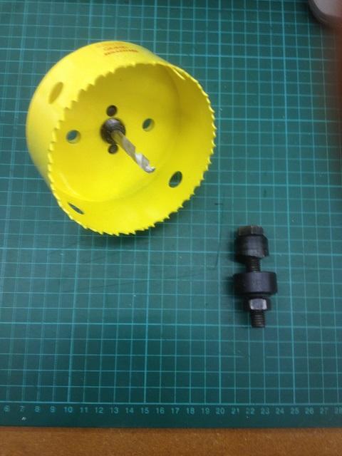

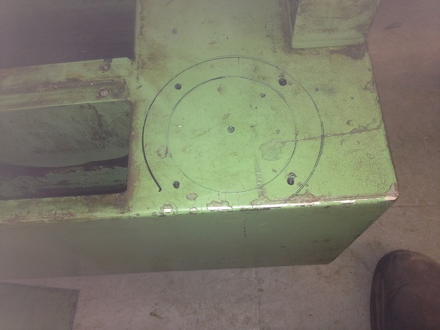

So I thought - stop pratting about and drill the hole now that you've got the hole saw.
Decided to check that I'd be able to get my hands onto the bolts holding the flange, so removed the access cover. Argh  :bang: :bang: :bang: Where I had intended to mount the pump is a separate compartment and doesn't seem to communicate with the coolant reservoir.
NEVER ASSUME
So I either need to open up holes into that compartment and hope that it is coolant proof underneath,  or find somewhere else for the pump. There is I think, room round the back but it's less convenient for plumbing and wiring.

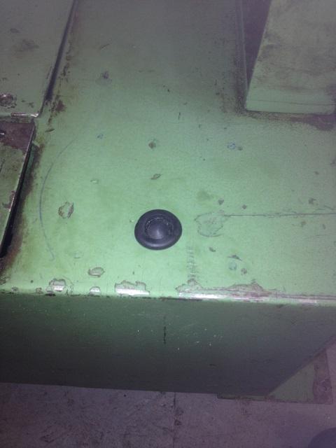

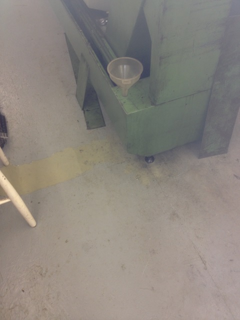

« Reply #454 on: October 09, 2013, 08:21:02 AM »
OK an action plan. Drill a hole in the top that will fall within the pump shaft opening, and tentatively fill or partially fill the chamber with coolant and see how much ends up on the floor! If none then trepan a large hole in the side to join the tanks
« Reply #455 on: October 09, 2013, 10:02:04 AM »
Well that's the end of that brilliant plan  :bugeye:
Drilled a 20 mm hole, put in a few pints of coolant, mopped a few pints of coolant off the floor then bunged the hole up with a blind grommet. Time to seek plan B.

Well plan B is to put it in an external housing
(yes I know, John S you did offer me a pump in an external housing but it was only 1/8 HP!)
The chap who I got the pump from took a housing off to reduce the carriage cost - well it's on the way to me now  :ddb:
It's not ideal as it's something else to trip over but it should solve the problem.

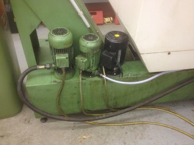

« Reply #458 on: October 15, 2013, 01:05:14 PM »
Plan B was rejected on aesthetic grounds  :clap:

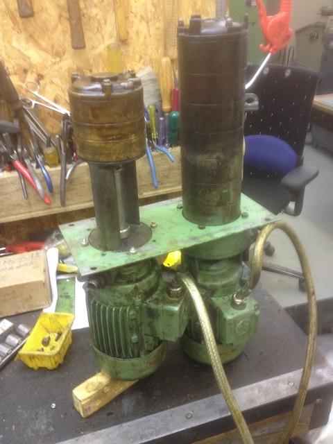

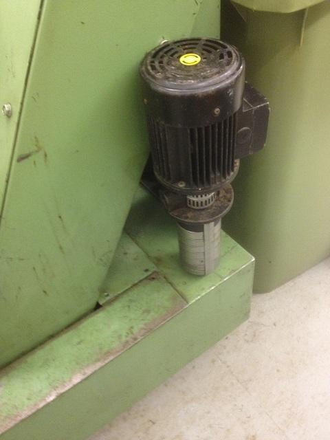

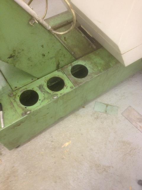

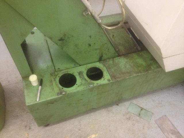

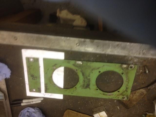

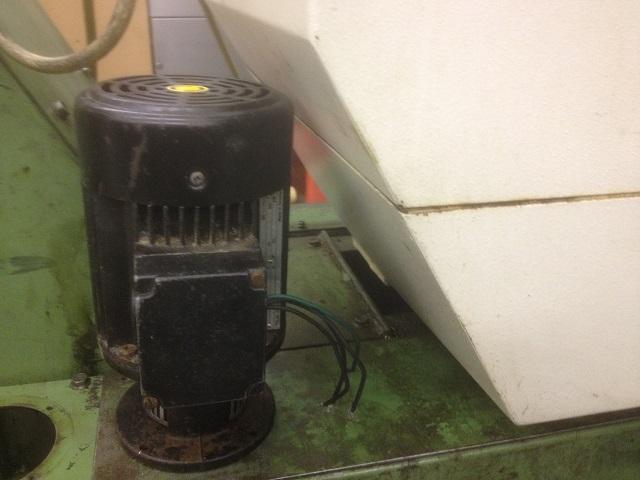

With a bit of jiggling and wriggling I reckoned I could get the third pump round the back of the machine next to the other two coolant pumps - it would be a squash but better than having a lump sticking out at the front 'like a carbuncle on the face of an old friend' to quote a well known person.
Best to do a mock up before cutting holes !

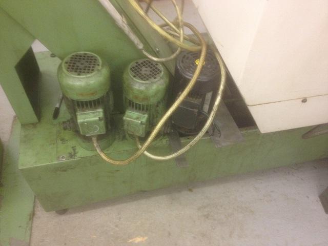

« Reply #459 on: October 15, 2013, 01:10:39 PM »
So yes, they JUST fit, with very limited clearance on the sloping panel to the right - but hey - they're in, albeit balanced on bits of flat iron!
The two original pumps will need moving 50 mm left, their mounting plate shortening, another mounting plate will need to be made for the third pump, and there is a filter in the tank that will need a bit of re-jigging.
Oh, and the new pump, and the middle pump will need careful alignment or their outputs will not be accessible.  Simples really  :clap:

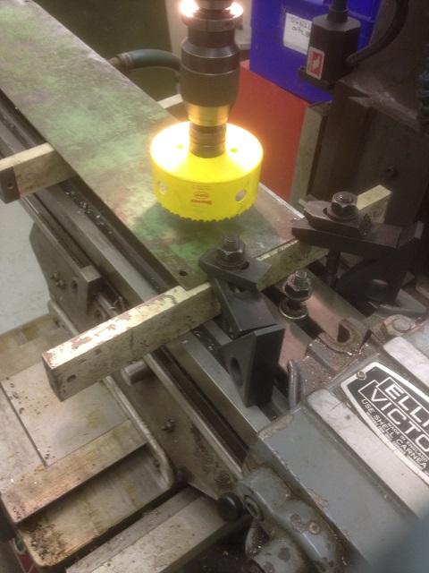

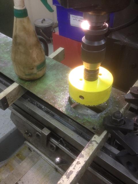

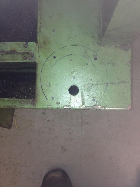

« Reply #460 on: October 15, 2013, 01:14:13 PM »
Next to cut the 100 mm hole for the new plate. Due to the width and length of the plate I could only get two clamps on it. Then I attacked it with a big scary cutter  :bugeye:

Due to the construction, the taller pump has to stand on a pedestal or would be too deep in the tank, so this means it has to be fixed to it's mounting plate along with the second pump as a sub- assembly then lowered into the tank
« Reply #462 on: October 15, 2013, 01:19:44 PM »
However pump no 3 has to go in first or you can't get at it's bolts!

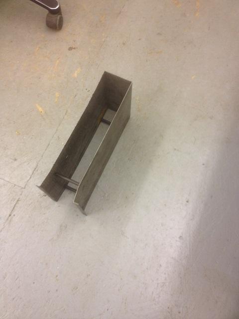

At this point I started attacking the filter, which would have fouled pump no 3

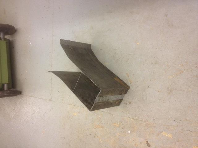

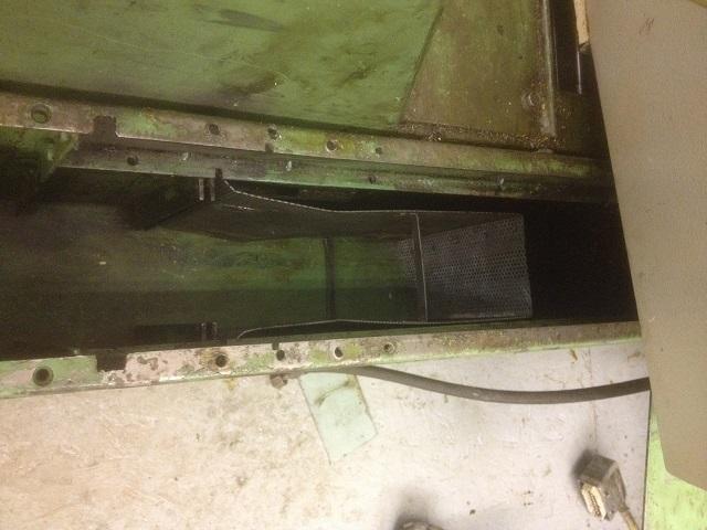

« Reply #463 on: October 15, 2013, 01:23:03 PM »
Basically it had to be somewhat wider to clear the pump body, yet still stop swarf entering that area. A classic 'cut & shut' exercise with an angle grinder and a spot welder!
Then at last the whole assembly could be put together. As you can see the new pump just clears everything  :ddb:
« Reply #464 on: October 15, 2013, 01:26:51 PM »
As the original pumps moved left 50 mm one of the braided pipes no longer reached  :bang: so had to be re-made, but trivial really.
"All" that remains now to do to this bit of the project, is mount the controls, wire them and the motor up, and plumb it to the hand held wash down nozzle.

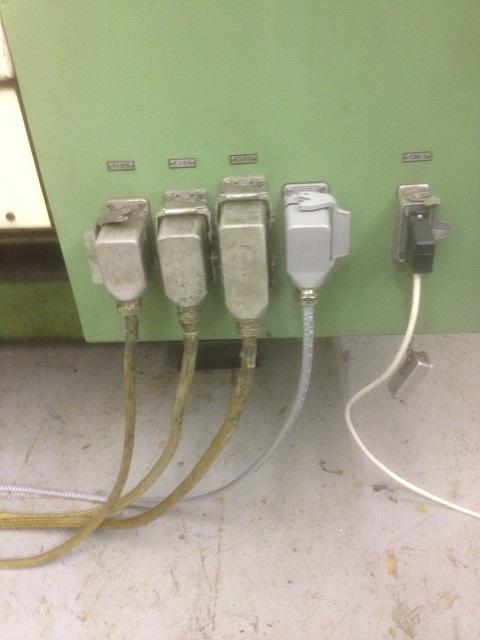

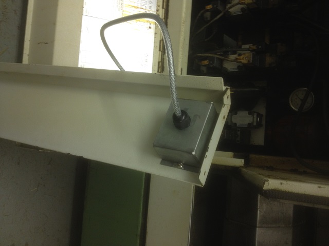

Firstly I needed to wire up and plumb in the manual wash down pump. The wiring went very well, I was actually able to pull a multicore 'SY' cable through the existing ducts from the control panel all the way to where I've mounted the 'motor protector' and the contactor that drives the new pump.

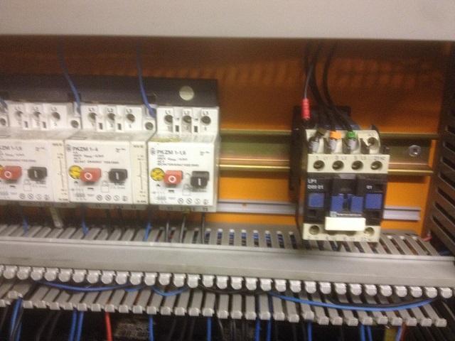

« Reply #466 on: October 19, 2013, 09:16:03 AM »
I had a stroke of luck wiring up the motor protector, which is on the far right hand end of a row of them. Turns out that the three contacts for the three phases are distributed using a busbar. They obviously had standard length busbars  using two in this row, one of which would have been too long originally, so they overlapped it on two devices. All I had to do was remove it and 'single overlap' the busbar and the three phases were connected - result  :clap:

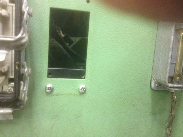

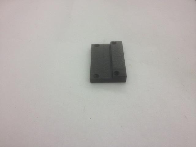

When it came to the plug and socket leading from the machine to the pump, there was already an existing cut out in the machine chassis that was blanked off. However the size of the cut out was suitable for a ten way Harting industrial connector which I couldn't source at a sensible price. I could get a 6 way as a 'Han-Kit' comprising plug / socket / inserts / covers / clamps - the whole shebang for the price of just a 10 way insert  :bugeye:
So .... reduce the hole. Not too hard really as the width was the same just the height was out by 13 mm - so I milled out a little adaptor ...
« Reply #467 on: October 19, 2013, 09:24:56 AM »
So now there are two plugs  in that row that could be put in the wrong sockets. The extreme left hand one is for the motor for the swarf conveyor, and of course the new pump. They are both 415v 3 phase motors, so as long as I used compatible pin outs at least things wouldn't go bang if someone made an error!
Checking the swarf conveyor connector it turns out that pins 1&2 are intended for a thermal trip, which isn't present in my conveyor, so just had a link across them. It's as well I didn't just use pins 1,2, &3 for the three phases  :bugeye:
So I copied the swarf conveyors connections using 3,4 &5 for the phases, and assembled the plug such that if it was put in the swarf conveyor socket the cable would point upwards. hopefully this will stop someone connecting it wrong in the future, as there is no other way of personalising the socket so it cannot be used by the wrong plug  :(

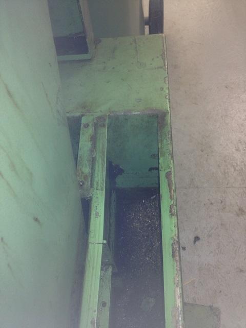

I also installed a tramp oil skimmer - just managed to squeeze it under the rising part of the swarf convayer where hopefully it'll be out of the way and not get knocked. Although I cleaned the tanks as far as I could, there was still a lot of tramp oil that I couldn't reach.

I'm not familiar with the plugs you describe, but how about cutting off one of the unused pins and blocking up the corresponding hole.  You would have to modify both plugs on different pins but even one would prevent getting them crossed over.
« Reply #471 on: October 19, 2013, 02:45:27 PM »
Yes Russell I'd thought of removing a socket and putting a customised peg in the corresponding plug, but the way it's wired all that will happen if someone gets it wrong is that the swarf conveyor will start instead of the pump, and vice versa. I also considered paining each plug/socket combination a different colour, but where do you stop !
  • Posts: 537
« Reply #472 on: October 19, 2013, 03:07:45 PM »
My idea was that if you cut off pin 1 on plug A and blocked hole 1 on socket A (eg by putting in the cut off pin) , then plug B couldn't be inserted as it would still have pin 1 and there'd be no hole for it to go in.  If you did the same to pin 2 and hole 2 on plug B and socket B then plug A couldn't go in socket B.  It'd be physically impossible to insert the plugs the wrong way around.
