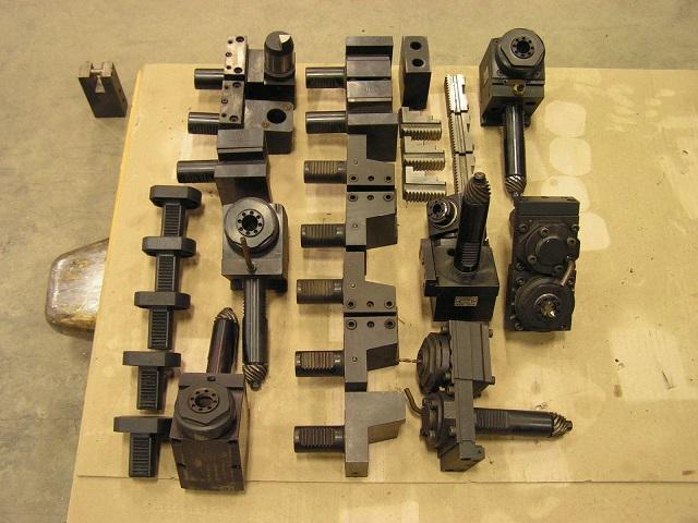

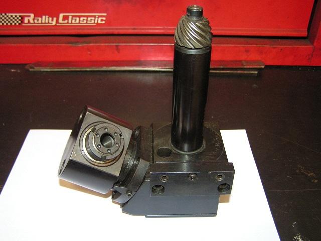

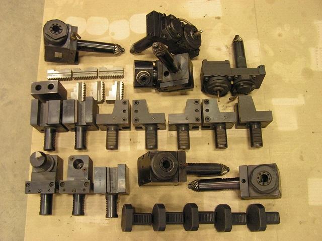

 :ddb: :ddb: Well I've been very naughty and indulged myself.  :ddb: :ddb:
 A fellow in the USA has been advertising a full set of static and powered tooling that had originally been purchased brand new many years ago to kit out a Traub lathe for a particular task. The lathe proved to be a pile of poop and went back to the dealer, and this chap got left with $30K cost of tooling. The ebay advert kept popping up at irregular intervals and the kit didn't sell at his starting price, so I put in a VERY silly offer having worked out that there's 80 lbs of tooling to move across the pond which carries a fair price tag! ($240 is lowest quote I've had) .
 :thumbup: :thumbup: :thumbup: Anyway amazingly my silly offer has been accepted  :thumbup: :thumbup: :thumbup:
The swivel angle powered tool is particularly attractive and I shudder to think what it would cost now new
(Pictures are from the ebay advert)

Looks like those widgets are going to be getting a bit more complex .... :thumbup:

nice catch on the tool holders

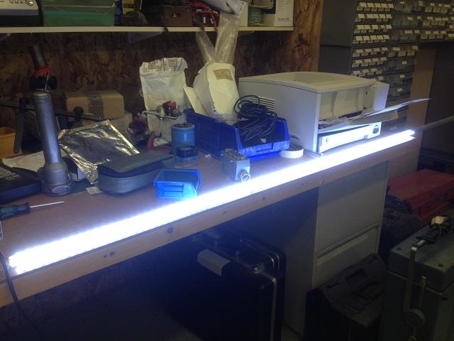

I've decided that the lighting in the machining enclosure is not up to snuff, so am upgrading it, but as the solution is possibly applicable to other machines I've started another thread here:
http://madmodder.net/index.php/topic,9062.msg99297.html#msg99297
