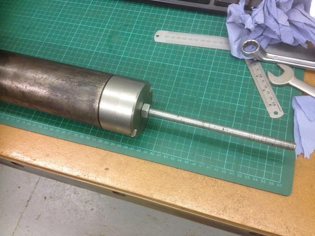

So now I could fit the actuating tube, and screw the female thread on the end, onto which I'd screwed the threaded rod and locked it in place with a locknut on each side

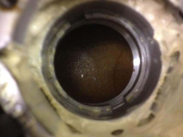

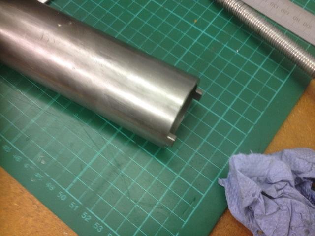

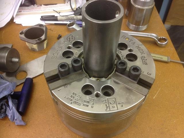

Next I needed a way of turning the actuator nut in the chuck, so that I could screw it, complete with my male threaded adapter, onto the studding to make length adjustments.
A tubular spanner came with the chuck, but due to it's diameter it will only engage the nut from the mounting side of the chuck - not a lot of use in my application ! Spanner wall not thick enough to reduce so need to start afresh.
Hunting for heavy walled tube or suitable bar it then occurred to me - there is a swarf guard at the front of the nut - would it remove and let the spanner in . . . oh YES  :thumbup:
« Reply #552 on: September 05, 2014, 06:50:44 AM »

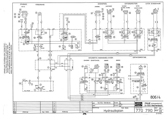

So now I'm ready to mount the chuck and try it out . . .
. . . . EXCEPT . . . I need to be sure of the hydraulics - a lot of power in that actuating cylinder. Operating force is tweakable by setting the hydraulic pressure, and I need to familiarise myself with the hydraulic manifold before I start random twiddling  :scratch: :scratch:
The chuck says maximum operating force is 22 kNewtons ie 22,000 Newtons
Powering up the machine (no chuck fitted) lets me see that the current operating pressure is 30 bar, and the chart on the cabinet says this gives 4000 deca Newtons or 40,000 so presumably that pressure needs about halving.
Also I'm not sure how much tension that I can put on that 12 mm studding. It's only there to prove movement length and position, so I will turn the hydraulic pressure as low as I can for testing, then re-set it when I make the final adapter.
Have a hydraulic circuit diagram:

A bit of fiddling about and I've reduced the hydraulic pressure to 2.5 bar (from 30 bar) which I'm sure is a safe level for testing the movement of the chuck mechanism. I've also been able to reverse the direction the hydraulic cylinder operates when told to close (The original collet chuck pushes closed, this chuck pulls closed)

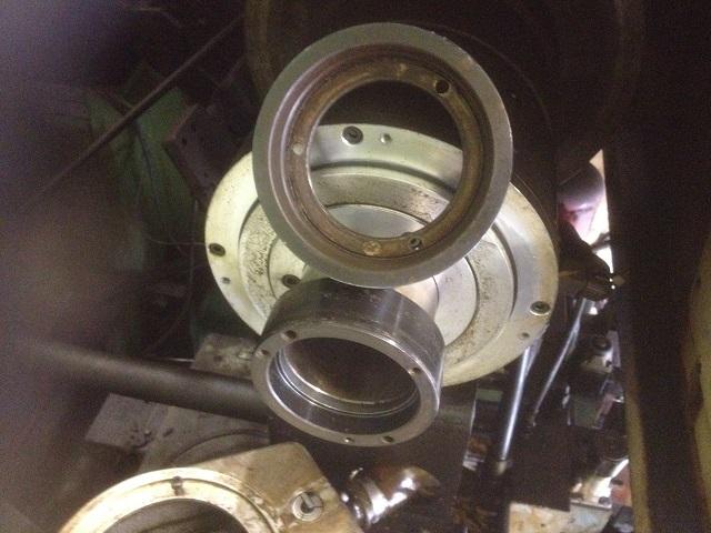

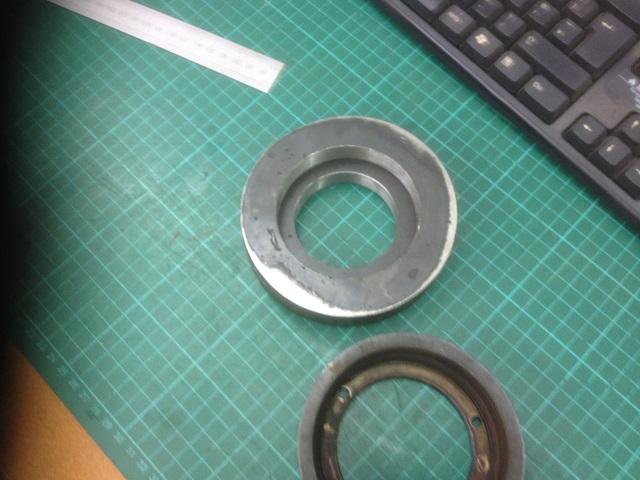

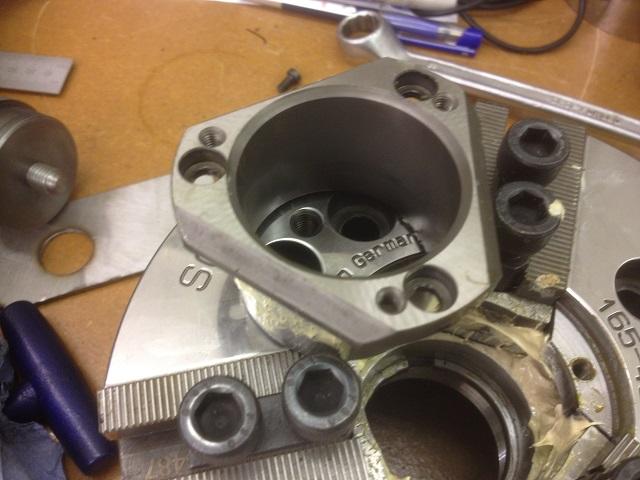

So I put my attention on the outer end of the spindle where the proximity sensor is.
The sensor is fixed in a housing that has two functions a/ hold the sensor and b/ act as a funnel for any coolant that pases down the bore of the spindle, directing it back to the sump.
Removing the housing shows the disk that theoretically is held in by three cap head screws - no screws in the holes ! The disk seems to be a VERY tight fit over a hub, and so far it is resisting my attempts to remove it
This is what it looks like
« Reply #558 on: September 05, 2014, 10:14:18 AM »

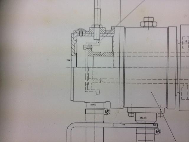

Now  I do have a plan of a similar spindle (shown below) and it confirms that only the screws retain it, but on mine the hub on the spindle is somewhat longer, and the disk surrounds it for a depth of maybe 3/4".
So far gentle heating, tapping with a plastic mallet, and application of wooden wedges has failed to shift it. I may have to devise some form of customised slide hammer to pull it off, but duty calls. I need to have a wash and scrub up before greeting and meeting some new guests in the cottages  :bugeye:

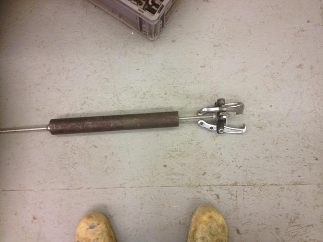

However I did manage to escape for half an hour and cobbled together a slide hammer from the jaws of a bearing puller, with a length of 12 mm studding projecting back as the slide, with a length of very heavy section cored rod as the hammer.
« Reply #562 on: September 06, 2014, 09:34:02 AM »
So did it work - - - - - oh yes  :clap: :clap: :clap: :clap:
« Reply #563 on: September 06, 2014, 09:35:55 AM »

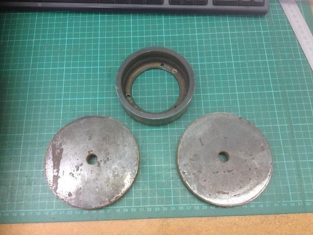

So now I need to hunt out a large bit of steel to make a replacement with a different profile so that the sensing happens in reverse to this one. I need a billet to produce a 108 mm diameter by 32 mm if you have one in your pocket  :ddb:
 I could turn down the original, but I will retain it with the collet closer in case I need to refit that chucking arrangement at any time in the future

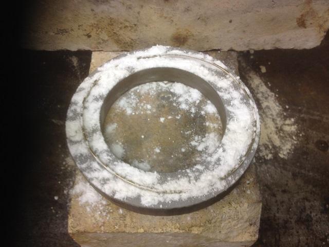

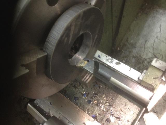

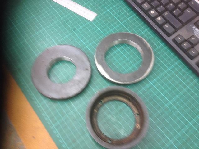

So in the absence of a suitable bar end (and it would have had to be 4 1/4" diameter) I remembered that I had had some blanks flame cut some years ago to make gear wheels. Digging through them found two that if glued together might work
« Reply #573 on: September 07, 2014, 07:41:37 AM »

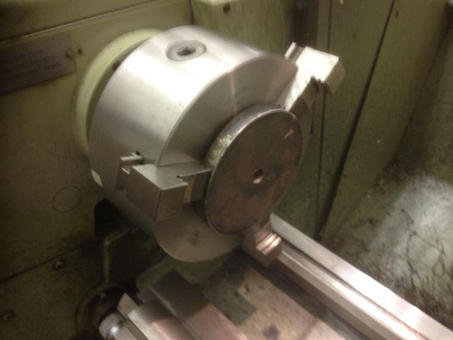

I needed 31 mm of thickness and these together make 30 mm which is close enough, as I'm adjusting the position that sensing occurs with the length of my chuck adaptor.

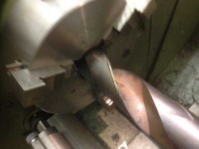

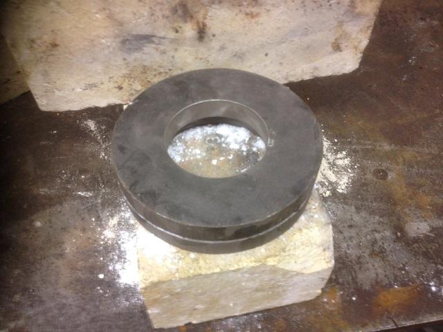

So I started by boring them out to 10 mm undersize to reduce their bulk for the silver soldering I was planning to use to fix them together
Don't often have to fit the reversed jaws but they went in today. Then I initially drilled a 2" hole in them to save time actually boring
« Reply #574 on: September 07, 2014, 07:44:01 AM »
The idea was to set them up like a sandwich, with a ring of silver solder and a sprinkling of flux, then heat them dull red with the oxy-acetylene torch, but first I grit blasted the mating surfaces.
