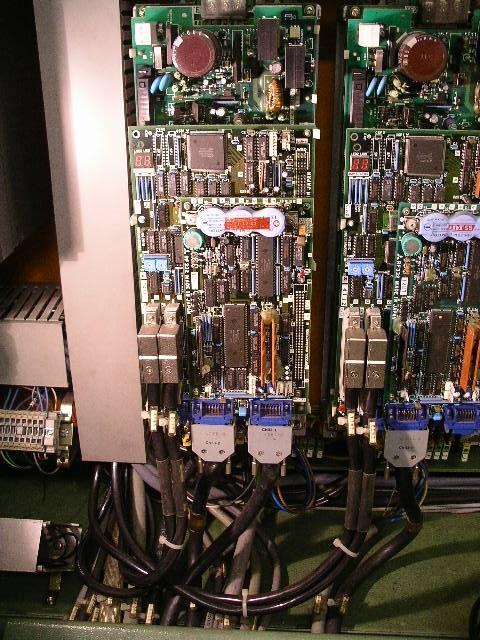

Today started with a bang. Literally  :doh:

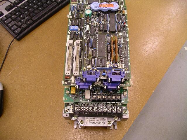

Went to the workshop to resume chasing relay faults, turned on the power and there was a crack /  bang like a fuse blowing. Turns out that the dual servo drive for the X & Z axis had blown up  :( Looking at it it was showing no signs of life. 3 phase going in, no supplies on the board. Here it is in situ:
« Reply #103 on: April 29, 2013, 12:02:28 PM »

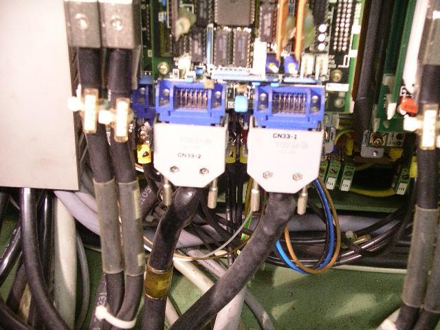

Obviously going to have to get it out and on the bench - loads of connections:

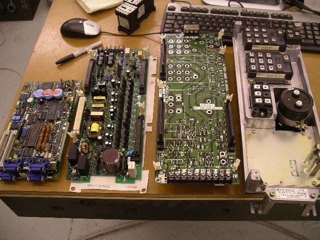

« Reply #104 on: April 29, 2013, 12:04:09 PM »
So got it on the bench and need to pull it to pieces for a very close examination:
« Reply #105 on: April 29, 2013, 12:08:35 PM »

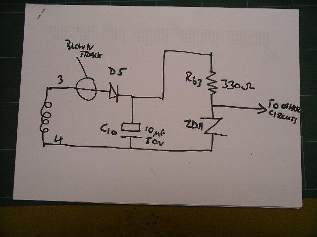

I was expecting to find blown up power components in the input side but everything looked (and smelled - don't over look the nose in diagnosis !) ok - It's the usual input stage of the three phases coming in to a bridge rectifier and charging up a whacking great reservoir capacitor, with inrush current limiting by having power resistors in series with the three phases, shorted out a second or so after power on. However all looked well to my trusty Avo!

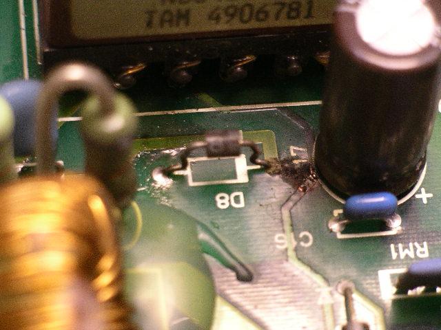

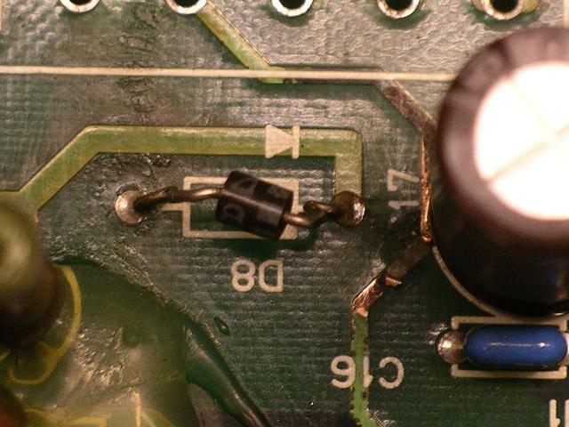

Then I started looking at the driver board and found this:
« Reply #106 on: April 29, 2013, 12:10:39 PM »
There is a bit of pcb track blown open circuit, and a flash mark next to a 180v working electrolytic capacitor. My guess is that the capacitor has gone short circuit blowing the track but yet to prove that theory as it's time to feed the livestock.

Didn't you say before that capacitors that have been dead a long time have to be started slowly to 're-establish' them or something?
« Reply #109 on: April 29, 2013, 01:25:40 PM »
Yes Pete, but this one had been powered up for a long time so I don't think it was a re - forming issue. Anyway the capacitor would seem to be innocent of all charges, not only does that track not connect to it, it tests out ok. This section of the circuit is as far as I can tell (by staring at it !) is a switched mode power supply generating all the internally needed voltage rails for the logic and to drive the 'H Bridge' driver circuits. However they are notoriously problematic to fault find - particularly without a circuit diagram and this one has Meldas proprietary lsi modules on it  :(

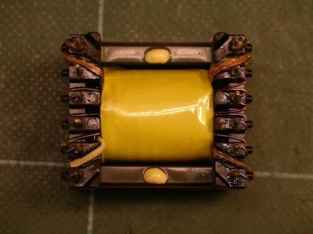

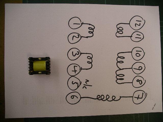

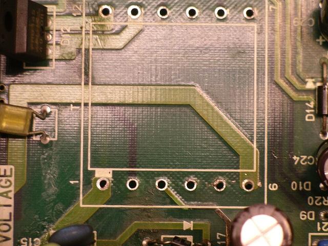

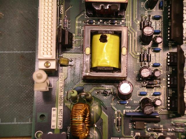

Started in earnest trying to find WHY that track burnt out. It runs from one pin of the transformer so I decided that I needed to pull the transformer so I could hopefully work out its windings and thus the circuitry around the blown track
A/ Transformer in way - remove it!
B/ Clear Board where it was
C/ Transformer underside
D/ That blown track

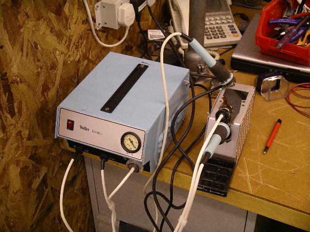

E/ Equipment used to remove the transformer
F/Transformer Diagram
« Reply #112 on: April 30, 2013, 04:42:38 AM »
Removing the transformer was a bit of a pig, as there was masses of solder on the component side that I couldn't get at. Ended up using the "SMD removal" low melting point solder to dissolve it and sucked out ok then! Turns out a single ended winding on the transformer (which presumably is driven as an oscillator at a few kHz)  is being used as a very simple voltage supply as per diagram below. I cannot for the life of me see how this circuit can produce sufficient current to blow the track, as all other components in the cct are ok.
« Reply #113 on: April 30, 2013, 04:45:54 AM »

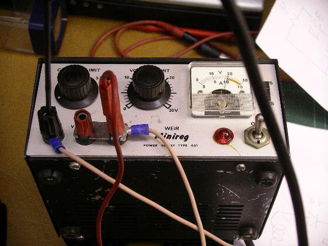

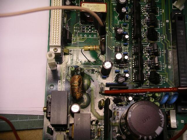

To prove the circuit I lashed in a lab supply in place of the transformer, which allowed me to measure that the (unmarked) zener diode is a 5v one (probably 4.7 actually)
SO HOW DID THE TRACK BLOW?????
A/ Lash up to power it
B/ Lab supply

My pennys worth "Is the transformer primary connected to a high voltage or is the transformer only to isolate grounds" either way have you tested the transformer at high voltage (Flash or 'Megger' insulation resistance test) .
Also can you test the transformer primary drive electronics with a load resistance in place of the primary and use a scope with Differential probes to observe whats going on??
Best regards
Fred
PS you've probably done all this but sometimes a different pair of eyes can sometimes spot the obvious (more to the point I'm not worrying about divorce papers :D)
« Reply #115 on: April 30, 2013, 06:57:39 AM »
Fred, as far as I can tell, remembering I have no circuits of this AC servo drive, two of the three phases are brought into this board, rectified, and chopped, the chopper / oscillator using this transformer as a load (and possibly feedback on one winding). As you can see from its size its a high frequency transformer with I suspect a ferrite core rather than iron. I agree Meggering it is a good idea that I hadn't thought of as presumably the primary is at a few hundred volts.

As I thought the Power supply is to generate on board LV DC supplies and as such the DC level on the primary on the transformer will be floating around 325 volts (SQR 2 (1.414) x 230V AC)  :zap: Be careful!!!
You could wire in an external supply to power the on board electronics and power it all up on the bench first then fit the board back into the system to see if the rest of the system works okay!!- Either way a bit of a risk, I have done it a few times myself.

The machine internally works on 100v AC - there is a three phase transformer bringing my 415v three phase down to 100v three phase. This particular board on the AC servo drive pick off two of the three phases to use as it's source - so probably about 170 volts phase to phase. When I've plotted out more of the circuit of the switched mode converter I'm going to power it from a Variac and bring the volts up slowly as I watch & measure.
Fred: I megger'd the transformer winding to winding with my (ex GPO - shows how old it is!) 500v megger and confirmed that there is no leakage - it was a good idea though - thanks.
This little bit of the circuit is generating quite a few independent supplies some of which I suspect are used on the drivers for the 'H Bridge' output power FETs and as such need to float as the H bridges (two of them as there are two AC servos in the unit) are powered by the rectified 100v three phase. Not really practical to supply external replacements as I don't know what they should be anyway!

And it seems I was wrong - it's 200v 3 phase running around so the input will be about 340v I suppose. Just has a quick look again and the input from two of the phases goes through the usual common mode rejection filter, a 3.2 amp fuse (which is ok) to the bridge rectifier and across the large electrolytic capacitor. There then sadly is a custom hybrid thick film potted circuit so the actual functions gets hazy, but there is a 2SK847 power fet in series with one winding that I presume is the excitation for the transformer. I've dug out my ancient open frame variac, powered it up and checked that it works but now called back in on dog sitting duty while the wife goes out selling eggs!
