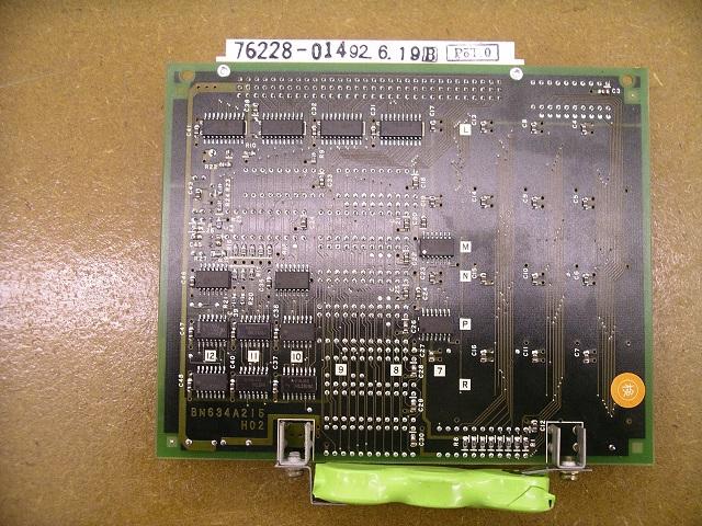

This is the card I'm working on:
« Reply #78 on: April 24, 2013, 05:40:42 PM »
Fortunately I think I've proved the two custom Programmable Logic Arrays to be ok as I've swapped them between the two faulty cards that exhibit distinctly differing fault symptoms, and the faults remain the same. Not absolute proof that they are ok but they probably are.

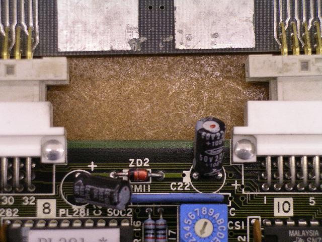

Chips arrived this morning, and I started on the 'easy' through hole SN74LS645-1N - as there are a pair of them I am assuming that they are the 16 bit wide data bus buffers. First one wasn't too bad, but the power pins were a pain as the board has a ground plane and a power plane so it took a lot of heat to suck out the solder. Changed the first, put in a 20 pin socket, whacked in a replacement chip, tried it - unchanged symptoms  :( - anyway onwards and upwards, went ahead and removed and socketed the second SN74LS645-1N. Tried it - symptoms have changed to EXACTLY the same as my other board (which was already packed up to be returned as faulty!). I can only presume as both boards now give the same symptoms the fault lies elsewhere. Looking on the bright side it does look as though I have probably fixed one faulty board to chip level.  :clap:

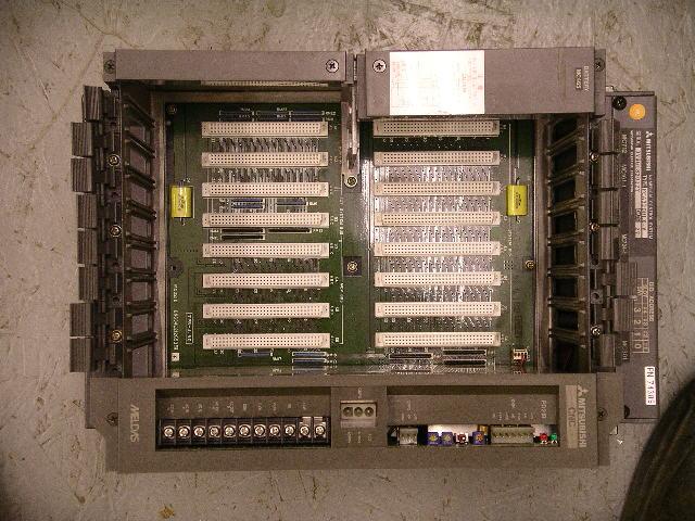

I've reverted back to the 10 slot controller as I cannot overcome the Z58 BRAM failure that I get in the 6 slot. It takes MC465a BRAM cards, two of which give the same failure, whereas the ten slot takes an MC462 BRAM card which has gone in and shows no such issue. I have yet to prove that the input / output addresses appear in the same places and that is tomorrows job with a 'scope and big piece of paper. However I cannot see that the 6 slot is anything other than a subset of the ten slot but I may be proved wrong!
« Reply #93 on: April 26, 2013, 09:12:48 PM »

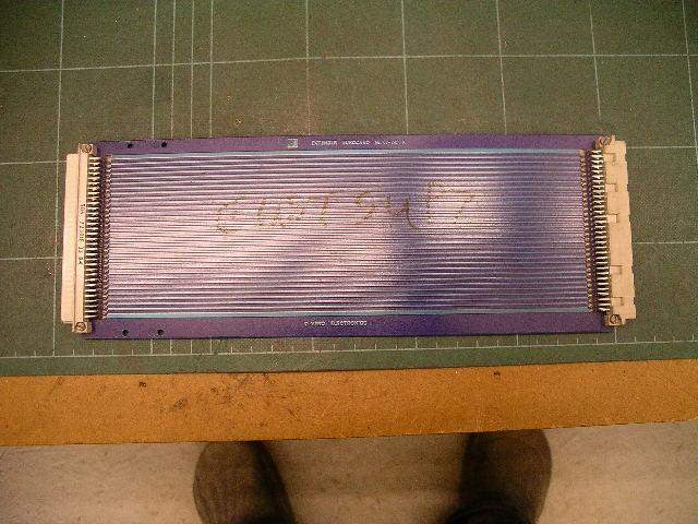

OK I didn't fancy buzzing out all those backboard lines to prove if the slot addressing in the 6 slot was different from the 10 slot as the experts had told me, so I went ahead and tried it anyway. There are two input output cards and a channel card to drive the additional axis:
MC301 has 64 Digit Inputs and 45 Digital Outputs
MC323 has Analogue i/o (not used in this config, and 64 Digital Input and 64 Digital Outputs
MC652 drives an additional daisy chain interface to the V axis (opposing spindle)
Now I can monitor inputs on built in displays on the controller, but I've not yet found how to drive outputs, but my reasoning goes that for these inputs and outputs to feature at the correct addresses so long as inputs on a card are proved to be in the right place, the outputs should also be ok address wise. Now there is a logistical issue testing this - the controller is on the front, and all the wiring is round the back! So I made up a long test lead consisting simply a single pole switch on one end of a wire pair, and a pair of 'bootlace ferrules' on the other end. A '1' is +24V on this system, so one wire was fixed to +24v, and I sequentially removed a selection of inputs from the termination board substituting my other wire. This way I could watch the interface monitor screen, and toggle the switch and watch bits being turned off or on. All inputs showed up in the right places so I concluded that the MC301 & MC323 backboard addressing must be what the system expected. Now for the MC652 card: Each drive (Axis and Servo) talks along its daisy chained bus and gives its status to the system the same way. Each has a rotary pcb mounted hexadecimal switch to set its 'drive number' on the bus hex 0-E are potential drive numbers and 'F' is unequipped - ie servo amp  not used. Sure enough making adjustment to the drive numbers showed up on the appropriate screen of the controller so again I conclude its address as far as the system program is concerned work just as it did before in the 6 slot backboard. So I MIGHT be on a winner. :ddb:
Fortunately all the i/o wires are screwless 'Wago' types that you open and close pushing a fine screwdriver in a  hole, so connecting and disconnecting wasn't as hard as it might have been.

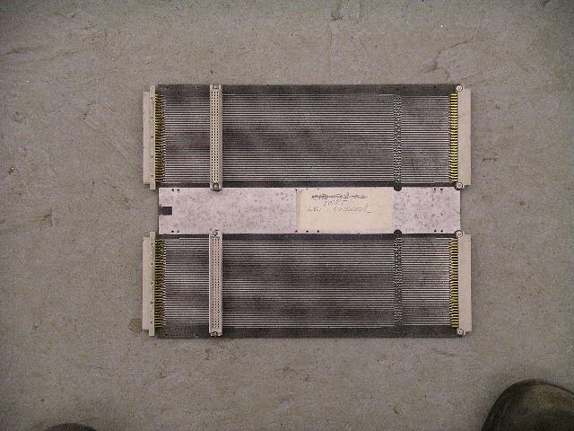

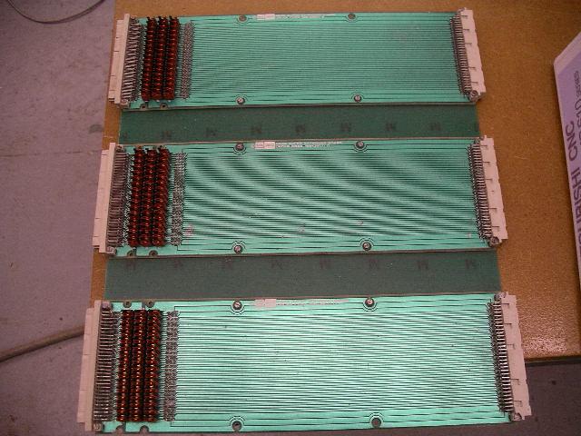

Talking of winners, I grabbed some 96 way din connector extender cards on ebay which arrived today. The system has single connector (half height) boards and double connector (full height) boards. In the photos that follow we have:
A/ Single connector extender - can be used unmodified
B/ Dual connector extender - needs slicing up and the connector spacing adjusting
C/ Tripple connector extender comprising three single bolted together with spacers - I may use two of the element of this rather than slice up B/
D/ a shot showing how close to the required spacing the dual extender is
E/ a shot of the now empty and forlorn 6 slot controller

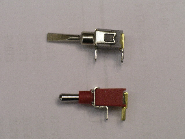

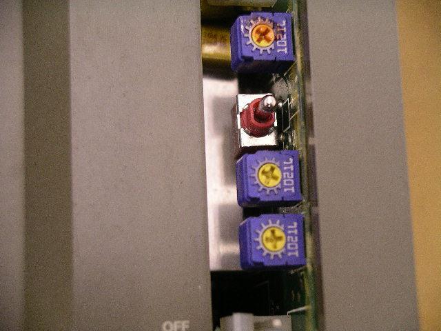

Whilst it was on the bench I set too with the power supply in the 6 slot. It worked fine except that there was a faulty centre biased toggle switch that latches it on or off, which duplicates a function on the operator control panel. It would stay in the on state, so when youb turned off at the operator control panel, it would immediately turn back on! It's an obsolete micro miniature pcb mounted 90 degree bent 0.1" pin spacing with two extra mechanical pins to secure it and an extended toggle. Closest I could find had the right 90 degree bend 0.1 pin spacing but the two mechanical mounts were in the wrong place and the toggle was short :( . A bit of judicious pin bending got it in the pcb (desoldering with the Weller vacuum sucker worked a treat this time). I reckoned to glue a tube extension to the toggle when re-assembled but in practice it's ok.
Hopefully I can set up a test bed with this 6 slot and the extenders - anyway some pictures:
A/ Old and new switches
B/ New in situ
