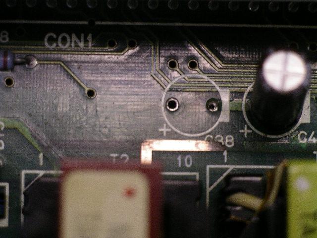

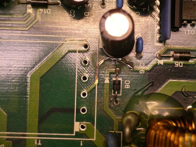

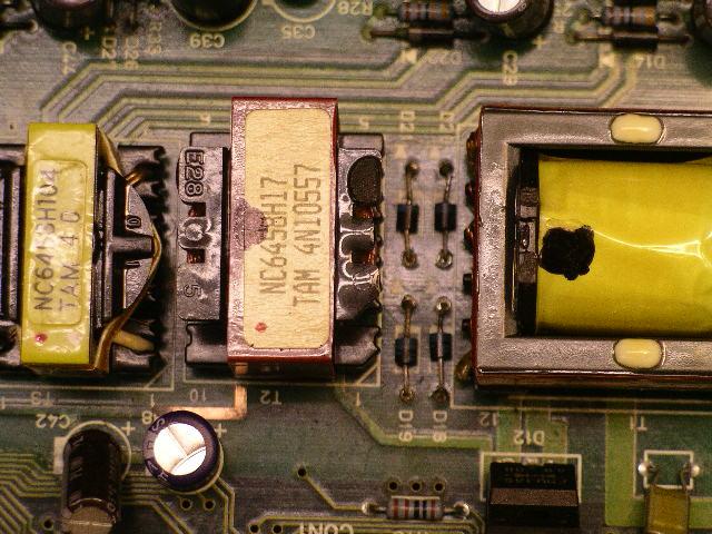

OK I had a few minutes so escaped briefly to the workshop for more investigation. More close scrutiny of the board revealed an overheated track and a blown capacitor (35v 68uF) with one leg burnt off! How I didn't spot it before I don't know. Bit more tracing shows that the overheated track, although it goes very close to the blown up capacitor, isn't connected to it! In fact this track snakes around ending up on the output of a 7915 voltage regulator a few inches down the board. I decided to take my chances and, having replaced the blown capacitor (with a 35v 100uF as that's the nearest I had to hand), returned the transformer to the board, and linked the originally found blown track, connected up my ancient (probably lethal) open framed Variac, set it to half normal input voltage of 100, and powered up. No smoke, no smells, nothing got hot. Slowly wound it up to 200v and again no dramas. Gingerly started probing around (everything is floating at a high voltage). That 5v Zener diode in the hand drawn picture a few posts ago actually had 5v across it, and from my reading of the circuit that can only happen if the thing is oscillating and driving the transformer. Somewhere down the line there are two 'standard' voltages regulators, a 7815 (+15v) and a 7915 (-15v whose output track had overheated but not blown) - neither are giving outputs so something is still wrong. I need to poke around with my oscilloscope, but need first to work out what I can use as a common earth - a job for tomorrow.

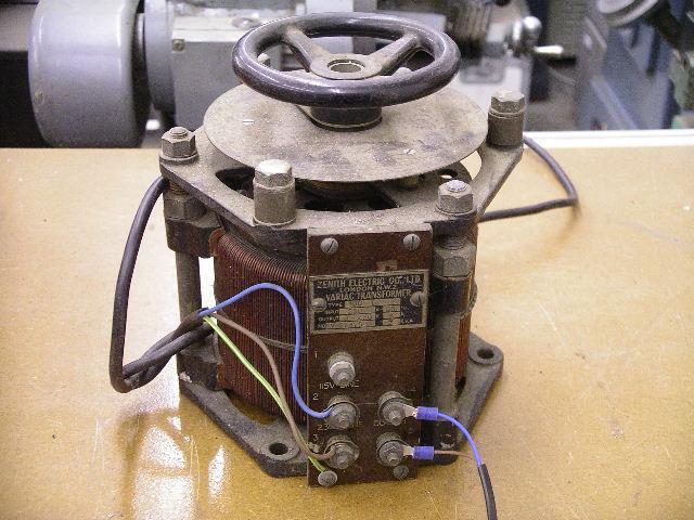

Incidentally, with a 200v input, the large reservoir capacitor is charged up to 295V
Some pictures:
A/ Second burnt track and adjacent blown capacitor
B/ Capacitor removed
C/ Original blown track linked
D/ Lethal Variac - don't try this at home children  :bugeye:

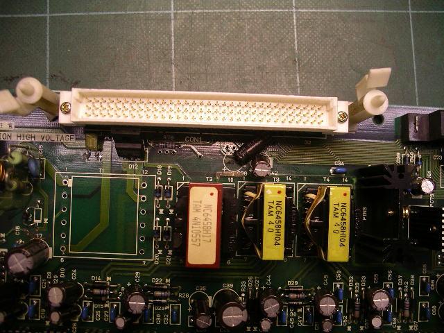

It seems that the transformer I removed, previously, one coil of which is definitely driven by the FET off the rectified mains, also drives the other two transformers on the board, EACH of which provide four isolated + & - supplies. The first transformer also has one winding giving the 5v supply, another giving about 25 - 0 - 25 which goes to two 'conventional' series regulators, a 7815 (+15v) and a 7915 (-15v) both of which I had removed as at least the -15v one had blown up due to a blown capacitor on it's output. Tonight I decided to load the 5v supply with a 0.5 amp load, expecting it to drop like a stone. Not a bit of it - rock steady at 5v bang on to the nearest 10mV. This lead me to replace the 7815 (as I had one in stock), but to my surprise it only gave 7.8v unloaded, meanwhile the 5v supply was motoring along getting my load across it nice and warm !
So a few tentative conclusions:
A/ The DK-466 may not be faulty after all
B/ Either something down stream of the 7815 is heavily loading it, or there is something odd about the rectification from the transformer on this winding. Tomorrow I'll pull the 7815 out again (lucky I have a drawer full of them!) and load it's input independent of it's output circuitry and see what's amiss.
anyway it's sort of progress

Just another thought but does the machine have any more of the same pcbs on the other axises, if yes why dont you set another one up on the bench and have a careful probe around with the scope to get an idea of how its working. :med:
Best Regards
Fred
« Reply #134 on: May 02, 2013, 10:08:24 AM »
Fred: yes it does, and that's a good idea, though it's an absolute pig to remove it.

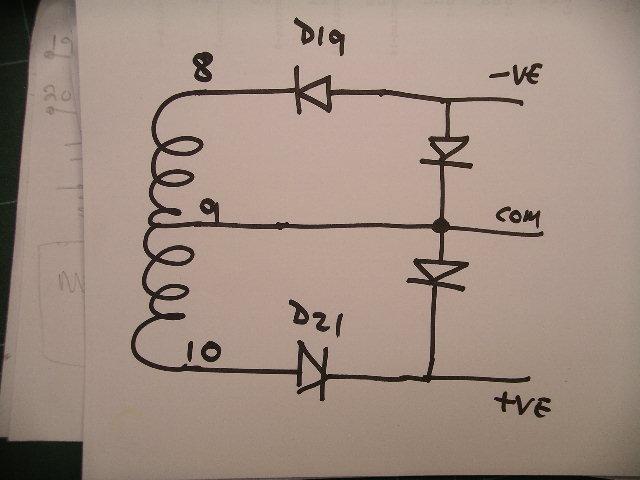

OK results of a bit more poking around: Firstly see the very simple circuit I'm working with:
« Reply #135 on: May 02, 2013, 10:24:16 AM »
I would say that one of the two little springs on the left have broke :D
« Reply #136 on: May 02, 2013, 10:27:07 AM »

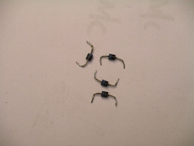

Now apart from the fact this is running at about 25 kHz there's nothing complicated there is there ? The positive output feeds the input to a 7815 regulator (+15v) , the negative output feeds the input to a 7915 regulator (+15). Both via a 'choke' winding on T2. Each rail has an electrolytic capacitor of 68uF and a 1 nF polyester capacitor from rail to common. Now bear in mind BOTH regulators have been removed for testing. Also bear in mind that these regulators are each rated at one amp, and are mounted on small upright heat sinks, so presumably are expected to be delivering at least a 100mA or so.
Right, so there is no load on either of the outputs as the regulator is removed - voltage from common to+ve is about +42v, and to -ve is about -35v so in the ball park of where you'd expect. If I load either of them with a 22k resistor, so only drawing perhaps 2 mA, the voltage drops to 12volts :doh:
High resistance transformer winding perhaps? No it measures virtually zero ohms. Dodgy diodes perhaps. Well very possibly. They only bear the marking "4L" with the cathode marked with a blue band. They may be some exotic species - quite possibly schottky  fast recovery ones? I tried replacing them with 1N4007's from stock but only got about 12v out, then I tried 1N5819's which are the only schottky ones I have in stock, with the same result.
So what the heck is a '4L' diode?  Poor things have been in and out of the board four times now.
Here is a picture of the little darlings, out and then back in the board.
By the way I had the second transformer out of the board to trace it's windings and it seems it's being used as a choke, three windings, each in series with a rectified transformer output.
« Reply #137 on: May 02, 2013, 10:34:41 AM »
I should add that I have, with the power off, applied a lab supply to the +ve output of the circuit, and wound it up on minimum current limiting (20 ma) up to 20 volts. Repeated this on the -ve output, and also done it on the outputs from the regulators up to 15v (they are not in circuit), and am able to raise each rail to the set voltage drawing virtually nothing from the lab supply, so nothing is breaking down (other than perhaps me!) and limiting the voltage.
I remain confused, though it may be those diodes if I can find what the 'ell a 4L is   :bang: :bang: :bang:

what does the volts say with a scope  instead of the DVM
evan my mk8 played merry hell with the voltage reading that had a say 20khz wave form , bear in mind I used to mess around with 432 mhz and 1.3 gig   1kw of the former and 100w on a good day with 1.3 gig my tuned cavity seem to dislke moisture in the air
had a quick look in my ancient data book no joy I am afraid they are not quite on velum but very near
Stuart
« Reply #139 on: May 02, 2013, 11:31:51 AM »
I've only been measuring DC levels as quoted - my Avo & fluke both run out of steam at these frequencies and the 'Scope of course raises issues of the circuit 'floating' at a few hundred volts.
I did try measuring the ac output of the transformer whilst the diodes were removed, but it gets increasingly hard to interpret the results - I gave up when the 'scope  (Tektronix 465) internal DC fuse blew  :bugeye:

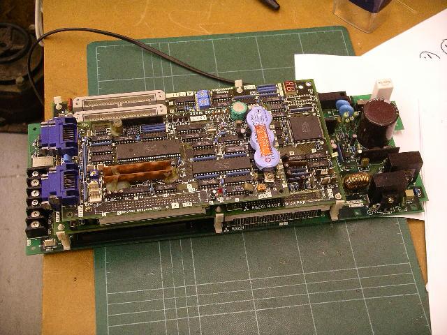

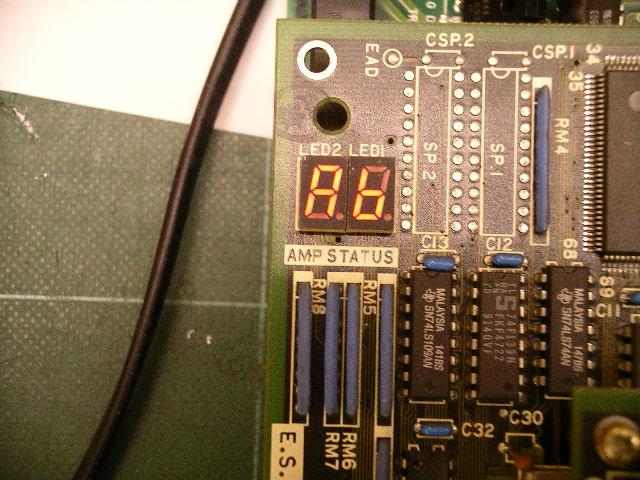

« Reply #149 on: May 04, 2013, 06:09:01 AM »
 :ddb: :ddb: :ddb: RING THE CHURCH BELLS  :ddb: :ddb: :ddb:
 :clap: :clap: :clap: Let everyone have Monday as a Holiday :clap: :clap: :clap:

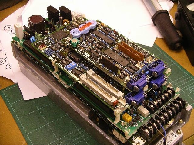

Postie brought the 7915 today, I rapidly installed it and - plugging the logic card and option card into the intermediate power board (which had the fault) ...whoohay :  we get "A6" which is "OK I'm here, now talk to me"
Pictures:
A/ Logic card loaded on, powered up showing "A6"
B/ Overview of same
C/ Re-assembled on high power chassis and still "A6"
