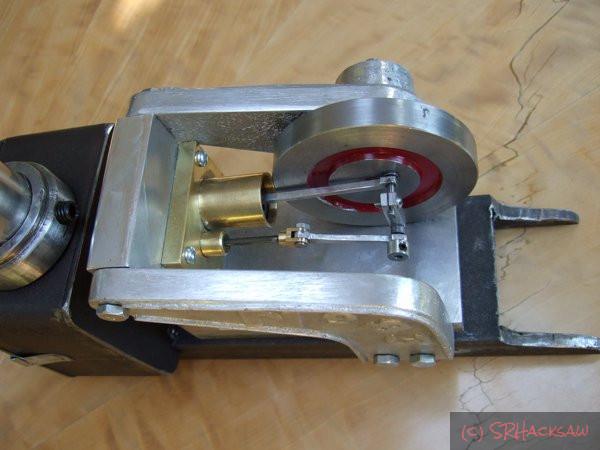

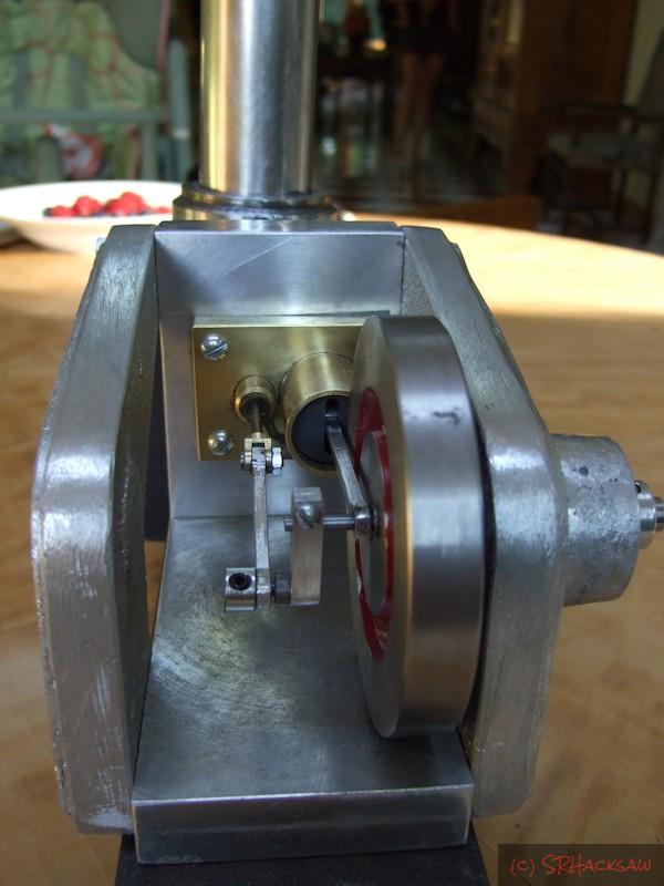

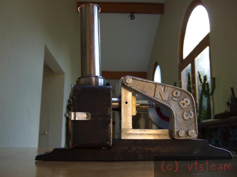

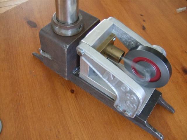

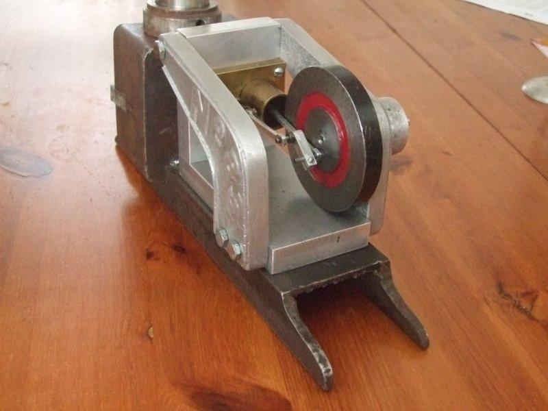

Eighteen years ago for my father's 83rd birthday, I built a hot air engine using my own aluminum castings, skate ball bearings, a graphite piston, and many borrowings from my scrap pile. It was a very rushed 2 week project, since I had little idea of the complexities I was getting myself into. I worked long into the nights. Nevertheless I finished the little engine the night before leaving to see him, and got the bare engine to run, rather impressively, by heating the displacer cylinder over the kitchen stove. I quickly added a channel Iron base, a firebox out of square tube, and a smokestack out of a brass sink drainpipe. The firebox even had a door.
When visiting him a few states away, I brought a small can of Sterno as a heat source, and this fit into the firebox, and luckily was enough to power the engine as well, running steadily. All was well!
Because we had to return home the next day, I took some pictures of the engine on a rather fancy table. The engine was named "No. 83" in honor of my father's birthday. Those photos were all I had of the engine for many years, and I really regretted I didn't have more time to run it, improve it, and try out the many ideas I had as experiments. In fact the original intention was to run it with wood as a fuel, and the firebox and stack were built with that in mind. But that never happened.
Not to go into too many personal details but my father later had a bad fall, was hospitalized and sedated for a week, lapsed into partial dementia, and my brother, an heroin addict and ex-con, took over his life. My father passed away, and my brother took everything, including the little engine. That was the end of it, so I thought.
My nephew, a kind person, recently returned the engine to me after his father, my brother, had also passed. It had been 18 years. My brother had pronounced my engine non-workable after trying and failing to run it once for my father. He had no concept of what a hot air engine really is or how it works. After my father died, my brother had left No. 83 in the corner of a garage on the bare concrete to rust.
The .008" walled displacer cylinder had been overheated and ruptured. The fire door was missing. No. 83 was in sad shape.

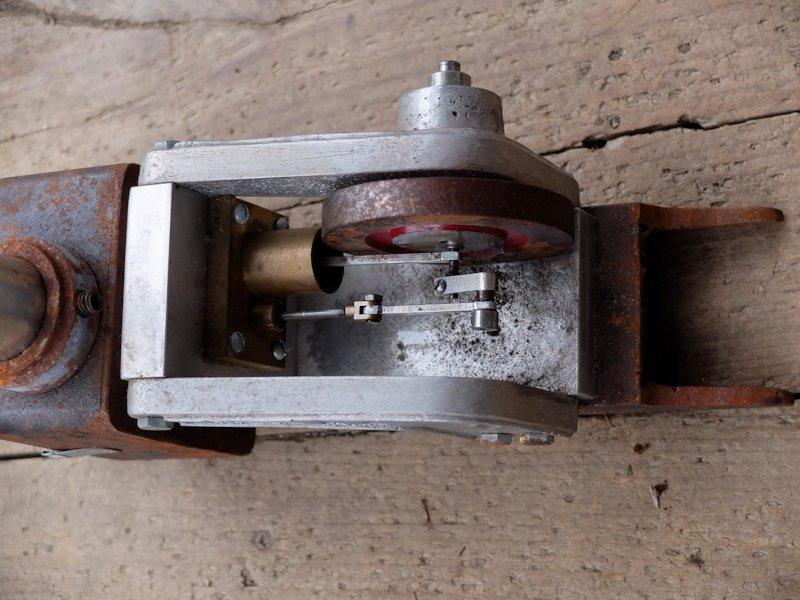

re. No 83: Well as a start, I cleaned the outer engine with mostly just soap and hot water and a 3M Scotchbrite pad. That felt a lot better!
Then I took apart the linkages, cleaned them and put them back together. No telling whether it will run again without replacing some of those parts. But for the moment I think I'll try with what I have.

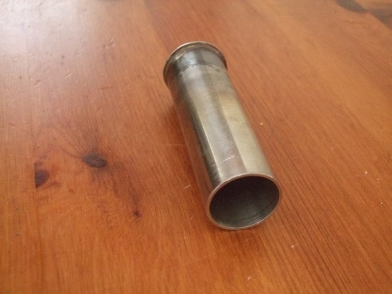

I had a piece of stainless steel tubing a friend had given me long ago -- I think it was from a sailboat stanchion. Anyway it measured on the OD the same as the ruined displacer cylinder. Probably the same piece of material I used for that one. I just don't remember. So it will be a natural fit into the engine -- I have about a foot and a half of that stuff left. So I cut off a piece the right length, and cleaned up the ends in the lathe, and then silver soldered another thin piece of stainless steel sheet to the outer end. Then I chucked it back in the lathe and bored it out to what the old displacer cylinder had been.
This is quite a bit thicker walled than the old one was. It's .047" while the older cylinder had a wall thickness of only .008" at the hot end! (The cold end was full thickness, also ~.047", so the mount in the massive bulkhead/heat sink will be the same).
Turning the hot end down that thin was very tedious. Eighteen years ago I had turned it between centers using tiny cuts. The cylinder had been jam-mounted onto a carefully turned oak dowel arbor, to give it support.
I'm anxious to see if the engine works, so I'm just going to try it as-is. I can always turn it down in thickness in future. I hope it will at least run okay without the thinning, just not at maximum efficiency. Or maybe it won't run at all, for this or other reasons. We'll see.....

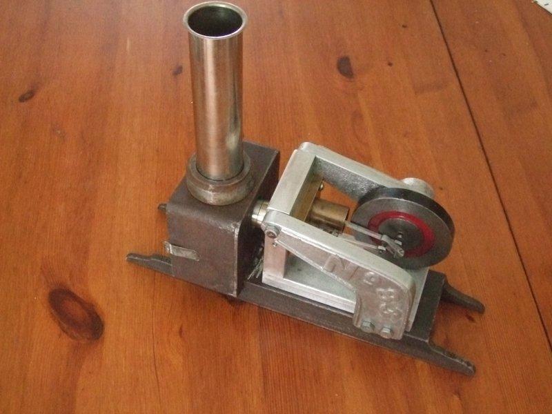

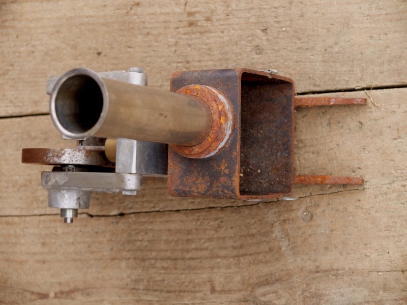

Well first evidence of clueless tampering in its past history. There are two allen screws (grub screws) holding the old displacer cylinder into the massive vertical aluminum bulkhead. They are situated 90 degrees apart. One comes in from the bottom of the bulkhead, and one comes in from the side. Well one of those screws was missing, and the other one seemed stuck (was it cross threaded?!)  :hammer:
Design note: I had originally hoped to mount the cylinder as a press fit into that bulkhead, but had bored it .002" oversize by mistake. I had wanted good heat transfer into the aluminum as a cooler hence the press fit. The remedy, since time was so short on this original birthday present project, was to immobilize the cylinder with the allen screws, after applying electronic heat sink compound to the bore to allow good heat transfer.)
Anyway, what to do about the stuck screw deep in the bulkhead? Well since the old cyinder was defunct anyway, I was able to pull it out, with some scratches -- but it was destined for the bin anyway. Luckily with the cylinder out, I was finally able to remove the stuck screw. Phew!  :med:
But when I tried to slide the new cylinder in place, It wouldn't go. What the heck? They were the same exact OD.
After taking a careful look at the bore, I notice what looked like the tip of the same grub screw I had removed, still in place. Another one? Well yes, mystery solved!  :smart:
I unscrewed that one, and could finally slide the new cylinder in place. Two screws had been put into the same hole. That explained the missing one from the other location 90 degrees away. Somebody had had the engine apart and then, uhhhhh... screwed it up. That would also have slightly changed the cylinder location from when originally tested. And possibly the angular alignment. It would also have allowed a little play, which is why two 90 degrees apart were originally intended. And jamming two on top of each other can make the top one hard to extract.

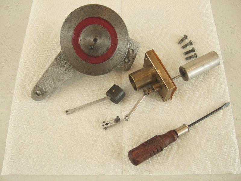

Piston and cylinder apart.
The flywheel spins VERY freely for more than a minute by itself. The displacer slides easily in its bushing. But the graphite piston and cylinder do not.
(Later):
Somebody oiled the piston!  :wack: It's not meant to be oiled. That completely defeats the purpose of a graphite piston!
I was wondering what kind of oil they used. Maybe even kitchen vegetable oil, heaven forbid....  so I smelled the piston. It must have been "3-in-1" oil -- I remember that smell so well from when I was a kid and we were working on our bikes. Well I still have an old bottle of it. So distinctive.
I guess the friction problem was 18 year old oil sludge absorbed into the graphite of the piston. So I just washed the piston with dish detergent in hot water.  And the brass cylinder as well. And now they are VERY free running together. Plus, the compression is back.
I can locate the piston and the little aluminum connecting rod in the cylinder held vertical and they fall right through under their own weight -- which is tiny. But if I put my thumb over the end, the piston stays suspended indefinitely because of compression, until I remove my thumb.
That's a big relief. I thought I might have to make a new piston.

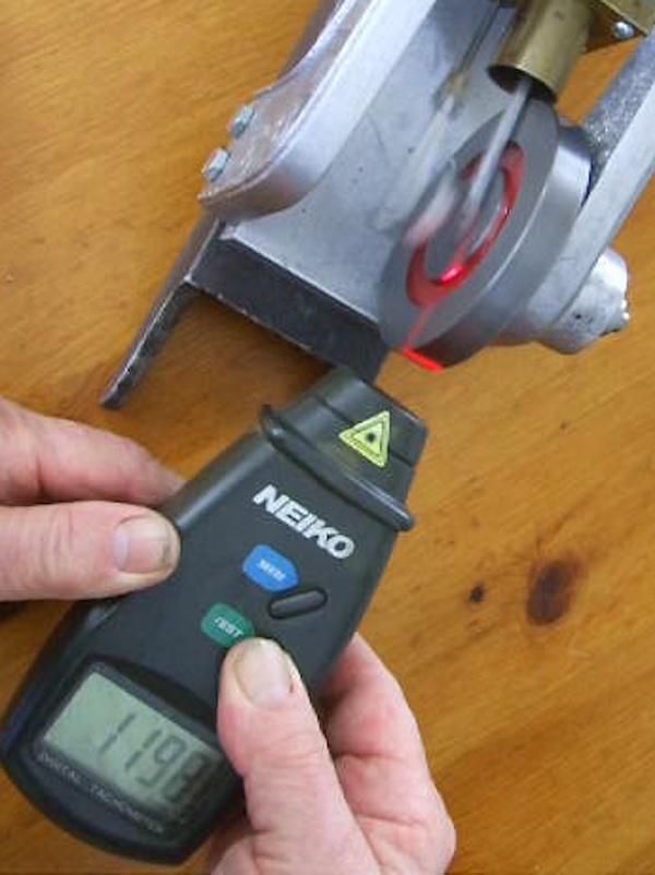

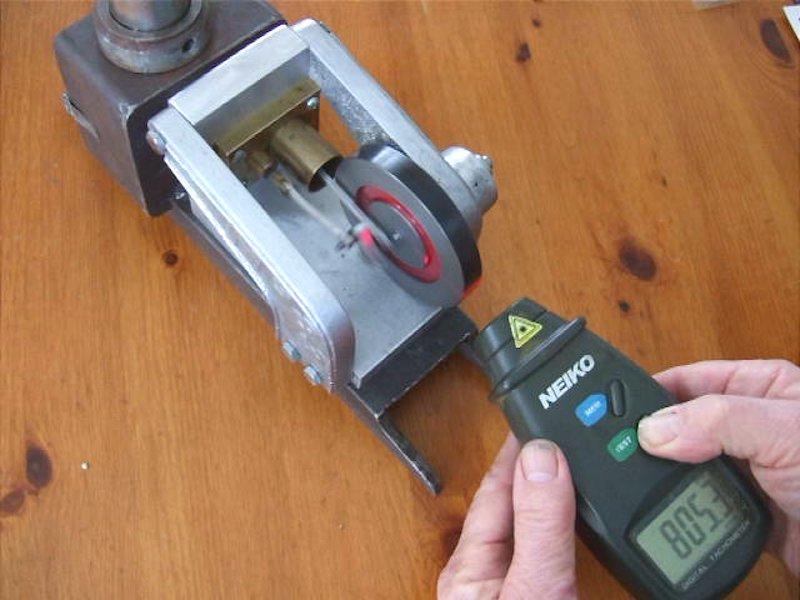

Found the optical tach. Had to charge some penlight batteries for it, but it's working.
So, 800 RPM on No. 83, which is gratifying to see. It 's an impressive running engine. That flywheel is pretty massive, and it's fun watching it slowly come up to speed and then maintain that rate. It does seem to take nearly 5 minutes of heating (using sterno) before it will start, which seems kind of long. I'm not sure why it shouldn't start sooner. Maybe the thicker wall of the new displacer cylinder. I think I'll make another one.
Well anyway, she's running well now and I'm happy! All these years I wondered about it  :scratch:
I keep running it, then stopping for an hour or two, then starting it up again just to see it go. It's just fun!
Top RPM is very consistent at about 800 each time.

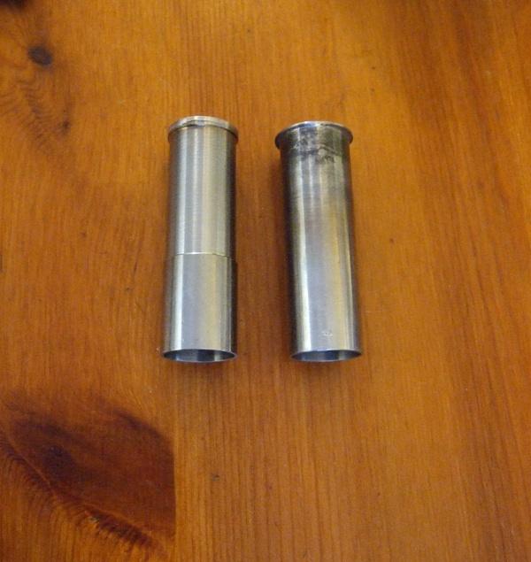

I made up a new displacer cylinder this afternoon, same bore but with sides at the hot end thinned from .047" to .014" (1.2 to 0.36 mm).
The older recent cylinder is shown next to it.

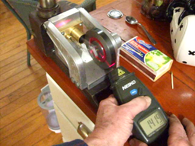

New displacer cylinder: 1400 RPM!
Linkages a blur.

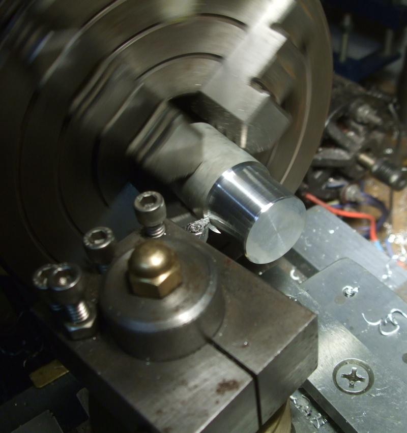

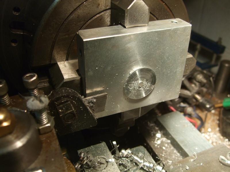

Today I decided to sleeve the existing oversized displacer cylinder hole in the bulkhead. I made a decision to change the cylinder mount method. Instead of press fitting the cylinder in place (or holding it with grub screws in an oversized hole), I'm going to mount it with a flange. This will allow easier replacement when experimenting. It will also allow easier alignment of the bore, and it will give better cooling at the cold end.  Part of the working bore will now be in the aluminum bulkhead, rather than inside a stainless steel section situated in the bulkhead.
To do all this I need to make a plug sleeve out of aluminum, and press that into the bulkhead. Here's the start:
  • Posts: 6835
Re: The Return of No. 83, a Hot Air Engine
« Reply #23 on: February 28, 2025, 09:05:44 PM »

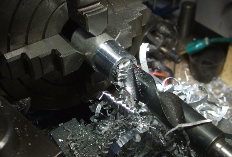

Drilling out the plug:
  • Posts: 6835
« Reply #24 on: February 28, 2025, 09:09:17 PM »
Pressed into the bulkhead:
