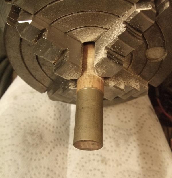

I was looking forward to working with the graphite this afternoon, but in measuring the cylinder to get a diameter for turning, I just didn't like what I found with a telescopic gage. I still had a small amount of oval, and taper. Also I didn't like the cross hatch finish, which was more appropriate to an IC engine. I tried lapping again with the lap I'd made earlier. But it was too small, and I didn't have enough adjustment to compensate.
I don't think I like an aluminum lap. The engine had been originally built with a lead lap that I'd cast onto an arbor, then turned to size. It made a great lap, and the abrasive bedded well, and it gave a really nice finish but I don't like working with lead any more. So I decided to try a wood lap.
I had a turned piece of oak that I'd earlier used as an slip fit arbor for thinning one of the displacer cylinders. I turned this down to just undersize -- a tight slip fit really on the power cylinder, and then charged it with abrasive and kerosene (parrafin oil). Here's the lap as used, it took off lots of fine brass:

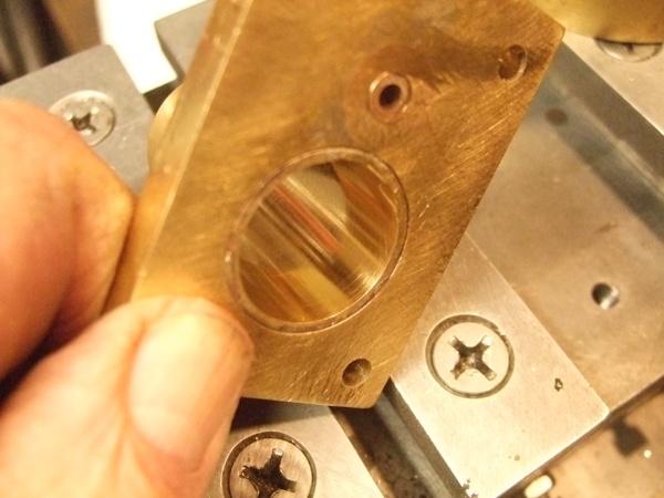

I spent about an hour lapping and measuring. The oak lap did a really great job of straightening out the bore, and it also left a really fine finish, very unlike the aluminum lap. I used the same valve grinding compound with each as an abrasive. I can't account for the difference, but I'm definitely convinced oak makes the best lap on a cylinder of this size and type, and very easy to make. I haven't tried any other hardwoods. I don't think softwood would work as well, but haven't tried it.
I could see a reflection in the finish:

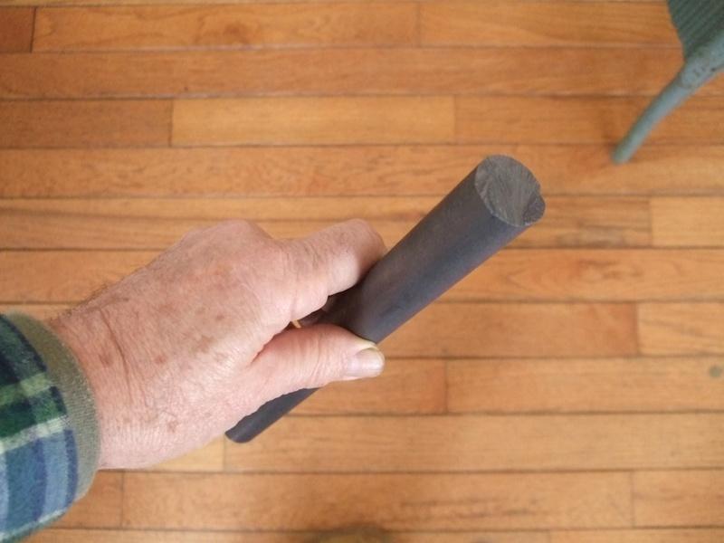

With the cylinder lapped, it was on to the graphite piston. I had to cut the rod in half so it would fit in the spindle behind the chuck. I faced the end and started turning. I think I like the quality of this latest graphite even better than the original piston. It seems finer grained and more slippery. It cuts like butter, and it was only three cuts until I was at final dimension -- a hard slip fit for the cylinder. I'll lap the piston to a sliding fit later with a scrap of newspaper - that's all it takes.

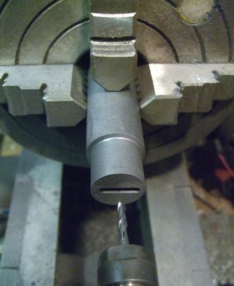

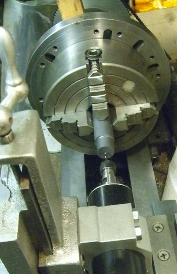

Then it was time to set up the vertical milling attachment, with a milling spindle to cut a cross slot in the base of the piston, where the connecting rod will go. It was getting late, and I hadn't set up a DTI for depth of cut yet, so I decided to wait until tomorrow to complete the operation.

This morning I measured everything carefully, and decided to lengthen the piston by 80 thou and move the wrist pin further forward to compensate -- mainly to reduce the tendency slip stick in the cylinder. I slotted it .5" wide using the mill spindle in the milling attachment. That went really well.

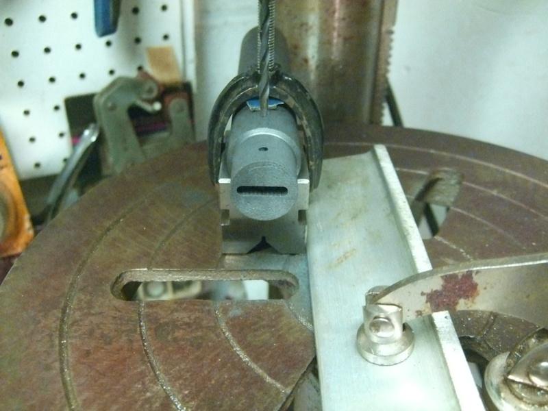

Time to drill the wrist pin journal. I didn't have a way (yet) to do that with the milling spindle. It's not yet possible to mount the milling attachment 90 degrees to the slots in the carriage. To do that I'll have to slot the present milling attachment's mounting holes to fit the table spacing.
But, no problem, we'll do it in the drill press.
I centered a chucked drill bit in a vee-block, then clamped a scrap of aluminum as a fence against the block. As long as the vee-block is tight to the fence, it will present its center to the drill bit. But it can slide along that fence. Then I clamped the graphite blank in the vee block, using a bit of cardboard under the clamp to protect the blank.
I checked the height of the piston slot to the drill table at both sides to ensure it was horizontal. Then I marked the top of the piston where I wanted to drill the journal hole the proper distance back from the end.
Then it was just a matter of sliding the Vee block along the fence until the mark was centered under the drill bit, and the hole was drilled.

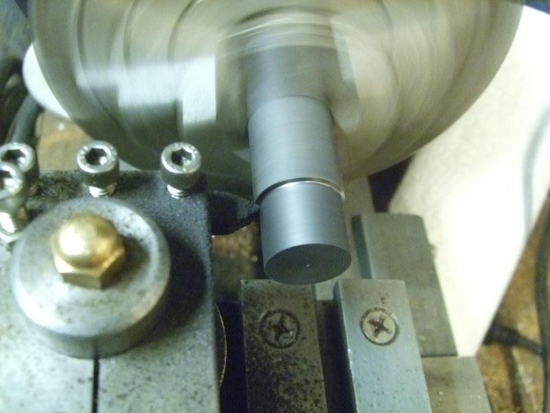

I returned the blank to the lathe and parted off the new graphite piston. I probably shouldn't have pushed that all the way, and sawed the last little bit off with a hacksaw blade because it broke a chunk off. Luckily that came out of the blank instead of the piston, so it was easily filed off.
Final step was to ream the journal to size and install the con rod.

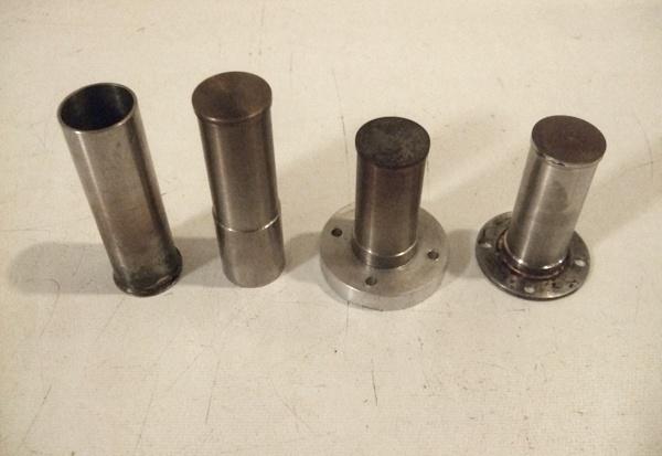

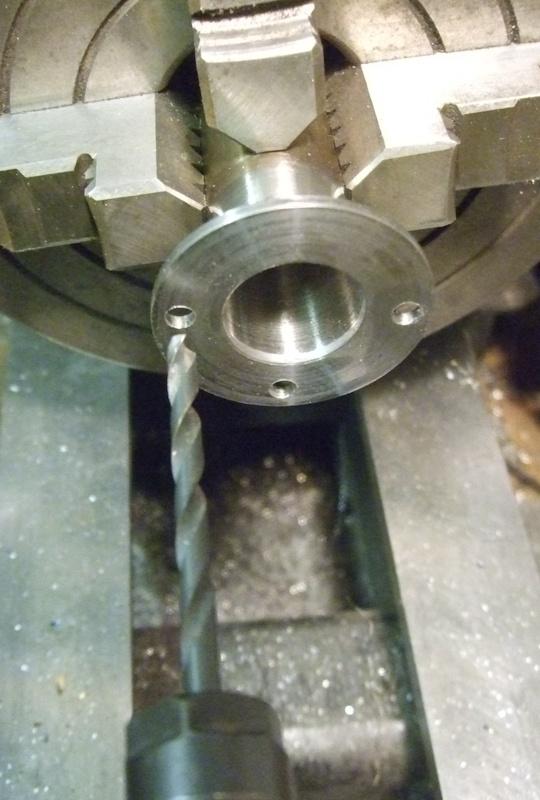

re. No. 83, I started on a fourth displacer cylinder today.
It features a thinner steel flange, compared to the last version's thick aluminum, and a reversion to a stainless steel end cap instead of a copper one. I wanted to try go back to the performance of my second cylinder, if possible, by removing some of the added variables.
So far, I've made 4 displacer cylinders, lined up here to show the differences. The first was just stainless steel tubing. Top RPM was around 800. The second had a thinned down wall thickness, and average speed was around 1400 RPM it did hit 1600 rpm on one run. The third cylinder had a changed mounting method. Instead of passing through the aluminum heat sink, it had a flange and mounted outside of it. It ran about 1300 RPM. An improvement in bearings and a sealed leak and removal of a frictional interference produced a max speed of 1440 RPM.
The 4th is a reversion to the second cylinder but with a flange mount.
