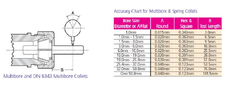

OK I've found the Crawford specifications for these collets and it seems that my 15 microns is within specification - seems rather a lot to me  :bugeye:

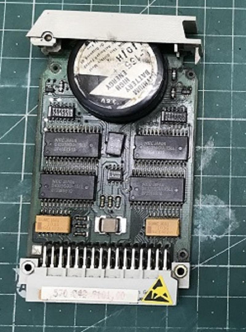

All enthusiastic I've recently re-measured and drawn up a pull stud for the tooling of the Beaver Mill, to be made on this Beaver TC-20 CNC lathe.
Going to the machine to review tooling, and powering it up there were odd and unfamiliar humming noises and the machine wouldn't go 'Ready'  :bang:
Now over the last few days we have had masses of rain and some very significant lightning - though not (I'd thought) very close.
So far I've spent a couple of days on the diagnosis trail and found a blown up memory card. Fortunately I had a spare, and now at least the controller is going ready.
At this point I've been able to load back ups of the PLC program and the other gubbins - in fact I've been through the process FIVE TIMES  :bang:
However, although I can 'reference' the machine, jog in X & Z, rotate the tool turret and select a tool, I cannot start the main spindle. You may recall this is driven by a vast Maudsley DC motor by a KTK DC drive and a propriety field current source. If I program a modest spindle speed (say 100 rpm but it doesn't seem to matter what) there is a slight increase in hum level but no rotation, and after a few seconds it errors with 'spindle speed too high' !
Putting a DC clamp meter on the field drive it's passing a reasonable 5.9 amps. Transferring it (On AC) to the feed to the KTK driver for the motor, it briefly is drawing about 40 amps (at 120 V 3 phase) before erroring.
The othere oddity is that one of the files that's been re-loaded (several times into RAM) maps PLC error and comment numbers to text, but despite this the controller is reporting the number and not the cross referenced scrap of text.
Now this controller has bits of ROM  and bits of RAM in several places and I've never satisfactorily managed to map what is supposed to be where - the manuals are as vague as a salesman's promise!
The spare could be faulty of course and explain both issues, but I seem to remember previously using it. There is another for sale on eBay at a reasonable price, but the postage and customs duties from the US are crippling :
https://www.ebay.co.uk/itm/130842358746?ssPageName=STRK%3AMEBIDX%3AIT&_trksid=p2060353.m1438.l2649
(This is one of the cards that were destroyed before I got the machine by oozing lithium battery juice, and indeed is the same as the card that was the source of he leak!)
. . . decisions . . . decisions  :scratch:

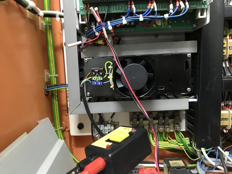

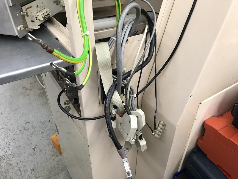

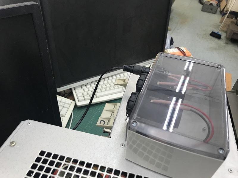

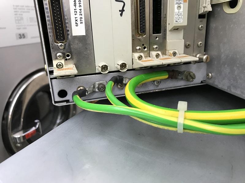

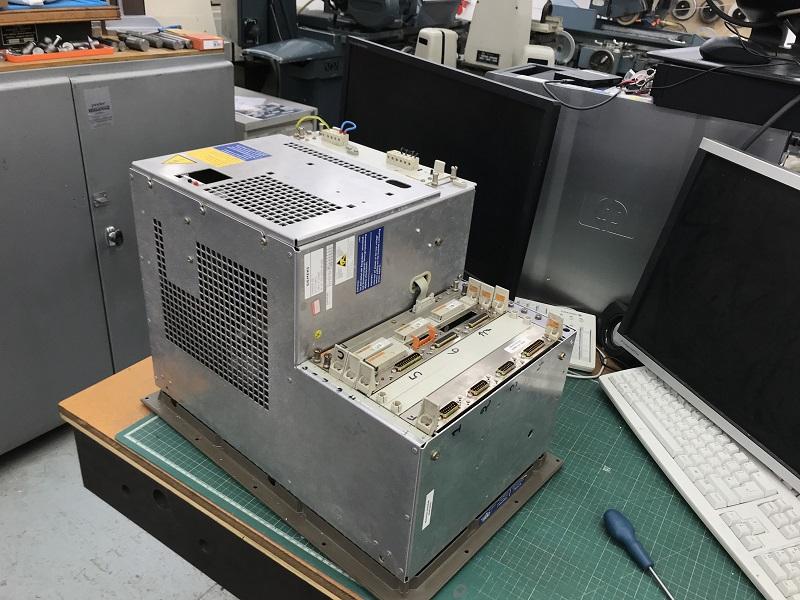

Meanwhile I have extracted the entire 820T controller from the rack for easier working on the bench. I seem to remember that when I first got the controller to come back from the dead when I got the machine, I was able to bring it up to 'Initial Clear' mode on the bench and only wired to mains - hopefully eventually I can repeat this  :scratch:
Frustratingly I cannot find my 'Lab Book' covering that initial resurrection period (I try to keep notes on the more complex bits) - my current book only starts at 7th Sept 2018 yet the controller was up and talking to me by 21st June 2018. It's somewhere, it's A4 and blue - but WHERE  :scratch:
Meanwhile some pictures I took really to make sure that I know where things go when / if I ever get it going again:

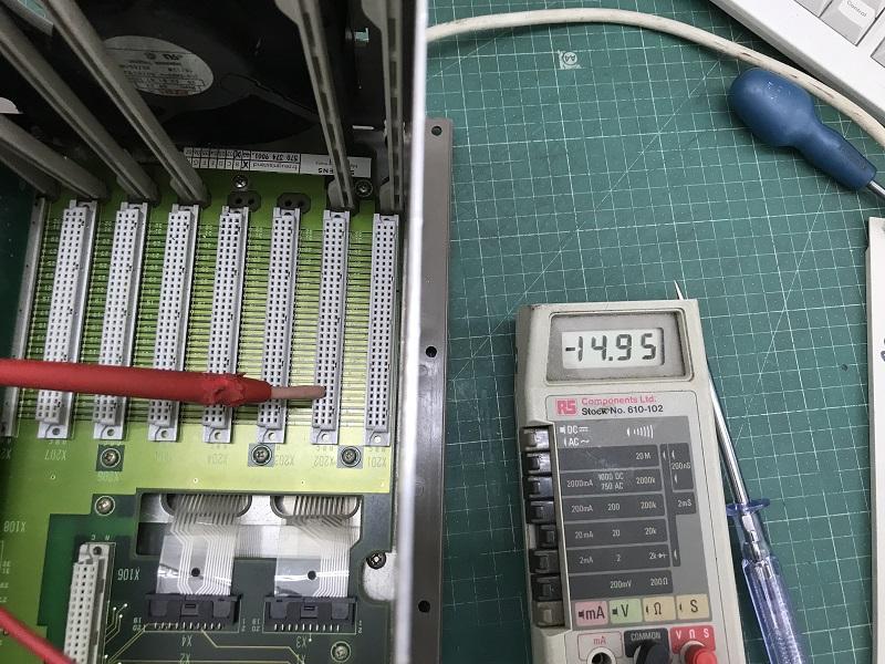

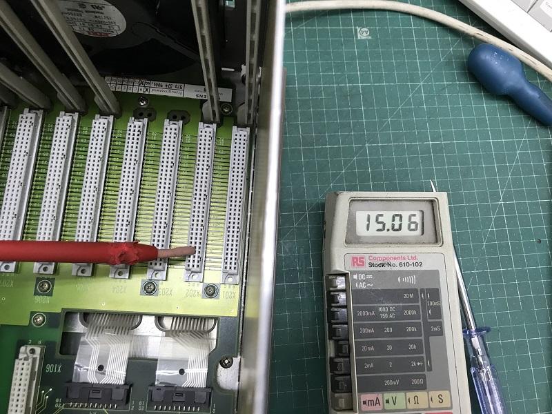

« Reply #1156 on: July 30, 2021, 09:44:15 AM »

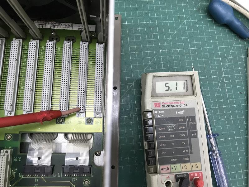

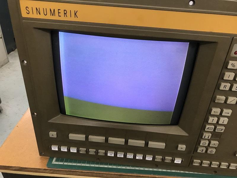

Pulling all the cards (except the two video cards) out of the card cage the screen is still blank, but with the ribbon cable from the video logic cable to screen unplugged the screen shows white scan lines.
(Screen is actually all white - the green bit is something to do with the camera and scanning)
According to the book of words the screen takes RGB TTL levels from the video-graphics card so I need to scope it and see whats what. No time at the moment as cottage guests due any moment.
However I HAVE managed to prove that the +5, and +/- 15 volt supplies are making their way along the back board - I actually found the original leads that I'd soldered wire wrap pins to back in June 2018 !

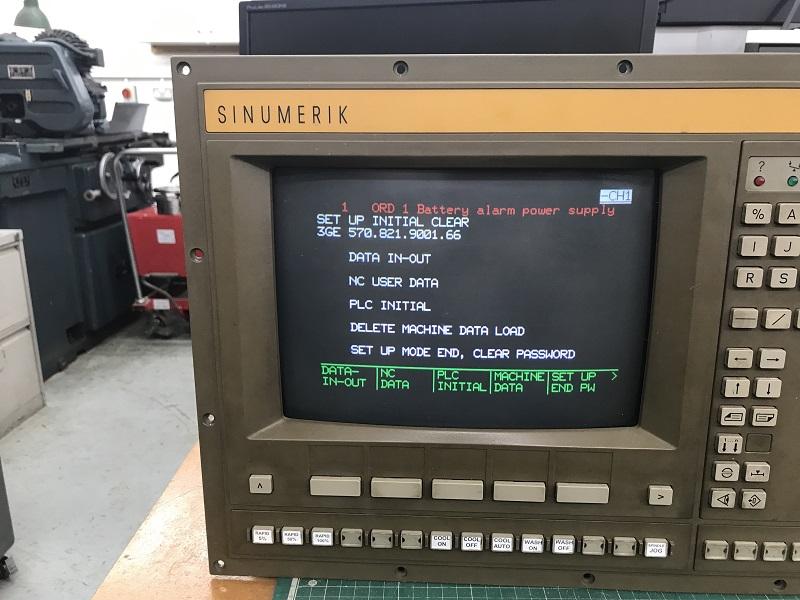

« Reply #1159 on: July 30, 2021, 03:29:04 PM »

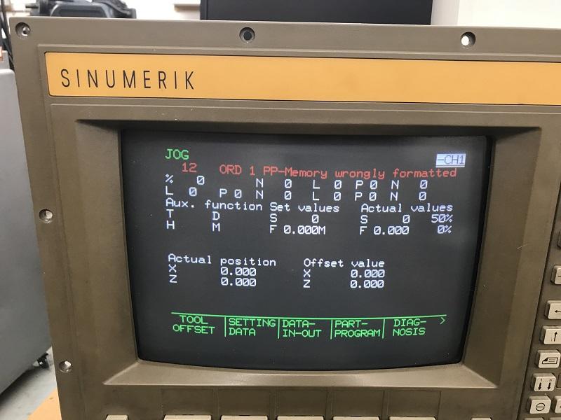

Well, positive developments, but I don't know why !
I came over to the workshop this evening to set the scope up to look at the backboard bus. I have no diagrams but it's amazing what you can deduce of card activity if you are persistent.
But I thought, just because I could, I'd return the cards to the card cage and see what happened. Darn me it comes up talking to me! Now it's reporting a "Battery Alarm Power Supply" which isn't surprising as the battery is disconnected !
Plugging back the (modified and remote) battery it now comes up "Ord 1 PP-Memory wrongly Formatted" which is probably not surprising - be good if I knew what 'PP-Memory' was but never mind - I now have a means of diagnosis as I can SEE things on the screen.
. . . life is full of mysteries . . . :scratch:

« Reply #1160 on: July 30, 2021, 03:44:27 PM »
Apparently "Part Program Memory"
(Thanks Google  :wave:)

« Reply #1162 on: August 01, 2021, 06:17:25 AM »
Possibly Graham, but I'd be surprised.
The other day I carefully returned all the cards to the card cage and temporarily returned the 820T controller to the lathe cabinet. But before I did this I sorted out a height discrepancy in the runners that it sits on. Left side was about 1.2 mm too low resulting in great difficulty aligning it's screws, and as the flange for the screws is fragile plastic it needed sorting. A simple packing piece was inserted under the runner.
So with it back in the lathe  the controller was quite happy going through the entire software re-loading process without reporting any errors.
At this stage all seems normal, the machine can be referenced, jogged, tools turret operated, hydraulic chuck and hydraulic tail stock all worked as they should.
BUT issuing an M03 or M04  (CCW or CW) rotation command for the spindle with a suitable speed value resulted in no rotation, maybe a feint hum, and after a few seconds an error message reporting excess spindle speed (!)
The other oddity is that certain reporting and error messages displayed on the screen should comprise of a number followed by an explanatory text. The number is there but no text, so for example: "6000 Initialise Turret" displays as just "6000" . Now the translation is in a file called PCA.TXT which HAS been loaded - all very odd.

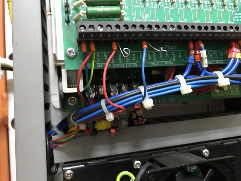

So trying to bottom out the lack of rotation I opened up the connections for the KTK Mentor DC Drive to get at the DC speed command input (+/- 10 Volts sign indicating direction) and was amused to see my clip links still in place from the last time - very convenient!
Measuring the speed command voltage it remained resolutely at 0v - mmm . . very odd. Now the controller is asserting the drive enable signal so all it needs to spin is a small DC voltage to say how much and which direction!
Well years back I made a little DC servo drive box - simple affair - 9v battery, suitable potentiometer, and a reversing switch. So it got a new battery and set to work.
Sure enough, I can drive the spindle quite happily from the little box until the control again reports spindle over speed and drops the drive enable signal.
This actually is quite a relief as this vintage of KTK Mentor are thin on the ground, and even if you can find them they command silly prices.
So what are we left with? Logically the lack of decoding of those numbers points to software in some form (firmware or what I loaded) and the lack of servo drive voltage could be either software or hardware.
Until a few more spares arrive I think I'm at an impasse  :scratch:

The spindle drive system in block form is pretty simple (but they are VERY complex blocks!). DC motor with a Tacho and Encoder attached which is driven by the KTK DC drive. This takes it's command from a DC level set by the 'Measuring Card' that compares desired speed and direction given by the CPU with measured speed and direction from the tacho and encoder.
Does the encoder work? Well yes, once the drive has been told to turn (and failed) you can see the rotational position of the spindle via the controller. So there's a 'tick in the box'.
. . . about now a light light started to glimmer, and get brighter by the second. There is a page of 'spindle settings' tucked away in the controller specifying 'Acceleration Ramp Time, G92 spindle Speed limitation, M19 exact spindle Stop location, and Spindle Speed Limitation Everything was set to zeros.
If you limit the spindle speed to zero, it AIN'T going to spin  :lol:
Now I thought that these settings were included in the re-load process, but it seems that they are not. Setting sensible values and now I have a lathe that turns it's spindle on demand - in fact just what a lathe SHOULD do  :clap:
I'm still left with the oddity of missing text on the error messages but I bet that that tuns out to be some setting that's been zapped !
