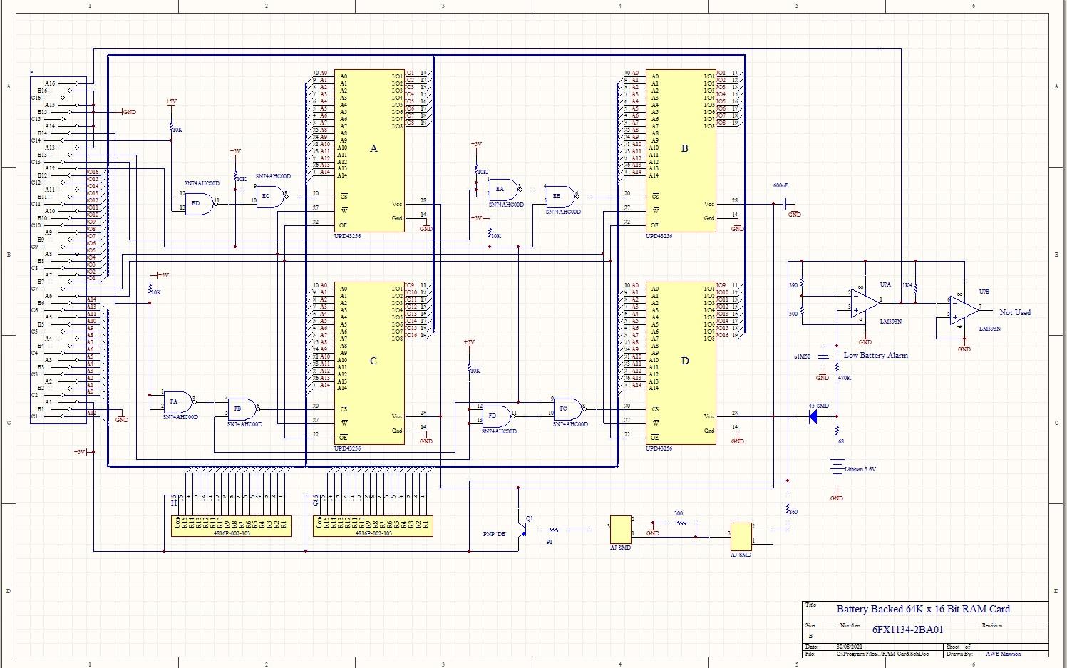

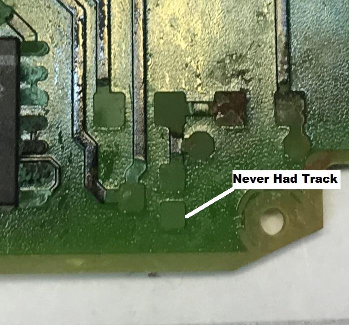

Another day going cross-eyed but quite a bit of progress  :thumbup:

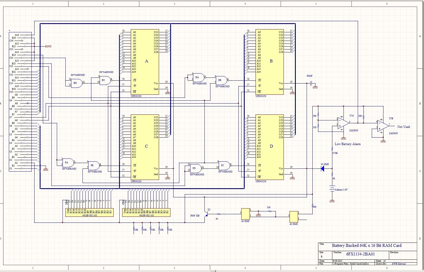

I initially concentrated on the 'low battery alarm' circuitry which uses a dual precision comparator chip. Got it's wiring worked out but I couldn't for the life of me find where the output of the second part went. I couldn't trace ANY pcb tracks but it's not easy with SMDs ! Bright torches help shining from the other side, but not in this case. In the end I decided to butcher the original battery RAM card that was dissolved by the lithium juice prior to my ownership, and take the 8 pin SMD off the board. Hot air gun suitably applied only to reveal that despite the fact that it's inputs are connected, IT'S NOT USED  :clap:
OK go back to chasing real bits not virtual ones. Next on my list to nail was the three pin SMD labelled '45'. The look up list for SMD's said it could be a pair of diodes, a single diode, a transistor, or a voltage regulator so not much help. In the event looking at the original card (where this chip had completely disappeared!) in fact only two pins had tracks attached so it could really only be a diode (probably schottky from my meter readings)

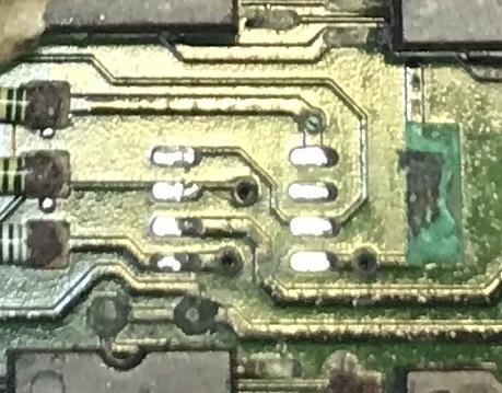

Time to try and identify the SMD device labelled 'AJ' - again the list said that it could be almost anything, so I decided to pull one off the scrapped board and try and test it. Fiddly things these SMD chips - breath and they skid all over the place. In the end I super-glued it to a bit of wood, pressed pins in adjacent to the connections, and biased them together with a Hellerman rubber sleeve. Didn't do me any good - my component tester had no idea what it was. So I've drawn up just a block with three connections for the circuit drawing hoping that it's identity might be revealed by context.
I still have quite a few 10K resistors to positively tie to places in the diagram - several are definitely pull ups for gate inputs from the outside world, but I'll save to joy of finding them for tomorrow!

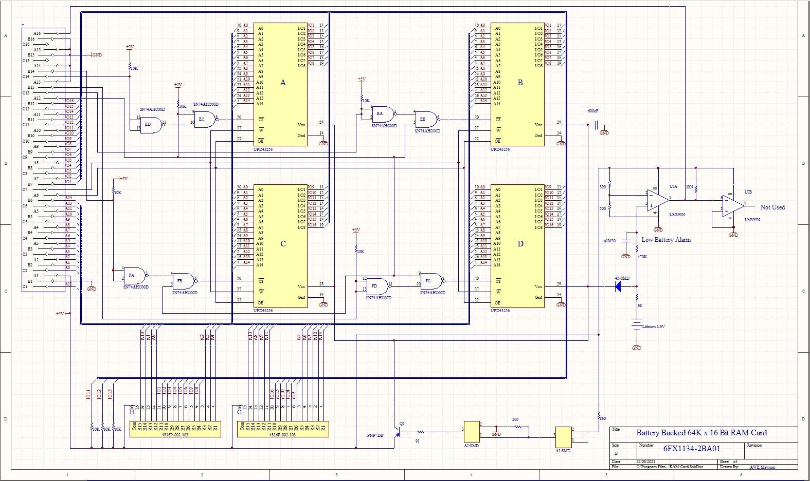

So with a flurry of activity this morning I think I've got all the components accounted for and correctly interconnected on the circuit diagram - phew that was quite a bit of labour and eyestrain!
Of the 48 pins on the edge connector only two are not used (C15 & C16)
I still don't know what the SMD chips 'AJ' actually do, but from the circuit you can see that they are turning on the PNP transistor 'SMD-DB' when 5 volts is coming in from the edge connector, and turning it off when it's not present allowing power to pass to the RAM chips normally from the incoming supply, and be powered via the diode '45-SMD' from the lithium battery when system power of 5 volts goes away.
By my calculations the 'Low Battery Alarm'  (Pin A16) should be asserted when the volts of the 3.7 volt nominal battery fall to 2.8 volts.
Now I have the circuit I need to work out how to actually test it and hopefully fix what is wrong. The battery side should be pretty simple. Power up the card with 5 volts, replace the battery with a variable lab supply and see what happens when the voltage is lowered from 3.7.
However testing the rest isn't quite as simple. Simplistically all 16 address lines and 16 bi-directional data lines should be able to be toggled by applying a TTL signal so any 'stuck bits' could be found, but Id like to build a proper tester that writes to the ram and checks what is written. My first thought was something like an Arduino, counting up the address line in binary, and performing a write and a read but the number of input output pins gets large.
16 address, 16 data, plus Chip Select, Write Enable and Output Enable is 35 I/O lines - will an Arduino do this - I have no idea never having used one! I can cut the number down by 15 to 20 by building a 16 bit counter circuit for the address lines and just incrementing it but that limits me to only testing addresses sequentially which is not ideal.
. . .so comments please from all those Arduino experts out there !

That battery / psu circuit with the 2 "AJ" devices sort of makes sense to some degree. In the circuit, the LH one looks to be an NPN transistor and the RH one appears to be a zener - but the same device can't do both functions. Or can it?
The LH device looks like pin 1 - base, pin 2 - emitter, pin 3 collector, which is a fairly normal configuration for a bipolar transistor. You can use the base-emitter of a bipolar transistor in reverse as a zener (typ around 6.8V breakdown?) or emitter-collector for that matter. I've seen a few circuits over the years where that's been done.
Trouble is, the supply voltage is only 5V, so you'd never get the base junction to avalanche. It seems to almost make sense - but not quite!

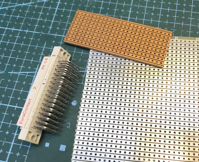

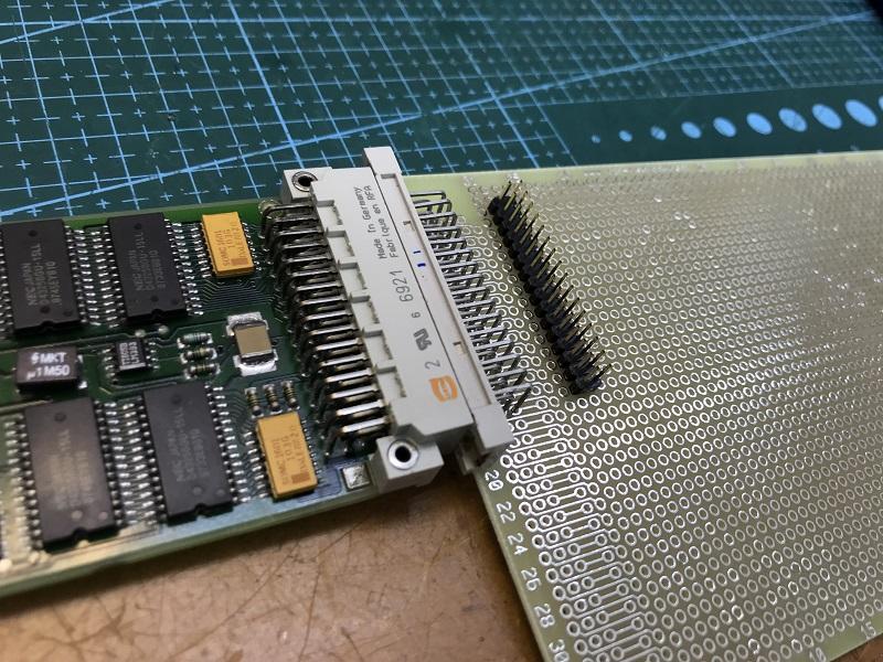

I rescued a 90 degree mounting PCB version of the correct socket, and I'd thought to just solder it into a bit of Veroboard for onward wiring, but it's three rows of 16 pins on a 0.1" matrix which rather scuppers that idea. I need a "DIN 41612 48 way breakout board" - I can't see that existing, or if it does King's Ransoms will be involved.
The pins are so flimsy that direct wiring even with sleeving, won't last ten minutes! Maybe the type of perforated board with separate pads might work, but I don't have any in stock ATM !

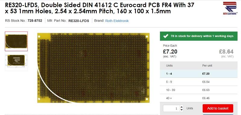

OK Arduino Mega 2560 V3 ordered and amazingly there ARE DIN41612 prototype boards available at a reasonable cost - RS do them but also on eBay . OK it's twice the width needed but that doesn't matter.
The three rows of pins are accommodated but only the outer (A&C) rows are extended, the remaining B row just having isolated pads but it should work OK I think.

I realised that I'd made a wrong assumption regarding the Data and Address bus terminations - the Data bus wasn't terminated at all ! So for the sake of completion here is the amended circuit:

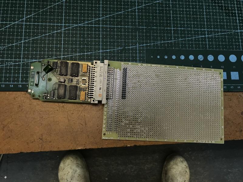

  • Posts: 9118
« Reply #1215 on: September 03, 2021, 06:03:03 AM »
Well well, a little progress  :thumbup:
Arduino Mega 2560 R3 has arrived - it did a few days ago but farming things took priority. I did just plug it in and download the IDE (Integrate Development Environment) and write a little diddy LED flasher but it failed to upload and no time to sort it out.
But today I had time to have a 'look see' : Simple really, tell the compiler that you have a Arduino 2560 R3 and not the Uno that it was set up for and it WILL upload  :ddb:
So a bit of playing about changing flash rates etc - nothing at all complicated, then I went off to GitHub and cloned the already written code for the 62256 SRAM chip to see how the author has approached the problem. The code compiles and runs but of course isn't connected to anything yet, but at least it's basically working, and will give me good ideas to structure my own version.
Still awaiting the breadboard and anyway being a Friday another two cottage change overs to perform and tomorrow a field to flail so hopefully Sunday or Monday I'll have a crack at it.
PDF version of the cloned .ino file attached - now I need to discover how to open .md read me files and I'll be well away  :thumbup:

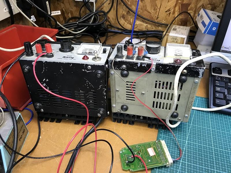

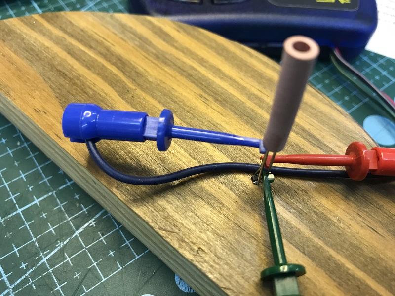

A bit more progress. I have rigged up +5 volt power to both faulty RAM cards, proved that they are not drawing excess current, and rigged a second supply up to emulate the back up battery (set at 3.7 volts)
This has allowed me to prove that the low battery alarm circuit on both cards is working correctly (+5 volt for Battery OK, close to zero for low battery).
Card #1 has a 'transition voltage' for the battery alarm exactly at the calculated 2.8 volts, but card #2 has a trigger point of 3 volts. I don't think that this has any significance but we may see later that that's a false assumption!
The bread board having arrived has let me think a bit more about the physical side of further testing, or rather  oscilloscope probing of the board under test. As most components are SMD's, unlike through hole devices you need to be able to probe both sides of the PCB. This dictates that either I stand the board vertically (which makes getting at it a pain) or have the board connector hanging off one end of the breadboard.
I've chosen the later method but this has persuaded me to incorporate header pins to connect to the Arduino rather than as I had previously intended - using directly soldered flying leads. My drawer of rows of header pins is a bit on the low side so an order has been placed with RS.

A bit more progress today. I've mapped out the logic that drives the four CS lines - one for each RAM chip.  It looks as though the board has been designed to be able to be read both in 'Byte Mode' and 'Word Mode' ie 8 bits or 16 bits of data.
In proving the working of the circuit using dead board #1 I was going round in circles as it turns out that the line on edge connector pin A12 wasn't being pulled 'high' by it's 10K resistor. Now that particular lines goes to several pins on both 74HC00D chips , and one of them is driving to 0v when powered up. Impossible to tell which without removing a chip. To this end I've ordered some (minimum order 50 off as they are SOIC-14 smds !)

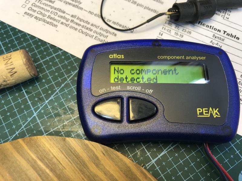

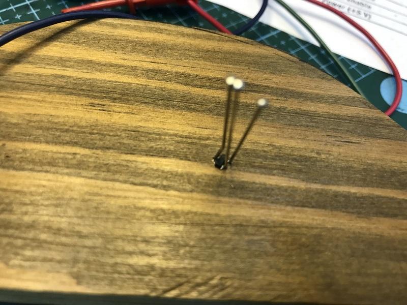

Board #2 has a faulty "SMD DB" transistor which I believe translates to be a BCW67C - again in an SMD package - so I've ordered some of those (100 off for £1.94 !!)
So this is going to be a learning exercise in SMD reworking for which I've bought a hot air rework station etc - about time I got equipped !
