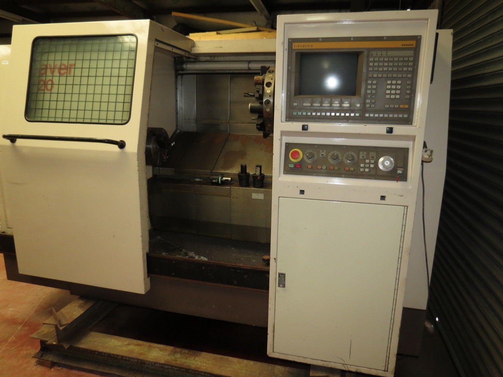

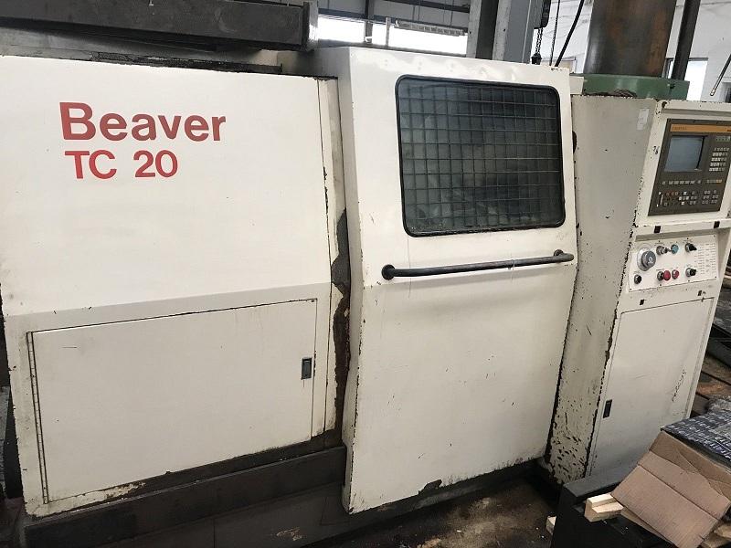

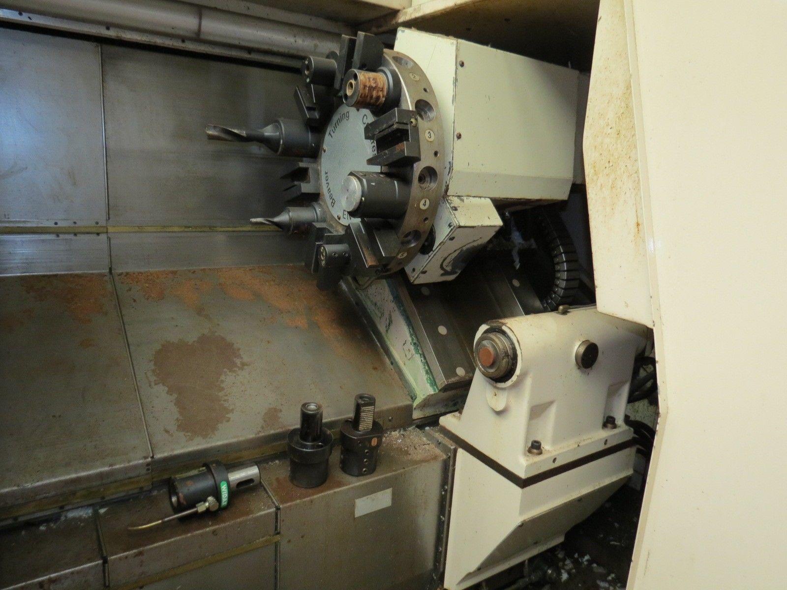

Well I've been and gone and done it again  :bugeye:
This Beaver TC 20 CNC lathe was too much to resist - after all it's paint scheme matches my Beaver PartsMaster CNC Mill  :lol:
Ex Portsmouth University, the sellers father bought it, had it briefly running, but then unfortunately died - that was five years ago and the machine has sat unused and un-powered for that period. The cosmetics of the outside are excellent, but inside the swarf guards have light rust - it's obviously been turning machinable wax, as there is still some swarf in it, and that would be without coolant, so the guards haven't been kept oily by coolant hence the rust.

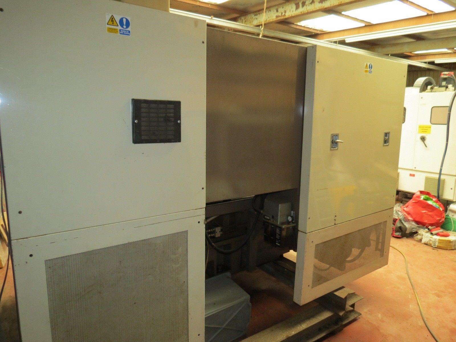

The control is a Siemens Sinumerik 820T - having been left powered off the back up battery (last changed 2008!) is obviously dead as a door nail and all the parameters and plc data have been lost.
I went to inspect on Thursday, and although I got 3 phase power on to the machine I could get nothing what so ever out of the controller - no screen display, no leds nowt  :scratch: Might be dead simple, might be a nightmare
A bit smaller than the Traub this is an estimated 3 tons and has a 2.75 x 1.98 metre footprint - just need to get it shifted the 80 miles home and I can start playing  :ddb: :ddb: :ddb: :ddb:

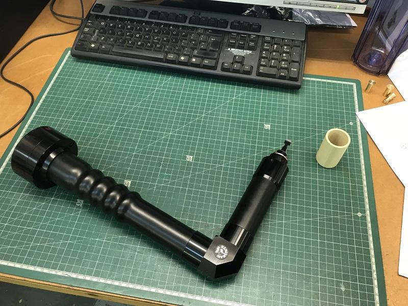

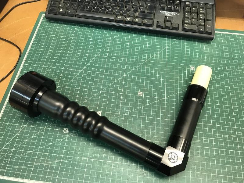

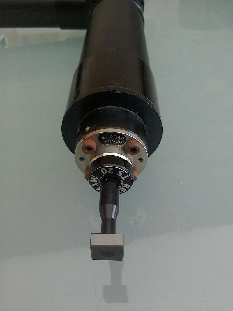

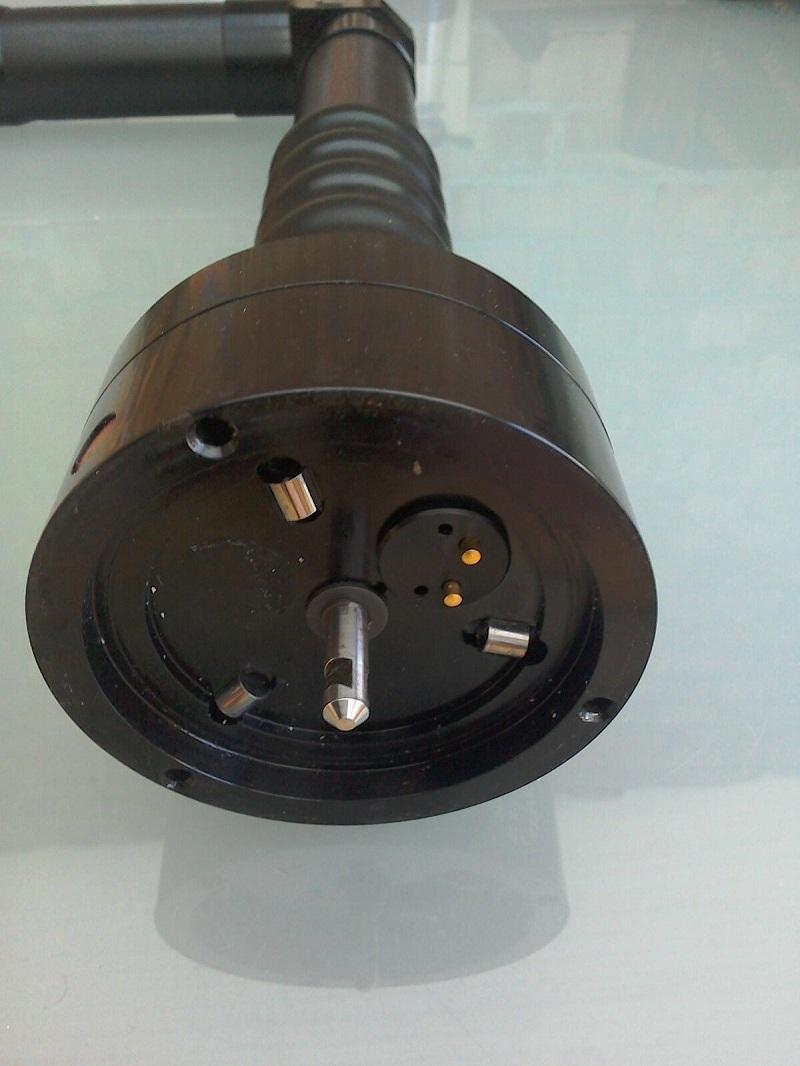

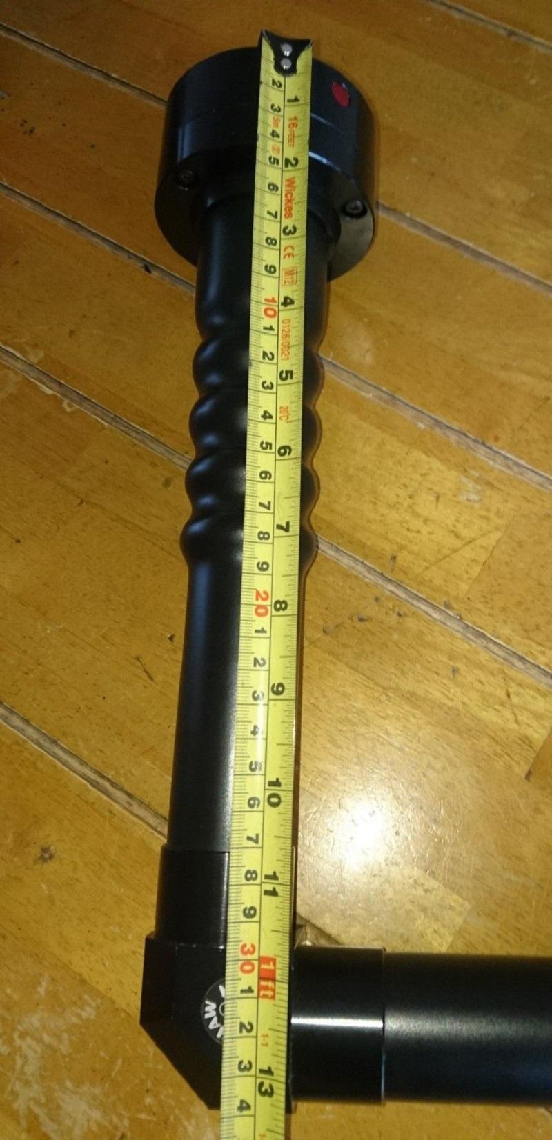

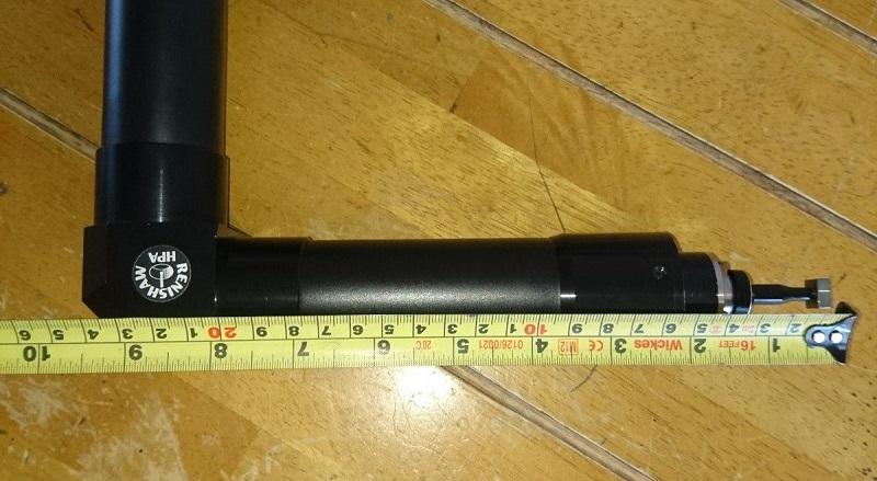

Well a tiny bit of progress, I've located a Renishaw tool setting probe. You'll recall the seller of the lathe lost his  :bang:
The one I've found is off a Beaver CNC lathe and was left behind when the lathe was sold. Vendor can't remember the model number, "but the Chuck was 300 mm". Now the TC 20 has a 250 mm Chuck and as far as I can find out Beaver never made a CNC lathe with a 300 mm Chuck
Chuck size is important as the probe reaches round and past it to touch the selected tool in the turret. The problem is that these probes are assembled from a huge variety of element lengths to suit a particular machine - hopefully if this isn't spot on I can move the programmed measuring point to suit it - I'm hoping he'd forgotten the size of his chuck - I never mentioned Beaver, he named the lathe so hopefully . . . :med:

The touch probe seller has been in touch (no pun intended!) and confirmed that it was off a TC-20 lathe, and not only that he still has manuals for the Sinumerik controller - so how good is that  :clap:
. . . . negotiations are in progress . . . .  :ddb:

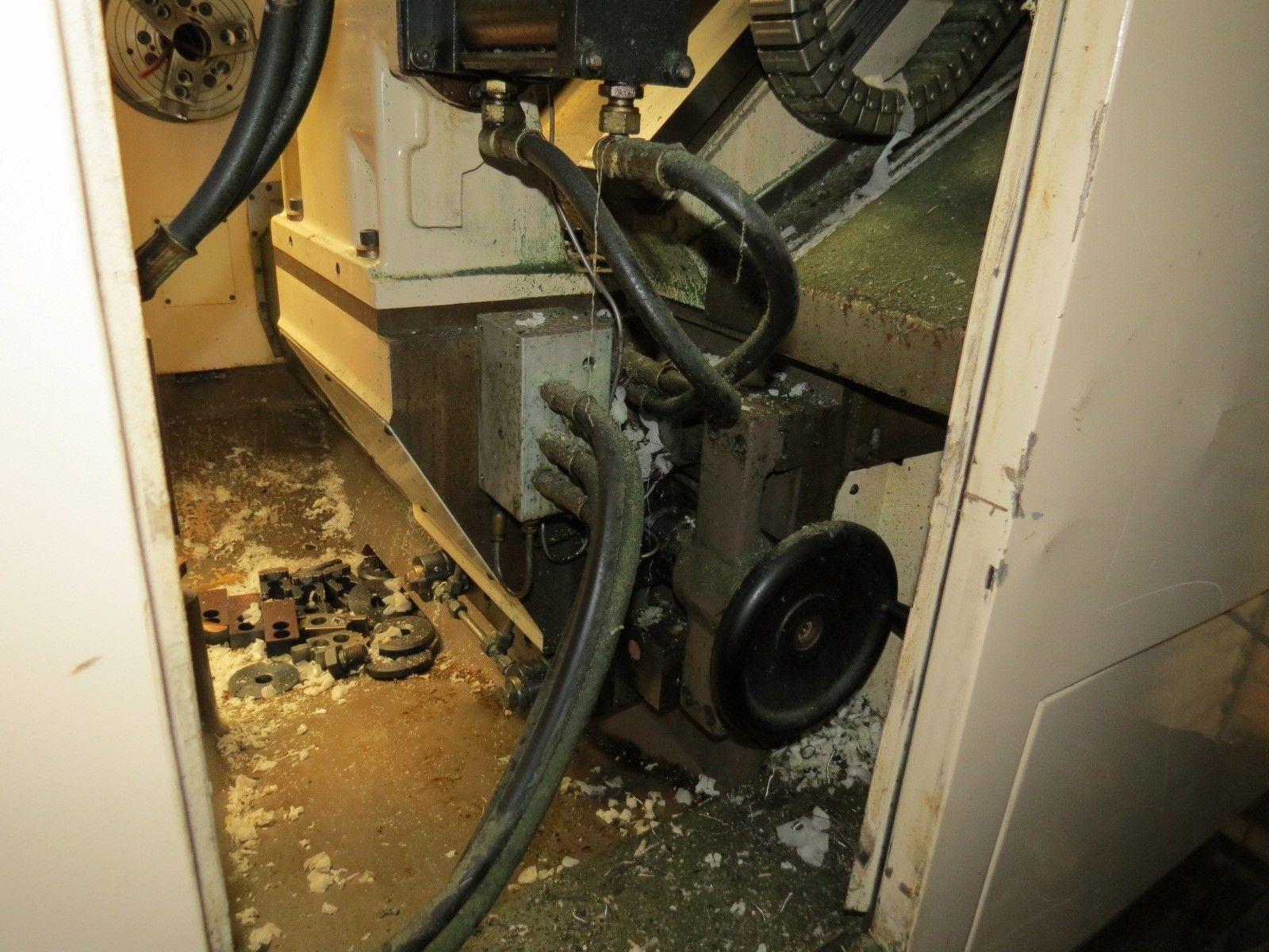

. . . . the manuals are mine and being posted tomorrow. He was last machining PTFE on it, and that was 2010 - the swarf from it is still in the machine  :clap:

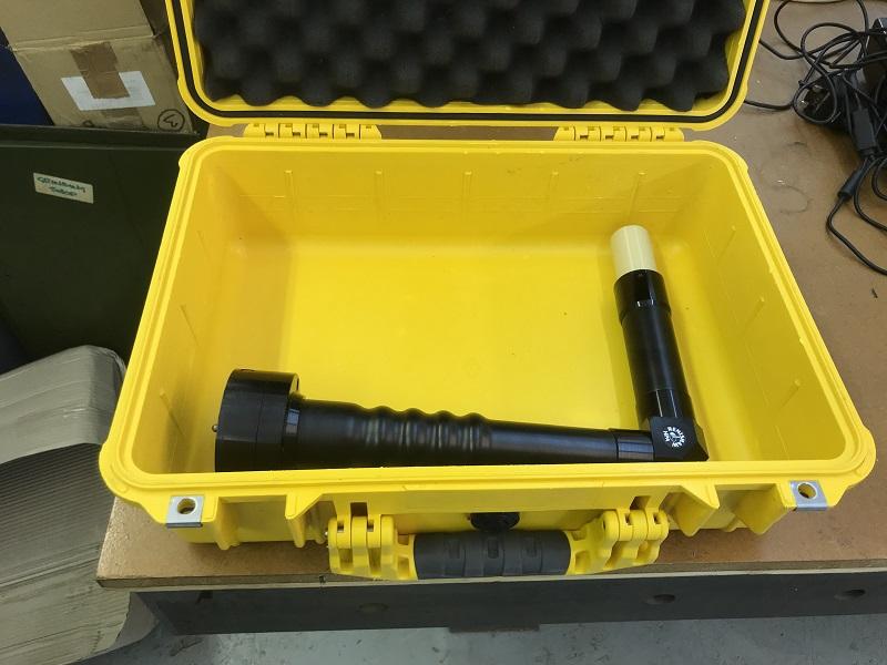

BUT - the probe has arrived along with the bundle of software manuals, as has a second hand 'Peli Case' that I bought to house it. The tip of the probe would originally have had a protective cover, which has gone missing so I 3D printed one this morning, and at the moment the Cetus 3D printer is making me a cap to protect the electrical connector, but that has another three hours to run.
. . . just need the 'pick and pluck' foam block that I have on order for the Peli case and it will be safe.

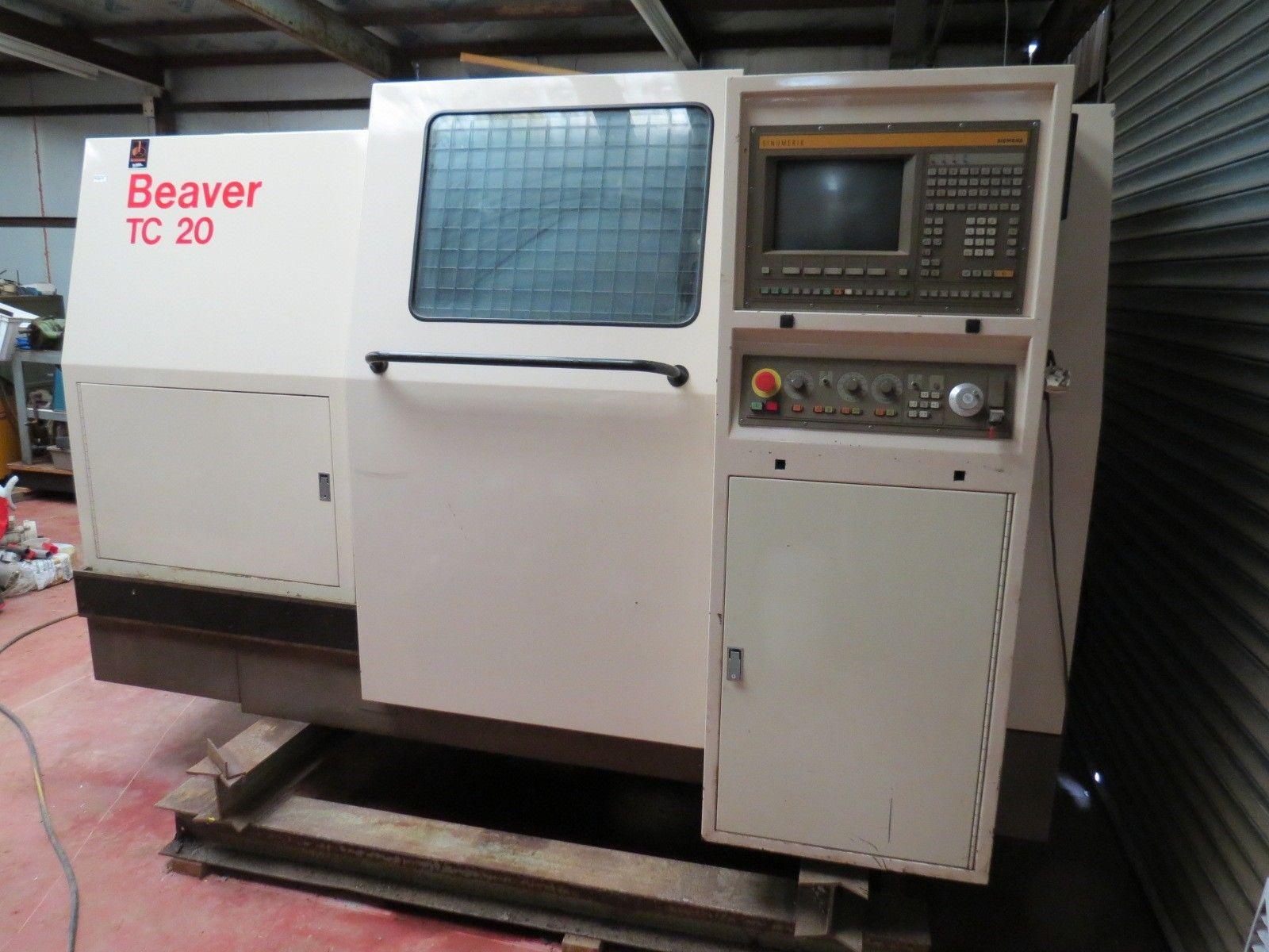

At last I've found a weight for the machine - 6.25 tons  :bugeye: and at vast expense have commissioned a professional machine moving company to collect and deliver using their enormous hi-ab equipped lorry - only problem now is that the seller is proving elusive and not answering phones or texts.
Meanwhile I've been offered another Beaver TC-20, slightly younger but in far worse condition cosmetically for less than it's costing to MOVE mine ! Shame to miss it, as obviously it would be an excellent spares 'Christmas Tree', but again I'd have to move it. Tempting as I have room for it and it has a full set of documentation. I'll try and liberate the documentation at least, or just maybe buy it and strip it on site though the removable chunks are pretty sizable on their own .
. . . any volunteers for a day out in Birmingham helping me pulling a machine apart in a controlled fashion !

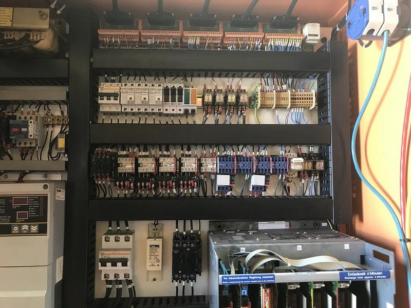

It's not quite identical being fitted with a different tool turret and machine control panel but the Sinumerik controller is fundamentally the same. Picture to show it's not as nice as mine  :ddb:

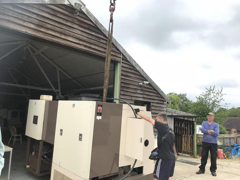

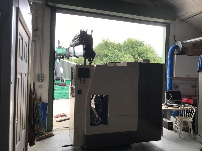

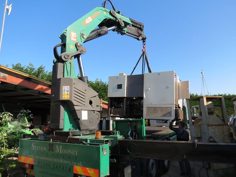

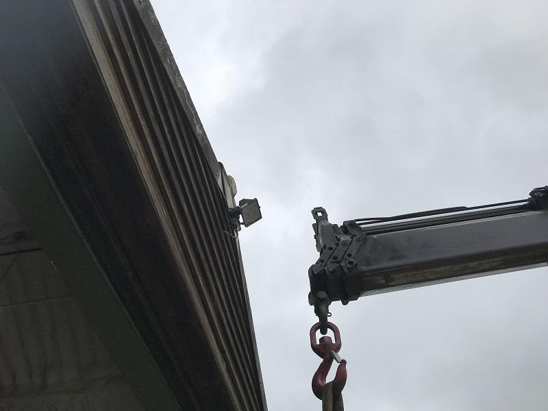

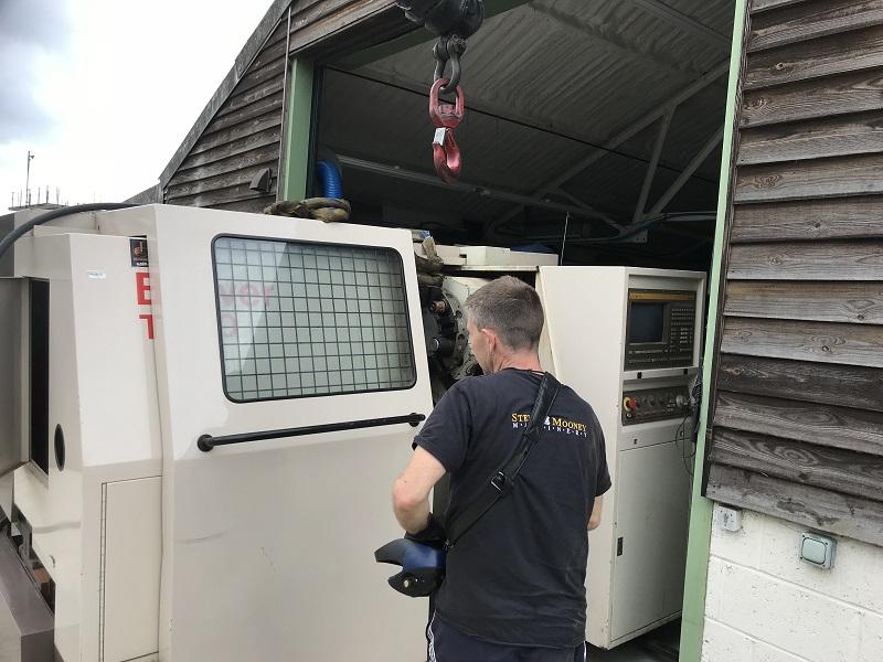

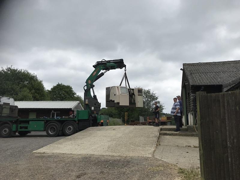

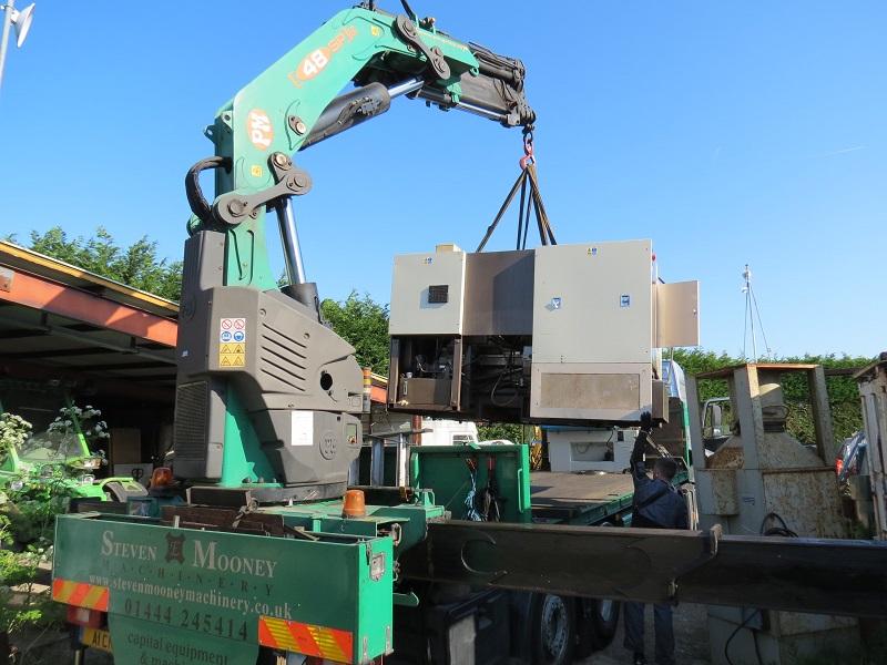

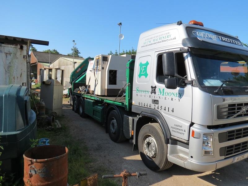

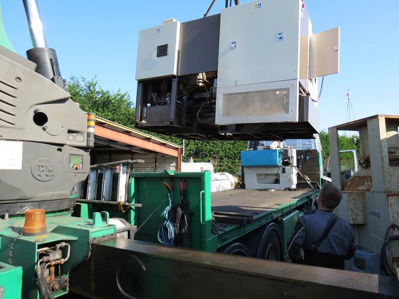

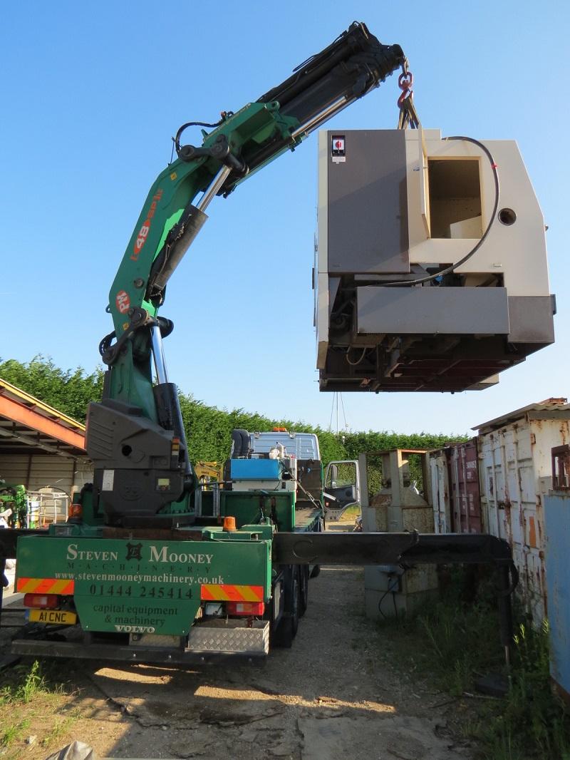

Well after several false starts and delays I got the call 08:30 this morning to say it's loaded to the wagon and on it's way  :clap:
Now this has sent me into a flurry, as previously it was going to be tomorrow and I've committed to transporting an elderly friend to and from the dentist for a check up bang on when it's expected  :bang: Oh well I expect it'll sort itself out  :scratch:

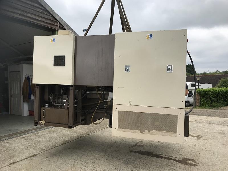

Have some pictures of my lathe swinging from a large hook !

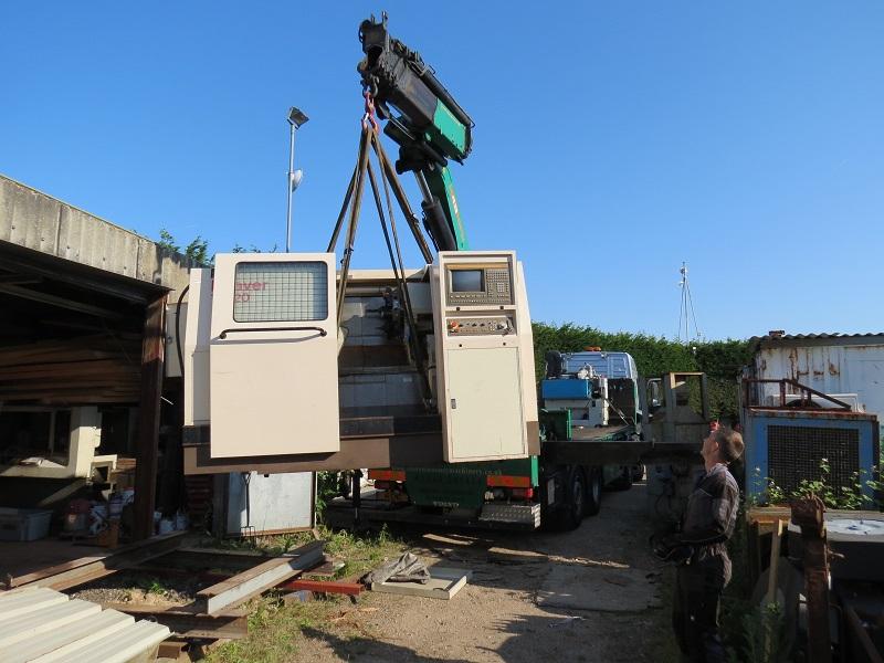

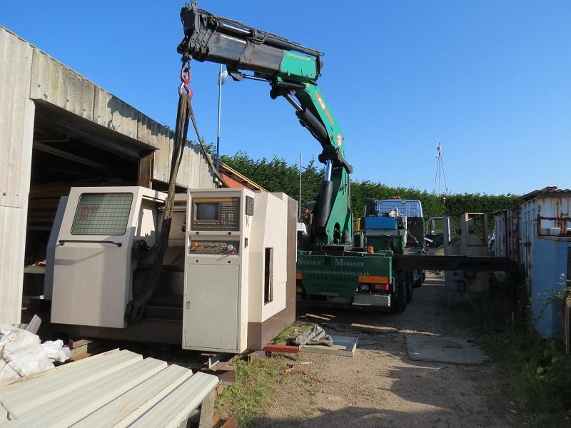

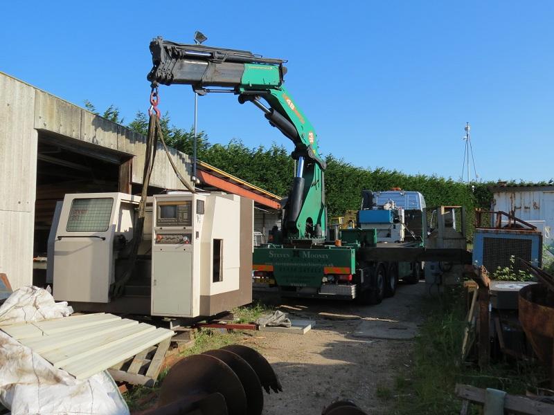

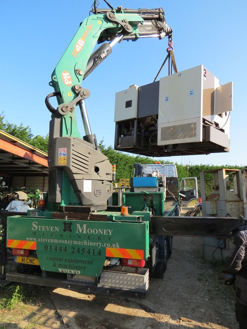

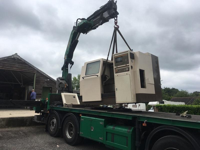

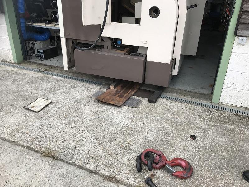

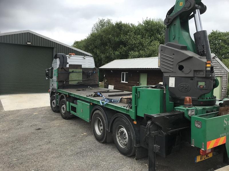

« Reply #21 on: June 12, 2018, 10:19:18 AM »

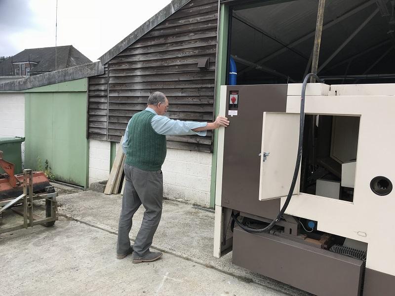

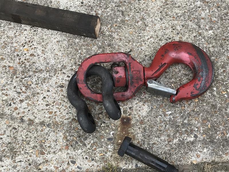

So rather surprisingly we were able to get Geoff through the dentist slightly ahead of time, and I got a text from a friend just as he was finishing, to say that a big lorry was pulling into the farm and did I need a hand !

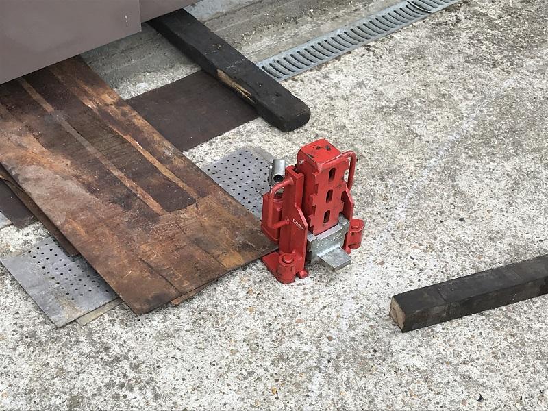

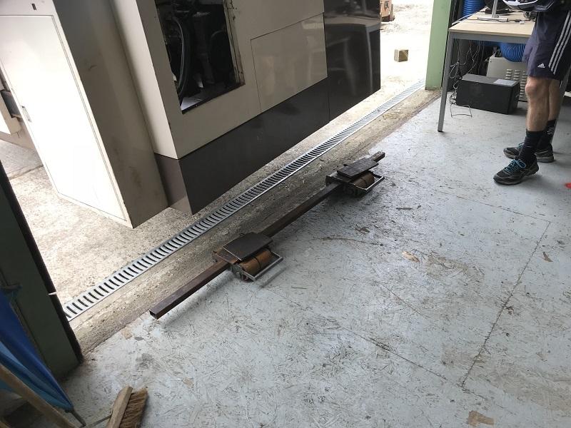

So we got back to the farm in time to see the lathe swinging again on the hook - a very professional chap on the (remote) control knew just what to do - extending the Hi-Ab as far as the load limiter would allow got it poked so that the Tailstock end was just able to be put on skates, then he shifted the lifting point to the Headstock end and was able to gently ease it into place.
Then a bit of work with some rather nice toe jacks got it off the skates and back on it's levelling feet. All a bit tight but 'workable' (I hope) - it's slightly smaller than the Traub so how the heck I got that in I don't know  :scratch:
It's been a  bit of an emotional roller coaster getting so far and I feel exhausted, but when I've fed the pigs I'll go back to the workshop and try and get a feel for what I've taken on this time  :bugeye:
« Reply #22 on: June 12, 2018, 10:24:12 AM »
The firm I used had all the right equipment and the driver certainly knew his Hi-Ab. Superb lorry, nice Toe Jacks,, good skates and a massive hook on the hi-ab that probably weighs more than that Denford Mirac that I mended !
Of course it would never have moved if Geoff hadn't given a push at the crucial time  :lol:

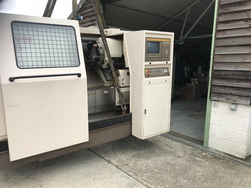

« Reply #24 on: June 12, 2018, 01:39:25 PM »
. . . who's Matt  :scratch:

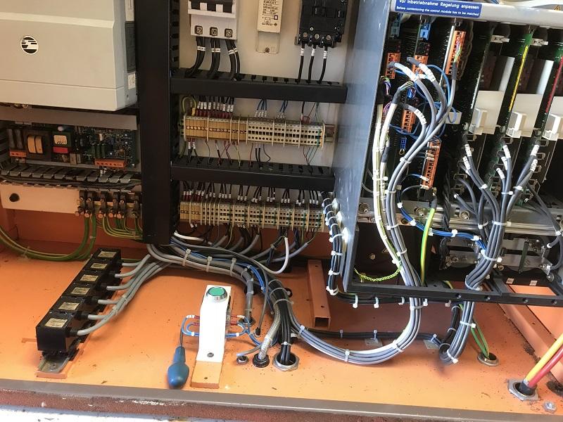

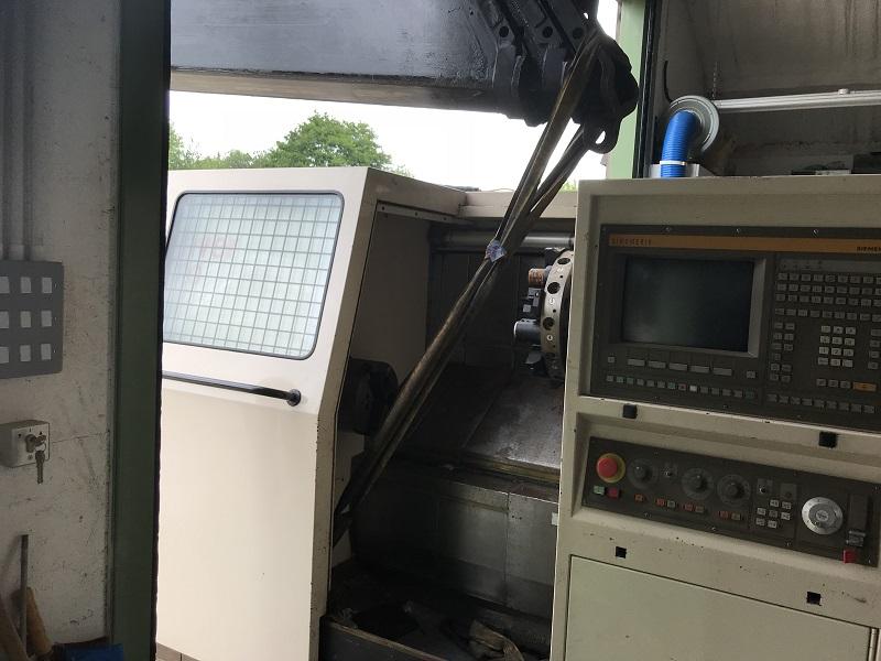

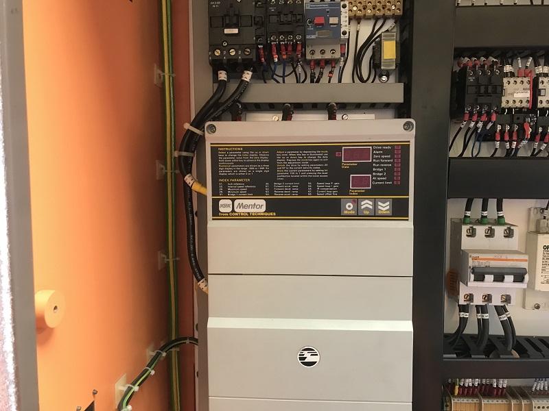

State of play at the moment is that I have it wired to 415 three phase. With an earth connected it's tripping a 100mA RCD - (when I hooked it up on site it had no earth) - symptoms remain as previously, no life or LEDs on the controller.
I'll try and pull the controller out this evening and see what's happening - the way it's mounted is a bit silly as there is no easy way to it's rear other than unscrewing it, and the back up battery is mounted on the rear of the controller. This battery has to be changed with the power on, so not sure how that is supposed to happen - may find out later!
