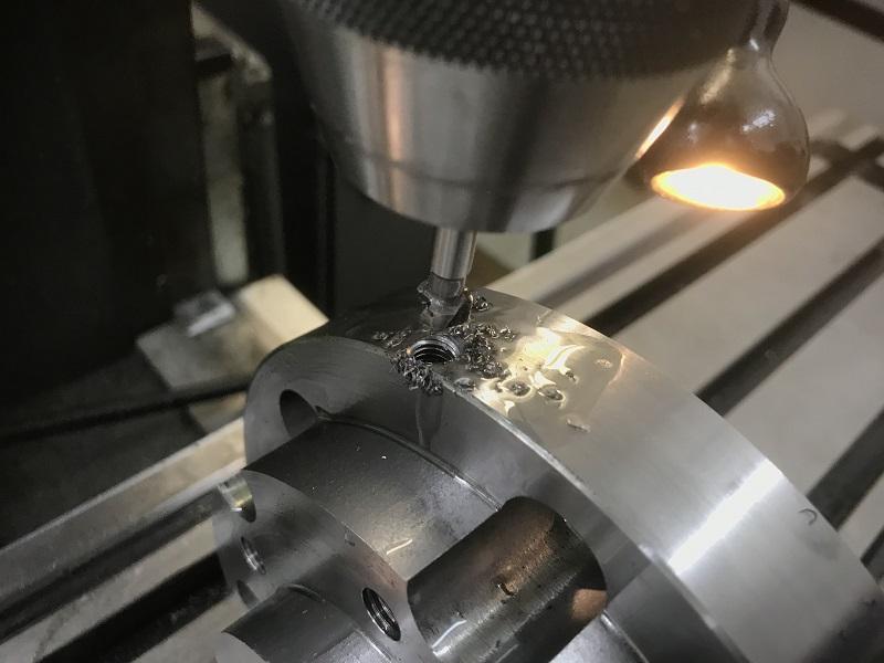

It's saved my bacon several times Matthew  :ddb:

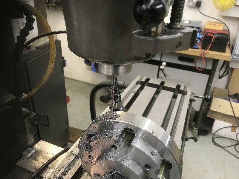

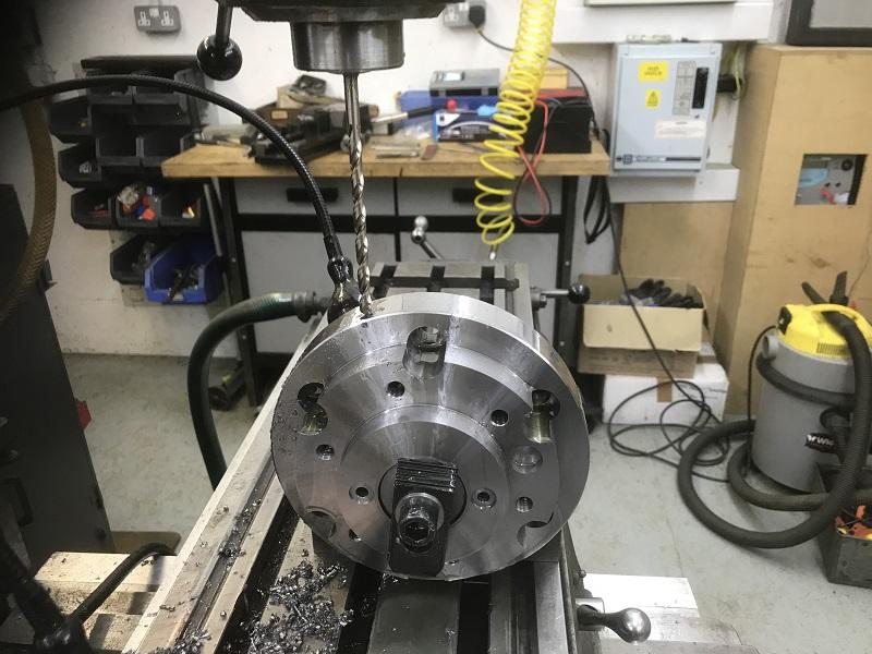

So after lunch I cleaned up the entry to the first oil gallery with a suitably sized countersink, and then re-set the mounting to present the other two oil ports vertically above each other. I'm glad I went to the trouble of making that pivot, it makes life so much easier!
Then it was a case of 6 mm end mill to give a start for the drill on the curved surface, and drill it out to 52 mm deep with a short series HSS Cobalt drill.
The hole needs to be about 110 mm deep finally but I've gone as far as a short series is happy, and that with masses of ups and downs for chip clearance and adding lubrication. Long series cobalt drill is due by Wednesday and although I have several plain HSS ones, in light of the previous experience I'll wait until it comes!

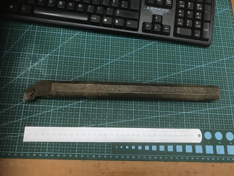

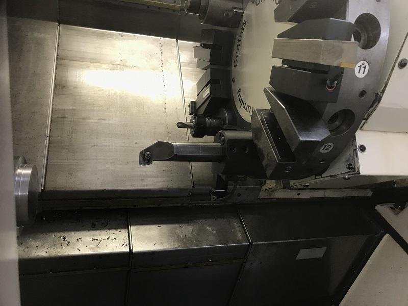

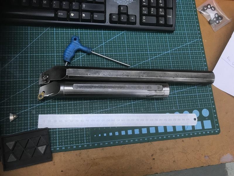

Ade's kind gift of the sacrificial boring bar arrived this afternoon.
Same 32 mm diameter as mine but somewhat longer - glad to find that I have suitable tips in my stash of carbide :thumbup:
I gave it a bit of a clean up on the wire wheel and mounted it in a 32 mm VDI40 socket holder - note the the socket supports the bar for  85 mm and that I calculate that I need about 200 mm total length so I can shorten this one by about 175 mm.
Just for a laugh I mounted it up 'uncut', and naturally it vibrates like a goodun - we'll see what happens when shortened. If it still vibrates I'm going to surround it by a  cast lead jacket, but that's for tomorrow.

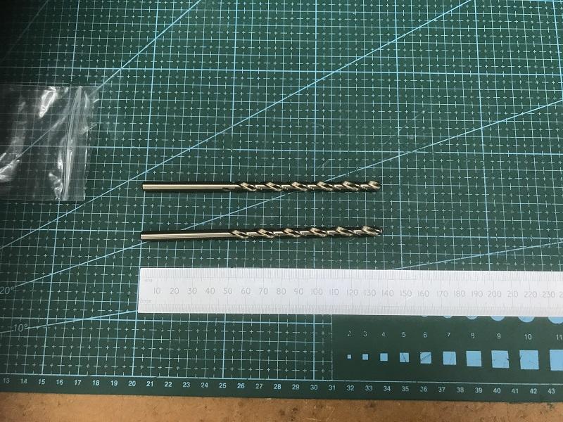

I'm delighted to say the postman brought the long series 6 mm cobalt drills a day ahead of schedule, so I was able to press on and finish the last hydraulic oil gallery.
I must say that these M42 8% Cobalt Osborn drills make short work of this hard alloy steel.
Same process as before culminating in tapping for an 8 mm grub screw as a stopper and cleaning up with a countersink. It is a huge relief to have finished these long holes    :ddb:

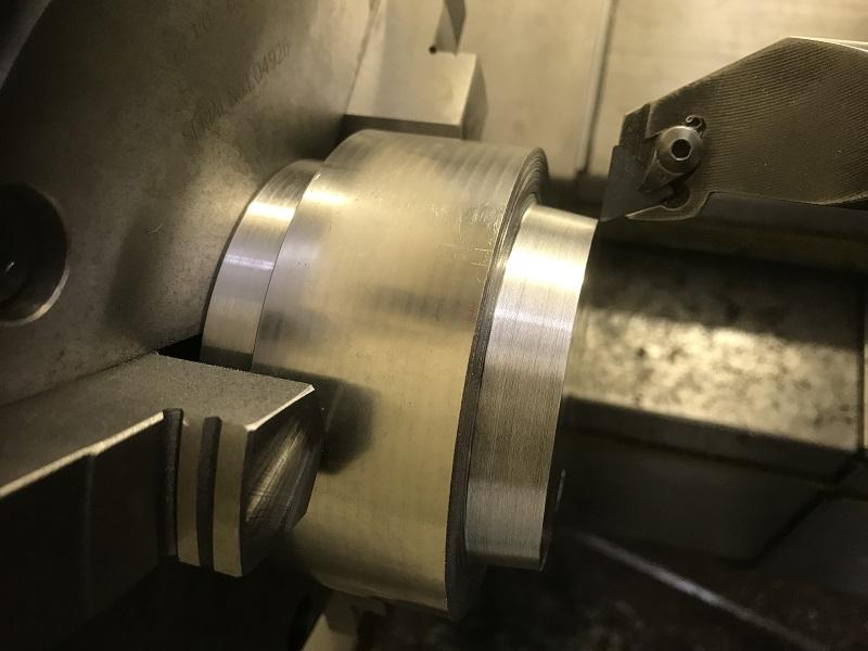

« Reply #1105 on: June 22, 2021, 09:23:36 AM »

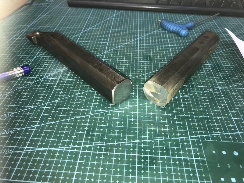

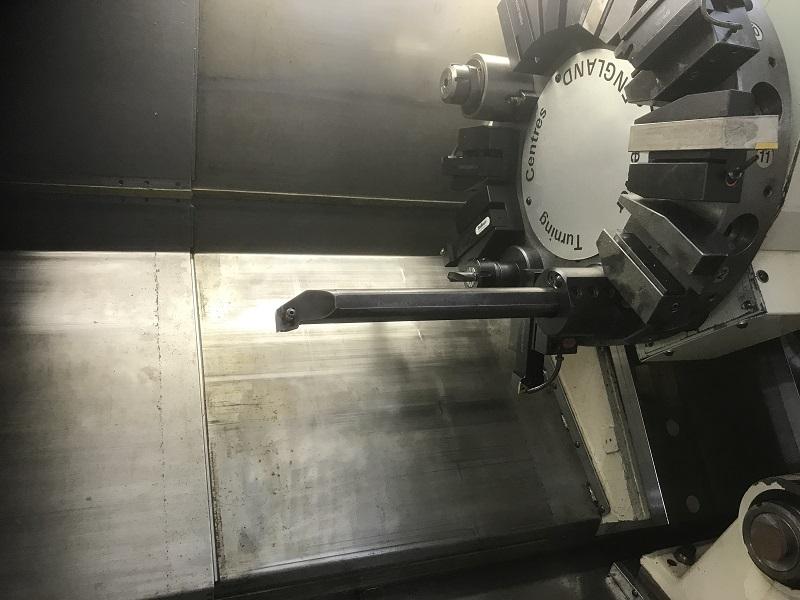

Nothing for it then but to grit my teeth and take the angle grinder to that nice boring bar. This is of course sacrilege
Very carefully working out  how long to leave it I then did the deed, and cleaned it up on the disk sander to at least look presentable. Mounting the shortened tool in the turret it at least looks less ridiculous than before it was cut, but how will it perform  :scratch:
. . . Well the answer is with FAR less vibration - it might actually be satisfactory. I've only tried turning under what is called 'Overstore' on this controller, where you can set the spindle rotating at your desired speed and direction, then use the manual jog or handwheel to control Z and X
Have other duties this afternoon so next time I'll try under program control and see how good a finish I can achieve.

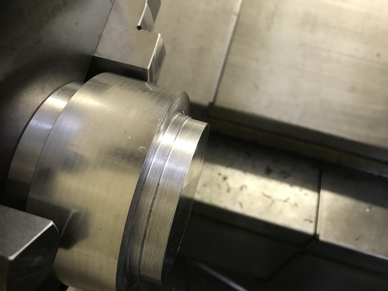

« Reply #1107 on: June 23, 2021, 04:43:02 AM »

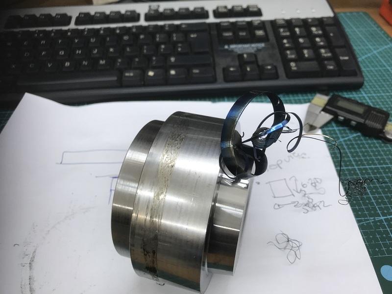

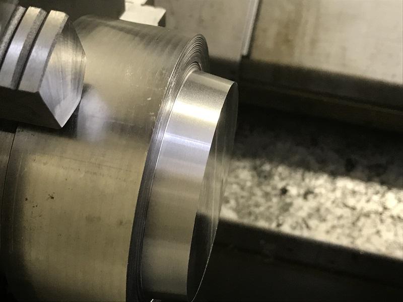

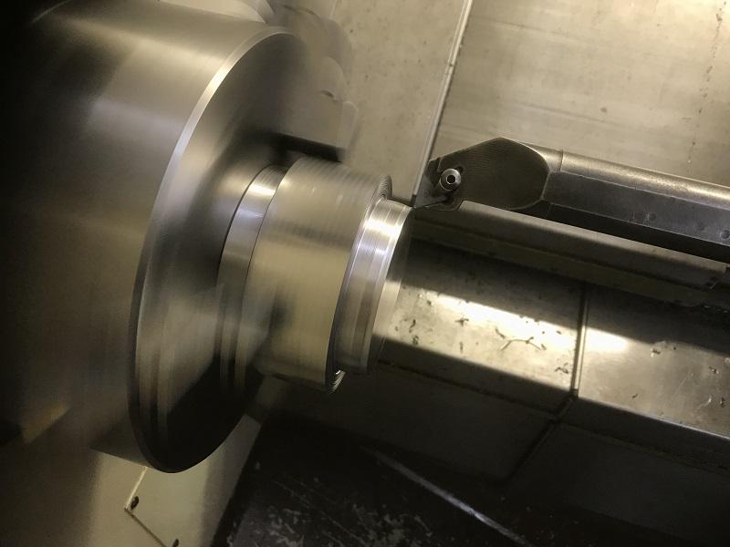

So this morning I set up an EN8 test sample to see what surface finish I can achieve and what chatter I can see if any.
Sweet spot seems to be 1500 rpm with 25 micron DOC - not using coolant so the whispy swarf glows like steel wool falling onto battery terminals!
Finish should improve with coolant. Note that this taper is the correct 7.125 degrees wall angle but smaller diameter than the actual adaptor nose as this bit of EN8 has been turned a few times !
  • Posts: 9048
« Reply #1108 on: June 23, 2021, 06:24:59 AM »

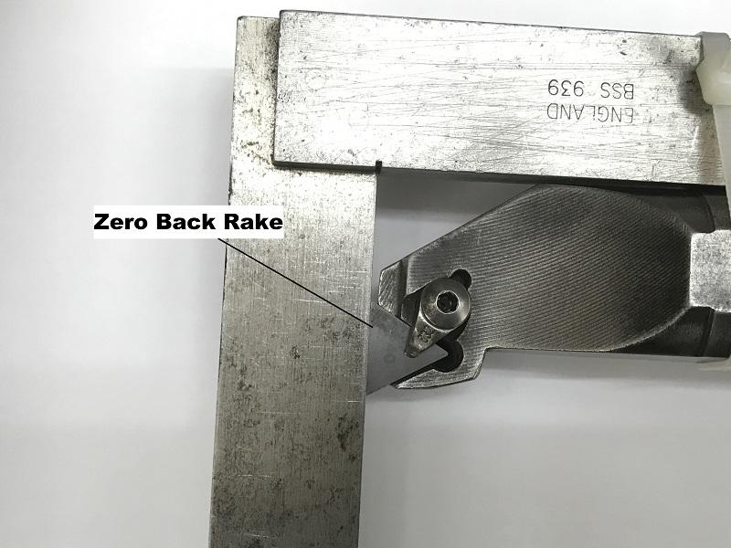

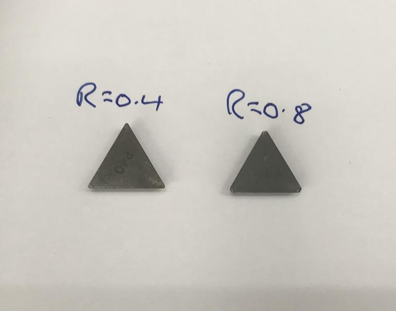

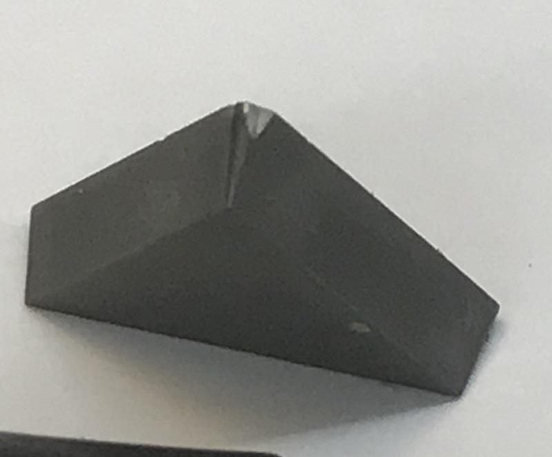

I dismounted the tool holder intending to put it on my off line tool setting rig, but I noticed a tiny flash of light from a facet on the tip.Close examination under a glass revealed a worn facet - so obviously I need to radically address feeds and speeds. Trouble is I have no idea what grade of carbide this is.
After all those dramatic glowing bits of swarf WERE a clue  :ddb:
No point in accurate tool setting until I get this feature sorted - probably just far too high a surface speed added to no coolant.
I tried photographing the tip on my Baty Shadowgraph, but the image was swamped by the light - the only way I could get a result was to make a little video moving round the tip shape - hopefully this will convey what I can see with my eye  :scratch:
First the worn tip:
Then a virgin tip:

« Reply #1109 on: June 23, 2021, 01:09:29 PM »
It seems that EN19T (or 4140) likes a surface speed range of 131 to 208 m/Sec when turning with carbide. For this taper that works out as speeds between 522 and 831 RPM.
Doing a test turn at 600 RPM with a fresh tip the finish was not as good as before but acceptable. I suspect that previously it was being burnished by the worn tip.
Hopefully finish will improve when I rig up a coolant pipe for this tool.
Even after this minor test there was detectable wear on the tip - I wish I knew what grade of carbide it is. I do have some TPKN 16 03 PP tips in P40 carbide that will fit this bar, though instead of a tip radius they have two small facets approximating a radius - I may try those tomorrow!

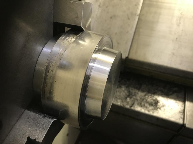

« Reply #1110 on: June 23, 2021, 03:50:20 PM »
Well I couldn't leave it at that - could I  :clap:

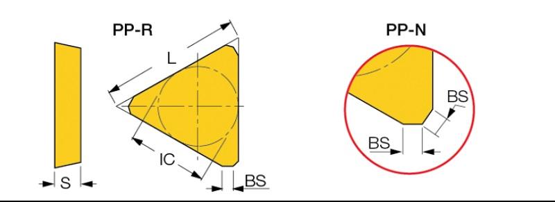

So out to the workshop and I swapped the insert for a TPKN 1603PPTR which is the one with the odd two facets rather than a  radius.
It actually gave a pretty good, and certainly acceptable, surface finish on this test piece of EN8 steel at 700 RPM. I just need to work out graphically if there are any implications for the male taper nose profile where it protrudes from the base metal - it may be within the chamfer of the chuck, but I need to check that they won't clash.
(The value "BS" in the picture is 1.47 mm)

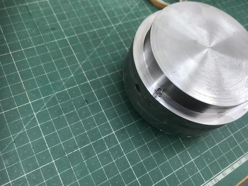

Today's job was to see if there was any way to cut an undercut at the root of the taper where it meets the body of the adaptor. This is to prevent any problems mating with the chuck body. Chuck body has a very small (just over 1 mm) 45 degree facet here but with the tips I have I can't get the root radius small enough to sit in that facet.
Normally I'd just use a parting tool or diamond tipped tool to form a groove at the root, but here I am working out side of the envelope where normal tools can reach.
Trying to push the TPKN 1603PPTR to it's limits to make a groove there I ended up with a nasty crash, pulling the EN8 bar end out of the chuck  :bugeye: Lucky this is an experimental test piece! Tidying it up on the manual lathe I got it back to a state where I could experiment cutting ever smaller tapers I've come to the conclusion the with a TPUN160304 tip (ie 0.4 mm tip radius) I should be able to get away with it - I have TPUN160308 tips but in a carbide grade suited to aluminium - so too soft and too large a radius.
TPUN160304 tips on order in P40 grade (steel and alloy steels)
All a bit of a pain but this is why I'm making numerous experiments before working on the adaptor itself - don't want to wreck that at this stage

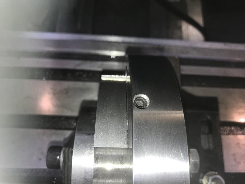

I'm pleased to say with the larger taper of the 'adaptor to lathe spindle interface', once bolted up, and then unbolted, it took a few persuasive blows from a large rubber dead blow hammer to unseat it  and it's that sort of fit I want to achieve with the 'adaptor to collet chuck interface'
(A self releasing taper needs to be 16 degrees or greater - this one is 2 x 7.125 = 14.25 degrees so just on the self holding side of the line!)

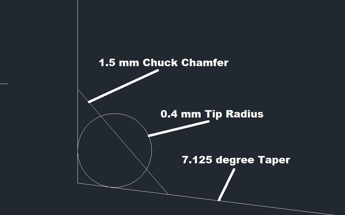

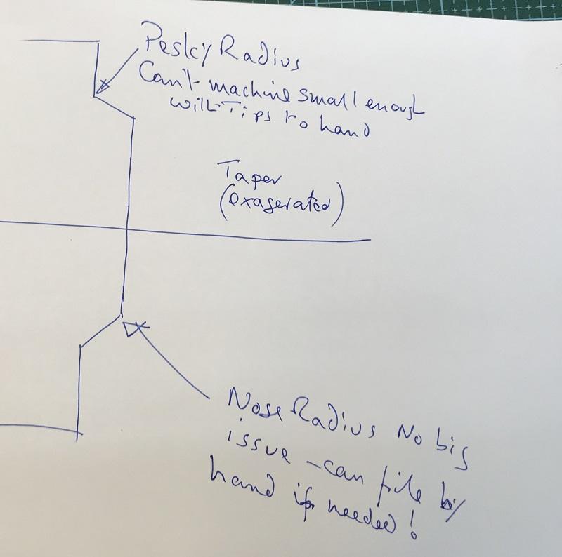

Can't get much done today due to other commitments,  however I spent some time trying to convince myself that using the 0.4 mm radius tips that are on order will produce a tight enough fillet at that pesky corner to be accommodated by the existing chamfer on the collet chuck.
. . . I think that it will but would welcome comments as usual.
I measured the chuck chamfer as reasonably accurately as I could visually at 1.5 mm, and assumed (!) that it was evenly distributed either side of the centre line of the chuck face and taper wall, which are at 97.125 degrees to each other, and drew it up, large scale, in Autocad. It seems to say I'm OK but as I say comments are welcomed!

Since you mention "the chuck" in a singular fashion, is it only one, specific chuck you want to mount on the adaptor?
If so, is there any reason not to modify (increase) the chamfer on the chuck if the peskiness proves to be obstinate?

Thanks for the suggestion - not one I'd considered, however apart from not being able to mount it in reverse and it being hardened steel no reason at all  :clap:
I'm hoping such activity will not be needed, but yes this is to mount a specific internally hydraulically operated collet chuck of A2-5 mounting specification on a spindle made for A2-6 devices with the same internally operated hydraulic mechanism.
(most CNC hydraulic chucks use an external hydraulic co-axial cylinder mounted round the spindle bore tube - not this one!)
  • Posts: 9048
« Reply #1122 on: June 26, 2021, 05:01:59 AM »
The postman brought the new 0.4 mm carbide tips this morning - not due until Monday so this is a bonus!
They are TPUN 160304 S6-P40 , so the correct grade of carbide as well as correct tip radius which has made a noticeable difference to the surface finish as well as to the corner radius.
I now need to be brave and mount up the actual adaptor and work on that  :bugeye:
