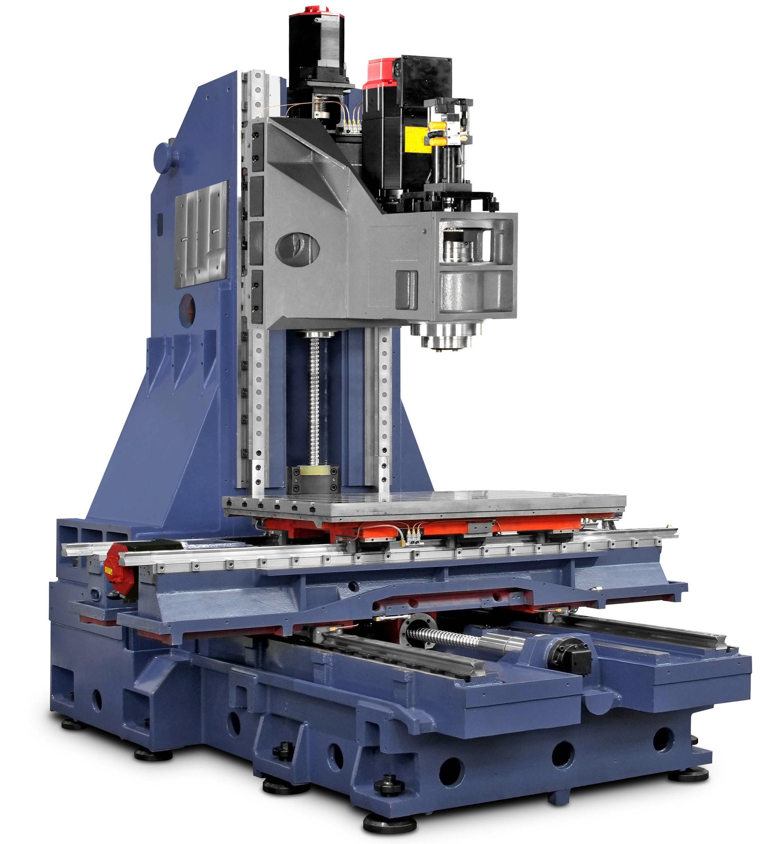

Yeah one of the designs i have looked at when doing this is this:
One of the problems with this machine is that it cant "touch off" on the table corners actually. It cant reach there with the mounted palette in the picture.
And the movent in X is really limited.. Its a chinese hurco clone.

That is the trade off. What is more important to you - more travel, or more rigidity?
