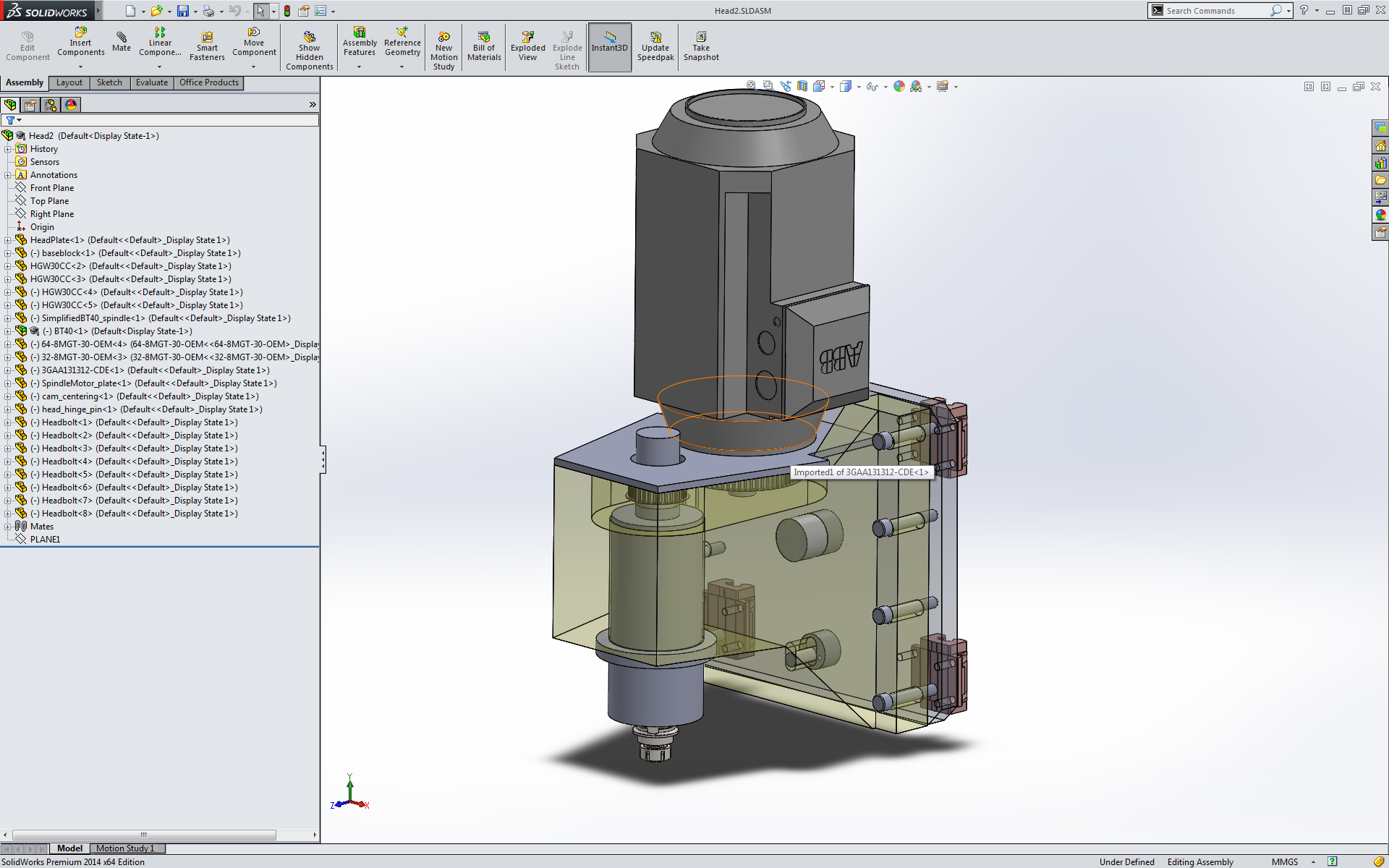

I need to pick your brains, and interest i guess.
So that 5.5kW motor on top of the head is weighing in at 45kg, the spindle is 35kg, the head is about 35kg, and the baseplate is around 20kg. So about 135kg.
The pitch on the lead screw is 5mm, its a 32mm screw and the head runs on 30mm heavy load linear bearings.. heres is the kicker..
The servo motor is a 1500W motor, that can hold 6Nm, and accelerate to about 18Nm, in my application the real acceleration is about 11Nm.
The question is.. would my servo motor be able to move that head without a counter weight. Or should i start thinking of redesigning the column in such a manner that counterweights could be added.
Im considering going with a 4kW motor instead and save 15kg, but - that would make me loose about 2Hp. I have decided i will go with a ABB motor tho - not just sure what size yet.

So i had some issues with the idea of 130kg milling head. But i got this formula off of a friend.
6Nm / (0.005/2/pi) * 0.8 = 6032N
That basicly means that in the lowend of the servo motors i can accelerate 600kgs with somewhat ease. the motors is 2600rpm, but lets say you have friction some strain and other issues, so it drops to around 2400rpm. Means if i work within the 6Nm holding power range of the motor, that 600kgs would be able to accelerate with 12m/s in theory. My motors can accelerate 18Nm, but with Amperage being an issue there im prob. limited to about 11Nm.
Still i dont think 130kg of milling head will be an issue. Not even sure i would need a counterweight actually. But i should prob. gear it down with some form of beltdrive to 2:1 ratio so i can actually utilize the theoretical acceleration.  *drawing new table mounts*

So spent 3 days tinkering with the tramming possibility..
So basicly, 22mm holes, with a 16mm bolt, head is sitting on a 60mm dowel, and has a little "cam" that allows for tilting the head ever so slightly. That cam only has about 2.5mm radius, so it will not allow for alot of adjustment, but enough i think.

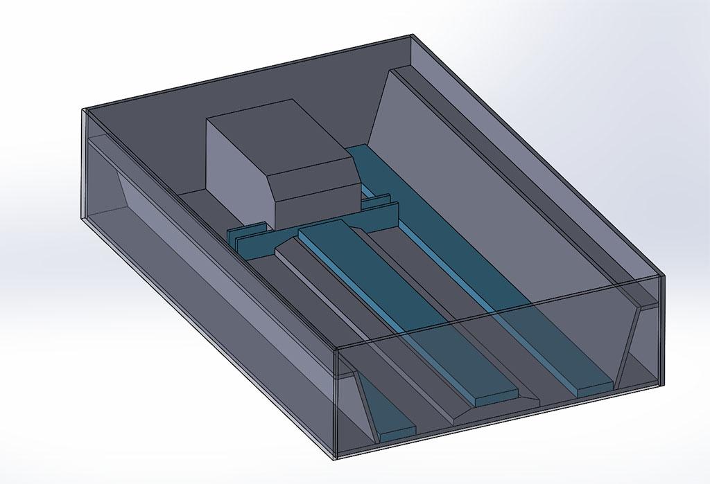

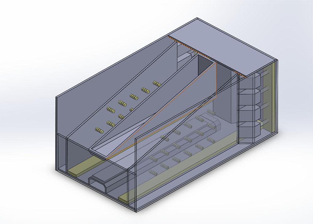

« Reply #83 on: March 16, 2015, 04:12:54 PM »
So while waiting for the handymans to complete my new workshop floor, i continued making drawings..
Molds for base and pillar, so i know how much sheet will be used..

« Reply #85 on: March 17, 2015, 06:10:15 PM »
A rough guestimation puts it in the 350kg range, and the base at around 400kg, table in and around 75kg and the head casting around 90kg..
The idea with the molds is to brace them with 45x90 and load straps for cargo.
