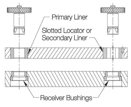

That palette is 400mm x 400 x 40mm mm palette. The idea of it is to have a quick lock system with 4-5 screwed inserts. (see attachments).
