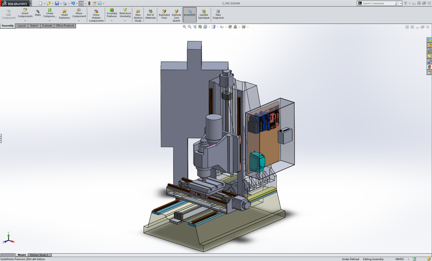

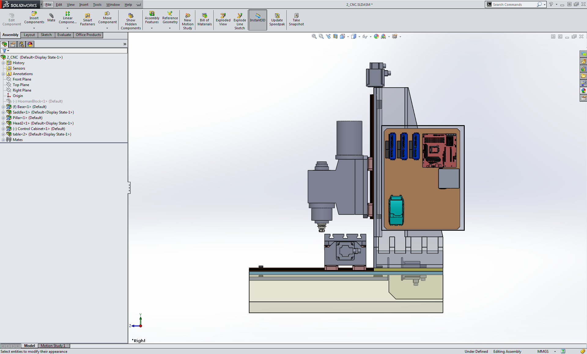

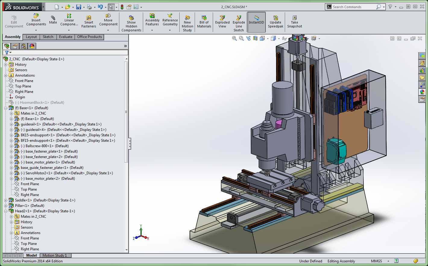

Here is some design iterations...
Head is redesigned, the frame is bulked up, the hangout from Z is shortened, the table is made smaller for.. well reasons..

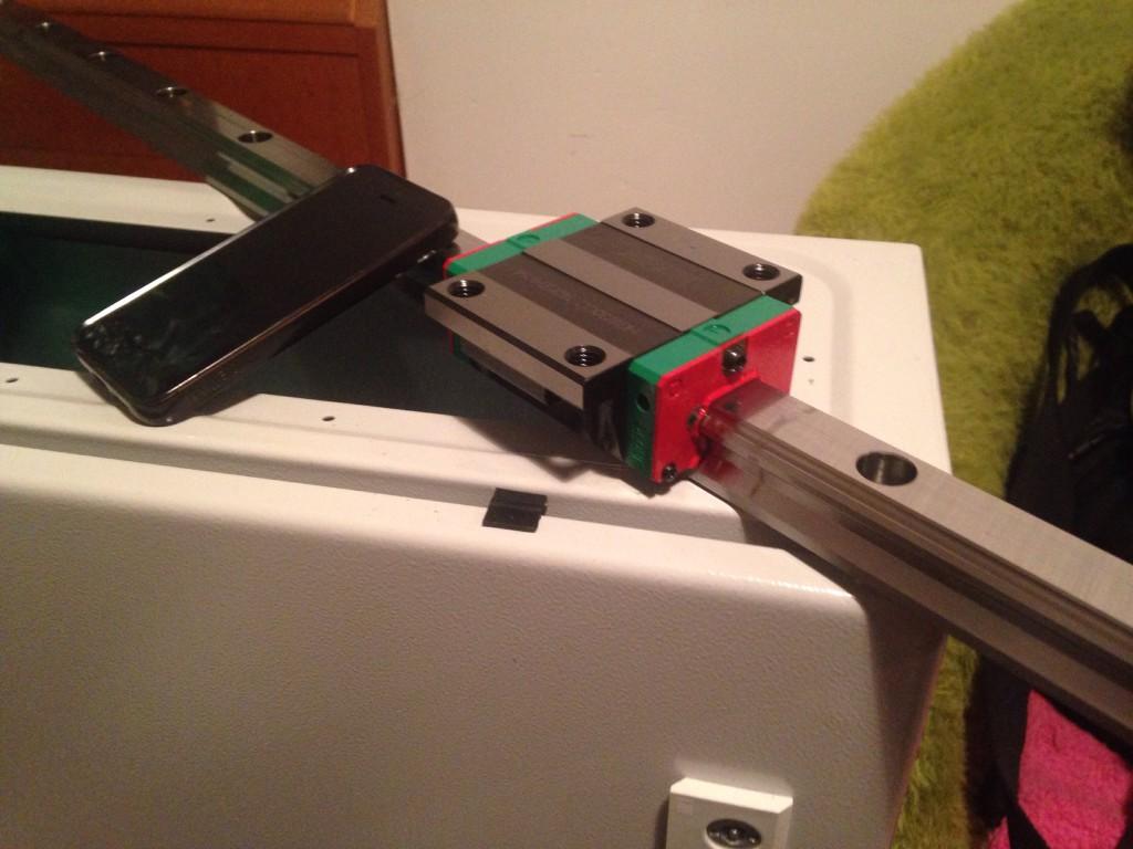

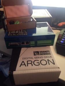

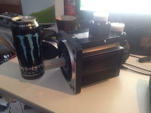

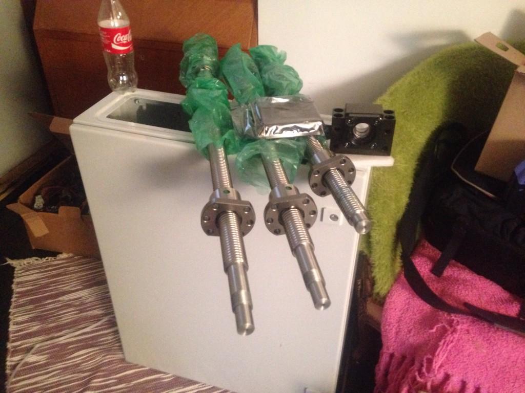

So i thought i should dumpsom pictures.. of stuff sourced so far.
Start with an image of the last design iteration - can be useful i guess.

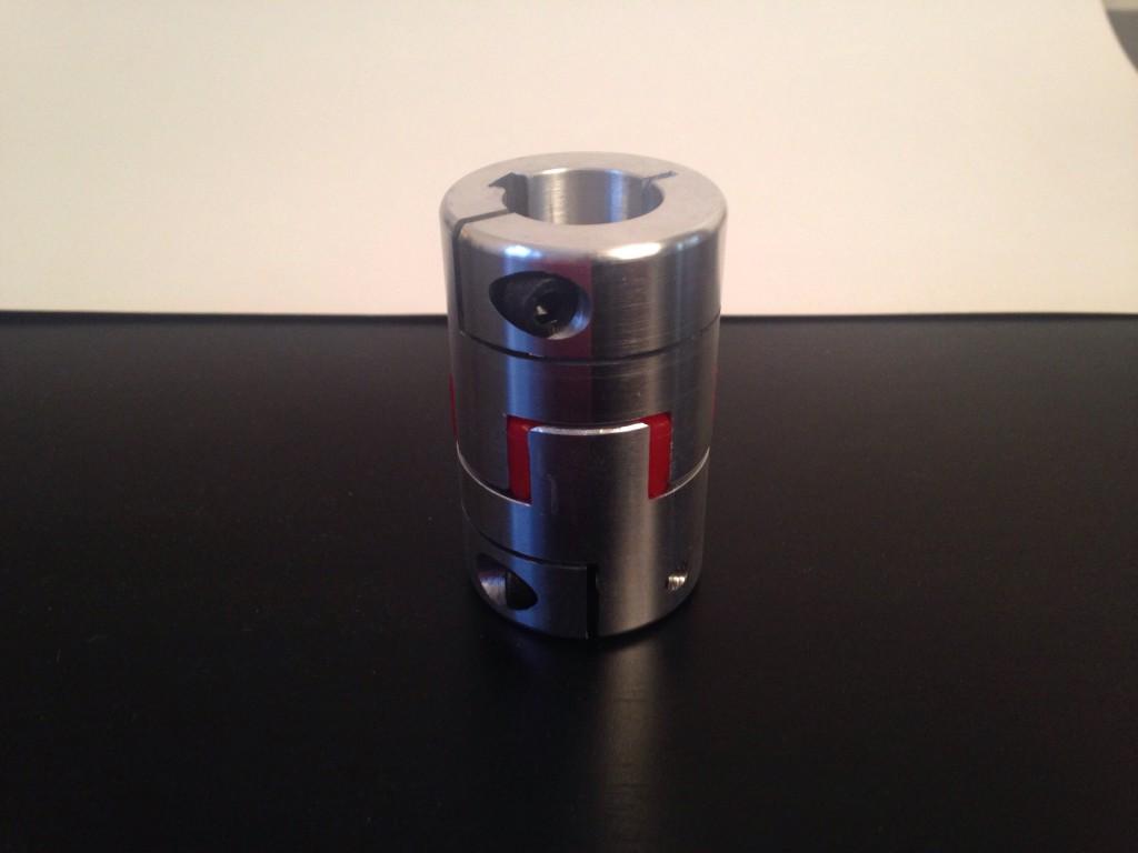

And after that first out, 16 pin connectors for encoders, aviation graded, 1.5kW servo motors for driving stuff around.
Granitedevices Argon Servo drivers, these i got for a hefty discount, thank you Tero over at granite.
And lastly a 6i25 + 7i77 + 7i84 MESA card setup, i first bought a parallell kit of this and couldnt find any good info - so thats a waste of money. But this should work.
Then cabinette., Hiwin 30mm rails with heavy load carriages and heavy preload, second 32mm ballscrews with double nuts and a 5mm pitch, and lastly claw connectors as im planning to directdrive this in the first iteration..
I need to get my hands on a 5.5kW Spindle servo motor that runs 3000rpm minimum - if anyone can scrounge up one for a good price point please gimme a shout.
And im still haggling over the BT40 spindle housing and pulleys with the chinese lady.. that drive a hard bargain.

Hard earned is a stretch.. most of this is chinese actually.. not the cabinette - cuz that thing weighs a ton..
The most expensive is the Argon drivers.  =)

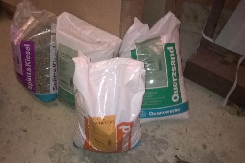

Hi Neotech,

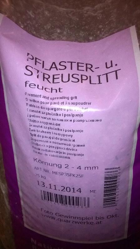

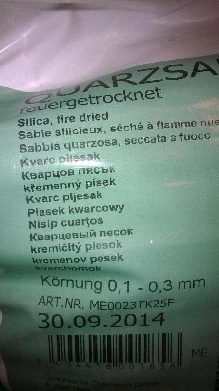

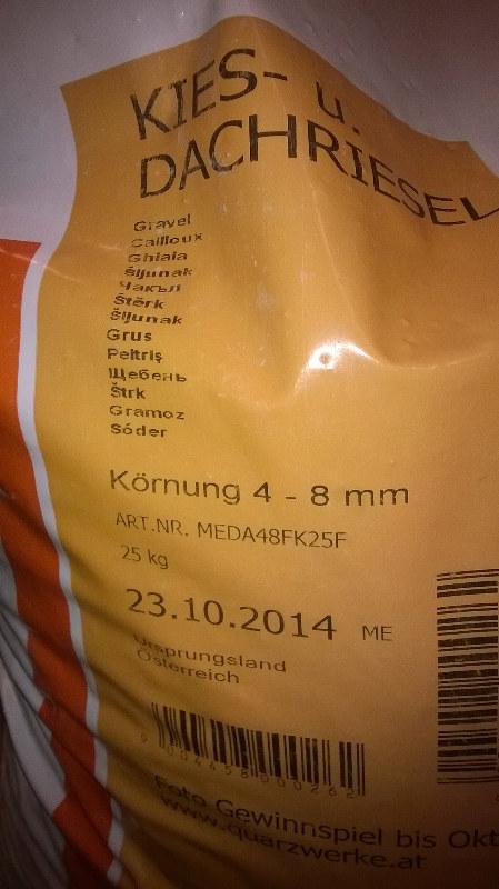

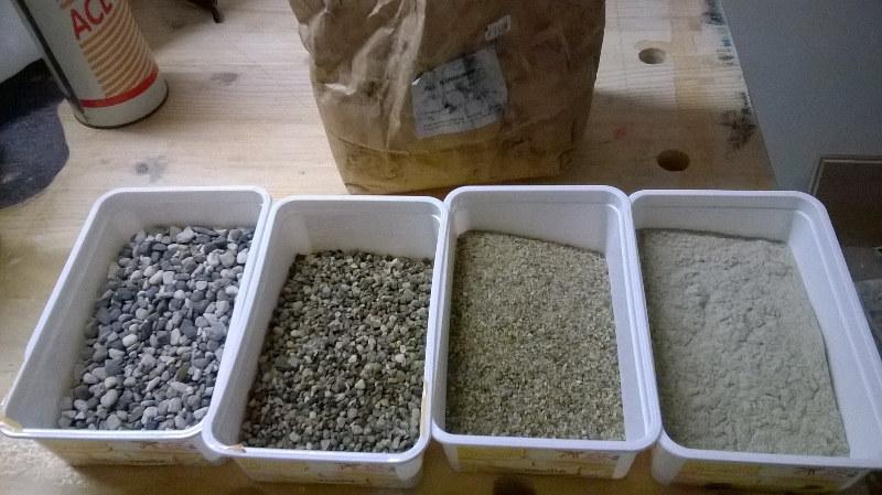

After I received a copy of Thomas Zietz GradingCurve.XLS, I had a look at what my local hardware store had which would be useful aggregate. From the garden section I got 4x 25 Kg bags as follows:
5-8mm pebbles - http://www.quarzwerke.at/datenblaetter/Quarzkies_ME_5,0_-_8,0.pdf
2-4mm crushed rock - (No data sheet - this stuff is sharp edged crushed rock for spreading on the icy footpath)

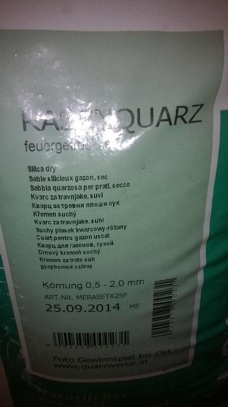

0.5-2mm quarz sand for improving your grass - http://www.quarzwerke.at/datenblaetter/Quarzsand_ME_0,5_-_2,0.pdf
0.1-0.3mm quarz sand for grout - http://www.quarzwerke.at/datenblaetter/ME23-Beschichtung.pdf
Cool that the local quarry which supplies them publishes the datasheets with the screen sizes. Total cost of that 100kg was about €13.

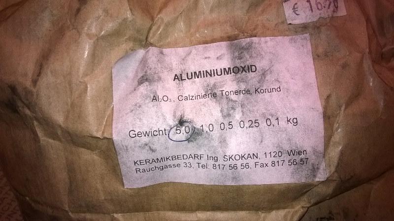

I still have some very fine alumina from making a furnace, so that will be my finest filler. It cost €16,50 for 5kg from a pottery supplier.
So without even driving the 50km to the quarry, I could pick up a ton of aggreate for about €130 five minutes from home, although the alumina would get pricy for that amount.
Using the grading spreadsheet, it gives me the following recipe to make up a liter of Polymer concrete:
Grain 5    6,35 mm   100,00   26 %   259 ml   399 gr
Grain 4    3,00 mm   74,09   26 %   263 ml   403 gr
Grain 3   1,00 mm   47,74   20 %   203 ml   350 gr
Grain 2   0,25 mm   27,42   16 %   157 ml   243 gr
Grain 1   0,03 mm   11,74   12 %   117 ml   197 gr
                                100 %1000 ml   1592 gr
The two largest aggregates are wet, so I am drying some in the oven. I read that moisture has a very detrimental effect on E/G strength.

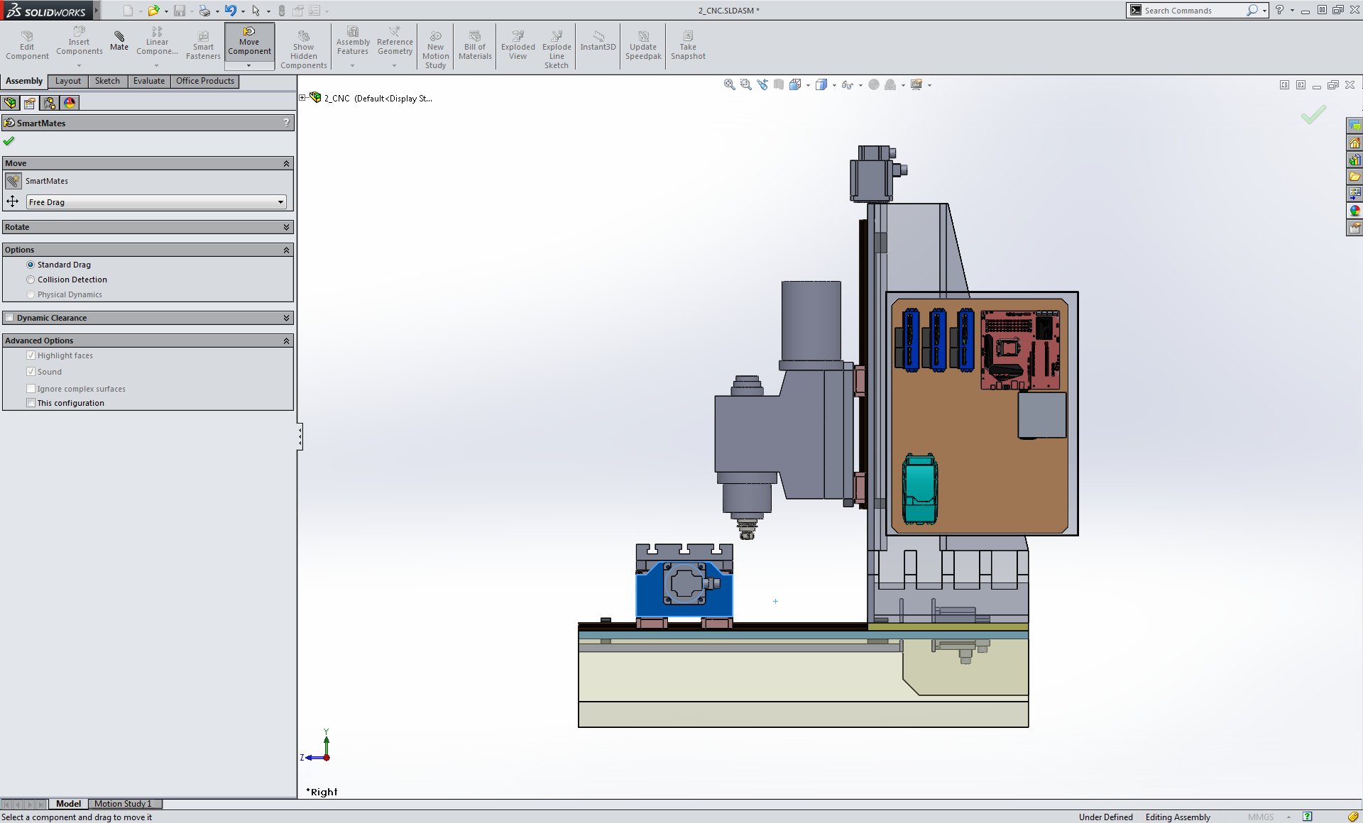

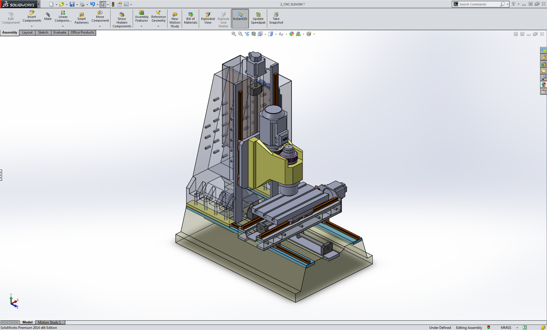

Just more design iterations..
Added anchors, changed the table, by adding 5mm to the platten of the saddle, fitted the ballnuts and figure out travels and such.
Will need to start making the way covers now to see how many i will need to make.. if they are gonna be thin and short there will be a shitload of them. *grmlbl*

« Reply #45 on: February 22, 2015, 03:59:12 PM »
Your x bearing blocks look far too close together.
I just cast a polymer concrete test bar. Added 5g of carbon black from an old printer toner cartridge. Made 1.2kg of E/G nice and black. 10% epoxy was stiff but still sagged why a little vibration. I just tapped the mould on the floor for a few minutes. With a proper vibrator 8% epoxy should be fine.
I mixed in the aggregate from fine to coarse. The first and last were hardest to mix.
Mark

« Reply #46 on: February 22, 2015, 04:12:03 PM »
Ah well, i cant fit them any other way, its wide heavy load bearing blocks. on a 30mm rail. So it starts to interferce with other stuff when moving around sadly. So its a bit of a compromise.
So the question comes to then i guess, can i conjour up a vibrator for a 300kg casting.. i have a 0.75kW electric motor that maybe could do the trick.. 1450rpm, a slightly offseted weight out of some aluminium roundstock maybe works?!
Got any picks of the brick? =)
Re: The CNC experiment build.
« Reply #47 on: February 22, 2015, 04:20:12 PM »
Mark
Neotech,
I noticed that too. When working at the ends of the table it's cantilevered. I think I would have the rails attached to the table and the blocks attached to the saddle. To do this you'd probably have to fix the screw to the table and the nut to the saddle. This way the spindle is always centred between the bearing blocks.
Just my 2p worth.

« Reply #48 on: February 22, 2015, 04:26:26 PM »
Have actually considered that approach.. should prob. take me the time to cad that out as well. Just redone the table like 10 times already so. =)
Would also allow for a smaller saddle with no overhang im guessing.
One of the issues i have is getting thick plate cut and drilled or even get hold of it. Its a bit why i approached the table like that. But i should reconsider that - and see what a slab of castiron cost actually.

« Reply #49 on: February 22, 2015, 04:38:03 PM »
Normally, on the rigid industrial CNC's they put the blocks on the ends of the table and the rails on a fully supporting saddle. That gives the most rigid configuration. The way you have at now, you have the disadvantage of a full length saddle, with the low rigidity of bridgeport saddle.
