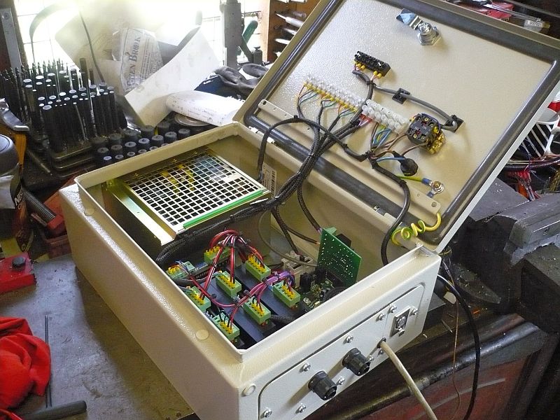

Re: Tiny CNC router
« Reply #40 on: April 25, 2011, 10:16:54 AM »
Yup, I think so too   :headbang:
I have just finished this.
And before anyone asks the fan is at the far end blowing into the power supply
John S.

Offline j45on
  • Posts: 380
Re: Tiny CNC router
« Reply #42 on: April 25, 2011, 10:35:53 AM »
Hi Kwackers

« Reply #43 on: April 25, 2011, 10:46:08 AM »
John S.
Very profesional John  :bow: (makes mine look like a birds nest that fell out of a tree and got run over)
What is it going to control ?
Jason
