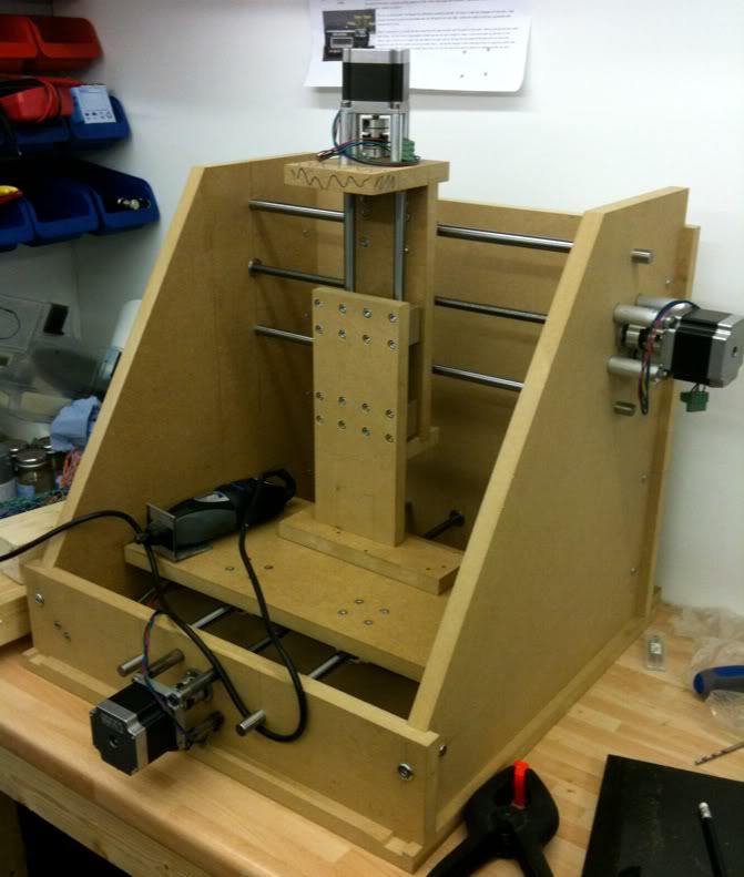

« Reply #78 on: May 01, 2011, 03:30:18 PM »
It's getting there slowly  :poke:
You might notice the design feature which is the back panel  :palm: ( I damaged the first one and then cut a new one to short  :doh:
The bed will have another ( sacrificial ) layer of MDF on top
http://i602.photobucket.com/albums/tt102/ja2onx/mk2-2.jpgTiny CNC router
http://i602.photobucket.com/albums/tt102/ja2onx/mk2-1.jpgTiny CNC router
http://i602.photobucket.com/albums/tt102/ja2onx/mk2-3.jpgTiny CNC router
I'm waiting for some Z axis linear slides I need two more
I need to make some more anti backlash nuts
Fit limit switches
Bolt frame to base
Make some bearing retainers ( the self tapping screw I used on the last one is not good enough for this )
Find some MDF sealer ( I don't want to paint it just protect it )
Jason

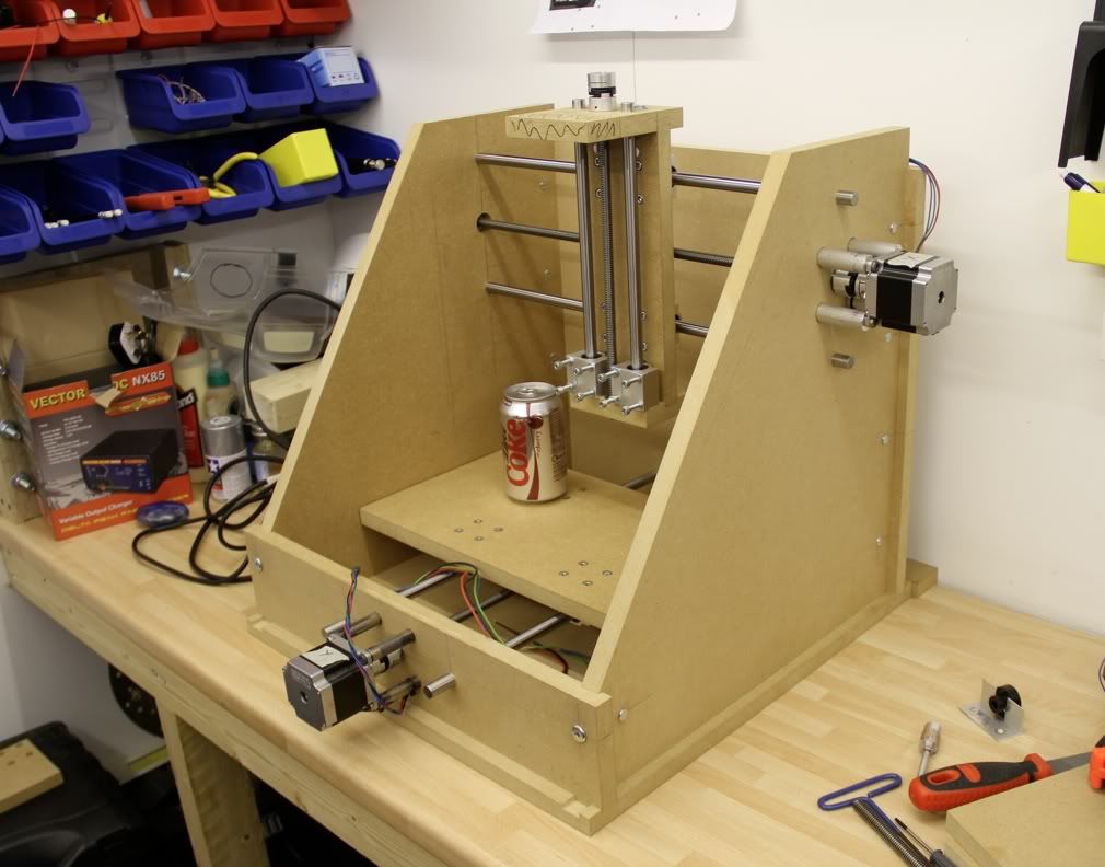

« Reply #79 on: May 07, 2011, 03:47:27 PM »

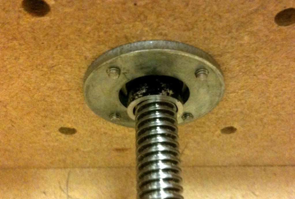

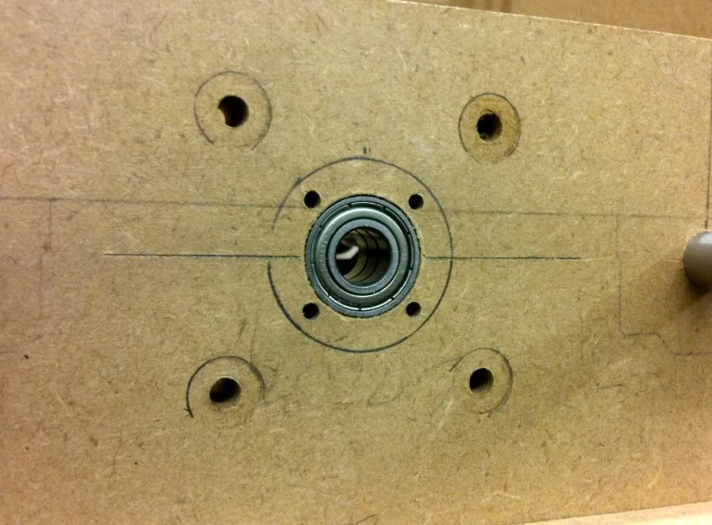

A few more piccys it's nearly finished (maybe tomorrow  :ddb:)
http://i602.photobucket.com/albums/tt102/ja2onx/mill-2.jpgTiny CNC router
For the lead screw bearings I went with three in the end as they are the same thickness as the wood
http://i602.photobucket.com/albums/tt102/ja2onx/mill4.jpgTiny CNC router :drool:
these are clamped tight with tow bar washers on either side using 3mm pan head screws
http://i602.photobucket.com/albums/tt102/ja2onx/mill3.jpgTiny CNC router
http://i602.photobucket.com/albums/tt102/ja2onx/mill2-1.jpgTiny CNC router
Jason

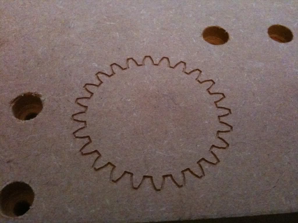

« Reply #85 on: May 14, 2011, 04:55:19 PM »
I have finally finished the router  :ddb: ( well nearly, I still have to add Z axis limit and home switches  :hammer: )
Unfortunately I did not record the running video ( I thought I had  :palm: ) so you will have to make do with a picture instead
http://i602.photobucket.com/albums/tt102/ja2onx/16f76c30.jpgTiny CNC router

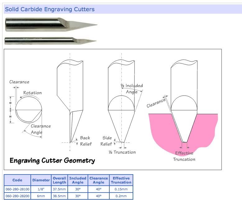

I will try something a bit more adventurous tomorrow but I only have an engraving bit at the moment http://www.arceurotrade.co.uk/Catalogue/Cutting-Tools/Engraving-Cutters
PS: the Makerslide I posted previously is now 181% funded  :ddb:
Jason

« Reply #87 on: May 14, 2011, 05:41:59 PM »
Hi John
I think it was about 50mm and half a mm deep, I cut it with a 1/8" one of these it's all I have at the moment
http://i602.photobucket.com/albums/tt102/ja2onx/Screenshot2011-05-14at223510.jpgTiny CNC router
Jason

the cutter looks simple enough to make your self
if you have the grind stones for carbide ( green grit stones ?)
although it will only worth it ,if the carbide blank  is cheap enough
I expect they should be OK cutting the copper on PCB's

John,
Those cutters are not a thing you could grind up by hand, just like the side flutes on a milling cutter. They are fed not only forwards, but sideways into the wheel at the same time, it is that which gives the cutter it's clearance at the back.

Yes john you are right ,I didn't mean free hand ,but with just one cutting edge it would be easier than attempting a multi fluted cutter
the process I had in mind is to first grind an eccentric cone ,with the tool held in a live spindle
then using a fixed jig(s) to remove half the cone ,then grind the clearance at the cutting edge

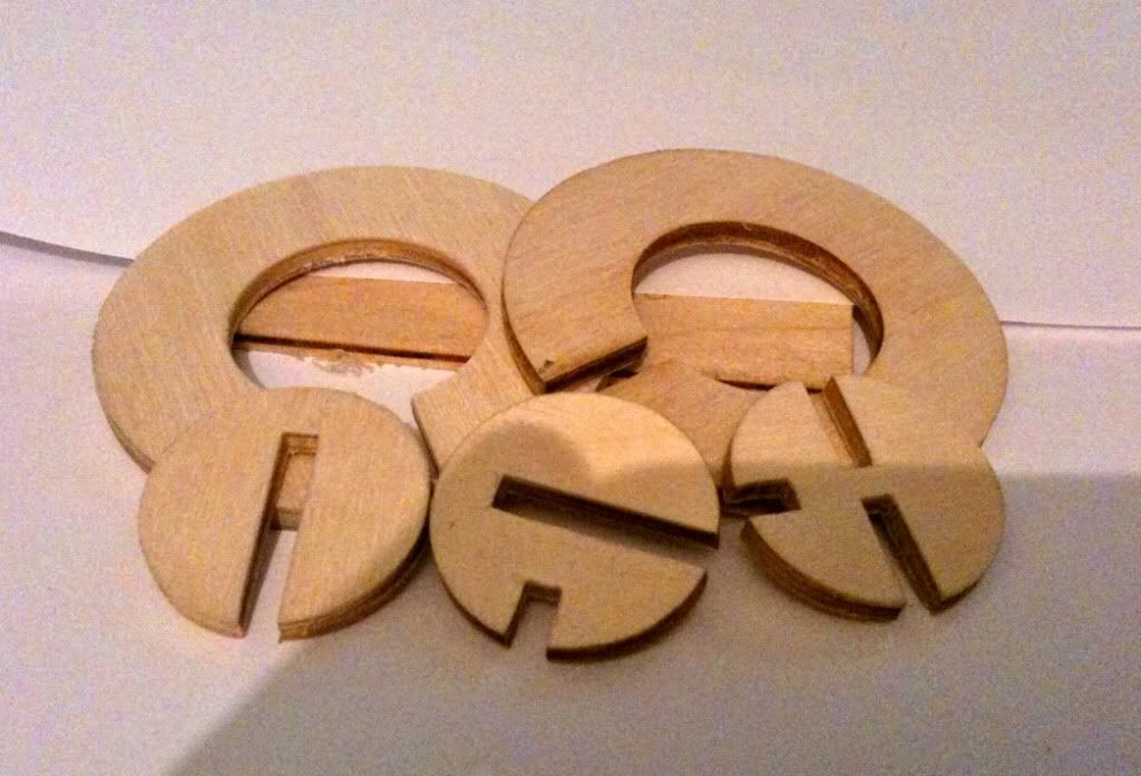

« Reply #93 on: May 19, 2011, 06:25:59 PM »

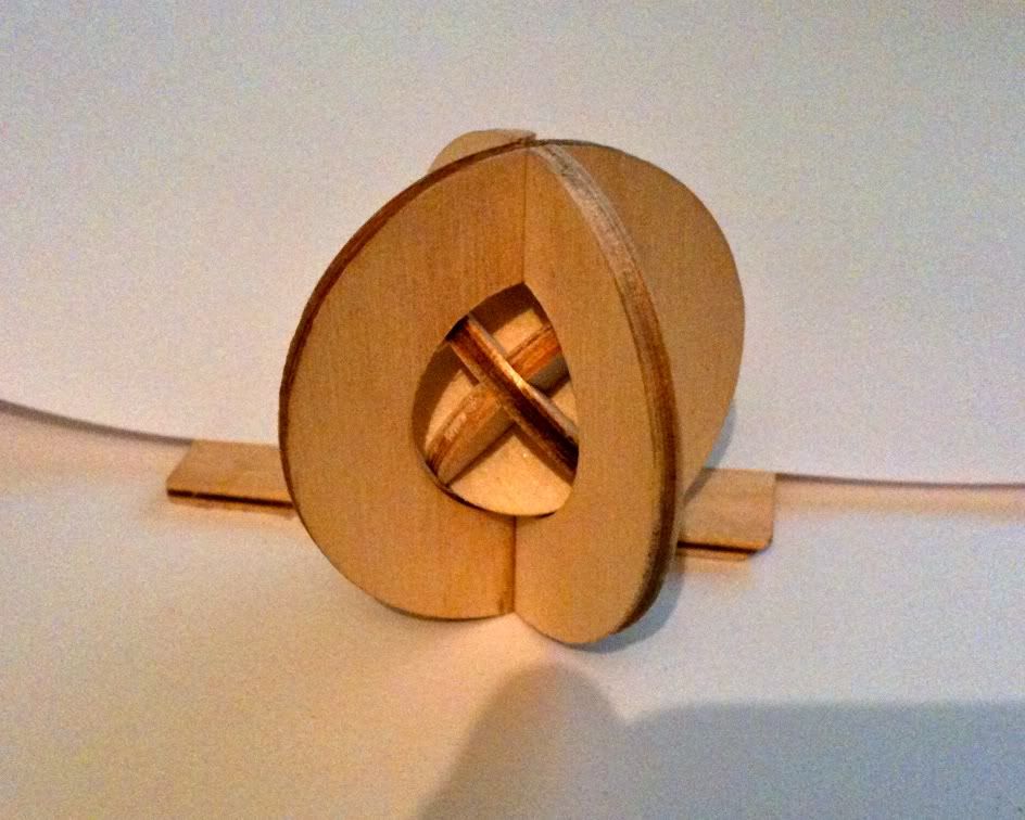

Finally I have made something other than saw dust with this router   :D
It's a small puzzle made from 3mm ply wood about 2" round
http://i602.photobucket.com/albums/tt102/ja2onx/puz1.jpgTiny CNC router
http://i602.photobucket.com/albums/tt102/ja2onx/puz2.jpgTiny CNC router
Terrible pics but I only had my phone to hand
Jason

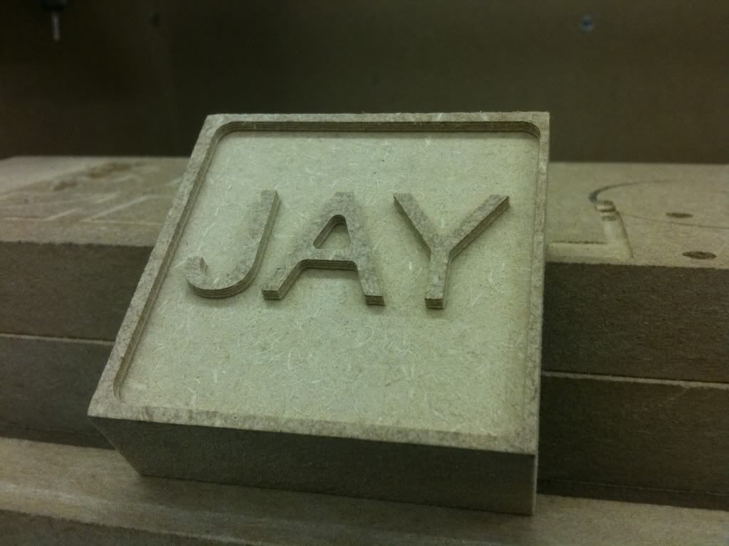

Chuck I'm only doing it for fun I have no real use for it   :D
But I'm sure I will find uses like isolation routing PCB's, cutting openings in project boxes
Making wooden puzzle boxes.
My sister makes silver jewelry and is already asking me if I can engrave items for her
This is today's experiment  :ddb:
http://i602.photobucket.com/albums/tt102/ja2onx/45c19482.jpgTiny CNC router
Jason
