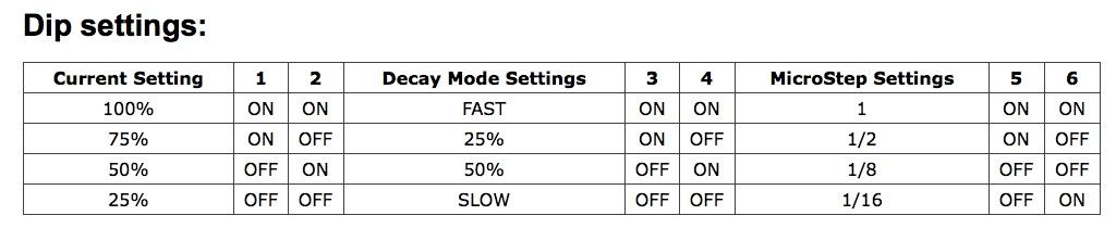

Chris I am happy with the motors and controller for this machine but I have to keep the motor speed down or they make random thumps  missed steps ?
I did see a video on how to confirm missed steps in mach3 but I cant find it now  :palm:
For a larger machine needing more speed and power it may not be a good choice I think you might run into the problems mentioned previously but I'm no expert  :scratch:
The motors are also very noisy when idle not quiet like the stepper on my rotary table
Here is a video of the noise
Can any one explain in simple terms what "decay mode settings" are for  :scratch:
I am running 75% current and 1/8 microstep if that helps

Offline John Swift
  • Posts: 344
Re: Tiny CNC router
« Reply #55 on: April 27, 2011, 04:57:31 AM »
Hi Jason ,
its good to see your making progress
I've found a tutorial at stepperworld tha may help you understand the current decay setting
I would of expected 25% or 50% to be a good compromise ??
http://www.stepperworld.com/Tutorials/pgMicrostepping.htm
reference made to Allegro  in tutorial ,
   A3979 data   http://www.allegromicro.com/en/Products/Part_Numbers/3979/3979.pdf
