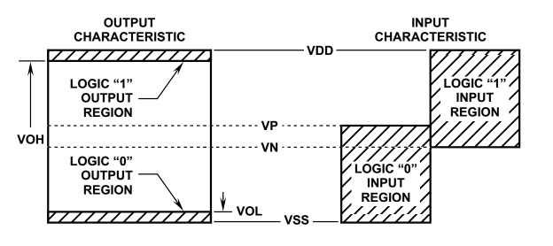

But in the mean time, I tested one more thing with the current mechanical setup. This time the output is from the schmitt triggers. Some equalisation to brighten the sound, and a hint of reverb was added:
http://www.elisanet.fi/kz1706/optical_pup/schmitt_trigger_test_.mp3
Those 4093-based schmitt triggers seem to work really well, cutting all the noises out. Major problem is the mechanical setup(as it relies on the reflection from the strings), which requires the ir-leds to be driven hard enough to make the trim pots quite warm.

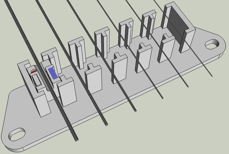

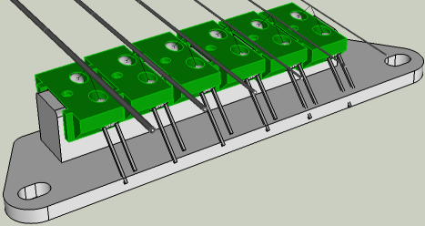

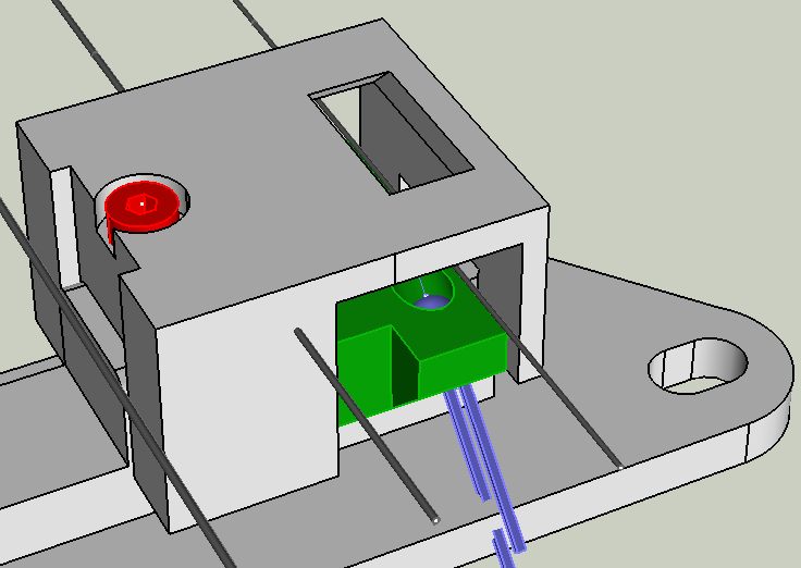

When that previous mech setup was in the guitar, at the time I didn't think of the thing, that could extend its usability. But now it seems obvious: simply add reflective cover above the strings, that could be easily removed at will, to allow 'normal' access to the strings like this:
  [ You are not allowed to view this attachment ]  [ You are not allowed to view this attachment ]
It should eliminate the effect of the waving hand above the pickups. Also, while testing that setup, there was momentary, audible peaks on the output, when the plucking hand was resting over the pickups.
Again another factor, which I didn't consider, while concentrating on other things with that setup. But when thinking of it, if there was a smooth, reflective surface above the string, it could add more reflections from that very string, and somehow improve the overall infrared 'flux' from the sender to the receiver, in form of increased output with lesser amperage used by ir-leds.
All that is just an assumption so far, but it seems that I have to revisit that setup to find out.
That setup uses 120 degrees between the sender/receiver, making it bit too wide/large. The narrower 90-degree setup could have similar output. But as always, plenty of testings ahead.

......... But when thinking of it, if there was a smooth, reflective surface above the string, it could add more reflections from that very string, and somehow improve the overall infrared 'flux' from the sender to the receiver, in form of increased output with lesser amperage used by ir-leds. ..........
sorveltaja,
If you're going to try this wouldn't it be better to include a dividing wall between each string to prevent (or at least reduce any crosstalk)?

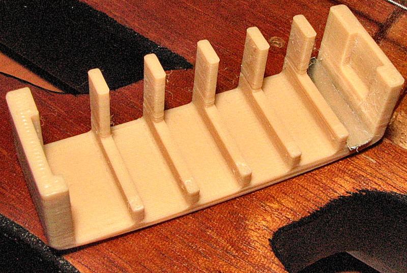

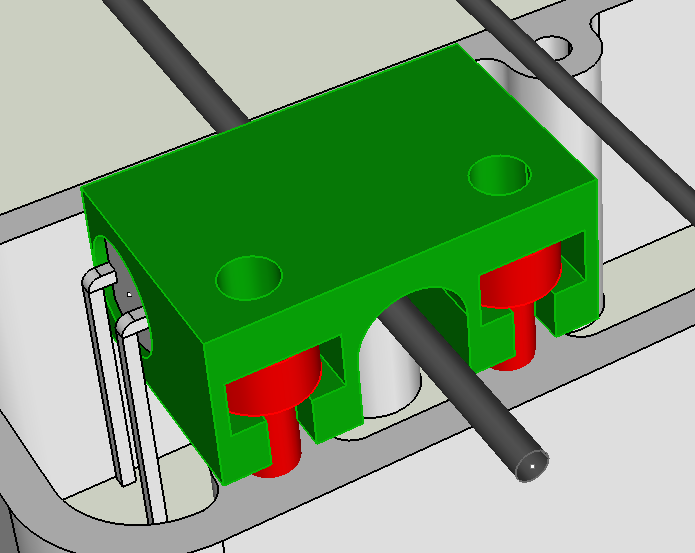

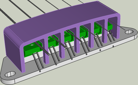

Offline sorveltaja
  • Posts: 684
Re: Diy optical pickup for guitar -- is it possible?
« Reply #78 on: January 13, 2020, 03:51:53 PM »

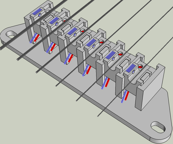

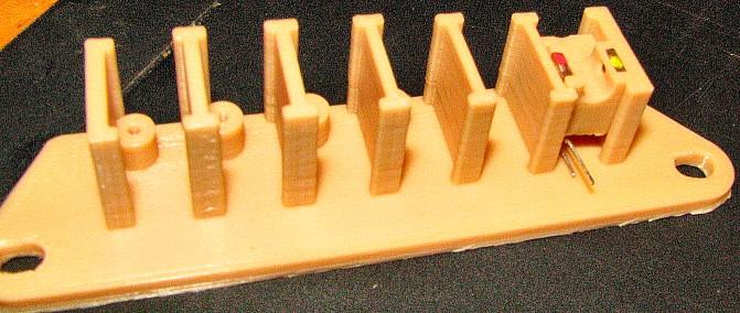

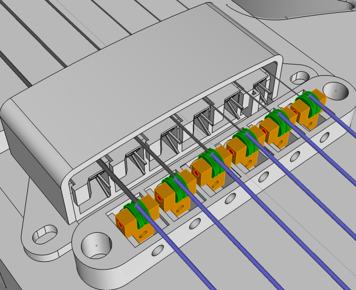

Phil, that's a very good point. After a bit of sketching, the 90 degree setup, and then same with a cover:
I added 'legs' to one side, which rest on the base, so that the cover doesn't flex when the plucking hand rests on it. I might add legs to the other side as well.
Although on the picture, the surfaces, that face the strings, are a little bit curved, they probably should be flat, to get straighter reflections.
Do the flat, reflective surfaces still need some kind of fine adjustment option for alignment, can't tell yet.
What comes to the reflective surfaces, I guess they should ideally be mirrors. But that is really difficult to achieve, unless one has a very good skill in glass cutting/forming.
Instead of that, well polished, flat metal surfaces could do the trick. Maybe even shiny enough paint, or aluminum foil.
On the other hand, infrared light could have other reflecting properties, that may not be so obvious, when compared to the visible light. Haven't go into that too much yet, but the output differences should be measurable, when testing materials for reflection with ir-led/phototransistor(or photodiode) -pair. I'm looking forward to test it.
But before that, I have the older kind of mech setup in the guitar, so I'll test, how it works. Today I got the ordered missing ic's for the amp circuit, and if all goes well, it should be possible to test, how all the six strings sound together.

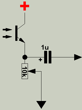

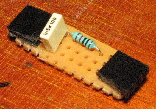

For 'mixing' the string outputs together, I simply used 'passive' one with 10k resistors for each output, when recording the previous audio clip. Schmitt triggers were used, and as their output levels are equally 'loud', not really need for adjustment between the outputs. Basically It's like three(later six) independent square -or rectangle wave oscillators.. well, oscillating together.
« Last Edit: September 29, 2022, 09:51:48 PM by vtsteam »

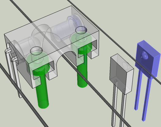

Offline sorveltaja
  • Posts: 684
« Reply #79 on: January 14, 2020, 09:45:18 PM »

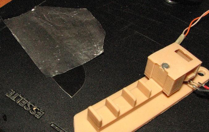

After thinking of testing the rest of the older setup, mentioned in previous post, which was similar to this:
-- I already know, that it should work to some extent so far, and is something to get back to, if other mech/optical configurations fail.
I got curious, of how the reflections could possibly improve the infrared 'flux' of the 90 degrees -kind of setups, which otherwise require the senders(ir-leds) to be driven at higher amperage, to get usable output, if relying only for the reflections from the string.
So I sketched a simple setup to test, how different materials reflect that ir-light. It has a 5 x 10 mm 'window', where to put different materials. That setup is on the table, instead of guitar:
As a reference, I use a special, 8mm wide mirror from the old scanner. What makes it 'special', is that on the other side it is like normal one, that has a glass between the reflecting surface, and looker.
On the other side, no glass, only dead flat mirror surface. I tried to take pictures of it, but the camera sees it as a black/dark object.
But, after all, that kind of mirror isn't required/needed for the testing. Plain shiny aluminum foil gave about the same results, when the sender was fed with 400Hz square wave.
That was after rather quick testing, but the infrared 'flux' could be improved that way.
How all that stands, when that setup is in the guitar, with the actual vibrating string added to the ir-beam, I can't tell until more testing.
« Last Edit: September 29, 2022, 09:47:59 PM by vtsteam »

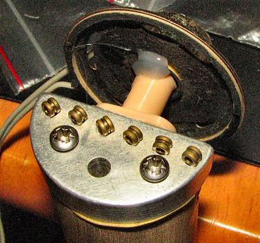

Offline sorveltaja
  • Posts: 684
« Reply #80 on: January 16, 2020, 08:59:43 PM »

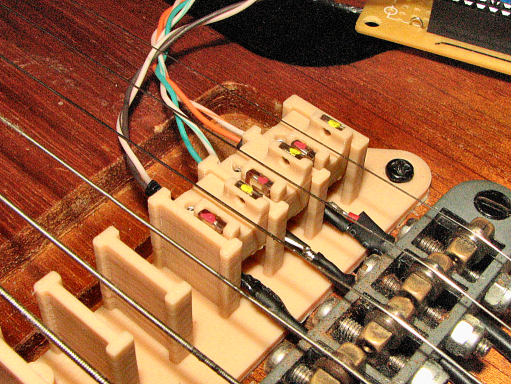

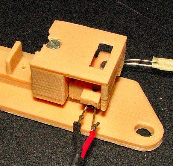

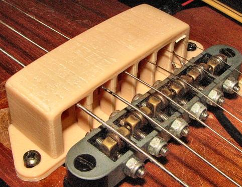

The new 90 degree mech/optical setup is ready for testing, for the thinnest string(0,25mm). For the reflective material, I glued aluminum foil to thin cardboard, so that it's easier to handle, and to cut to suitable size.
Then it was tested with the previously mentioned test-setup. Again, the input ---> output -results were close to mirror-like surface. But when looking that aluminum foil, it doesn't seem that 'mirrorish', though.
It could be carefully polished, but I'm thinking of replacing it with thicker brass, or aluminum, which should be a lot easier to polish, although they should be sawed and filed to the size.
Bit of work, but not a big deal.
The cover with alu foil glued in. There were thinner legs on the front side, but I managed to snap couple of them out, while sanding the upper surface(it was printed upside down).
But the overall construction feels rigid enough without them, so I snipped rest of them away also:
I certainly hope, that this setup, even with cover in place, works, as it feels somehow very 'natural', without the feeling, that something is protruding between the strings:
After some testing with the thinnest string(without schmitt trigger), there was output, but it wasn't easy to locate the factors involved(as I have a nasty habit of starting at the hardest point available ).
But after all, it looks promising enough for this setup; so the next step will be the thickest string, that has a lot more output to boot, to hopefully get a bigger picture, of how that setup works.
« Last Edit: September 29, 2022, 09:43:27 PM by vtsteam »

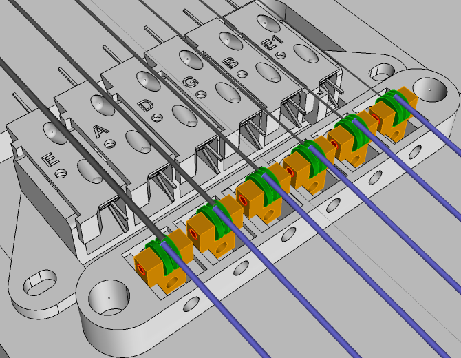

Offline sorveltaja
  • Posts: 684
« Reply #81 on: January 18, 2020, 08:40:54 PM »

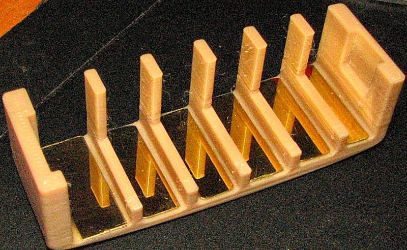

The cover is now ready for testing all the strings:
Aluminum foil was replaced with 0,25mm brass. The brass sheet was first treated with dremel and polishing compound, and after that, the pieces were sawed with a fret saw to size.
Bit of filing to remove any burrs, and that's it.
There is one thing though, when handling polished brass like that. To avoid any fingerprints on that shiny surface, straight after polishing, I covered it with a tape.
After sawing and filing, it was peeled off, before gluing the pieces in place.
Although the brass surfaces on the above picture might look like mirrors, they are actually quite 'shady'. But, after all, if aluminum foil performs well enough, polished, more solid metal surface should do even better. So fortunately, no need to go crazy with the polishing.
With this mech/optical setup, there are a lot of options to test. One being like this, where the distance, and angle between sender/receiver could be altered, while still using that very same 'base platform':

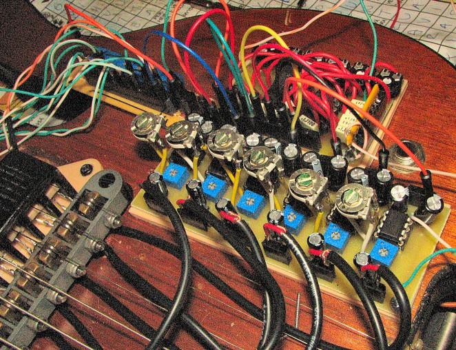

At this point, when the amplifier circuit is completed(although not perfect, but good enough for now), as well as the schmitt trigger one, a very basic kind of 'foundation' finally exists.
With that in mind, it allows one to dive more into other factors of testing, like producing a stable signal from the string(s), that could be a lot more easier to measure, than simply plucking the strings.
One of the reader mentioned earlier something, that reminded me of a 'sustainer', that is used to input the string(s) signals, and fed back to the speaker-like 'exciter'(under the strings), to make them 'sustain', or ring constantly.
I'm considering of making that kind of sustainer for a single string use, that could be fed with open string's fundamental frequency with a function generator.
One heck of a side project, but the concept isn't actually new for me.
« Last Edit: September 29, 2022, 09:37:40 PM by vtsteam »

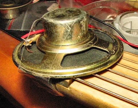

It seems, that the 'resonator' to make the string(s) constantly ringing, while adjusting/measuring output of the pickups, doesn't need to be that complicated, as I expected.
Using small 8ohm speaker and function generator, I tested, what could be the position, to get the strings to respond to speaker signal.
So far, at end of the neck, where the guitar's headstock usually is, turned out to be the best location. My guitar is a decapitated version, so it doesn't have a headstock, but I managed to tape the speaker so, that it doesn't touch the strings:
That way the speaker makes the neck and body resonating, and therefore, also the strings. I guess, that it would help to have a headstock, with a mass in it to make the neck resonate even more.
Even that small speaker works, although a bit bigger one could help with higher frequencies, that the thinnest strings use.
I have another small 8 ohm speaker, and maybe I'll add it in series or parallel with the one already in use, to hopefully get some extra resonating power.
As one could expect, thicker strings resonate/vibrate a lot easier, than the thinner ones, which require the speaker(s) to be driven harder.
I'm not sure, if driving the speaker(s) straight from the function generator is a wise thing to do, for a long time period. To play it safe, I'm going to breadboard one of the 386- based amps to drive them:
Some things, of how to get the strings to respond to the fed signal: the signal itself should be in sine wave -form, as the wooden parts of the guitar do not seem to respond to (somewhat unnatural) square/rectangular waves that well.
Also, the signal feeding the speaker(s) should be 'tuned' for each string's fundamental frequency, to get them to resonate. That is, when testing one string at a time.
Although the setup is fairly simple, a sine wave generator, that has an option for fine tuning for the frequency, is highly recommended.

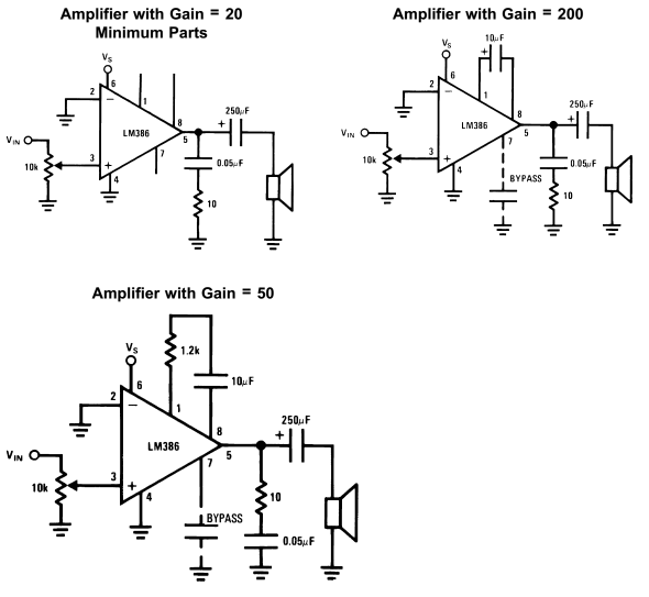

I tested the x200 gain configuration of the 386-amp, to drive the speaker, and it clips and distorts the fed sine wave, even at very low levels, making it useless for the purpose.
So next is going to be the mildest, x20 version.
I have also looked a way to improve the way, of how the vibration is transferred to the guitar body. There is a thing called 'vibrating speaker', which could be made using a sacrificial speaker.
As I have one, that's what I did:
I did cut the cone on the edges, and hot-glued random, printed left-over t-piece to the center of it. As the piece, that holds the strings, is made of aluminum, I used superglue to attach the assembly to it. Removal is easy, just knock it out.
It works bit better now. I have only three thickest string's pickups in the guitar so far(need to prepare rest of them also), but for them, the signal is more than enough. One of those strings, when tuned in, actually starts to buzz like sitar string, and the signal, that is fed, must be turned down, to get cleaner output. All that by abusing using only the function generator to feed the speaker.
As always, plenty of testings ahead, before usable end-results.
« Last Edit: September 29, 2022, 09:31:41 PM by vtsteam »

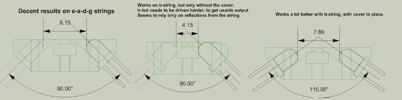

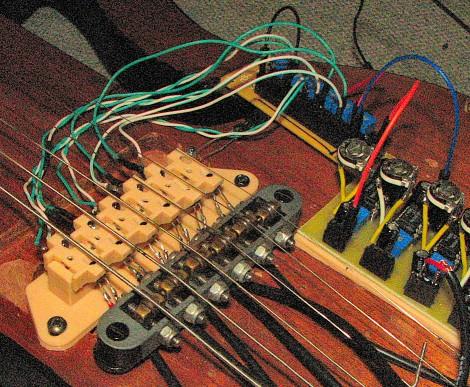

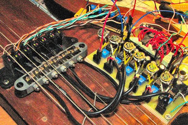

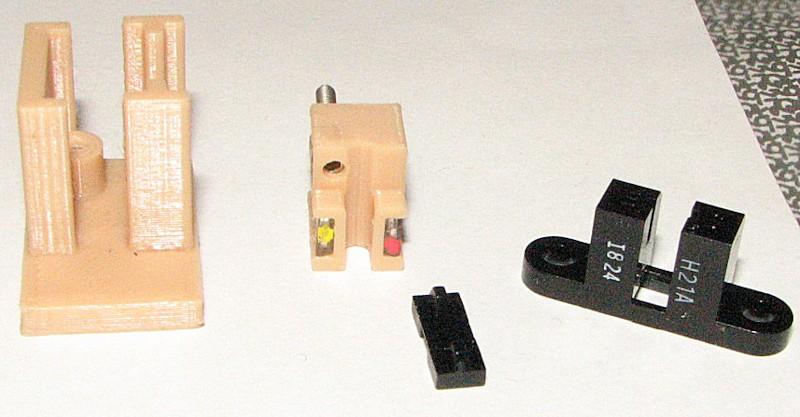

Some observations, while testing. First the overall base setup for all the strings:
To avoid confusion about the guitar strings(with a standard tuning), they go from thickest to thinnest; e-a-d-g-b-e. Basically just a bunch of different gauge steel/nylon wires, in certain order.
But so far, some results of the three tested setups; first one seems to work on four of the thickest strings(e-a-d-g). That setup doesn't give strong enough output for the second thinnest string(b), though.
Second one is a bit of a mystery, as instead of increasing the output, when cover(with reflective surfaces facing the strings) is on, the output disappears(b-string).
Third one, again tested on a b-string, seems to be a step to the right direction, as it provides more output, when using the cover.
Distances/angles between the optical components on those setups are only arbitrary, but I think still a very good way to get a hunch, of how they behave, and affect the overall output.
« Last Edit: September 29, 2022, 09:29:11 PM by vtsteam »

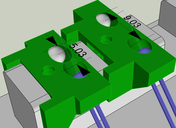

Addition to the previous testing theme; but this time it was done only with the hardest one - thinnest string(another e).
Angle between the optical components was changed, while the distance changes only a bit.
First one is a no-go, but gives good a tip, of what (or what not)to test next.
With the second one, I was aiming for an approximate angle, that would allow the ir-beam to actually reflect straight from the cover's brass 'mirror'. Afterwards it seems obvious, that the results were a lot better:
Needless to say, but although the four thickest strings(e-a-d-g) already give usable output with one of the earlier setup, that 70-degree setup will probably replace them, to squeeze even more output from them.

The whole setup, with almost all wires connected:  [ You are not allowed to view this attachment ]
As for the 6-to1 -mixer for the output of schmitt triggers, I built a stamp-size one, with discrete 10k resistors. But, memory served, and I found a bag of 10 x 10k resistor networks from the shelf.
It was quite easy to make a nice and tiny 'plug-in' unit out of that. It's barely visible in the picture, but it's the orange one, on the upper boards right side, that has schmitt trigger -ic's in it.
Makes me a bit nervous to start testing out a mess like that. I don't expect instant success, though, as there could be hiding some 'cumulative' bugs.
On the other hand, with (almost) all the wires running wild connected, it looks more complicated, than it actually is.
If(when) there is any kind of success, only then it's worth diving into the 'sub-project', to tidy up(or remake) the wirings for something like.. more permanent setup.

Sketch for a new setup for the optoswitch components:
Model of the optoswitch is H21A2 by Isocom. Components came out easily, by pulling the 'lid' open with a sharp chisel, without even breaking their housing:
Sender and receiver were push-fitted in place(perhaps some glue also needs to be used). One with yellow dot is the ir-led, while the one with red dot is a phototransistor. Printed part on the left is a testpiece of the to-be-printed base, to test the tolerances and height adjustment. So far it has gone well, and (hopefully)shouldn't take too long to get back to 'test-bench'.
It may need some modifications to fit the wirings, though. The concept will probably be same, as with previous setup, where the sender's wires come out from one side, and receiver's wires from the other side.
The components work, as expected. The physical specs of those flat components aren't usually mentioned in the optoswitches datasheets.
Although they can be simply measured, in some cases it could be better to see the actual manufacturers spefifications, and tolerances.
Sparkfun has datasheets of Liteon's LTR-301 phototransistor, and LTE-302 photodiode available on their site, as well as downloadable 3d-models, if memory serves. But generally all of those seem to be the same size, after all.

New setup almost ready for testing:
Once the short-ish legs of the components are bent, they fit in just fine. That way, the wires that are to be soldered, stay outside of the base.
By using the smallest size heat shrinking tube, that I have, the legs shouldn't short between each other. But we'll see.

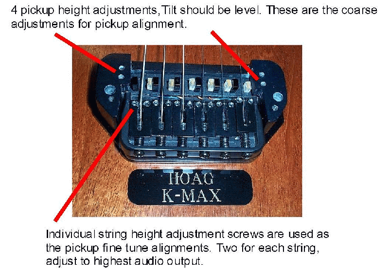

While sketching and printing the parts, I remembered seeing a picture of those flat components used in optical pickup somewhere. So that's where I got the idea.
It was Ron Hoag's invention. I have no idea, of how old that picture is, but if judging it by the thickness of the optical components, they look a lot thicker, so probably not very recent:
Again, making an optical pickup to look that clean, without wires running around, there really isn't too much options, other than to drill holes for the wires to go to the back side of the guitar.
After all, there is very little information available of that pickup/setup. I have found only few sources, one which is on the same site, as the above picture:

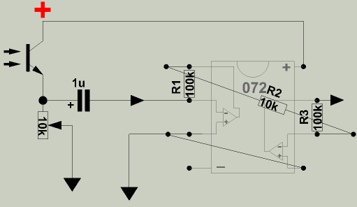

In the past few days I've looked a way to replace the 386-amp board with an op-amp based one. Test circuit(TL072):
It was just thrown together for breadboard, and probably lacks all of the some important components. But as it is, it gives enough output for testing.
Seems to work better by using a split power supply.
But in general, the lack of delivering enough output to keep the schmitt triggers 'squaring' long enough, to make the output to feel more like guitar-ish, still exists.
Then I had to rethink about the whole thing: I have already an overly powerful(and noisy) 386-based amplifier board, which should be more than enough for the purpose.
But in practice, is that much grunt for amplifying the phototransistor's output really even needed, as the end result is still far from usable?

This picture is actually from 40106's(cmos hex schmitt triggers) datasheet, as it's much more clearer, than the old 4093's one:
One thing, that came to my mind, was to bring the input signal between the Vp and Vn, by using an offset, and then adjusting it, to see how low it would go to 'tickle'(trigger) enough both limits.
There might be something in it, but I'll have to admit, that after trying that with a function generator and a scope, there is much more in it.
No matter, which way I tried to test that out, I just couldn't get my head around, of how it could actually be done.
Threshold voltages, although only approximate ones, are on the datasheet, and as the supply voltage is lowered, they lower also.
So the next thing to test was obvious; decrease the schmitt trigger's supply voltage. At 1,8 volts, the input threshold was under 0,1 volts, when testing with a square wave.
Needless to say perhaps, but at that level, the quality of the output never meets any of the standards.
Besides of that, I kept on going, and tested the bugger with a g-string. Yes, the output was a lot lower, but for some reason, 'squaring' was there, and it just kept on doing it longer, than ever before.
And that was by using the above 072-op-amp based circuit.

Latest setup ready for height adjustments of the pickups:
To get reasonably stable outputs from the strings, for adjusting the height of the pickups for max. outputs, perhaps most time consuming part (at least on my guitar) is to track the peak frequencies, where the individual strings resonate, when using the small speaker as a resonator(mentioned earlier).
Using low enough outputs, that don't clip at the amp stage, makes it easier to find sweet spots.
I used to write those frequencies down, but they change from day to day. Not so much between the strings, but all of them have gone in frequencies tiny bit lower.
I guess, that's the way the wooden construction(mahogany body, maple neck) reacts to changes in air humidity.
But enough of that. Only after the height adjustments, it's worth to move on to the electrical side.
One thing, that popped to my mind, when testing, if it's possible to 'palm-mute' the strings, while the cover for the optical pickups is in place.
It is almost possible, but as the printed cover is made of plastic, it has to have some extra thickness in it. If that cover was made of, say, out of 0,5 or 1mm brass sheet, it should allow a lot lower, 'slimmer' cover to be used.
What I mean by that, is that if one uses a traditional electromagnetic pickup, its usability could be expanded, when using it besides the optical pickup.
Making that kind of brass/other metal cover would require some serious skills, that I don't have, though.
On the other hand, one way could be making a mold, and casting some tin in it. Could be too smoky thing to do in my apartment. But, after all, who knows

Besides all that, came another idea of using individual covers for each string/pickup, like this:
  [ You are not allowed to view this attachment ]  ]
I haven't tested that yet, but if it works, the parts could be printed, while being a lot more 'stealth', than single, bulky cover.
