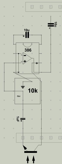

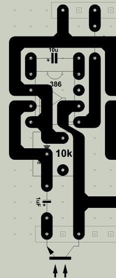

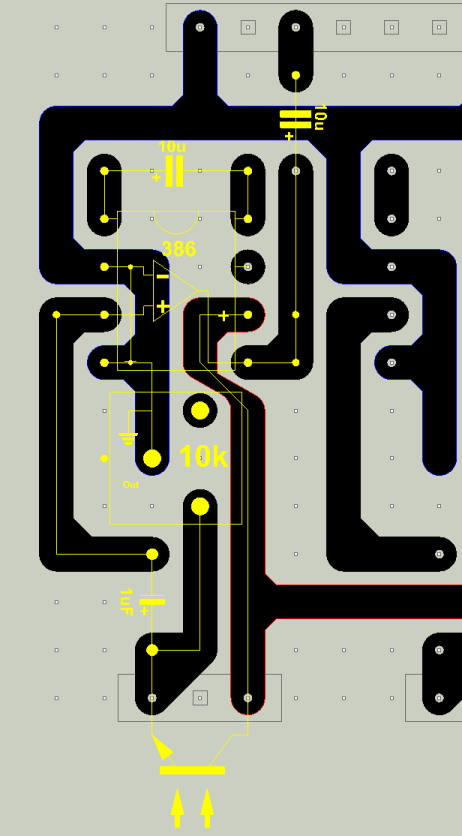

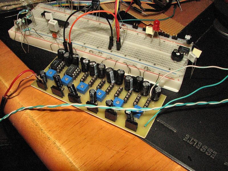

Making the pcb went just fine, but only after etching, I noticed that it was a mirrored version of the circuit
But that aside, the first pcb consists only the amplifier stage for the phototransistor, in hopes of keeping the overall construction 'modular':
  [ You are not allowed to view this attachment ]     [ You are not allowed to view this attachment ]
After testing, that the above pcb works as expected, the first candidate for the next 'module' is one, that consist of 4093 ic's, with schmitt trigger configuration.
What I mean by 'modular', is that the amplifier stage isn't permanently tied to any of the following whatever-stages, so if one doesn't work, take it out and replace it with something else.

The first pcb is ready to go for testing. For me, the drilling is always the most thrilling part.
Babbling:
Thin carbide drills are usually very fragile, and are to be rotated at high speed. Not so in this case, as I used about 2800 rpm(max rpm of my mill) for the 1mm one.
As a precaution, the drill's vertical movement was minimised, so that it just penetrated the pcb.
One might ask: why not use hss drills instead, as they are dirt cheap, and more flexible?
Anyone, that have used hss drills for pcb's, knows, that after 50 holes they are as dull as it gets, and tear instead of cutting.
Although carbide drills cost a bit more, and are not to be used for hand-operated drilling(ask me how I know), they don't wear out easily.
Some kind of (lightweight will do) drill press is required, though.
Reason for this run out? If there are newcomers reading this thread, willing to make their own pcb's, hopefully they get more info to get over the learning curve involved, than I had in the past..
But enough of that. Drilled pcb as it is:

There was an error in the previous pcb, but it's now fixed:
It's just a bare bone circuit, which could be cropped even more, by replacing upper right 10u capacitor with a jumper, as I'm not sure if it's needed at all.

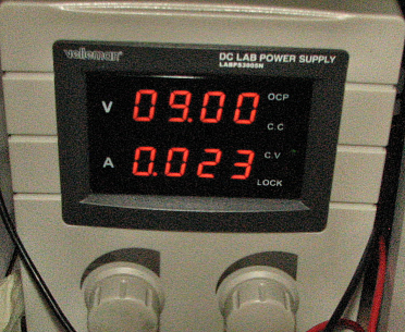

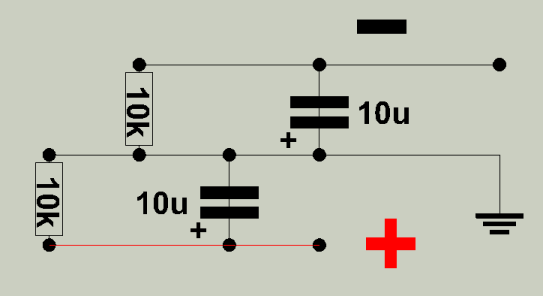

Although it's working as expected, it seems to need some kind of psu filtering thingamabob to suppress overall noise. I use a simple one like this, which could also be used as a split power supply.
It was used only to power the amplifier circuit, and not the power hungry ir-leds:
So far the testings and adjustments were done by using scope, function generator, and multimeter. But they don't reveal all. The end result is still judged by aural testing.

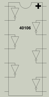

Next stage after the amplifier could be a schmitt trigger, zero cross detector, or about anything, that is able to clip the output to suit cmos ic's.

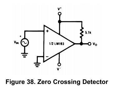

Simple zero cross detector(zcd) from datasheet..
..and 4093-based schmitt trigger were compared as signal 'squarers'.
Zcd did work, but its sensitivity(or lack of it) made it to cut the signal from the plucked string too early. Another version, that has 10mV sensitivity, although having more parts involved, could still be an option to test. With that high sensitivity, noise could be a problem, though.
Zcd with an adjustable/variable input sensitivity would be jolly good to have in this case. But when searching on the net information about it, such things doesn't seem to exist.
Then there was the 4093-based schmitt trigger, which did let the signal from the plucked string to 'squarify' bit longer, making it to look more 'natural' response.
Current circuit has (maybe)enough amplification for the receiving phototransistor. On a second thinnest string(0,33mm/0,013"), when plucked, the output goes to 9 volt(with 9V supply), and fades as the string vibration decreases.

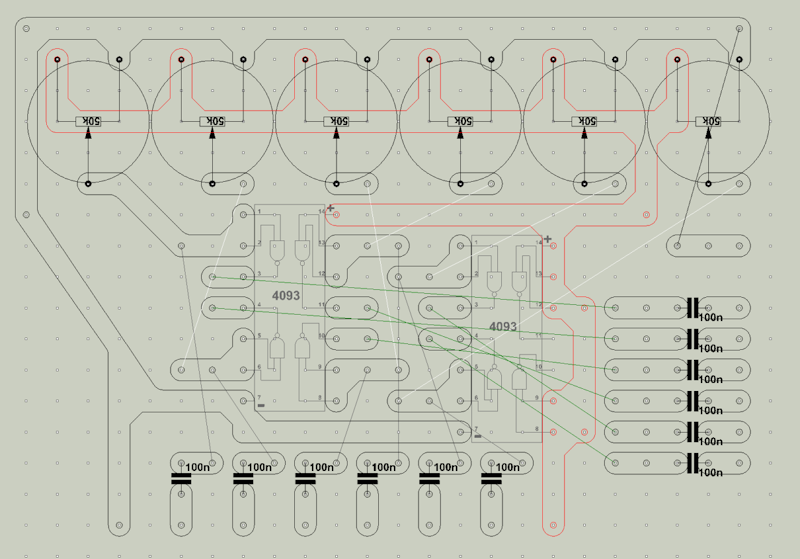

After looking at the datasheet of 4093 ic, by lowering its supply voltage, the input threshold lowers also.
At 9V it is ~ 1,8V, and at 5V ~ 0,9V. By adjusting the 50k pot, there is a very narrow spot, where the output appears. Lower supply voltage makes that spot even narrower.
Multiturn trimmer pot could be a better choice for that, as they aren't that costly nowadays.
So far, circuits with minimal parts count are used. As I mentioned earlier, this thread is useless without pictures, but even more so without audio clips.
The mechanical setup isn't up for that yet, and needs a lot of testing as well. By using the current (flimsy)setup, it should be possible to use a least two strings, to make some nice sounds audio output.
The form of output, that I expect, could be fuzz/buzz. If all goes well, there should be some form of cross-modulation, that one gets only by using hex-fuzz.

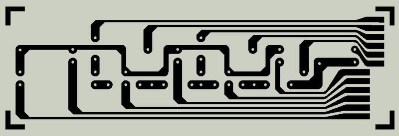

Offline sorveltaja
  • Posts: 684
Re: Diy optical pickup for guitar -- is it possible?
« Reply #57 on: December 19, 2019, 08:05:29 PM »
Pekka, thanks for the link. Yes, using fixed value resistors is in the plan, although on the thinnest strings, which have less sustain than thicker ones, finding closest resistor values could be a bit tricky.
On a second thinnest string, when tested with 100k pot, at the sweet spot, it was removed from the circuit, and its values were measured, being close to 60k/40k, or 40k/60k.
The supply voltage was lowered to 5V, but before testing all the six circuits together, I can't tell, if it's the the final value.

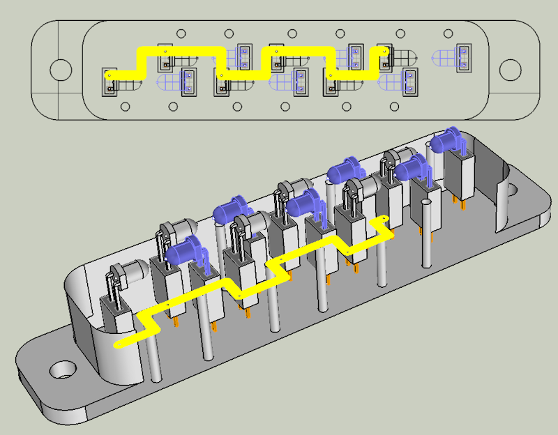

Other than that, I drew some sketches, considering the mechanical setup. The electromagnetic humbucker pickup was remover from the guitar, to make more room.
One thing, that has bothered me about current mech setup, is that you have to drill holes through the guitar to make connections to the pcb.
A small step in hopes to change that:
In that pic, sender ir-leds' common ground legs are brought together with pcb trace. The 2-pin grey headers, where the leds are to be connected, should be identical size in length.
But as I have long ones(40 pin), they should be sawed off of that, and milled to size using depth jig.
There is ~4mm space below the headers, so small 1.6mm pcb should fit there. Not sure though, if there is enough room for all the traces for optical components, when using single-sided pcb.
But as always, I have to test it to find out, how far I can get.
I guess that there is an option to order custom made pcb's, but from what I've read, in this country, they would cost ~200€/piece. Or maybe I'm missing something.
But that aside, to provide more constant signal from the strings, while testing one by one the outputs, could be to use a motorised piano-hammer-like contraption instead of tickling the strings with fingers and toes for the purpose. That may well be the next side-project.
« Last Edit: September 28, 2022, 07:11:53 PM by vtsteam »

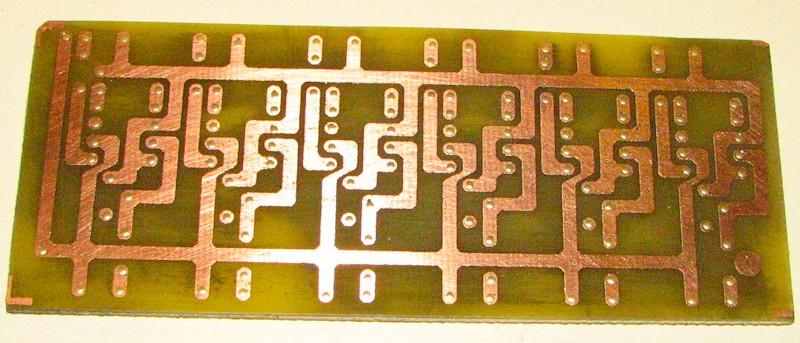

Offline sorveltaja
  • Posts: 684
« Reply #58 on: December 20, 2019, 06:58:04 PM »

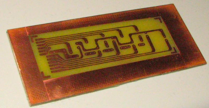

First test with a pcb, that may end up to the pickup housing:
Thinnest traces are 0,5mm wide, and it took quite a few times to get them to transfer without cracks:
Of course, the continuity of every trace has to be tested, before cropping the pcb to its final size.

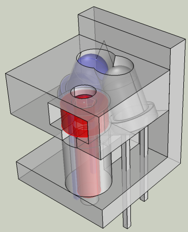

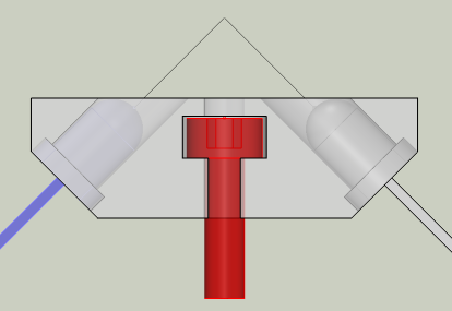

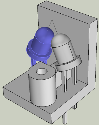

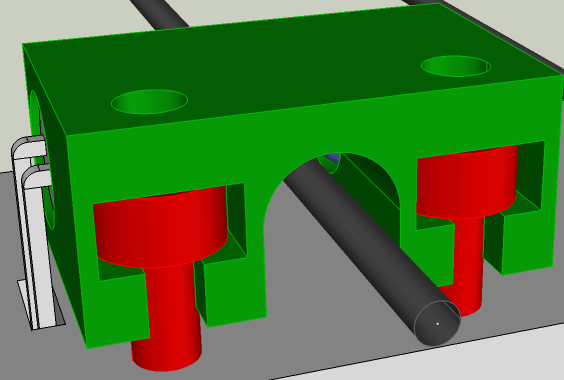

On to the next version, which rely on using two hex-head screws as vertical 'rails'. The first printed version of that was too loose for the led/phototransistor combo to stay in place.
There is a discussion on the 3d-printer thread about snap-fitting printed parts together. That's where I got an idea for this:
At first, the red screws couldn't hold the green part in place, when they were adjusted.
Then came the snap-in thingy;
Screws were pushed into the green sender/receiver housing. It took some force, but once in place, the overall construction is surprisingly stiff. And for me, that was only the first test using snap-in fit.
As the green part(height) needs only a minor amount of movement to find the 'set-and-forget' -position, wearing the printed parts out shouldn't be problem. But time will tell.

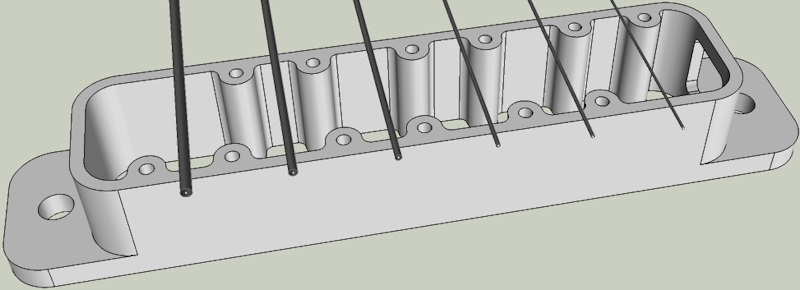

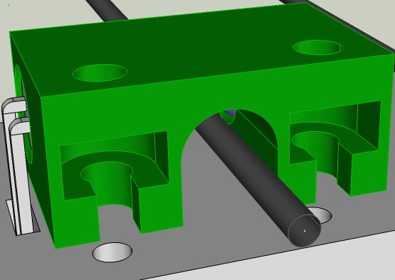

Offline sorveltaja
  • Posts: 684
« Reply #60 on: December 22, 2019, 07:11:21 PM »

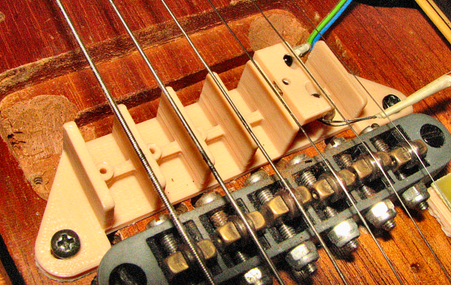

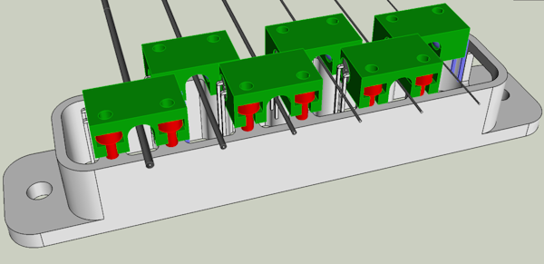

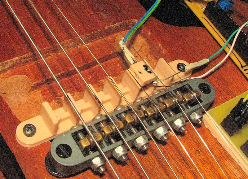

A new version of the pickup housing. Couldn't find any 'neat' way, that could be easily done, so why not go for quick and dirty. Well, maybe not so quick, but at least it's dirty.
The idea is loosely same as before, but this time, instead of using the drilled holes on the guitar to put the wires through, wires go through the hole on the side of the pickup housing.
The skeleton version of it:
And with the parts:
I printed that out, and although bony, it has some rigidity in it. If that isn't rigid enough in practise, I just have to add some wall thickness.
That kind of 'open' construction means, that the optocomponents should stay tightly in place through all the wild wiring hassle.
With right tolerances, they could be pushed in place seemingly tight, but that isn't enough. The trick is to apply small drop of lacquer or paint to the neck of the led/phototransistor.
When it's then pushed in the place, and let dry overnight, it should be more than enough to keep the bugger in the place.
Quicker way, using super glue might seem tempting, but the fumes of it will ruin the hemispherical 'seeing' area of the component, as they are usually made of some sort of plastic.
« Last Edit: September 28, 2022, 07:01:20 PM by vtsteam »

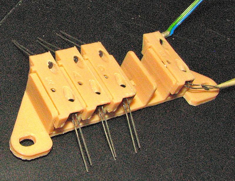

Offline sorveltaja
  • Posts: 684
« Reply #61 on: December 24, 2019, 09:15:21 PM »

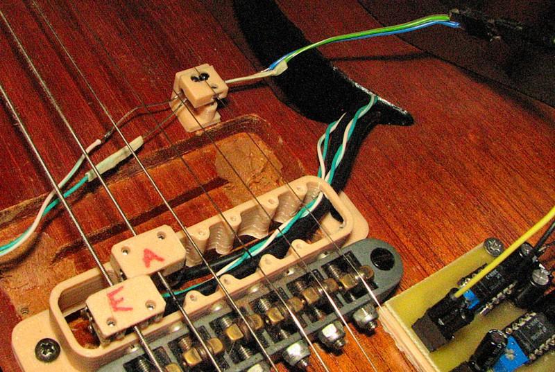

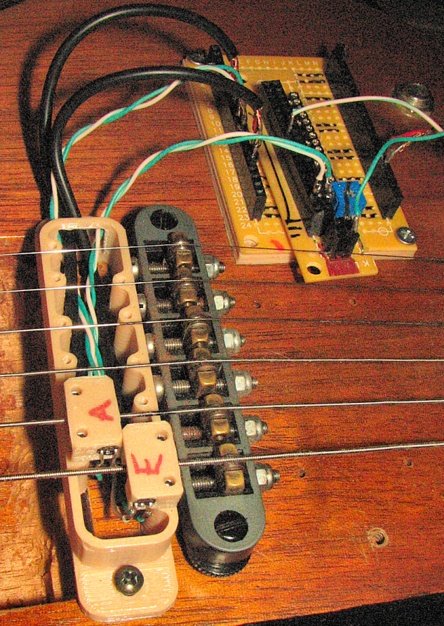

First tests with a new mechanical setup:
Wires of two pickups in place. But that housing might get too crowded, when all the wires are stuffed there, especially when using a 3mm thick shielded cable for the receivers.
But that's what I have at the moment.
One shortcut could be to mod the housing, so that the wires would come out of the side of it, instead of only at the end, as it is now.

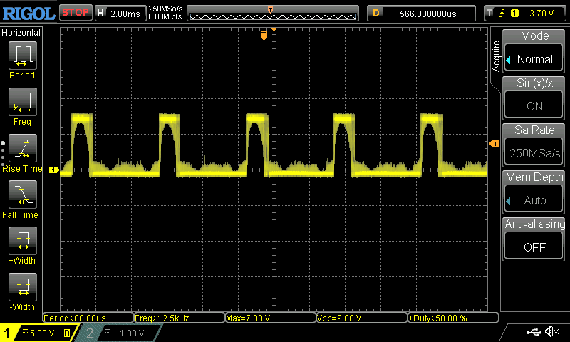

Now, that the two pickups are in place, I tested shortly the 'E' -labeled one, which is for the thickest string.
The screw-adjustment for the height seems to work, as expected.

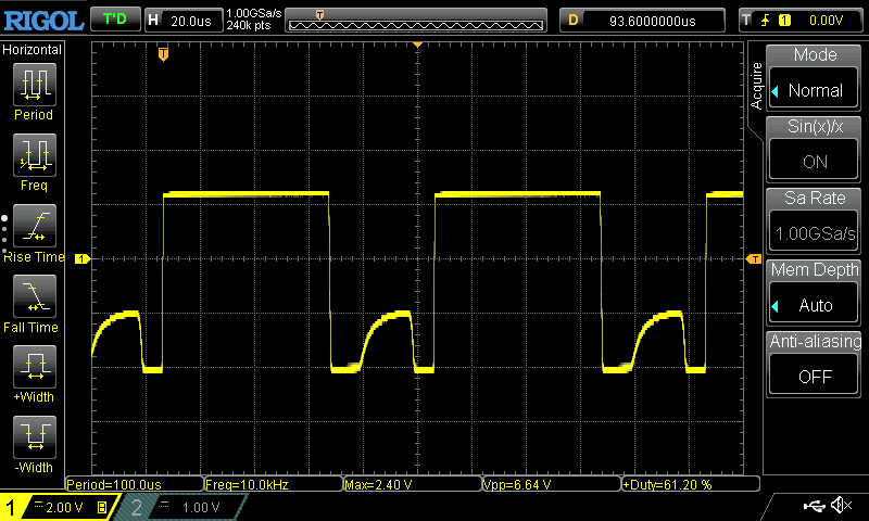

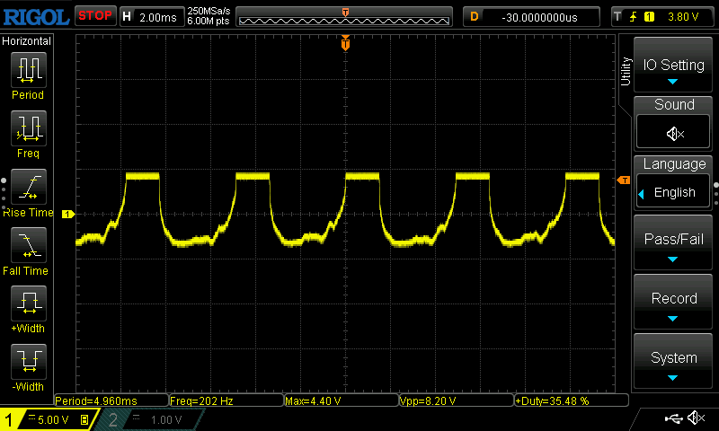

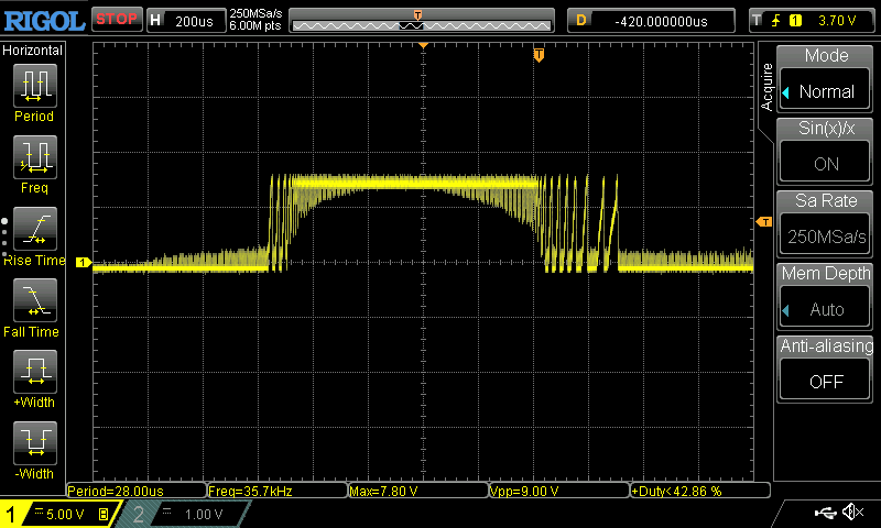

10Khz square wave was then fed to the sender/ir-led, and to my surprise, there was... well, I don't exactly know what it is, but perhaps a reaction, when adjusting the pickup up or down.
When it was in one position, there were bumps between the square waves:
After some height adjustment, the bumps were gradually gone. So the difference, of what the receiver/phototransistor 'sees', whether it's string shadow, or whatever involved factor, can be visualised using scope. During that, the string stood still, and wasn't plucked, or otherwise excited.
Obviously that effect is greatly reduced, when testing with thinnest strings, but should be visible, though.
« Last Edit: September 28, 2022, 06:54:20 PM by vtsteam »

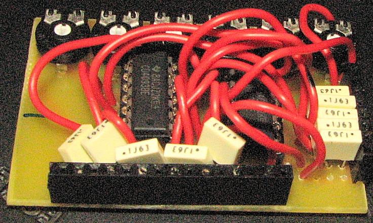

Offline sorveltaja
  • Posts: 684
« Reply #62 on: December 26, 2019, 08:37:53 PM »

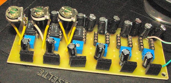

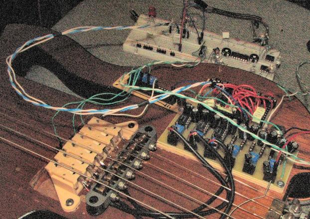

Now, that the amplifier pcb is almost finished, I got curious of how the optical pickup sounds like. I tested it only on the thickest string. I'm going to order four missing ic's, once the holidays are over:
Output from the 386 amp is certainly very strong, as it's used in x200 gain configuration. The output is distorted in rather ugly way, but that doesn't matter, when the signal is to be conditioned for the cmos devices.
So far, there are no gain adjustment pots. Maybe they could be fitted afterwards, don't know yet. If not, then it's just time for a new pcb.
But to test how the string actually sounds, I tuned the overall output down by lowering the sender/ir-led voltage to the point, where there wasn't distortion.
Yes, it is possible to get a 'clean' output of this setup. Although I wasn't too much interested about that, it might well change.
The sound of the E (thickest string) is very bassy, not in a muddy way, but like a real bass. Didn't even know, that guitar can produce such low frequencies, without octave-down -effects.
Not only that, but when I increased the voltage of sender/ir-led, the overall output was again very high, I noticed, that plucking the other strings(whose pickup wasn't connected),
the E string ringed, responding to some of their plucked note harmonics.

« Reply #63 on: December 28, 2019, 06:07:12 PM »
This one might be boring one, but as it is essential for the project(or at least with current mechanical setup), I'll give it a go anyways.
It's about height adjustment of the pickups. Today I tested, how to get the pickup(sender ir-led/phototransistor pair) to the position, where the string is at the center of the ir-beam.
That could of course be done by listening the output, and guessing the sweet spot by ear.
But guessing games aside. To see, if I can find anything useful for the matter, I fed all kinds of signals to the ir-led, and looked the results on the scope, while moving thin, string-like wire across the ir-beam.
The pickup used for this test is separate one, but similar to the ones, that are attached to the guitar.
Method, which I mentioned earlier, that feeding square wave to the ir-led, and judging the result by the looks of receiver output, when moving an object across the ir-beam, doesn't seem to be reliable.
There are simply too many things to be adjusted, before one can see the results(if any).
While frustrated about turning all the knobs of scope and function generator, there was one thing, that I hadn't noticed before.
When I slowly moved thin(and thicker ones also) string across the ir-beam, the current readout of the psu went temporarily from 23 mA to a few mA lower, as the string was moved up and down.
After repeating that procedure few times, there was constant reaction of the current readings of the psu.
The circuit, that was used to amplify the phototransistor output, is same as in previous post.
The thing seems to be to feed that circuit through the ir-led, with a signal, that makes the receiver/phototransistor amplifier 'busy', while 'receiving'.
Even a small amount of deviation in the ir-beam seems to give the amp time to take a breath, so the current consumption decreases shortly.
In the end, I think that the deviations of current consumed by receivers amp could be more reliable way to measure the best position of the string, to get maximum output.

While the current mechanical setup is in the guitar, and the amplifier pcb is fastened to the guitar also, I decided to have a look of another kind of mechanical/optical setup, which I tried very shortly in the beginning.
It was left aside, as I didn't have an amplifier circuit to provide enough boost back then. But now that I have, I thought that re-visiting that design could be interesting.
Don't mind the bigger setup, as the one, that I'm babbling about, is the small one on the upper side of the picture. It's glued in place:
The sender(ir-led), and phototransistor have 50 degrees angle between them. No any particular reason for that angle, other than to see, does the concept work:
That test housing has a "backrest" to keep the sender/receiver combo from rotating around, when adjusting the height. Seems to work quite well.
As can be seen on the first picture, that thing was tested on the thinnest string(~0,2mm). If that works, any string thicker than that should give even more usable output.
To my surprise, there was stronger output, than was expected, after adjusting the pickup closer to the string.
So far, I have only used the scope to see the results, but it's the resulting sound that counts after all. I haven't got that far yet, as projects like this tend to expand(explode) in form of countless possibilities involved.
But yes, I think the mentioned sort of setup could very well be more appealing to the most of experimenters, that are willing to get their feet wet.
Quick summary of the two lately tested concepts so far, but take it with pint of salt:
One with sender/receiver pair in opposite(horisontally) sides of the string:
+ immune to string bending(which is also a horisontal movement)
+ the "sweet spot"(max. output) could perhaps be found by measuring the current consumption of the amplifier circuit
+ overall output level
- not a very practical to use, as the sender/receiver pairs (and their housings) protrude above the strings, so it's not possible to dampen the strings in natural palm-assisted way.
Then the one, that relies on reflecting the ir-beam from the string surface from the below:
+ remains under the strings
+ allows free playing, and string dampening at will
- rather sensitive to string bending(maybe not so, if multiple pairs of sender/receivers were used)
- can't think of reliable way to judge the "sweet spot" yet
But as always, all that needs a lot of testing.
To expand the subject even more, I'm thinking of ordering some hall-sensors, to see, if they could be abused used for this purpose. But that's beyond of this thread, though.
« Last Edit: September 28, 2022, 06:33:46 PM by vtsteam »

Continuation for the previous post; I tested that configuration, where the sender/receiver pair was perpendicular to the string.
Results were quite disappointing, as there was a lot of noise, although the ir-led was fed with dc. Also the pickup should have been very(too) close to the string, to get usable output.
So far, that configuration is done and dusted.
Variation of that is kind of similar, but this time the sender/receiver pair was set to be parallel with string:
Output was bit better, with less noise. Also in that configuration, if the pickup was too close to the string, output decreased. I guess, that the reflection of the ir-beam from the string could be better also.
But the form of the output signal seems strange, as the waves are formed from tiny spikes:
Maybe the schmitt trigger could translate those spikes to more solid, rectangular shape. Haven't made a pcb for that yet, though.
So far, I have found one major drawback in that concept; the output signal changes, when the ir-beam is reflected from players hand, near the strings.
One commercial manufacturer uses the latter concept, but there the optical components have a lot more distance, apertures, and fancy ir-filters between them.
I'm not going to copy that thing, as it was never advertised to have properties, that I'm after. Perhaps slightly adopt the ideas, if needed.
But the general principals are there for testing purposes, after all.

One basic testing version of the 6 x schmitt trigger board:
For some reason, I insisted on making as small as possible board. Then I had to cram the capacitors in:
It lacks only two caps, which I'm going to order, besides other components. But when testing it with function generator and scope, it worked as expected so far.
All those clumsy jumper wires, I wish I could replace them by using two-sided pcb. That's a subject, which I haven't explored at all, as aligning the two pcb transfers with each other seems overwhelming, to get usable pcb. Maybe that's one tough side project for the future...
Another version could be a bit simpler, with similar layout, using 40106 hex inverter gate, which has the needed six schmitt trigger inputs/outputs in one ic:
I'm not sure if that 40106 works as 4093's, that I have used, but maybe I'll order some, to find it out.
« Last Edit: September 28, 2022, 06:22:28 PM by vtsteam »
« Reply #67 on: January 03, 2020, 05:21:44 AM »
Not sure how you make the boards, but could you use the same method with transerfer sheets than is used with UV-method? That is to tape the transfer sheets facing each others into an "envelope" I.E. index them firs to each others and then slide the PCB blank in and then tape it into correct place.
Or you could use something to allingn the PCB into a "pocket" like this:
https://justaddelectrons.com/blogi/double-sided-pcbs-aligning-the-sides-for-exposure/
Or just drill holes on opposie corners of the PCB that has a mating parts on masks and then tape the mask (or in your case transfer) which has the same indexing holes.  Hell....you might even 3D print an alligment fixture for mass production:)
Offline sorveltaja
  • Posts: 684
« Reply #68 on: January 03, 2020, 08:02:46 PM »
Pekka, thanks for the info. I was thinking of that envelope method, but the paper, where the transfers are printed, should be plain, instead of the magazine paper that has either text or images in it.
Glossy photopaper for laser printer could be a better candidate for that. Or some pcb-transfer specific product.
By using the uv-method, as the link provided tells, making two-sided pcb's could be a lot easier. Haven't got that far yet, when making pcb's. So indeed it would make a lengthy sideproject.
To get back to the project, yet another variation of the recent setup appeared. Previous one used 50 degrees angle between sender/receiver, to reflect the ir-beam from the string.
Output was there, but it was somewhat rather lacking.
Then I got a plan 9 from outer phase, for increasing the angle, and distance between optical components. That way, the sender(ir-led) could shine its light to a longer amount of string, meaning more string surface to reflect, and hopefully more output.
Now the angle between sender/receiver pair is 90 degrees:
I printed a new housing, which should be a bit more 'universal', if the distance/angle between optical components needed to be increased even further:
Result is more responsive, and more 'solid' looking output, than the one with 50 degree setup. The sender is again fed with dc:
Although I'm looking for hard-clipping, maximum output, there is also a great potential for experimenters, who are possibly looking for a clean output from optical pickup.
Just tune things down enough to get to that territory. In that case, using photodiode instead of phototransistor could be a better one, as it has lower output.
After all, these things always require testing, to find the options, that suit.

What comes to the project, again another mechanical setup, where the sender/receiver pair distance is ~15mm, and the angle between them is 120 degrees:
I already tested it on the thinnest string, and the output was there, not necessarily better than on the previous, 90-degree configuration, but I just had to choose one of the setups, to move on with the project.

« Reply #71 on: January 07, 2020, 09:46:40 PM »
Three pickups in place for the first audio test. Another three 386 amp ic's are still missing:
Again, that kind of mechanical setup's pickup outputs get easily disturbed, when moving hand over them.
They probably have their uses, but the strings should be plucked near the neck to avoid that.
One commercial maker uses 'strings-through-the-bridge' configuration for their guitars and basses, which doesn't have that problem.
Earlier I tested somewhat similar concept(where the sender/receiver "stare each other in the eyes"), although it had a bit different approach. I might get back to that, after all.
Results of the current setup: what comes to the 386-amplifier circuit, I wanted all the gain and boost it could ever offer. Now, that I have it, when listening to the output, it's overly raw, and very tricky to control in any way, as I left the gain pot out of it. It produces all kinds of farty sounds on its own, and isn't too responsive anymore.
In this case that amp clips very hard at x200 gain, which could be helped to some extent by increasing its supply voltage to get more 'headroom', but I'm not looking forward for that option.
So, as the mechanical setup will change, also the amplifier circuit has to be modified.
For the audio test, I didn't even bother to use schmitt triggers, as the output is beyond erratic already.
But all that aside, there is a hint of the effect, that I'm after, in the recorded masterpiece clip, in form of harmonies, which was made using the current setup:
(zipped mp3 attached)
« Last Edit: September 29, 2022, 08:43:01 PM by vtsteam »
I did quite a bit of messing about trying to make my own PCBs last year.... I can summarise my results here (I'll do a proper write up someday):
1) UV exposure method is a right pain in the backside in a home shop. Getting the timings *just so*, and the exposure chemical strength *just so*, and then etching it just right - there are a LOT of variables. I reckon I must have used about 5 sheets of 100x160mm board, just to get one working 10x25mm board. And even that wasn't perfect.
2) Laser printer method is WAY easier. Forget the magazine paper, the laser printer will crinkle it, and it's hard to see the PCB print over the magazine print, especially if you're trying to go double-sided. Instead, use Vinyl (the sign-maker's type, that you cut in a machine). Works beautifully. I successfully transferred prints using a hot clothes iron, and latterly a slightly modded cheap laminator.
The only downside to laser transfer is pinholes - the laser doesn't cover 100% perfectly, so you can get pinholes in the traces. Not a big issue unless you've got very narrow traces. The upside is you just dunk the board straight into the acid after it's come out of the laminator. Have some acetone handy to wash away the toner once you're done.
Drilling PCBs is a whole different bag of fish. I bought one of those X-Y engravers, which works fine IF you get the boad perfectly lined up. Still working on that one... (well, will be, once I've got some spare time again).
Anyway - enough on that. I know it goes against the spirit of MadModder, but I think if I ever want a PCB that I *know* is going to work properly, I'll probably outsource it next time. PCBWay seems to get good reviews, and is cheap enough.
« Reply #74 on: January 09, 2020, 05:07:16 AM »
UV-method does needs some "dial" in. At the school we had repro camereras/films/pen plotters and all the works. Worked out fine. Secret was to use only fresh factory coated PCB:s and use two layers of film/paper that had darkest lines you could get and greatest UV pass trough you could get. Also the "envelope" had to be absolutely flat and UV-tubes have serious power.
I tried direct transfer method and I had best success with high coated high gloss paper, but applying just Goldilocks pressure/time/temperature turned out pretty difficult.
I have had some hit and miss success with UV-method, but my last try ended up to desperation, mainly because I had trouble with transparent material that would allow UV to pass. I bought the material that was confirmed to pass near 97% of that wave length....but I got the "improved batch" that was filtering about 99% of UV. Found out that when I made the "gradient" to find out, took like three minutes instead of usual 15 sec.
I have been thinking of routing method, but there is much CAM, indexing and all sorts of intricacies in that too.....
And then there is chemical copper and vias....
Probably best to buy board, but there is a definate apeal on "roll your own" .
