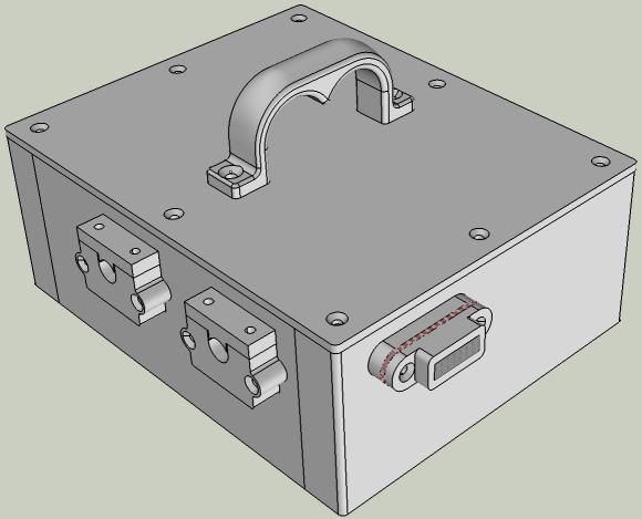

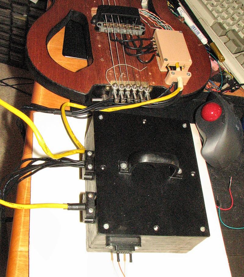

Not really an optical pickup related, but more about how the external enclosure has turned out. Bit too dark and fuzzy photo, and drawn one:
  [ You are not allowed to view this attachment ]   [ You are not allowed to view this attachment ]
I used chipboard to add some extra weight for it(otherwise I hate to work with that stuff). Kitchen aluminum foil was used for shielding to see, if it has any benefit for that noisy amp board.
The cover also has foil glued in it.
Cables from the guitar(pickups and ir-leds) will go through printed strain relief clamps. Later they will be replaced with two D9-, or a single D15 connector.
Using cd-rom ide-cable for outputs, as mentioned before, didn't work that well.
As a male part, I used pins soldered to perfboard, but when pressing/connecting the female part in, some pins popped out on the other side, with the copper spots they were soldered to.
Simple pin headers were used to replace them(as on the above pics).
That box has a 7809-regulator in it(as the testings were done with 9 volts from the variable power supply), and will be powered with 24V/1500mA power supply(from an old scanner).
Combined current drawn by the amp board, schmitt triggers, and ir-leds is only under 100mA, though.

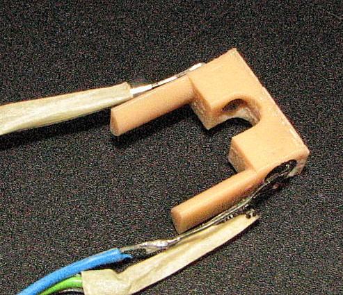

More of the interfacing hassle. Yes, it is (very)boring, but has to be done. Current version of the stuff:
Printed 'boxy' part on the guitar consist two sandwiched perfboards with pin headers, to plug in the sender- and receiver wires.
Another one is a strain relief clamp. They make it a lot easier to move the assembly around, as I have to do it often, to free some table space.
That wiring/connecting/interfacing is very finicky to work with. Apparently some of it needs to be changed at some point.
But for now, I'm going to test it as it is. I'll be surprised, if it works, as expected. If not, it's again a good chance to learn new project-concerning things.

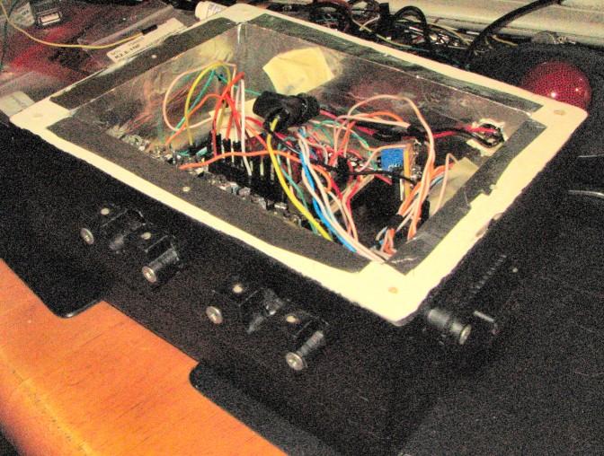

I managed to assemble the circuits inside the enclosure, and after stomping several bugs (which were actually stupid mistakes) out, they work, as expected.
Settings for the amp board/schmitt triggers/ir-leds are still same, that were used, when the circuits were on the guitar. As a sort of a reference.
The overall noise level, although not seemingly that high, is enough to reach the schmitt triggers. The receiver/phototransistor cables are shielded, except inside the small box on the guitar.
When covering that box with a hand, it decreased the noise just a bit, so that's where the 'leak' is. As a last attempt, I'm going to try to shield it with aluminum foil.
Whether it works or not, I kind of saw that coming(shielding problems/noises), as most, if not all, optical pickup manufacturers place the amplifying circuitry as close as possible to the source.
If only I had an ability to work with smd(surface mounted device) components, all the involved circuitry would be already 'stealth' enough to fit nicely inside/outside of the guitar.
After all, if the shielding of the 'box on the guitar' fails, it's probably time to redraw the involved circuits from the very beginning, as the current ones are very clumsy, and were just thrown together for testing purposes. Maybe even fusing them together to form a single circuit board, without unnecessary pin header -connections.

Shielding that small box in the guitar doesn't seem to have noticeable effect, to lessen the overall receiver/phototransistor noise.
Although the wiring for them is made of a shielded, individual microphone cables, there are differences between the pickups, in a way their noise outputs and -levels(with zero input signals) look.
Perhaps a shielded, single 6-core cable could be a better choice for that. But who knows, before testing. I'll probably add some of that to the next order.
After all, I really would like to keep the current setup, instead of redrawing/remaking the whole circuitry to fit in the guitar body.

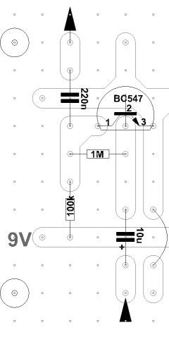

While tinkering with the optoisolator based noise reduction for the amp board, I accidentally found the major source of the noises, that appeared, after the circuits were put to an external enclosure:
Those pots, that were added afterwards, seem to act like radio towers. Just by touching the metal wiper part, the noise immediately decreased a lot.
Although the noise source is located, I'm not quite sure yet, how to shield those potentiometers causing it.
But after all, I'm rather relieved, that the noise source wasn't that much about the cables, or other wirings on the guitar side.
The residual noise can be suppressed even more, by using something like the noise gate, that I've been testing.
At the moment, it's a bit quirky one, until I find a way to smoothen out the input signal driven led's response.
The noise gate circuit itself is quite simple, consisting one npn-transistor, that is fed by the signal from the amp board, to drive the led of the diy-optoisolator.
There are few other components involved also, but I'll have to do more testings to see, how they work.

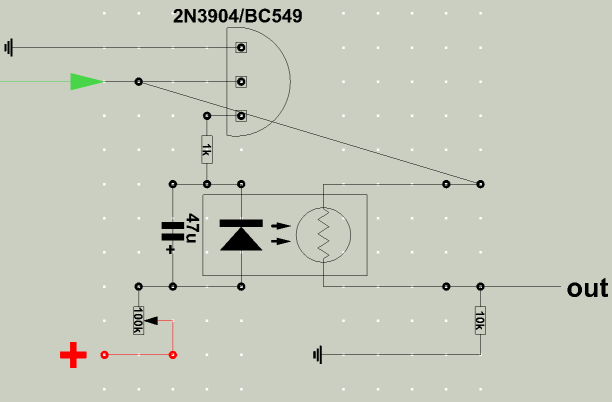

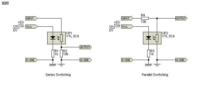

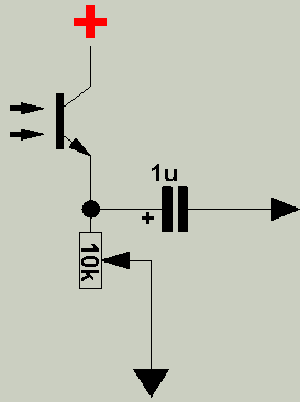

WeldingRod, that's a good idea, but the pots are trimmers, and don't have mounting nuts in them. But on the other hand, it could be worth testing, if at first replacing one of them with actual pot, that has a metal cover and mounting nut, affects the noise level... hmm, we'll see.
The noise gate, that I've been tinkering with, is based on the circuit on the left(source: https://sound-au.com/project145.htm):
Although it is for switching, it could be abused used as a sort of 'automated volume pot', by substituting the Vctl input with an audio signal.

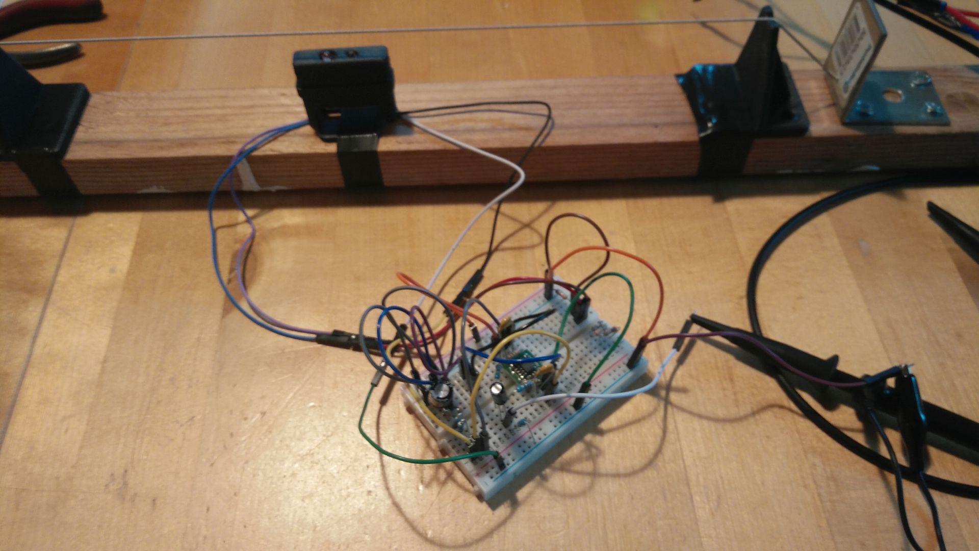

To drive the led, I've been using breadboaded circuit like this:
Component values on the above pic aren't necessarily same anymore, as I change them during testing, to see the differences.
So far, after plenty of adjustments, it seems to be almost usable. Drawback is, that it decreases the overall signal levels from the strings/pickups also.

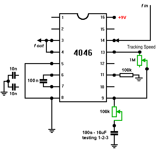

I'm not sure, if I should even mention one of my mad mood ideas. But here it goes, anyways. The thing would be to use 4046-based phase locked loop(pll) -circuits for each string, to track the frequencies.
When the frequency is stable enough(like after plucking the string), the pll can lock to it, providing 'yes' -signal to a certain pin.
After that plucked note fades out, noise takes over. If the noise is random enough, the pll just wanders, and can't lock to it, providing 'no' -signal to that very same pin.

So, on to the noise problem. I'm going to test an optoisolator-, and 4046(pll) -based ideas.

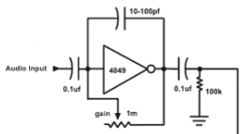

When looking an alternative for the 386-based amps, I ended up testing a 4049(Hex Inverting Buffer and Converter)-based one (source http://electro-music.com/forum/topic-51275.html).
Although the schematic on that page uses two stages, I cropped the second one out, to see if the thing works with fewer parts:
After breadboarding, and some usual tests with thickest, and thinnest strings outputs, and with schmitt triggers, yes, it seems to be working. Not only that, but it's also a lot more responsive to gain adjustment, than the 386-amps were.
Nice thing about that 4049-chip is, that it has all the needed six 'amps' in a single 16-pin chip.
There is one serious precaution, though. I almost fried the chip(it got very hot), when forgetting to connect unused inputs to the ground(or to +, as the datasheet says).

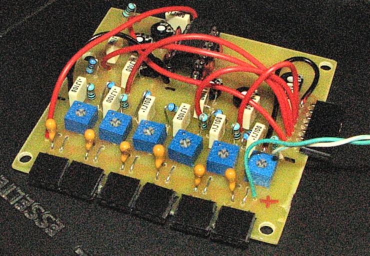

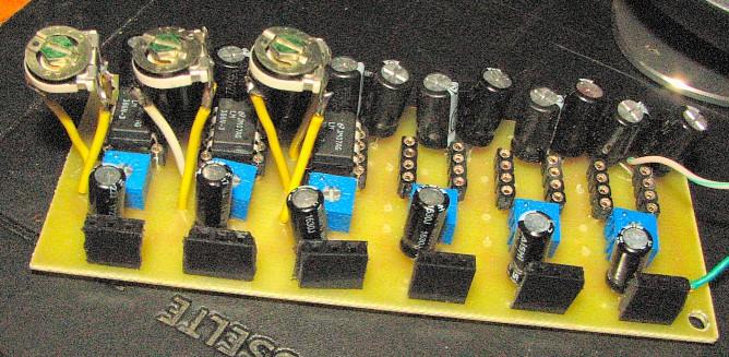

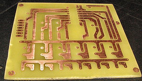

The phototransistor- and 4049 amp board is ready for drilling:
Hopefully there isn't any errors, as I checked the layout multiple times. The size of the board is 72 x 68 mm. I could have made it smaller, but then I would have to (again)cram the parts in.
Besides that, I probably should have made it even bigger, as it's all analog circuitry. "The bigger and uglier it is, the better it sounds"
But seriously, as there are six 4049-based amplifiers so close together, their inputs and outputs should have some distance between them.
When doing the previous breadboard testing, they don't seem to do the hard clipping, as the 386-based amps did.
« Last Edit: September 30, 2022, 07:19:48 PM by vtsteam »

New amp board:
I tested all the six sections, and they seem to work, as expected. As usual, square wave was fed to the ir-led of the pickup(from the earlier mechanical setup), and the phototransistor was connected to the circuits input:
There is one thing, that bothers me about that 4049-chip, though. While testing the sections one at a time(while others were not connected), it did hog constantly about 50mA(at 9V), and got warm.
Bit like on the breadboard, where I forgot to connect unused inputs to the ground, but not that bad.
From that came this shady logic conclusion, that the inputs might act like weathercocks, that aren't tied to anything during the storm. So they rotate at forever increasing speed, until they get glowing red, and therefore get very hot.

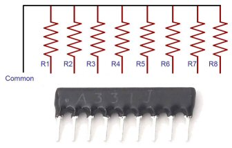

But enough of that. I took a look of other 4049-based circuits on the net(there are lots of them, as that chip was/is used in some commercial, and in many diy guitar fuzz pedals), and at least some of them have 1M resistor between inputs(that are in use) and ground.
Not a big deal, so I drilled holes for the 1M resistors, and soldered them to the circuit. But they didn't help at all. Am I missing something important here?
I have tinkered with other cmos-ic's(mostly for guitar effect purpose, some counters, and pll) before, but never had problems with excess power consumption/heat.
Let it be said, that I read somewhere, that this chip(4049), when used as an amplifier, has a notorious reputation of having wildly different current consumption, even between individual chips from the same manufacturer.
I have two spare chips, and will probably test, how they compare.
But in the end, if the circuit works, regardless of current consumption and warming, it's okay by me, as I never intended to rely on batteries to use it. I'm more worried of how the chip lasts, being warm all the time it is used.
Also, one thing to test is to connect all the pickups to the circuit(to'occupy' all the inputs), to see if it makes difference.

Also less distortion(although some of it could add nice texture to the sound), as the 4049 doesn't clip the signal as hard as 386 amps did.
There is one downside, though. When plucking a single string, or playing solo, the outputs are very weak/lacking(or outright unpleasant). Don't know why that is. But when several strings are plucked(as chords), somehow the outputs 'morph' together, having a lot more powerful, and usable output.
What comes to the power consumption of the 4049 chip, I tested another one, and it acts just the same. I guess that's just the way it works in the current circuitry.
As the power supply has a lot more beef(24V/1500mA), than needed, I can live with it.
So next thing to do, is to fit the new circuitry to that external enclosure, that I made earlier, and some wiring.

I've been eagerly waiting to get to the point, where the circuitry is worth putting inside the external box, and here we are:
No smoke or sparks, when I shortly tested all the six sections, they seem to be working just fine. Also no extra noises on the outputs.
That certainly doesn't mean, that the project is finished. It just means, that all the(well most of it) wire hassle is now out of the way.
Lots of aspects to test, including 'stealth' covers for the pickups.
Also to see, if I can make sense about that 'soloing'(playing single string) -problem mentioned earlier. There might be some strange phase cancelling stuff going on, that makes plucked single strings to sound so weak. When looking at individual string outputs on the scope, they are rectangular, and should sound, like fuzz does.
There is now less crosstalk between the strings/pickups/sections, when compared to 386-amps, but it still exists, and that alone could cause phase anomalies between the strings.
Almost like the next strings(that are muted) pickup(s) 'loot' most of the plucked single strings signal somehow.

When testing breadboarded, simple single transistor amplifier to see, if the schmitt trigger levels could be increased that way to the cmos-level, there was suddenly this repeating noise pattern, where noise was on for 1 second, and 2 seconds off.
After a while, I was ready to open the external box, where the circuitry is, and to dig it all out. But no, luckily it wasn't necessary. When I removed the lid of the box, shortly after that, the noise disappeared.
After some head scratching, I noticed, that the 7809-regulator chip was rather hot. I checked its datasheet, and there it was: 'Thermal overload protection' caused repeating noises.
The whole circuitry draws 100mA, or less, so it was kind of surprising(at least for me), how hot it gets.
Now the regulator board hangs outside of the box, and all works just fine.
What comes to the transistor amp circuit, after some tinkering, it seems to provide enough gain/amplification. Form of the output isn't perfect rectangle/square wave, but as long as it 'triggers' external cmos-devices, it should be good to go. Next thing is to test that in practice.
Hopefully it's the last amplifier circuit needed, as there are few of them already in the main circuitry.
The dissipation is the product of  the the current (0.1A) and the voltage drop across the chip (~2V minimum for a 5v device so 7V input), so your device is trying to loose at least 0.2W of heat a TO-220 package will have a typical thermal resistance of 70'C/W  so expect at least +14'C over ambient without a heat-sink .
If your driving the regulator with more volts 9-12v expect  a lot more heat :-)
Offline sorveltaja
  • Posts: 684
Re: Diy optical pickup for guitar -- is it possible?
« Reply #117 on: March 16, 2020, 09:13:17 PM »
Bill, no wonder then, that it gets that hot, as I'm driving it with 24V/1500mA supply. As the regulator chip is 9V 7809, 12 volt supply should be enough.
In fact, I used variable psu on earlier testings, and it was feeding the circuitry at 10 or 12 volts, and the reg. chip stayed a lot cooler.
Thanks for pointing that out :thumbup:.

Now, that the transistor amp circuit is built, the output levels should be good to go, to feed other cmos-based devices, or effects.
It brings the schmitt trigger outputs(about 2-3 V p-p(peak-to-peak)) nicely to ~9 volt p-p output at 9 volt supply. Very quick and dirty, and the resistor values were chosen simply by tinkering first with potentiometers, to find suitable output. Capacitor values were chosen by looking on the scope(and what I had on my shelf), which made the output to remain closest to square/rectangular wave. Pretty scientific approach, eh?
But after all, the frequency range of the strings/outputs is below 1Khz(unless one insist on shredding on the thinnest string on the frets above 12th one).
Only one section is shown, but as the circuits before, it also has six of them:
One, or few other outputs could then be clipped down with something like 5V zener diodes, if needed. Don't know about that yet, as I'm going to take a bit of a break from the guitar/pickups -involved circuitry, and take a look, what kind of cmos-devices I have, that could then be driven with those pickups/outputs.
So far, I have fiddled with 4046 pll(phase locked loop) -ic, just by feeding it with function generator, and listening to the output.
I used to tinker with that chip years ago, so it isn't entirely new thing for me.
There are so many different component combinations/options to alter, of how it works/sounds. This is only one variation of them, that tracks the frequency of the signal fed to it:
That chip has a vco(voltage controlled oscillator) in it, that runs at tracked input frequency, which could be interrupted, making some kind of "sample and hold" -situation, where the played note could be freezed/sustained to play longer, than the guitar string vibrates. Almost like on keyboard, that plays the note as long as the key is pressed.
The idea for that came from: https://hackaday.com/2015/08/07/logic-noise-4046-voltage-controlled-oscillator-part-one/
There is a lot of theory based stuff, of what that chip does, how it does it, and so on, for those interested, but I just don't understand it.
But that chip(basic version CD4046, not sure about the exotic, high frequency variations) is a very good one for testing on breadboard, as it is practically impossible to fry it out, unless intended.

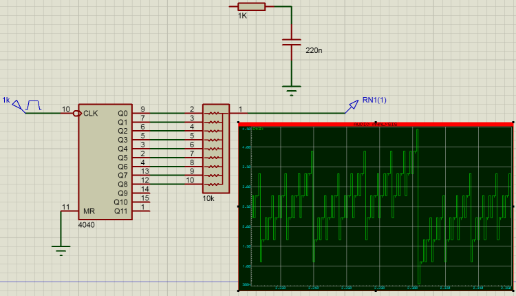

What comes to that sawtooth generator, I thought that 'does it really have to be in traditional sawtooth form, that was used on so many analog keyboards?'.
Then came the idea of some kind of primitive "sampling" technique. After more searching, I found a name for it - staircase generator.
There are schematics, of how to make a proper one, but again, I started looking for other(simpler) ways to test the idea.
Back to the shelf, to check, what chips, or other stuff I have at the moment. There was 4040(12-stage binary ripple counter), which was then test subject.
I cheated a bit, and did some simulations, to see, if it's worth breadbording.
Circuit itself:
The output waveform is not, what I expected, but nevertheless, it sounds like a cheapo analog synth. Good enough, so I breadboaded it, and yes, it sounds very much the same, as in the simulation.
One big drawback is, that the frequency of the input signal is divided down a lot. To get the output frequency to match the input one, I did some testings with 4046(phase locked loop), that could be used to multiply the frequency by the factor, that it's divided by.
I'm not sure yet, if it works in practice. More testings ahead.

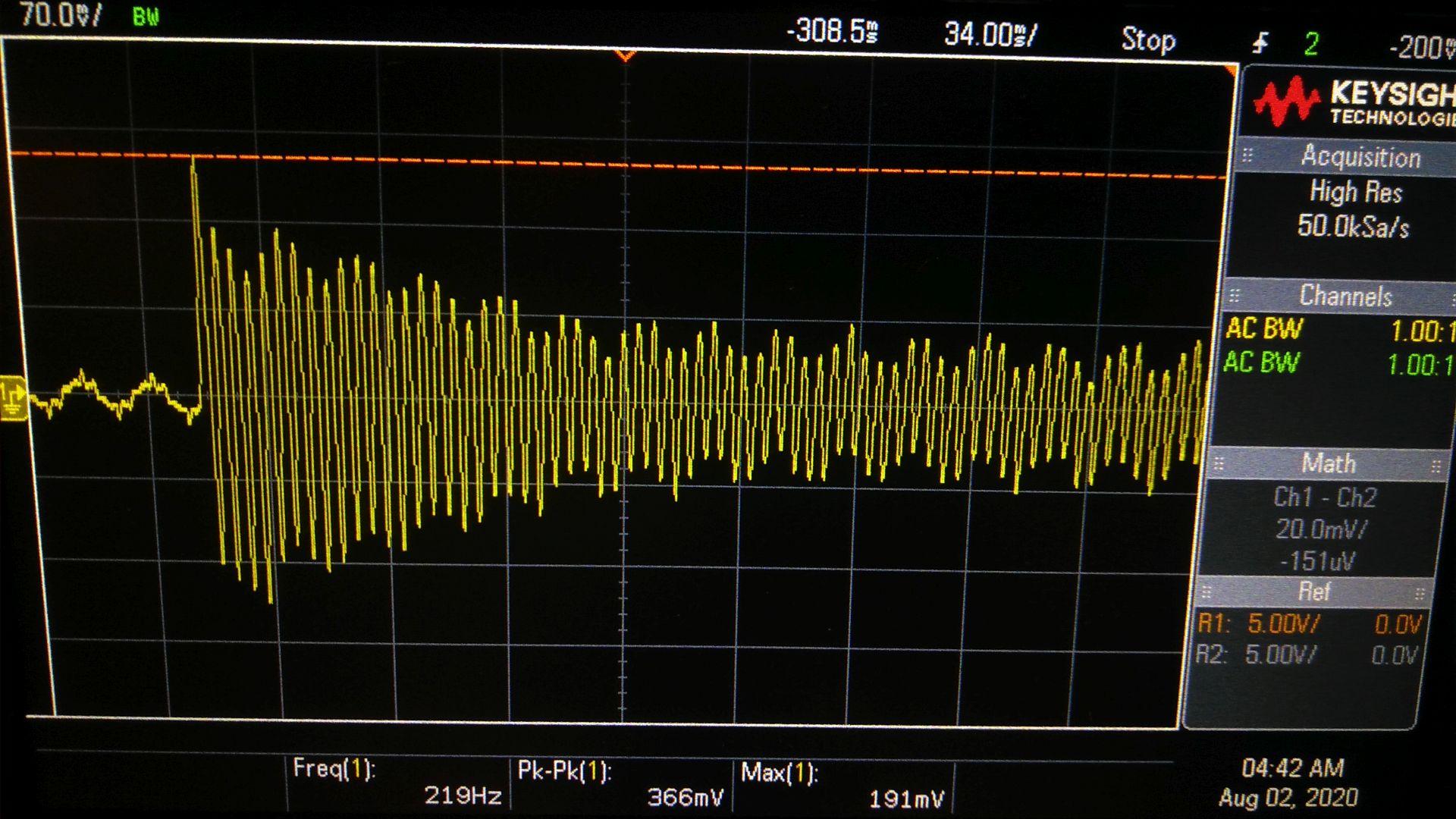

I stumbled upon this thread as I have been researching optical pickups myself and came to the same conclusion that there is barely any information about it. But what I was looking for was more of a drop in replacement for a normal humbucker pickup which led me to the oPik design.
I've got a little test setup for the thickest string:   [ You are not allowed to view this attachment ]
Oscilloscope output:   [ You are not allowed to view this attachment ]
Audio output: https://www.dropbox.com/s/dug6chet2pw6jv7/test%20%233.mp3?dl=0
I am currently working on building a shielded enclosure to improve the signal to noise ratio, and trying to make this all fit in the size and shape of a normal pickup.
