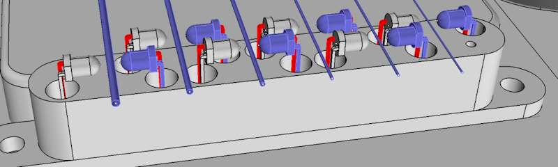

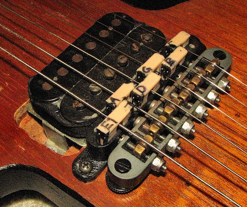

Here is the current setup, that has 3mm infrared leds and phototransistors paired, so that they can be plugged in or out separately, if it is needed. IR components are press fitted.
Parts holding them are 3d-printed, also press fitted to the base, as they would be very tricky to machine, because every pair has to have different height, corresponding to that string.
Meaning, that the led's and phototransistors "eyes" should be at the very same level with the string, to create a maximum "disturbance" in the infrared light, that travels from the led to the receiving phototransistor, providing the output:
Hopefully bit more clearer picture, as in the above pic, the ends of the IR components have been painted to prevent the "shine through" -effect:
There are plenty of configurations, of how the IR components could be arranged. At the moment, I use the horizontal one, because the string doesn't disappear from the IR beam, when bending it.
Vertical one cuts out immediately, unless there are multiple IR component pairs for each string.

Next comes the "interfacing" with a guitar, while testing. I haven't yet found a way to "surface mount" all the possible electronics, without disturbing the guitar's delicate, inner self.
If one wants to take the step, to test out the concepts mentioned, be sure to have a sacrificial guitar, that doesn't mind the few extra holes drilled through it.
I think the interfacing is very important, to assure, that the IR components stay in place during all the tests.

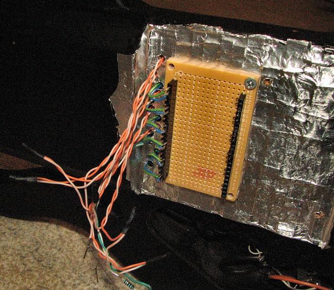

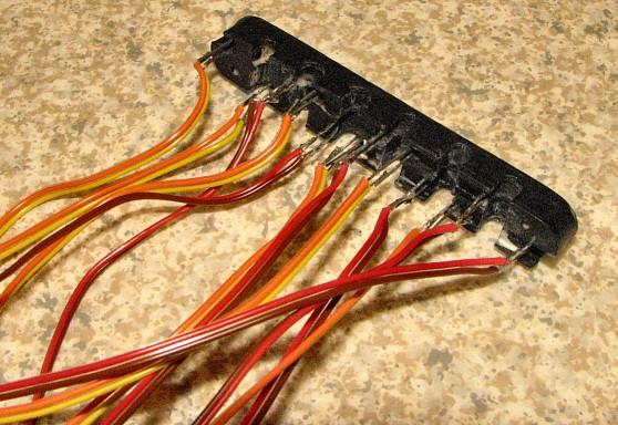

I made a cavity to the back of the guitar, to have enough space for two small circuit boards. I used paint to attach aluminum foil to the surface, just in case, that the grounding is needed:
There are 12 holes, that go through the wood:
That way, there is something to attach the phototransistor's leads, instead of them moving wildly around. Longer leads belong to the IR leds, and are wired in series, instead of earlier, parallel configuration.

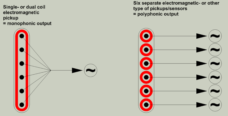

Thanks for the replies. RussellT, optical pickup isn't necessary better than the ordinary electromagnetic one.
Reason, that I chose optical pickups, is that they are much more compact, and ready to be used as sensors.
Electromagnetic pickups require very precise winding of really thin copper wire, to produce good output. Naturally, space between the strings limit the size of those type pickups.
Not only that, but when one wants to make a polyphonic pickup, six separate elements are needed for guitar.
What do I mean by polyphonic pickup, and what is its purpose?
The consept comes from commercial guitar synthesizers, that have a specific, polyphonic pickups.
Although that kind of pickups can be bought separately, unfortunately they require a model specific synthesizer device to work, which are rather expensive.
Difference between mono- and polyphonic pickups:
So the polyphonic(or hexaphonic) pickup has six outputs, which each could be processed independently. For example, signal from one string could be panned to the left, and signal from other string to the right in the stereo field. Or each string could drive different oscillators. Almost endless amount of options.

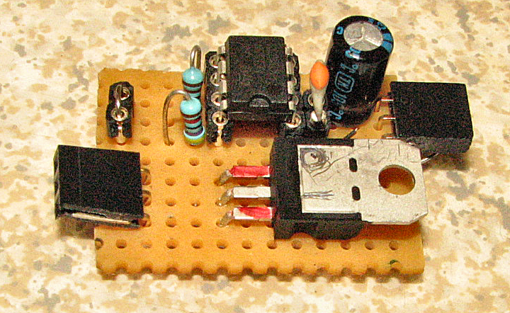

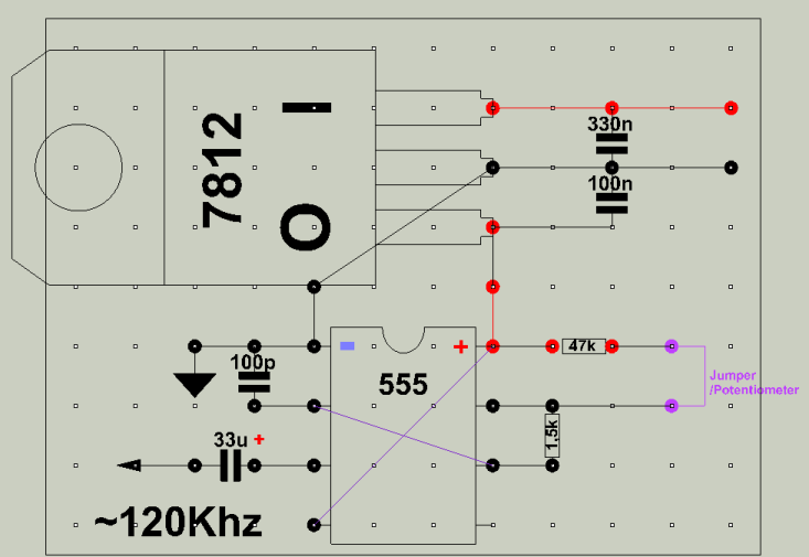

But on the other hand, I have made a very simple square wave generator, to feed the IR leds, instead of DC. It is based on a 555-timer IC, that runs at ~120KHz.
That frequency is just a sum of the components, that I had on the shelf:
I have noticed, that by using plain DC for those leds, they tend to hog a lot of current, without actually "feeding" the receivers. I see those receivers, as bird cubs, that scream for food all the time.
When they are fed hundreds(or thousands) of times per second, they don't have the time to observe the environment, or make noise.
I'm not sure, if it is any form of modulation, but rather pulsing, to keep the receivers busy, so that they notice only the aberrations in the IR beams.
Also, current consumption is minimal, when compared to DC.

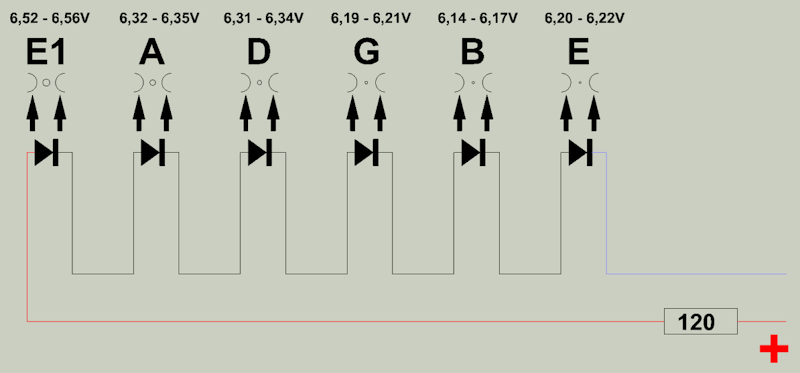

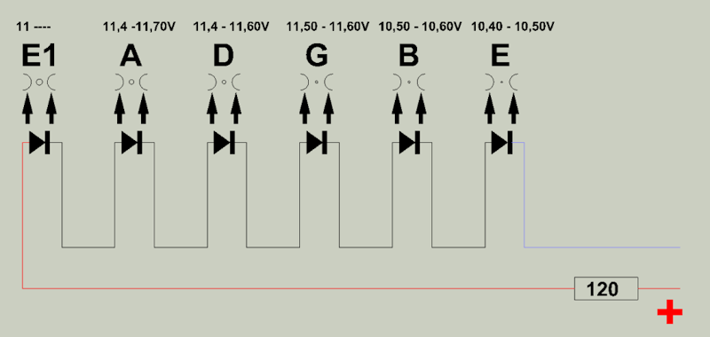

Although the square wave generator pulses the IR-leds, which are now in series, there seems to be a lot of deviation between their output ranges.
At the very beginning, I tested those IR-leds in parallel configuration, just to find the same differences.
So today I tested them with an adjustable DC source, still in series. All of them have different voltages, or "sweet spots", where they give the most output for the receivers.
Bit confusing, but I guess they(IR204's) weren't made to be that accurate, after all, what comes to the operating voltage and current.
One thing, that I might test with them, is to use potentiometers to "tune in" each led. If that doesn't work, it's just an end of part one, as I have already few other types of IR-leds on the shelf.

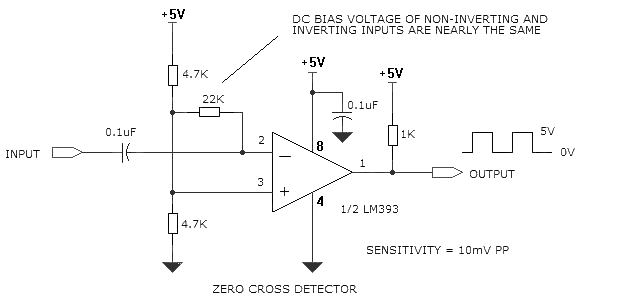

I think the IP-receivers' outputs could be measured with multimeter, but the readings come and go so fast, that it's a bit hard to follow.
When plucking a guitar string, there is first the highest peak, then the signal slowly fades away, so it hasn't that much of constant values.
Without having a storage oscilloscope, I judge the results just by listening. That way it's easier to observe, if the signal is too weak, or is it too strong, causing distortion.

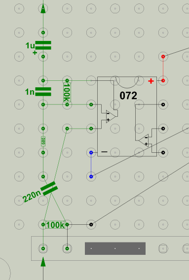

I have tested the IR receivers one at a time, and the signals from them goes first through the unity-gain op-amp(9V battery powered), then to the laptop's mic input.
Optical path differences, yes they likely have an effect. By using variable DC-supply(30V/3A), that displays both voltage and current, I got some results.
From left to right, E1 is the thickest string, while the other E is thinnest.
When using plain DC, the "window", where the leds gave any usable output was really narrow(numbers above the letters)
One (or at least me) could expect more output, if more voltage is used. But no, outside of the above voltage ranges, there was no output at all.
I must be missing something essential here. Perhaps the receivers have something to do with those narrow windows? I Can't tell.
Then comes the test, using pulsed square wave at ~120KHz.
Generator schematic:
As can be seen, there is 7812-regulator, meaning, that it provides regulated +12V voltage for the 555- timer IC.
Results are very confusing. Again, numbers above letters present voltages fed to the circuit, to find out the sweet spots of the IR-leds outputs:
For some reason, E1 has the broadest response, as it gives good output, when supplied from 11 to over 20 volts.

I breadboarded the 555- timer circuit, using a bit different configuration, that I found on the net. So now it gives DC pulses, instead of AC.
But the results are pretty much same. The leds still have their narrow, individual ranges, that produce output.

I tested the previously mentioned configuration, using trim pots for each sender/receiver pair. Yes, it kind of works, but the receivers' outputs are still at a very narrow ranges.
On those narrow output ranges, it's more like an on/off switch situation, where the outputs are either non-existent, or are overly strong, causing distortion and a lot of noise.
I don't mind the distortion, as all those outputs, when I finally get there, are to be converted to CMOS- level square wave form.
But with that much noise, it seems to be very difficult to achieve with the current mechanical setup:
As I see it, is that when the sender/receiver -components stare each other in the eyes at so close distance, the receiving one goes mad, and gives overly saturated output, even if it isn't amplified in any way.
After all, the optoswitches have similar configuration, but are perhaps designed to be nothing more, than on/off -devices.
I'll put the current concept aside for now, and move on to the next mechanical configuration, which concentrates to the reflection of IR-beam from the vibrating string.
To be honest, I'm not going to re-invent the wheel. Instead I'll use the info from the previously mentioned patent.
As it is for commercial product, there obviously isn't any "specific" details available.

In the previous post, I mentioned that I'll be moving on to the reflective approach, as mentioned in the patent. But not so fast, as the saying goes.
While taking the current setup apart, which consist pairs of 3mm sender IR-leds(IR204), and 3mm receiving phototransistors(PT202B), I Somehow got to this crazy, 'mad modder' -mood, and tested, how the actual emitting IR-leds(IR204) react, when they are treated, as receivers.
To my surprise, they provide quite a lot of output, when considered them to be emitters. Also they are bit more forgiving, than the optotransistors, what comes to the operating levels.
So I tested a pair of IR204's, one being the sender, and the other being receiver. Didn't seem to work well with plain DC, so I switched to previously used, pulsed source.
Crude circuit, that I'm currently using to amplify the signal:
It is powered by split power supply. But so far, there is good output, although with some hum. But that is mostly due to the jungle of wires involved, when testing.

After testing several kinds of circuits found on the net, considering sine wave(amplified output from the receiver) to square wave conversion, it doesn't seem to be that straightforward.
One of them being a zero crossing detector, that, as I assumed, should be sensitive enough for the purpose:
But there wasn't any output at all. So I removed all the parts from the breadboard, just in case, that there was mistakes, and built it again from the scratch. Still the same result.
Next thing was to test with multimeter, does the 'preamp' -circuit(mentioned in previous post) give measurable 'peaks', as the electromagnetic pickup does, when the string is plucked.
No, it didn't. Be it AC or DC range. Nothing. But the output is still there, when connected to the laptop's mic input. Somehow it sounds stronger, when compared to the 'high output', dual coil electromagnetic pickup.
If there isn't measurable AC or DC values, then what kind of output is it anyways?

« Reply #21 on: November 09, 2019, 11:34:17 PM »
The first thing to check is the frequency range of the multi meter.
Secondly, the meter will measure the 'rms' value of the signal, this is the average value, not the peak. And it probably assumes a sine wave.
If your signal is a series of 'spikes' rather than a sine wave, then the rms value could be very low.
Audio design really needs an oscilloscope. You can pick one ok for audio off any Chinese trading site if not eBay for under aud50. £20?
(Turning a sine wave to square is easy. Just apply massive gain) .

What comes to my description of the signal of the plucked string, when measured from the electromagnetic pickup's output, it was incorrect.
It actually isn't in a form of spike(s), but more like an envelope.
I'll probably butcher the subject by trying to explain it, but the first picture on this page hopefully shows, what I mean by the envelope: http://www.muzique.com/lab/pick.htm

Back to the original subject. As Russ mentioned, 'Turning a sine wave to square is easy. Just apply massive gain'. But how much gain can one apply to a single op-amp, without making it self-oscillating? Or is it something, that requires multiple stages?
