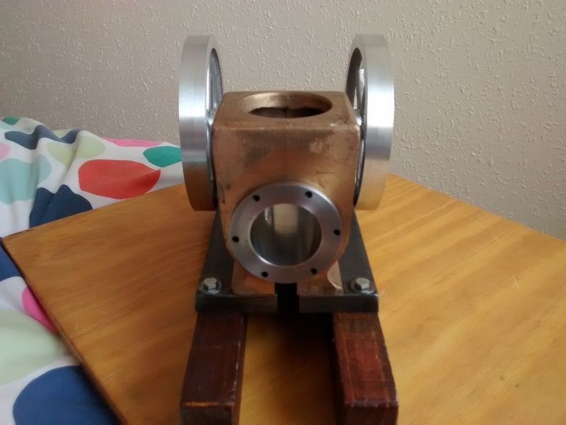

I finally made my mind up. There's no turning back, now!   :palm:
It has to be, twin pedestals, and flywheels.........

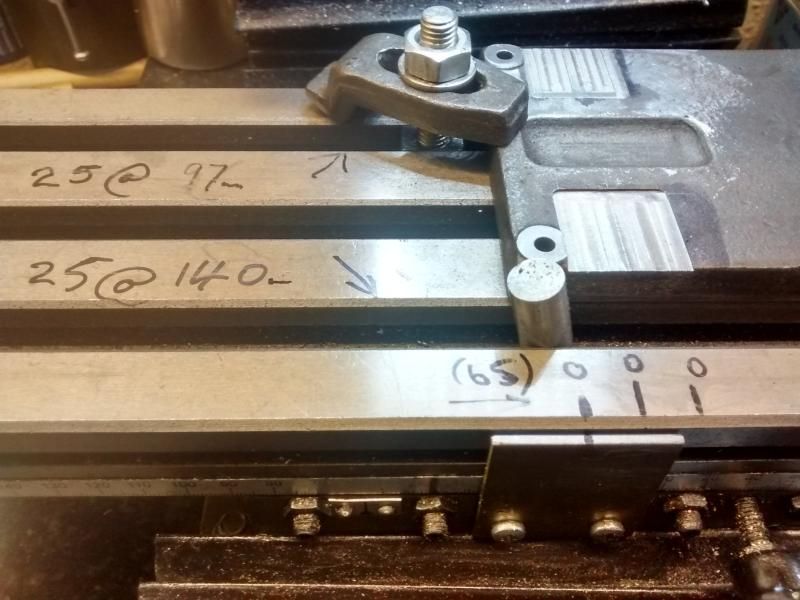

« Reply #78 on: March 07, 2015, 04:54:46 AM »
Slow, steady progress........

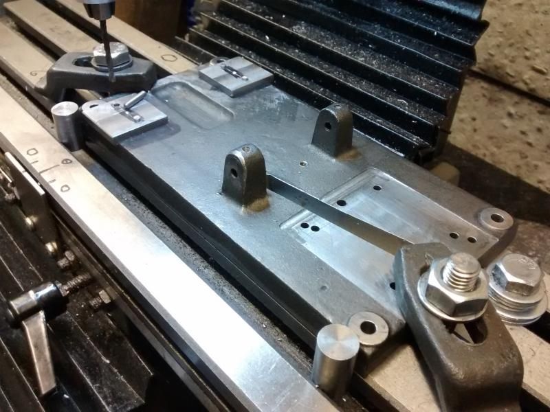

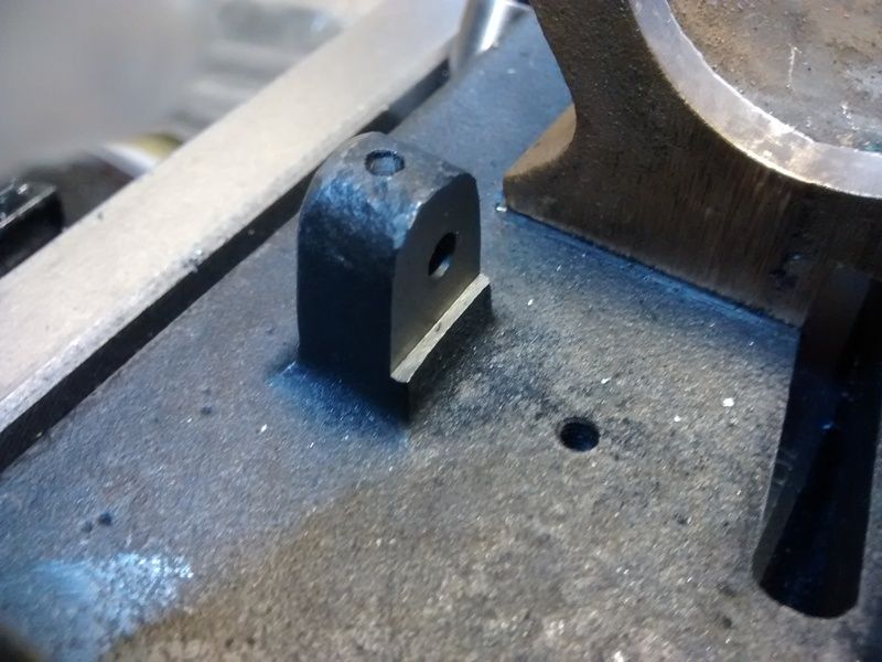

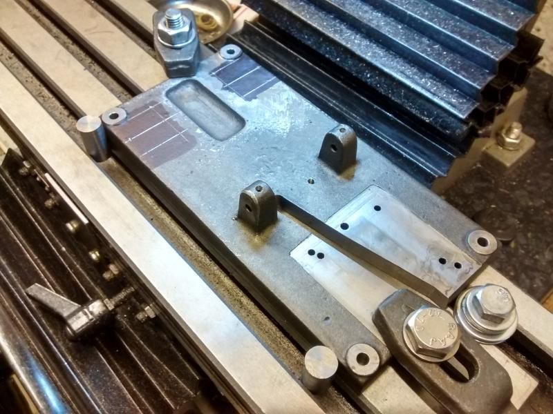

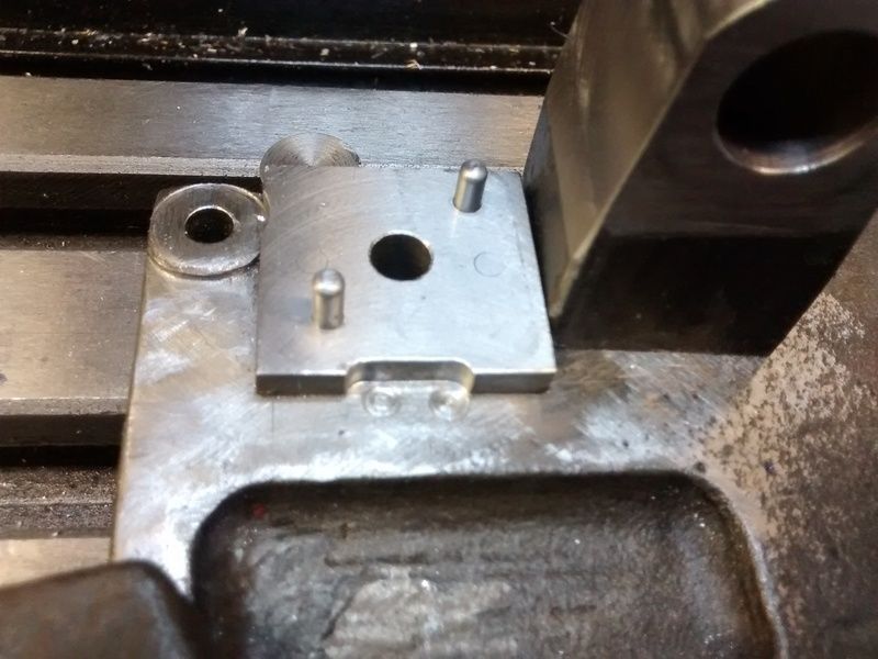

Cleaned up the casting, in the single pedestal area.
Marked out for crankshaft centre line, and two base pads.......
http://i110.photobucket.com/albums/n95/Dayjo/2015%20Onward/IMG_20150218_150838704_HDR_zps9tyootro.jpgScott Vacuum Engine......

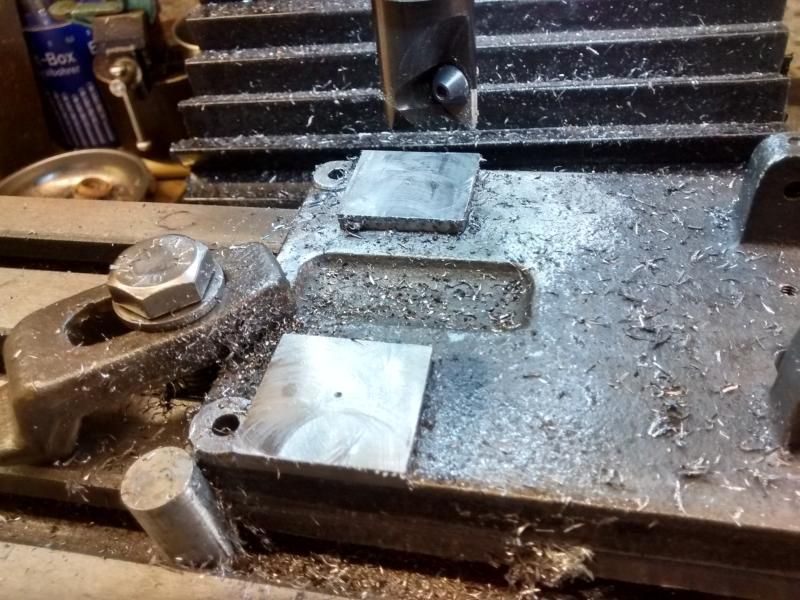

Milled .03" deep pockets........
http://i110.photobucket.com/albums/n95/Dayjo/2015%20Onward/IMG_20150220_125905228_HDR_zpsi3rkhnx3.jpgScott Vacuum Engine......
Two steel pads. Fitting snugly, in the pockets, also doweled........
http://i110.photobucket.com/albums/n95/Dayjo/2015%20Onward/IMG_20150223_145819322_zpsccp4iduv.jpgScott Vacuum Engine......
Glued with sleevelock. Milled to match each other........
http://i110.photobucket.com/albums/n95/Dayjo/2015%20Onward/IMG_20150224_113217038_HDR_zpsfoo4xwhq.jpgScott Vacuum Engine......

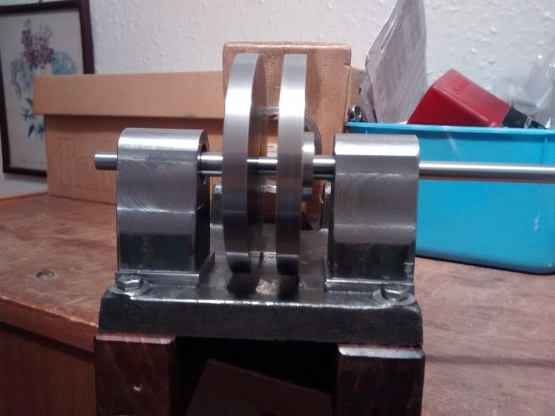

Two 25mm square columns. Held with m6 c/sunk screws and dowels.
Drilled.........
http://i110.photobucket.com/albums/n95/Dayjo/2015%20Onward/IMG_20150227_145129888_zpsoxvesura.jpgScott Vacuum Engine......
Reamed, 13mm........
http://i110.photobucket.com/albums/n95/Dayjo/2015%20Onward/IMG_20150303_143822413_zps8rzqhw7v.jpgScott Vacuum Engine......
Angled the column sides.......
http://i110.photobucket.com/albums/n95/Dayjo/2015%20Onward/IMG_20150304_150534925_HDR_zpszcqn39t8.jpgScott Vacuum Engine......
Radiused.........
http://i110.photobucket.com/albums/n95/Dayjo/2015%20Onward/IMG_20150306_144445153_zps5c7m1zka.jpgScott Vacuum Engine......

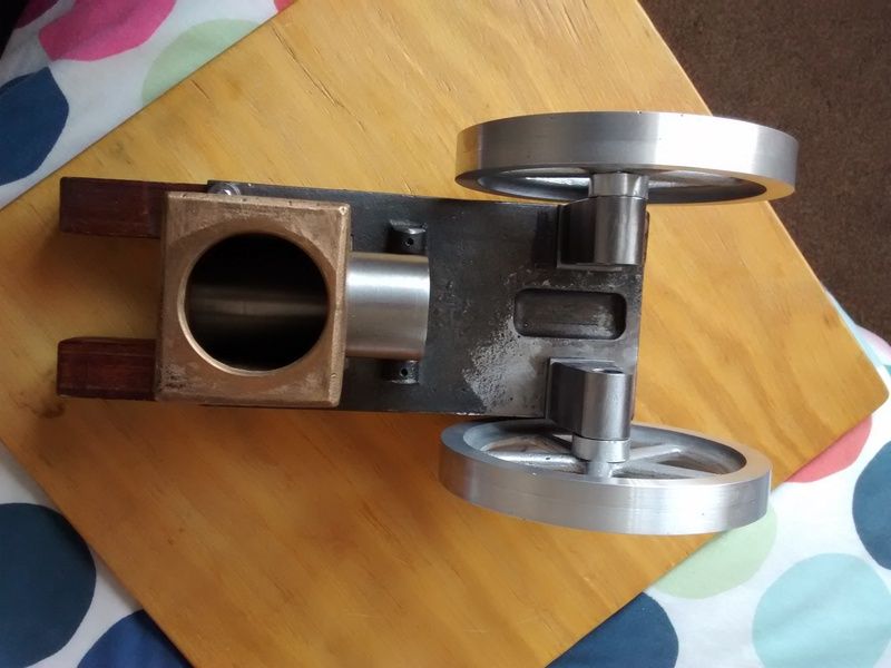

How it all fits together........
http://i110.photobucket.com/albums/n95/Dayjo/2015%20Onward/IMG_20150306_155037446_zpsmagyaefy.jpgScott Vacuum Engine......
A quick spruce up, of the flywheels. Increased the diameter of the bosses........
http://i110.photobucket.com/albums/n95/Dayjo/2015%20Onward/IMG_20150307_091408300_zpsj9rrqzms.jpgScott Vacuum Engine......
Thanks for looking in!

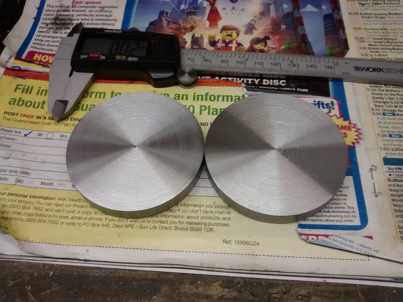

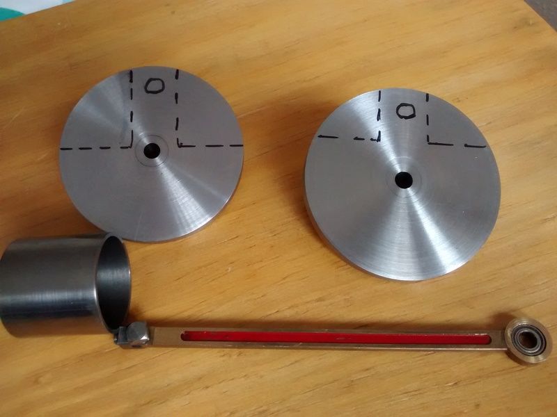

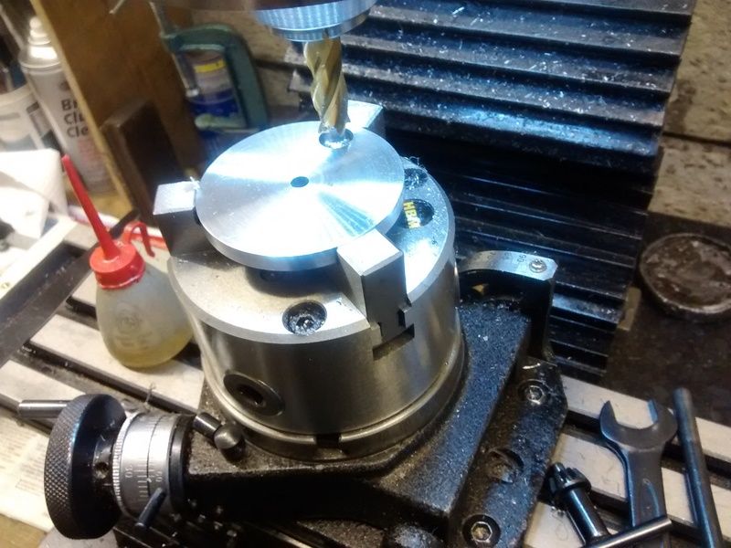

I've started work on the crank discs.
Two off, 3" square x 10mm blanks. And aching arms.......
http://i110.photobucket.com/albums/n95/Dayjo/2015%20Onward/IMG_20150309_114412775_zpsna0wnqip.jpgScott Vacuum Engine......
Topped, to 68mm o/d........
http://i110.photobucket.com/albums/n95/Dayjo/2015%20Onward/IMG_20150311_105811453_zpszgrqvwdj.jpgScott Vacuum Engine......
Skimmed. Finished at 3/8" thick........
http://i110.photobucket.com/albums/n95/Dayjo/2015%20Onward/IMG_20150311_143402585_zpsnrmgxd05.jpgScott Vacuum Engine......

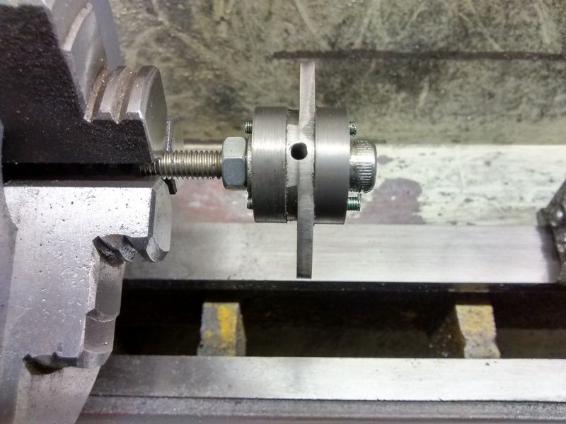

Sleevelocked, sleeves. To increased shaft location length......
http://i110.photobucket.com/albums/n95/Dayjo/2015%20Onward/IMG_20150313_130443914_zpshv5vfqv8.jpgScott Vacuum Engine......
Drilled/ reamed 6mm, for silver steel shaft. Sleeves topped to 8mm dia. No discernible wobble, when spun on shaft.......
http://i110.photobucket.com/albums/n95/Dayjo/2015%20Onward/IMG_20150316_193929528_zpsuyrzmz6t.jpgScott Vacuum Engine......
Time to make 'em look like crank discs!
If I mill away to centre line, as usual, (l/h disc). I guess the assembly would be "over balanced".
The r/h disk seems more, functional.
http://i110.photobucket.com/albums/n95/Dayjo/2015%20Onward/IMG_20150317_164218023_zps0rog0vep.jpgScott Vacuum Engine......

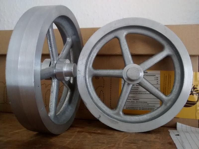

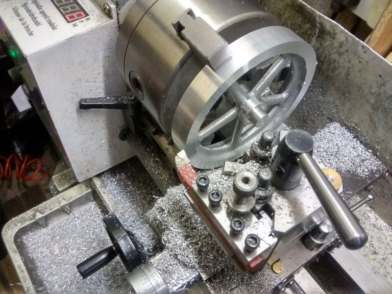

I've been steadily reducing the flywheel's 1" wide rims. Not wanting to overdo it.......
http://i110.photobucket.com/albums/n95/Dayjo/2015%20Onward/IMG_20150317_132649149_HDR_zpsb7nv7irx.jpgScott Vacuum Engine......
Now, down to 5/8" wide.......
http://i110.photobucket.com/albums/n95/Dayjo/2015%20Onward/IMG_20150318_111343632_zpshzymxnis.jpgScott Vacuum Engine......
http://i110.photobucket.com/albums/n95/Dayjo/2015%20Onward/IMG_20150318_111405820_zps2stkn10u.jpgScott Vacuum Engine......
http://i110.photobucket.com/albums/n95/Dayjo/2015%20Onward/IMG_20150318_111436991_zpsfjtu4vga.jpgScott Vacuum Engine......
I think they look about right. Anyone care to comment?
I can still take more off.........  :thumbup:
Re: Scott Vacuum Engine......
« Reply #84 on: March 18, 2015, 08:45:29 AM »
David,massive improvement,they look tremendous.  :clap: :clap:
Proportionally to the rest of the engine they look grand,but also I think if they're thinned down any further you may start to loose the depth proportion of the radius on the cast section of the rim webs.
It's your decision but I think she'll look mighty when the crank is in and the flywheel centres are painted.
Looking forward to the next installation. :thumbup:.......OZ.

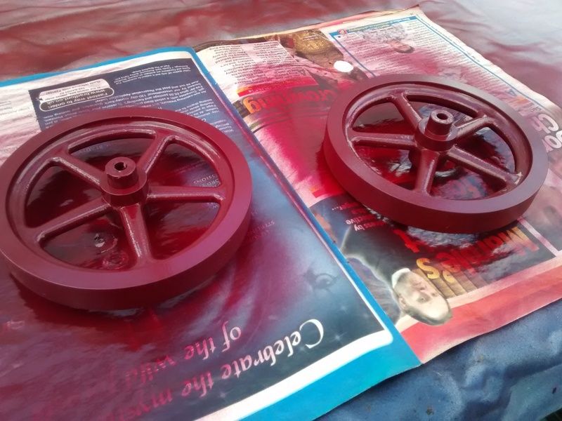

"Miliputtyed", where necessary, and sanded/ carved back........
http://i110.photobucket.com/albums/n95/Dayjo/2015%20Onward/IMG_20150323_150932719_zpsy7vm8va9.jpgScott Vacuum Engine......
A fuff of paint.......
http://i110.photobucket.com/albums/n95/Dayjo/2015%20Onward/IMG_20150325_143821165_zps6fqg7iif.jpgScott Vacuum Engine......
And, a tidy.......
http://i110.photobucket.com/albums/n95/Dayjo/2015%20Onward/IMG_20150326_114339560_zpsagjiuopt.jpgScott Vacuum Engine......
I think the rim, still needs a bit off the width. And the sidewall depth reducing a little.

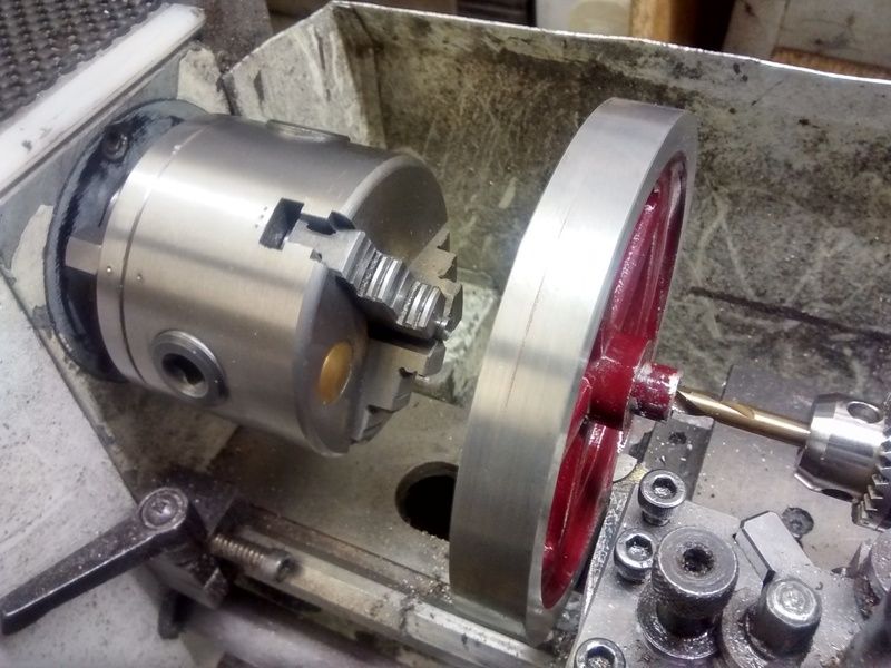

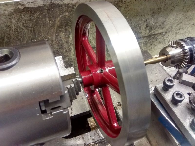

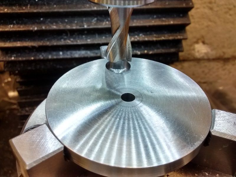

I decided, it was time to drill n tap the flywheels, for m3 grubscrews........
http://i110.photobucket.com/albums/n95/Dayjo/2015%20Onward/IMG_20150403_131928433_HDR_zps3yoa7dhc.jpgScott Vacuum Engine......
Trying the silver steel shaft, afterwards, it stuck, solid.
The only way to part, the parts, was to drill through........
http://i110.photobucket.com/albums/n95/Dayjo/2015%20Onward/IMG_20150403_130936785_HDR_zpsgn6gqe6e.jpgScott Vacuum Engine......
http://i110.photobucket.com/albums/n95/Dayjo/2015%20Onward/IMG_20150403_131308932_HDR_zpso1rzzvxw.jpgScott Vacuum Engine......
Then drill 8mm dia, and sleeve back, with mild steel insert.
This is not the first time, this has happened to me. I hope it is the last.
I can't get over, how tightly the alloy gripped the silver steel. Despite the fact, they were first fitted, some 3 weeks ago. And, have been taken apart/ assembled, more times than a Lego set!
Is there some unwritten rule. "No alloy sleeve, onto silver steel shafts"?  :scratch:
From a rather miffed, David D

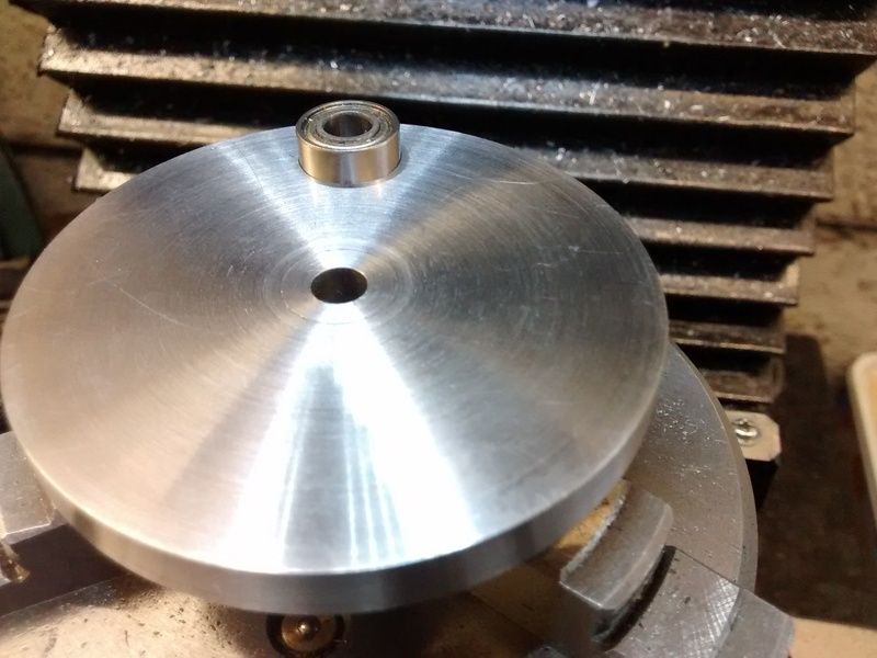

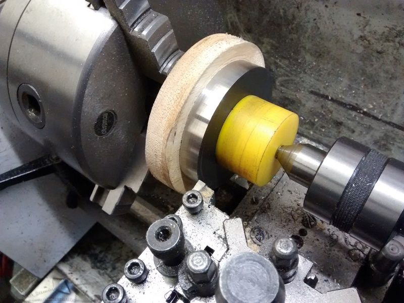

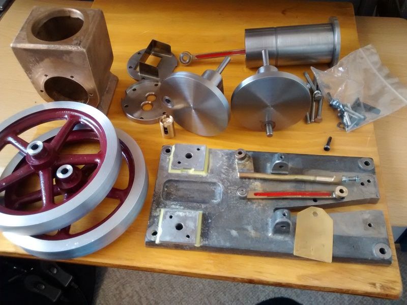

Finished the re sleeving. All went well........
http://i110.photobucket.com/albums/n95/Dayjo/2015%20Onward/IMG_20150406_114337003_zpsyzqa6mzo.jpgScott Vacuum Engine......
I decided to house the bearings, inside the flywheels.
Opened out with end mills, in 2mm steps.......
http://i110.photobucket.com/albums/n95/Dayjo/2015%20Onward/IMG_20150323_112136187_zpsmt4quk48.jpgScott Vacuum Engine......
Final pass, with 13mm slot drill, 5.5mm deep.........
http://i110.photobucket.com/albums/n95/Dayjo/2015%20Onward/IMG_20150325_142257385_HDR_zpsmb7zdbd6.jpgScott Vacuum Engine......
Should be a nice shove in fit, probably..........
http://i110.photobucket.com/albums/n95/Dayjo/2015%20Onward/IMG_20150326_103749687_zpsry0llhua.jpgScott Vacuum Engine......
Sandwiched the cam, between two 5mm thick cast iron discs. Drilled & tapped m3. All held with sleevelock........
http://i110.photobucket.com/albums/n95/Dayjo/2015%20Onward/IMG_20150326_104141994_HDR_zpscjnjckxf.jpgScott Vacuum Engine......
Slips in here, nicely. Plugged the grub screw hole, with it's annoying click........
http://i110.photobucket.com/albums/n95/Dayjo/2015%20Onward/IMG_20150409_085052708_HDR_zpsm9j84tjj.jpgScott Vacuum Engine......
A bit of clearance, here........
http://i110.photobucket.com/albums/n95/Dayjo/2015%20Onward/IMG_20150407_114449586_zpsuyu7eqci.jpgScott Vacuum Engine......
And there........
http://i110.photobucket.com/albums/n95/Dayjo/2015%20Onward/IMG_20150407_114541474_zpsku2tugir.jpgScott Vacuum Engine......
Screwed it all together. First flick, away it went!  :bugeye:
http://i110.photobucket.com/albums/n95/Dayjo/2015%20Onward/IMG_20150408_175022862_zpsx8mdbfcb.jpgScott Vacuum Engine......
And the video. Cos, I know someone will ask.........
It's now in lots of pieces, for final finishing and assembly.........
http://i110.photobucket.com/albums/n95/Dayjo/2015%20Onward/IMG_20150409_190338788_zpsuczao1up.jpgScott Vacuum Engine......
