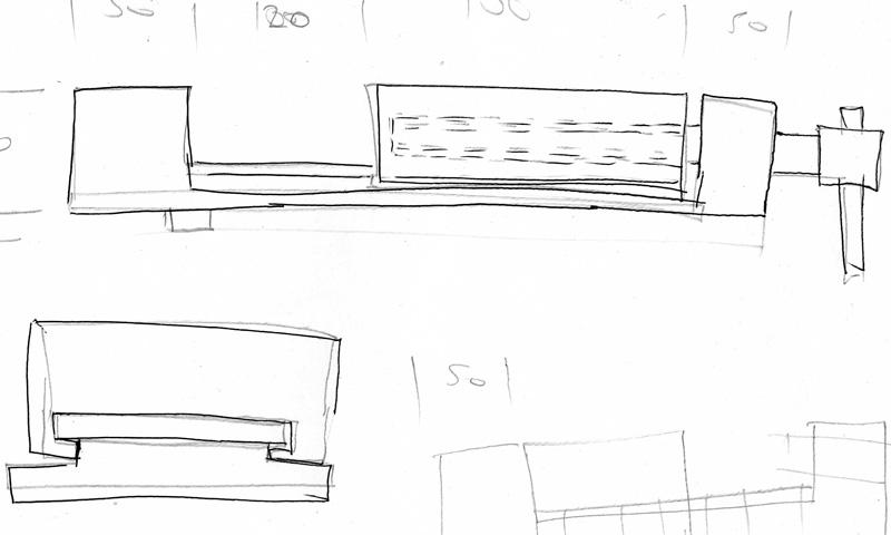

Having completed my milling machine I felt that the next thing to make was a milling vice. Like the milling machine I'll be using aluminium castings. This is a simple project, it only requires two castings.
This is the dreadful sketch that I made as preparation for the build.

« Reply #1 on: August 09, 2014, 12:11:18 PM »
Some of the best design's started on a napkin!

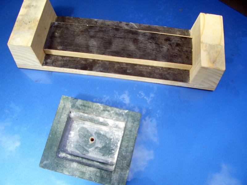

The patterns are very simple, but when I first tried to mould the sand for the moving jaw the sand in the recess broke away. To solve the problem I drilled a hole through the top of the pattern so that I could poke through the pattern onto a piece of cardboard that would help to release the pattern.

Of course when I tried again it released perfectly!

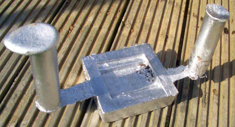

Here is the casting for the moving jaw. I was eager to get it cast today as the weather forecast for the next few days is not good as we will be receiving the remains of an "American" hurricane passing over UK.
A chunk of sand fell out but it does not matter as all surfaces will be machined.
I will be able to machine it whilst waiting for the weather to improve so that I can cast the body of the vice.

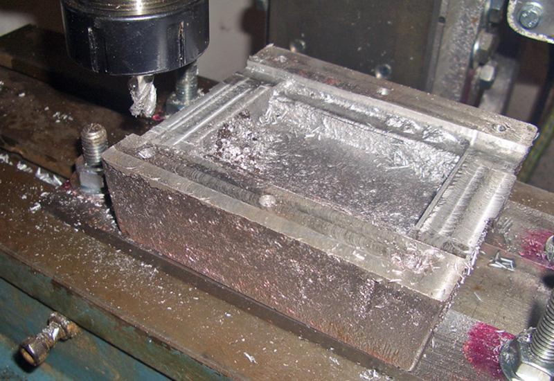

I've started machining the casting. Mounting it was the first problem as not having a vice already meant that I needed to find another way to do it. I drilled and tapped the holes that will eventually be used to fix the clamps that fit on the slide. I used these holes to mount the casting onto two flat bars 40 x 6mm and then was able to bolt the bars down to the table.
I've partly machined the bottom of the casting and the milling machine is working nicely, it is quiet and rigid and giving a good finish.

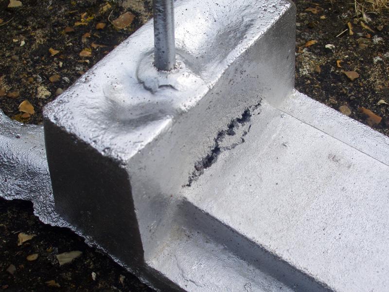

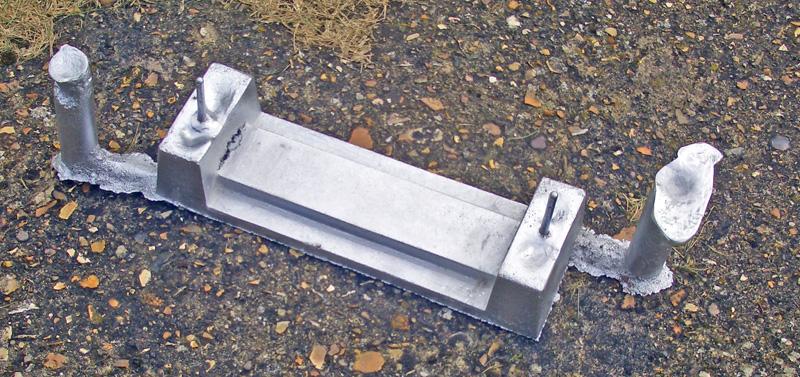

Well that was a disappointment, the moulding of the sand went well, likewise the pour. When I opened the mould I got quite a shock. The surface finish of the casting was amongst the best I have had, nice and smooth and no corners broken away. I had gated it from the ends so as to avoid too much hacksawing, I expected some shrinkage on the tops of the end blocks and allowed extra material to cover it. But, when I turned it over I was greeted by a large amount of shrinkage and the metal had torn apart on the inside corners!
Well it's back in the pot tomorrow, weather permitting, and I'll gate it from the tops of the blocks, I might try to extend the gates in order to get a larger head of metal to reduce shrinkage.

I would have poured that shape in the vertical, gating from the bottom and left a thickness for machining off the top. I know it means a custom cope & drag  :wave:
  • Posts: 6833
Re: Making a milling vice
« Reply #15 on: August 12, 2014, 12:24:05 PM »
Forgive my opinion here, too Norman, and take with a grain of salt.... I like the horizontal layout okay, and the bed is important to preserve clean compared to the ends -- keeping that part low in the mold helps.
I think gating the sprue high up will wash sand down the ends during the pour, so I like the low gating as well.
You just basically need to feed metal into the inside corners during solidification so I'd try a bigger  riser off the edge at that corner, and thicker than the upright is --maybe even a blind riser -- like a ball of styrofoam. The riser has to solidify last, so needs to be thick.
Sharp Inside corners in massive casts tend to tear like that since they solidify last, and the leg and main base tend to pull metal away from it while soft.
 It helps if there's a radiuus there instead of a sharp corner, even if you machine it off afterwards.
Also a bevel on the outside corner can help.
Also the present sprue and riser look small. They should normally be larger in cross section than the largest thickness you are feeding -- which looks like the bottom of the uprights. That way they hopefully won't solidify before the corner does and can keep feeding iliquid metal.
I know just a bunch of suggestions, but some or one of them might help.
Your base does look good!

Thank you Andrew and Steve for your suggestions. I think that I will keep it horizontal for the next try. I'll add fillets to the corners and make the header and riser bigger. Funnily enough I did not have any problems like this with the much larger castings for the milling machine and I used the same size header and riser for those as I have here. I am sure that the gates between these and the body of the casting are too small as I was trying to keep the metal section small so as to reduce the hacksawing needed, my angle grinder is bust!

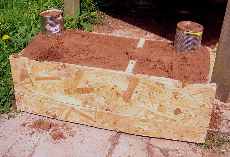

I kept a pile of baked bean tins with both ends removed in my foundry. Ram them up tight with floor sand, then press a piece of 1.5" copper pipe through them, and hey-presto you have a taller riser. I used to sculpt them at the upper end to a funnel shape with one of my moulding tools, and place them on the cope over the existing pour and riser, putting a little sand round them to seat nicely.

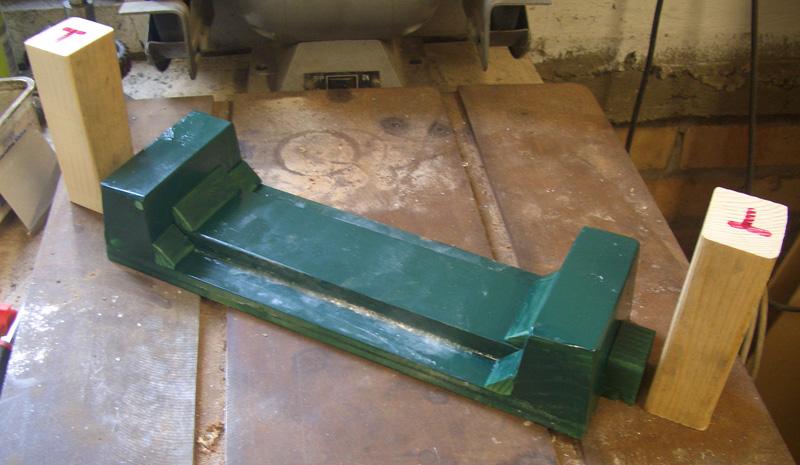

Here is the reworked pattern. I've done it quite crudely but I am sure that it will be OK as I intend to machine it all over. I've put in quite large fillets where I had the splits and added a block at each end for the gates. I have made patterns for the header and riser to mould in situ. I normally cut them with a piece of steel tube about
1 1/4" diameter. I will also raise the height with two cans as suggested by Andrew.

« Reply #20 on: August 13, 2014, 06:51:24 AM »
As I suspected, even though the pattern is a bit rough it moulded up OK. Here is the flask set ready for pouring. I am now waiting for the aluminium to melt.

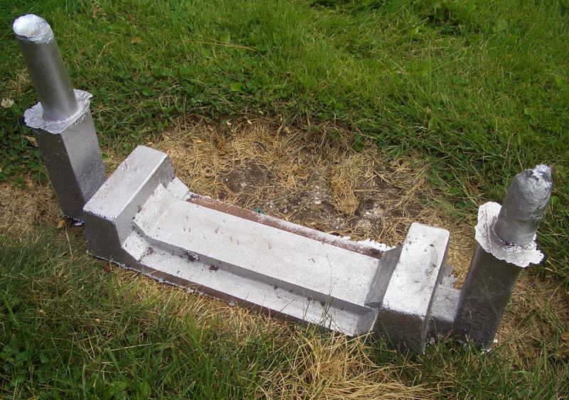

Oh! I totally misunderstood you. The internal corners were already filleted with body putty, there were no sharp corners. I couldn't chamfer the outside corners as that is quite an important part of the base. I'm going to knock it out in a few minutes and then we will know what the outcome is.
Offline NormanV
  • Posts: 633
  • United Kingdom
« Reply #23 on: August 13, 2014, 08:24:56 AM »

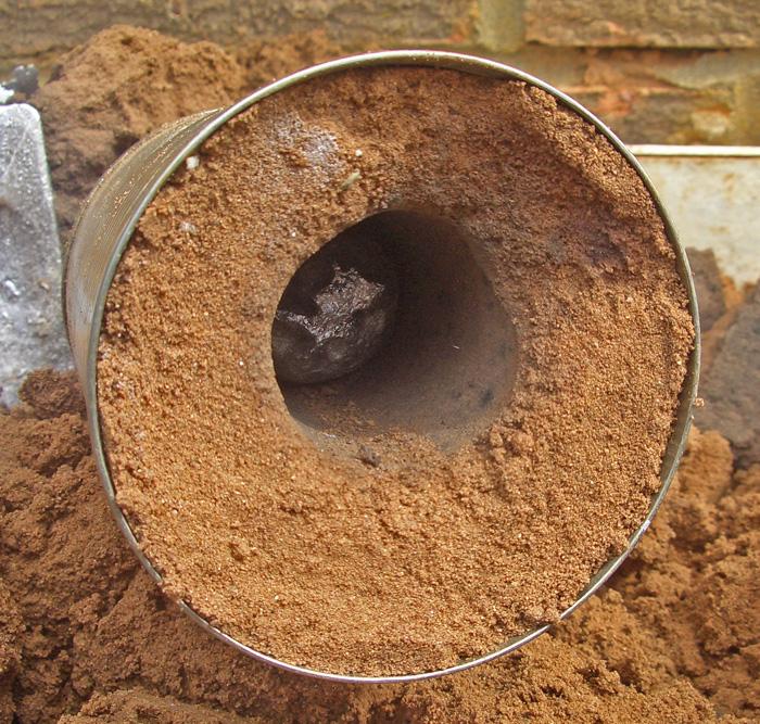

It turned out fine. There is a little shrinkage at one end but that will be machined out. There are no cracks.
The header has suffered enormous shrinkage, right back down inside the tin can. The top of it can barely seen in the second photo.
