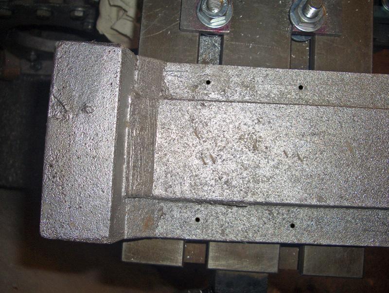

Steve, I have to remove the top fillet, I'm not sure about the bottom ones. I may have to remove them to make space for the mounting bolts. I was intending putting pins in the bottom to engage with the Tee slots to set the vice square to the mill.

It would be nice if you could keep those side fillets at the fixed jaw end,
For a hold down at the fixed jaw end, my vise has a lug extending off the main casting, and two lugs on the side of the base casting.
If you wanted a lug at the fixed jaw end you could shape one out of the gate. To get more material you could cut that sprue off horizontally, flush with the top of the gate.

I have checked the casting against the milling machine table and find that I won't need to machine away the side fillets. This  black dots on this photo show where the fixing bolts will go. I plan to have hollow dowels on two of them to locate the vice.

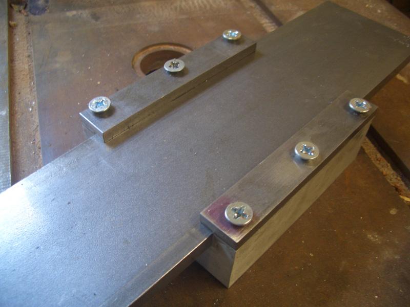

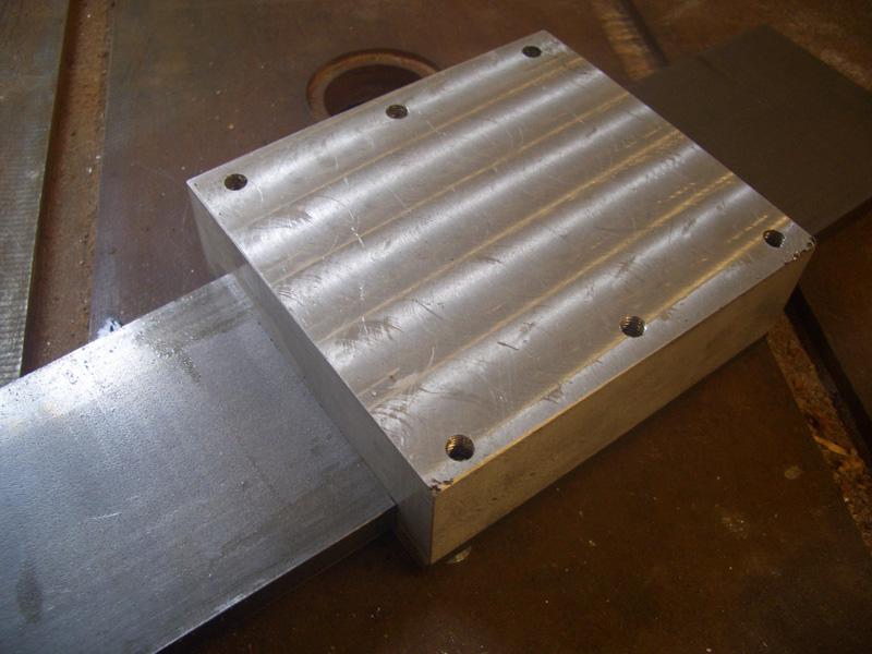

 I've machined the moving jaw all over, I just need to bore the hole for the adjusting screw to pass through. The box slide turned out nice and smooth with no play. I've temporarily attached the clamps with countersunk screws until I can obtain some shallow head cap screws.
The screw holes that come through the top will be filled. I had to drill them right through to enable me to clamp the piece on the mill.
Next job is to start machining the main casting.

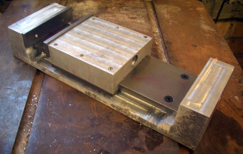

« Reply #41 on: August 15, 2014, 03:07:04 PM »
As promised, here is the main casting with the slide attached. I had to use a mixture of screws as that is all I had, doesn't affect the performance but doesn't look too good.

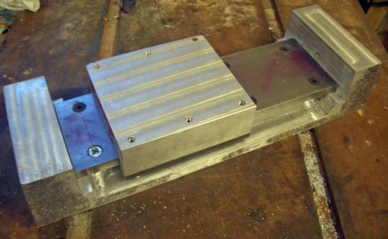

« Reply #42 on: August 15, 2014, 03:08:33 PM »
Here it is with the moving jaw installed, I had to machine some of the fillet away in the lower corners as it obstructed the moving jaw.

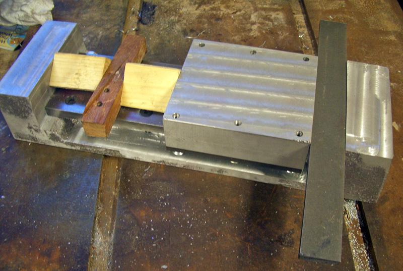

« Reply #43 on: August 15, 2014, 03:11:46 PM »
I was anxious as to whether the care that I took to get the jaws parallel had paid off so I made a couple of wooden wedges to clamp it and was delighted to find that it clamps squarely.

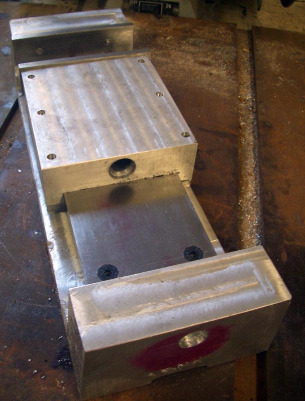

« Reply #46 on: August 16, 2014, 02:09:58 PM »
The steel facings are now fixed to the jaws, they don't line up perfectly but that will be the first milling job on it when it is finished.
I've found two problems with the "make it up as you go along" method of design.
1) There was not enough space to fit a 5/8" clamping screw so I will have to use 1/2" but I don't think that will be a problem.
2) My choice to use shallow head cap screws to hold the clamps was unworkable as I did not make enough space for those screw heads and the clamping bolts to pass each other. I can't remember why I did not want to use countersunk screws for the clamps but that is what I have had to do.

I've got the holes prepared for the clamping screw. I had originally planned to buy an acme threaded rod for this but have decided to use standard 12mm threaded rod, albeit left hand thread. Where it passes through the fixed end of the main casting I have made the hole oversize  so as to avoid any problems with alignment.
