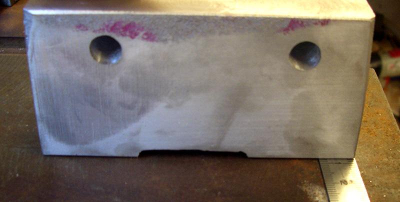

Thank you for the kind comments, I think they were a little premature the casting has warped! I went to do some more work on it and found that it now rocks when placed on a flat surface. On inspection I found that I could fit a .5mm thick ruler under one corner when it is pressed down on the flat. In order to remove the slide and moving jaw I had 8 screws to remove, two of which were hidden under the moving jaw. Due to the distortion the moving jaw was tight to move, I pulled on it and it went suddenly, and bit me!

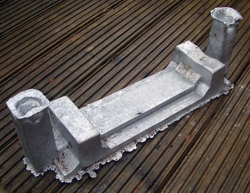

I've cast it again and this time had a bit of an 'event'. As the header and riser filled to near the top the mould opened and metal started leaking out of the side. I rapidly put my foot on top and pressed down, that stopped the leak. I poured in the rest of the metal from the crucible and waited for the metal to have a chance to solidify before I removed my foot.
To my surprise I still got a good casting, there is quite a lot of contraction at the riser end but there is enough metal there to do the job.
I think that I might take Beone's advice and stress relieve the castings in the oven.  Beone it might have been a good idea to specify  the units when quoting a temperature. When I made my first furnace Dave Gingery suggested curing it at 400 degrees in the oven, I did not give it a thought and set the school workshop oven at 400 degrees and nearly burnt the school down 400 degrees Celsius is very hot!

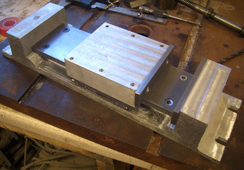

« Reply #64 on: August 24, 2014, 02:20:31 PM »
I've now got the second casting almost to the same stage as the first one but even this warped slightly. When I took it off the mill after milling the base yesterday it sat absolutely flat on a surface plate. By this morning it had developed a slight rock, it is not a major problem as it straightens out when I clamp it down.
You may notice from this photo that I have added mounting lugs to fit the tee slots on the milling table to enable me to mount it in either direction on the mill.
Tomorrow I will start working on the lead screw that Philf kindly sent me.

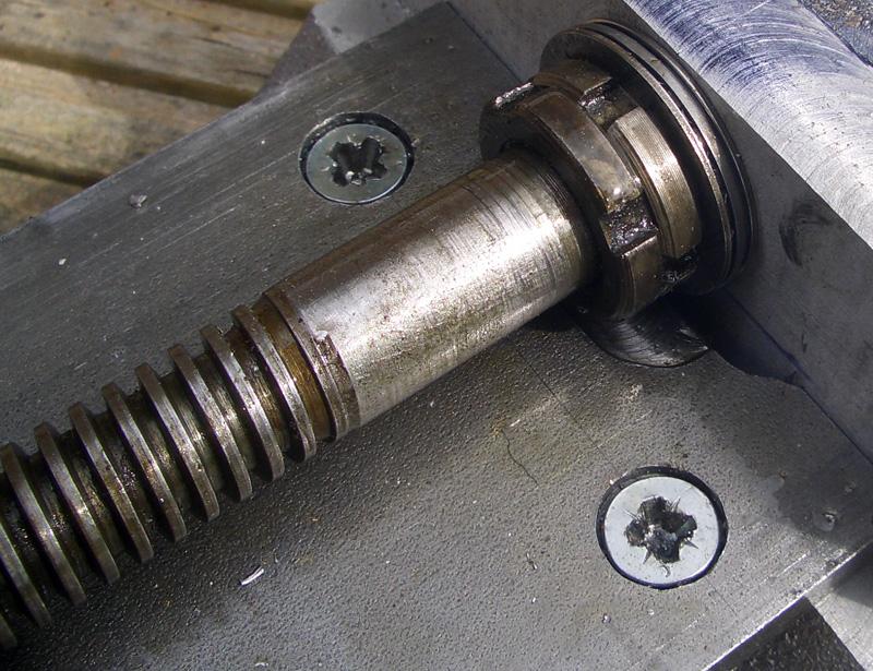

This vice is nearing completion. This morning I clamped a piece of round bar in it and was pleased to see that the jaws are parallel and it clamps evenly.
But, I did learn some useful lessons today also. I wouldn't class myself as inexperienced but most of my engineering work has been with steel, cast iron and aluminium. This morning I had to machine the bronze nut for the leadscrew on my lathe. After a couple of dig-ins using my usual tool I thought that I would grind a new one with no top rake, well, it's chalk and cheese! After that I backed off the point of a drill and it went through with no grabbing. I have always been too lazy to grind separate tools, all I can say is, "what an idiot I am!"

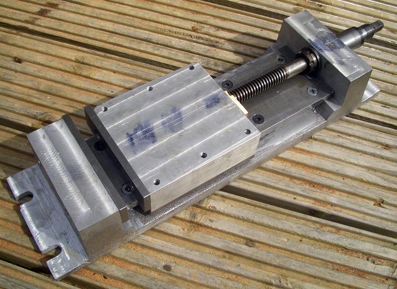

Taaraaah! It is complete!
I have just finished assembling it and am delighted at how smoothly it operates and firmly it clamps.
I fitted a roller thrust bearing on the screw which must help with the amount of force needed to clamp it.
The capacity of the vice is 100 x 75 x 25mm, I designed it to be 100 x 100 x 25 but the plain section on the screw prevents it from opening further. Next time I plan to make any equipment I should ensure that I have all the parts before casting any metal.
