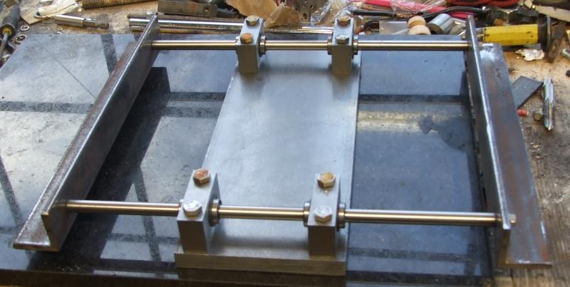

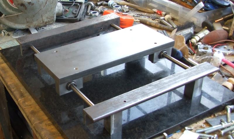

Everything I want to do requires slides of some sort or another. I have made slide before by endless hours of lapping crude steel plates but this gets tiresome.
I have decided to have a go at a project which will hopefully make the process a little less tiresome and make a surface grinder, I am going into this with low expectations and the hope that it will at least make the lapping last hours rather than days.
I have started by concentrating on the X,Y movement for the moment, I already had a couple of 8mm bars salvaged from printers and some linear bearings to suit them which I brought a while back with the intention of making a reprap printer. so these where drilled and tapped for 5mm bolts each end to fit into the housing for the front to back travel. I would prefer something more robust but if this works well enough it may be able to make better for itself. I first made it with just a front and back but then thought that it might flex a little too much so made a square frame to hold it steadier.

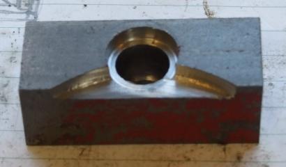

I made some bearing holder blocks for the top of the runner, this will be a cantilever type setup.

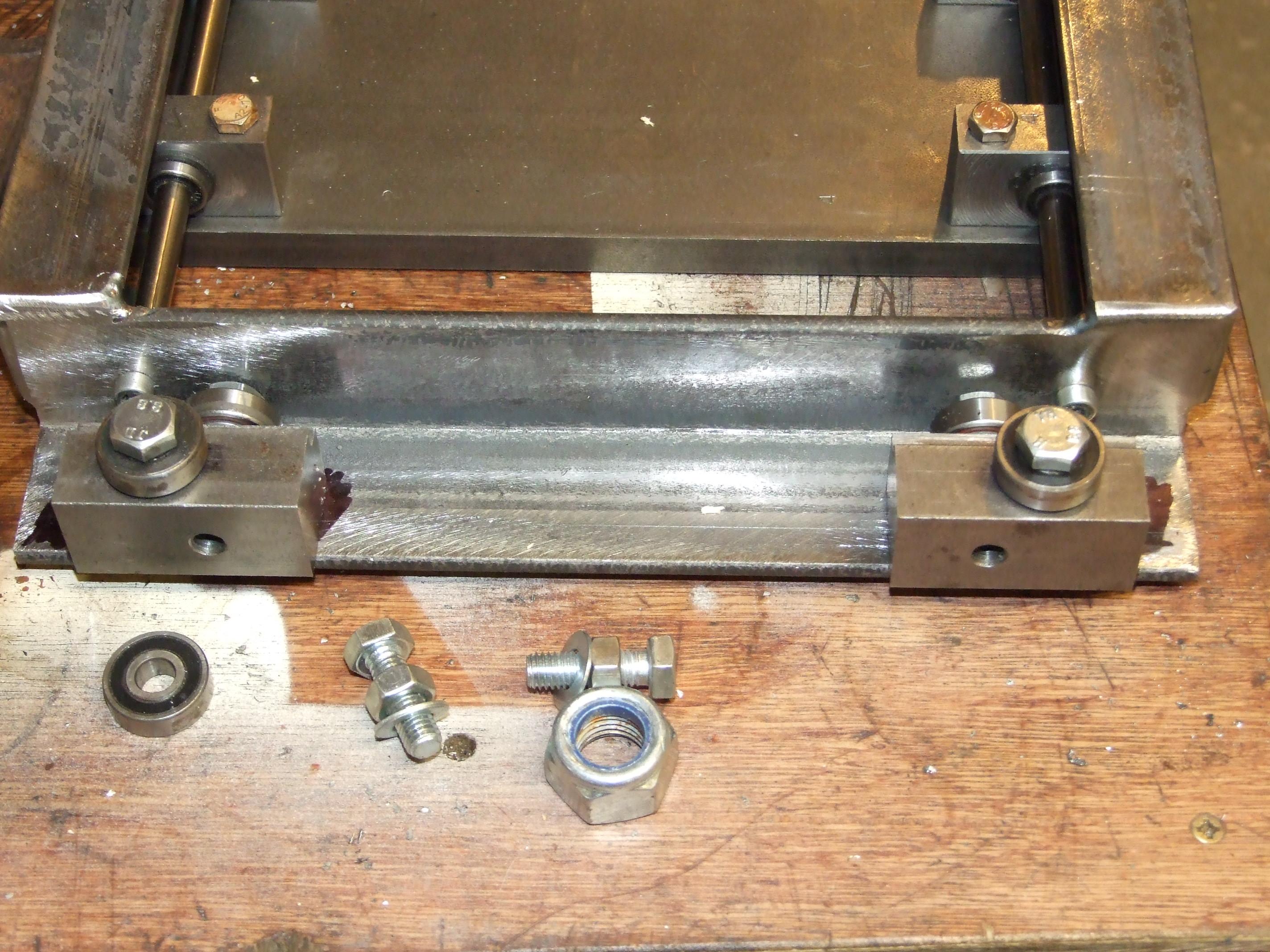

Next I needed to make the lower runner bearing holders, they are slotted on the side to adjust the table for squareness I still need to make and attach the blocks to do this adjustment and lock it in place. 5th picture shows them attached to the underside of the table and 6th picture shows the table on the bar I am going to use for the runner.
Hopefully tomorrow after work I can sort out the adjusting blocks.

I hope that you are going to put some boots on those slides to protect them from dust and grit.  If you don't the grit will play havoc with the smoothness of movement.

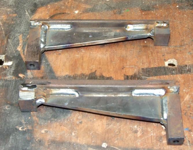

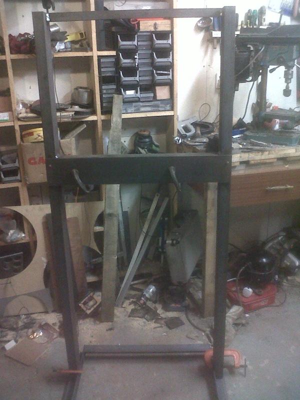

yep rubber wipers and brushes as well as guards to hopefully stop anything getting under the bearings.

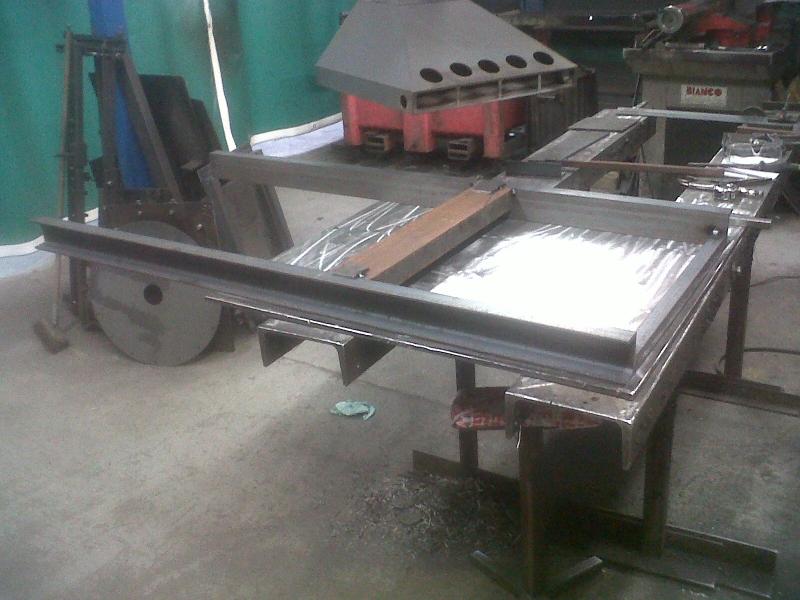

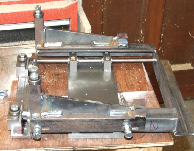

Had a little time to spare at work today so made some parts for the frame pictures show the base and upright bits going out to shed after pointless to get the blocks done.

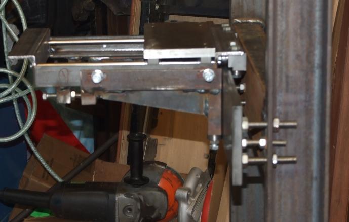

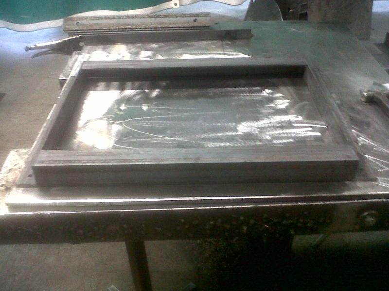

Got framework home and spent a little time in the workshop, I was sorting out the main runner plate. The picture shows the pilot drilled plate in place one the frame (sorry for the rubbish picture but I didnt have proper camera with me)
its will have 3 bolts pushing against the plate to get it lined up properly and 6 bolts to hold it to the frame and also eliminate any twist in the plate.

Loosely bolted together but not set up yet and I have to say I am very pleased with how smoothly the table glides along on this plate. Dont want to jinx it but maybe it will give good results after all.

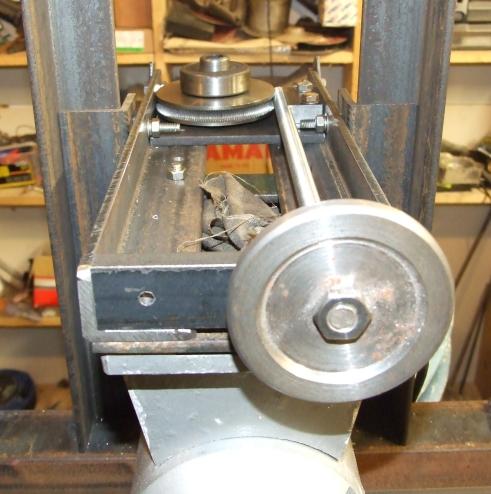

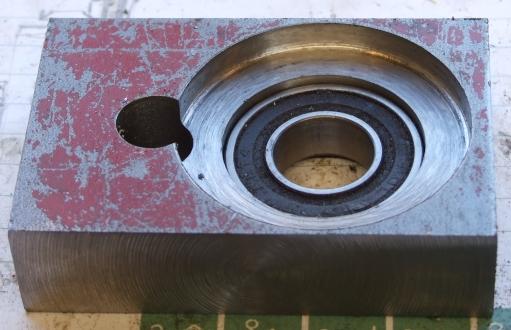

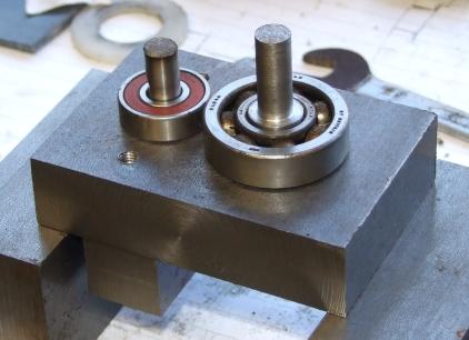

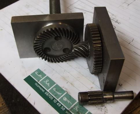

I have been trying to work on the gears for the feed screw but forged ahead without a clear idea in mind about what i needed and as such I have worked myself into a corner.
I am now thinking its a scrap it and start again job, however the gearing I have found should (if I have done my maths properly) give me a little over 0.1mm per full turn of the handle I just hope this will be fine enough control.
  • Posts: 9051
Re: surface grindy type project
« Reply #7 on: March 19, 2014, 04:17:29 PM »
Many a grinder has two speed gearing, as the fine feed needed is a right royal pain if you need to move a significant distance while setting up. On my cylindrical and also my surface grinder you pull out a knob to engage a coarser feed. Perhaps you could incorporate something similar ?

Its not a bad idea actually if I can figure out a way of driving the second stage of gearing direct then that would bring the travel to .5mm per turn and would certainly save a lot of handle turning.

Not sure why you think it's a scrap and start again job as you didn't say. Or I didn't read carefully enough. From my looking at the last pic, if the gear plate attached to the lead screw is rotated 180deg it looks like it would line up close enough to allow fixing of the two plates so the gears mesh ok. Of course the way you have it may be what is needed for mounting. Good luck with whatever you decide - tis all a learning experience. Think of it a practice if it helps.

Why don't you use a sliding gear that way you could have the fine feed and the more rapid travel?

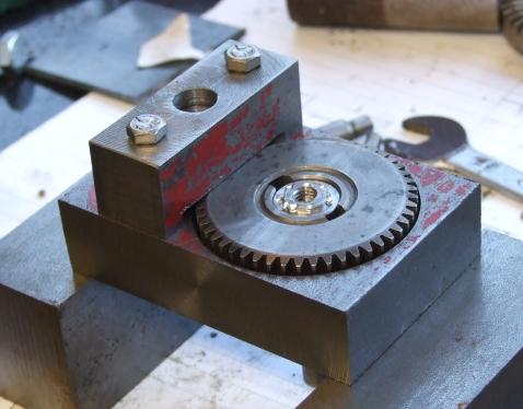

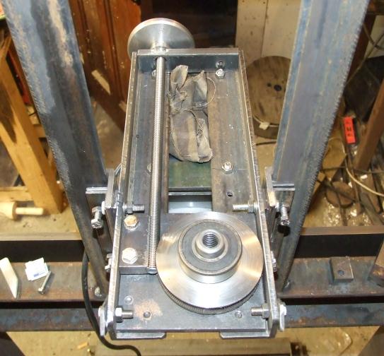

This weekend had a fair bit of time to spend in workshop working on the gearbox for the lowering and raising of the grinder posted a few pictures which will make sense once I complete the bits and put it together.

PekkaNF you have really done it now  :hammer: I was merrily making this gearbox when I started to think about your comment and had a eurika moment followed by a  :doh: for not thinking about this before.
A much better way which would solve both the problems with feeding the grinder to the work and having a course feed for setting it close. If I can A) get hold of the correct tap for the screw I am using (possibly a 18X4 LH trapazoidal) and tap the center of a worm gear or B) turn the nut I already have and press it into a worm gear, I can lock the thread at the bottom to use the fine feed or let it free and turn the screw for the course feed, something like that shown in picture except the screw could be locked off rather than fixed.
I hope you get the idea of what I am thinking.

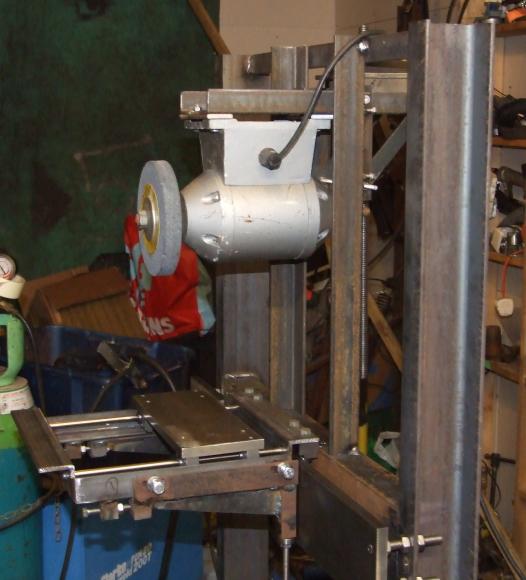

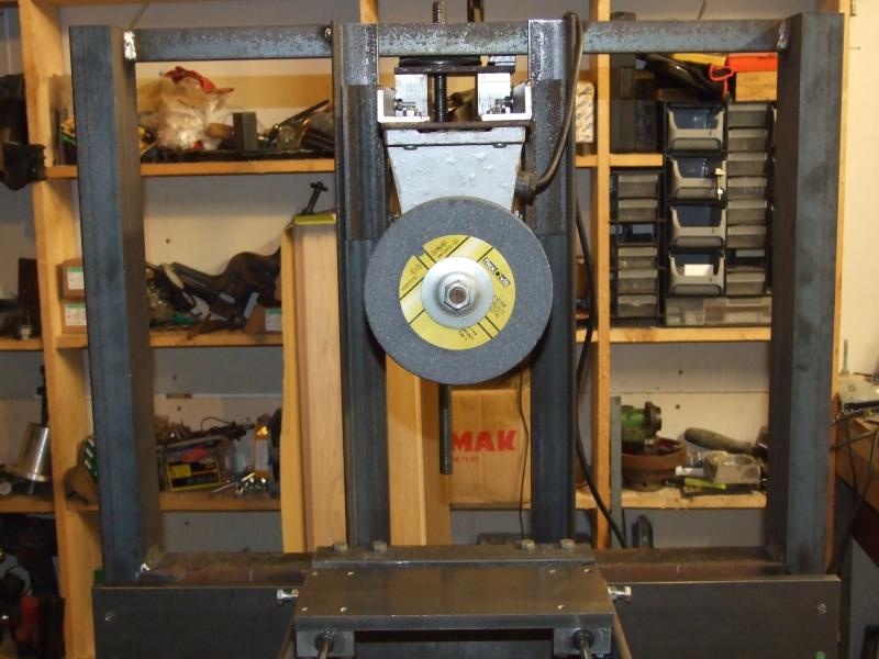

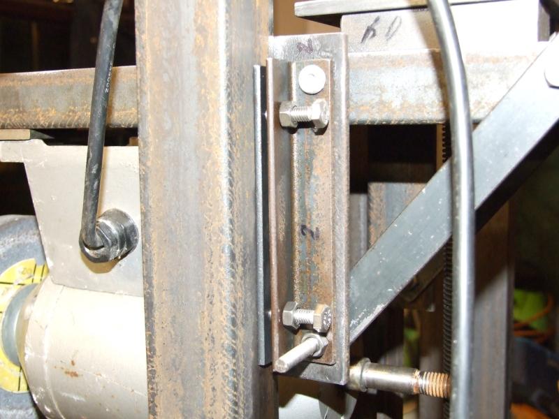

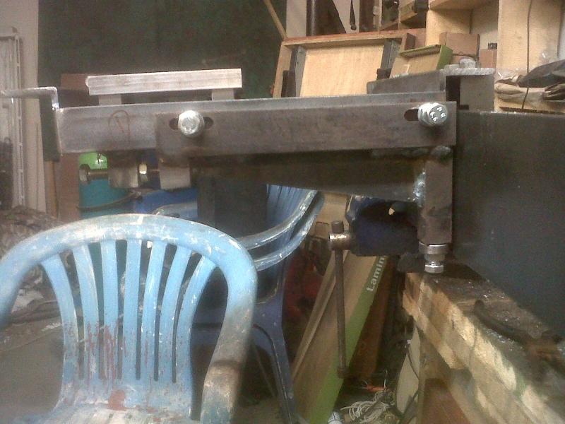

Made some good progress today (thanks mostly to the word NO! long story) anyway I started to set things up better than they were, the main runner plate is set as good as can be until I make a few cuts and see how it is grinding. started to weld the frame to the base but ran out of wire before I had finished tacking it so its still clamped for now until I get more wire.
Also started on the up/down for the grinder its just a simple slide using angle irons and a little bit of flat for a gib. It all seems to go together well. The gearing for the screw for this is well under way too but i forgot to take pics of just that so theres one job for tomorrow. :D

To tap trapezoidal is not very easy and taps are not exactly cheap. Also threading small ID trapezoidal thread is no fun. Buy the nut and make it do if you can.
I think got your idea....you want to do fast traverse by turing the screw, and (slow) feed by using worm drive. Nifty. You need brake/lock for the srew tough, but that should be pretty doable. Simplest form might be extra nut on the tapezoidal spindle to lock it imovable to the frame.

Went with the altering the nut option in the end (see above) as wife couldnt get me the right sized tap it seems to be a special thread which are more expensive and harder to get hold of, no matter though its all going in the right directions now  :thumbup:
As for locking the screw to use the fine feed I am simply going to have a locking bolt contacting directly with the screw it wont hurt if it chews it a little as it wont effect the feed.
