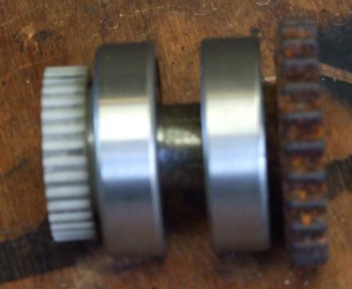

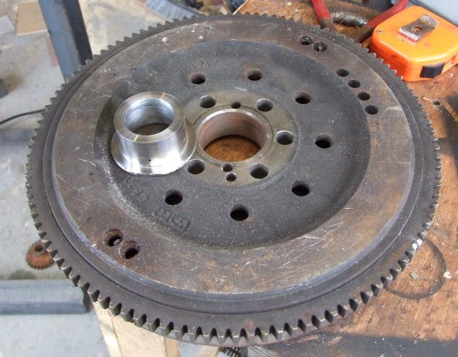

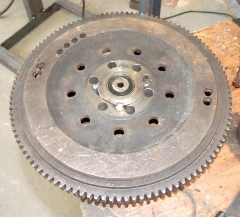

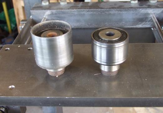

Today I started by taking a car cam belt idler and removing the outer bit and remaking it so it fitted into the center of a flywheel this will have the variable mechanism to move the table left and right. Then I made the shaft to drive it and started the housing for this, the picture for this i will post tomorrow.

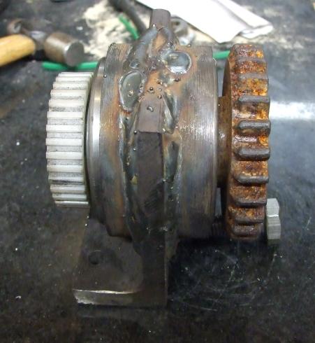

Well did most of the housing today just need to clean it up for the sake of looks (not that it will be seen now i think about it, it will be covered by a guard). Only had a small amount of stock so the bearings are not totally enclosed but this will not matter the housing is merely holding them straight they will be held in place by the shaft itself.

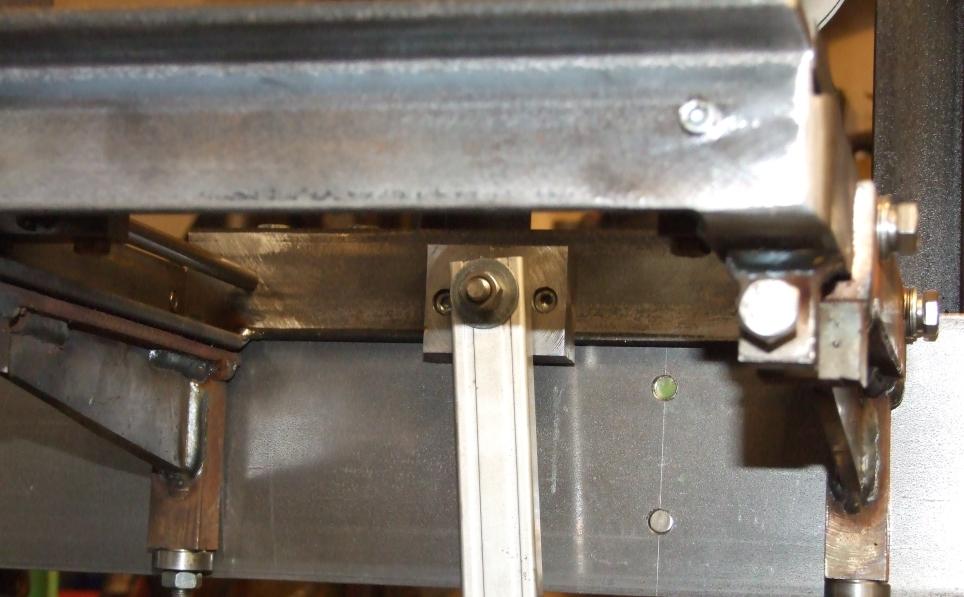

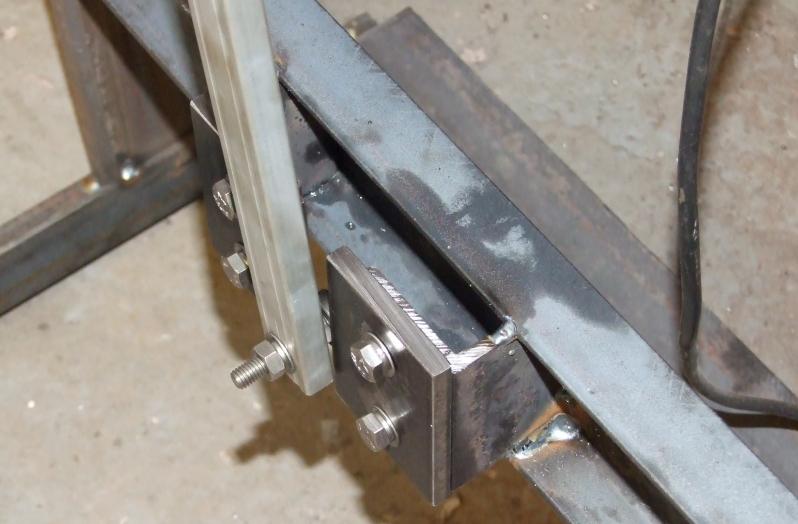

Progress has been slowed due to working on getting a vw campervan to mot standard but I have been working on getting the left to right mechanism going and so far have done the top pivot and bottom slide. The bar I currently have connecting them is a bit of extruded aluminium which may not be man enough and need changing but I will see.

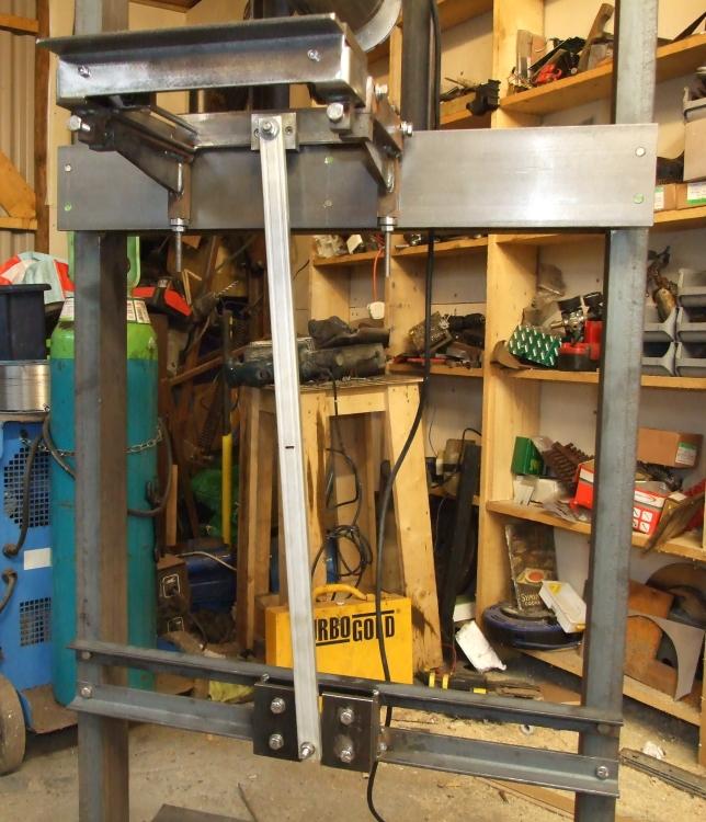

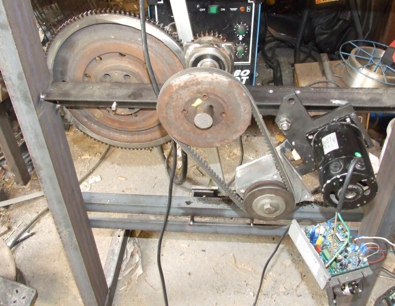

I decided to take a break from the chores I have to do on sunday and get some work done on the left/right drive  :D I think it should be about right now but if I need a bit slower I can increase the size of the larger v-belt pulley.

so I have decided I do need a bigger pulley mocked it up today to see it running.
the video makes it sound a lot noisier than it really is but the squeak once per cycle is the belt slipping slightly when it has to stop the carriage and reverse it, hopefully higher gearing will solve this. The bar you see is only a temp when I am happy I will get some rod ends.

changed out the pulley and its way more managable now so just for fun I decided to do a little test  :)

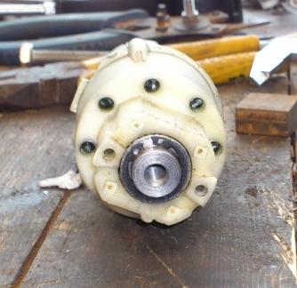

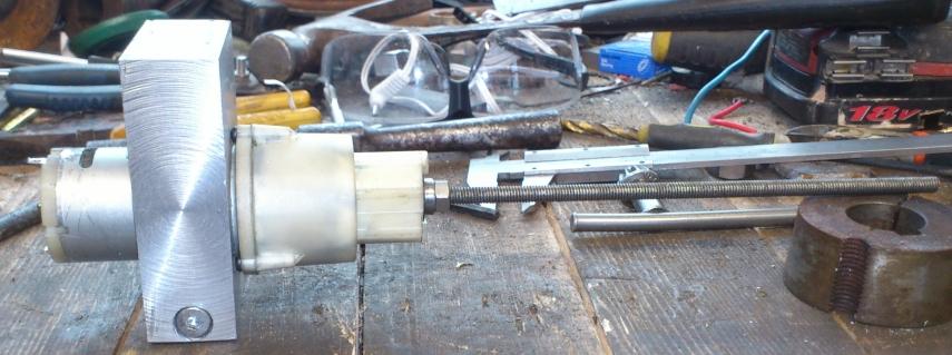

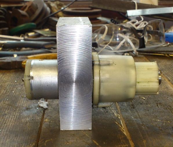

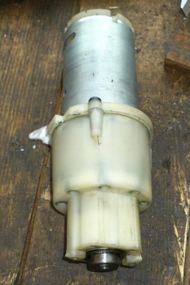

I have stripped down a old 9.6V drill a friend gave me and salvaged the motor and gearbox. Then I stripp down the gearbox and sawed the shaft shorter before facing it off, drilling and tapping the center for a m6 screw.
Next I made the mount for it from a block of aluminium, still have to drill and tap the block to mount it on machine but will do that after I work out the rest of the mechanism.

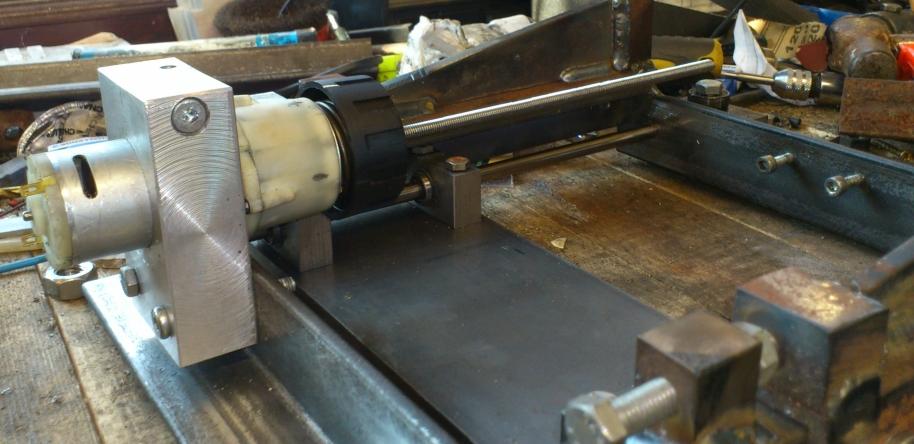

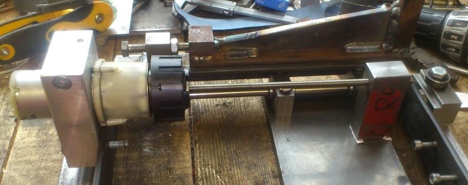

Had to gather together some of the bits I threw away as I forgot to take the torque limiter mechanism into account, I could have just locked the mechanism but thought if I could find the bits it would be a handy function. So found them and installed them, then mounted the setup on the table.

No major progress today just added the block for the screw.
