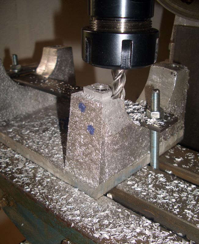

« Reply #182 on: August 02, 2014, 11:44:56 AM »
Today I made swarf!!!!!!!!
There are just a couple of little jobs to finish off and then it is done
What shall I make with it? Another machine?

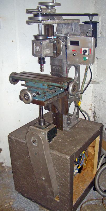

Well done Norman.  :thumbup: Let's see a nice full shot of the machine.
Offline NormanV
  • Posts: 633
  • United Kingdom
Re: Building a milling machine
« Reply #199 on: August 18, 2014, 01:42:53 PM »
Thank you for your kind comments.
Thank you Andrew, I'll let you know when it has arrived.
Arbalist here is a full length photo, if you look closely you will see a 12" ruler propped on the front of the table.
The working envelope is X 290mm Y 150mm Z 210mm
I need to get a door made for the electrics compartment.
