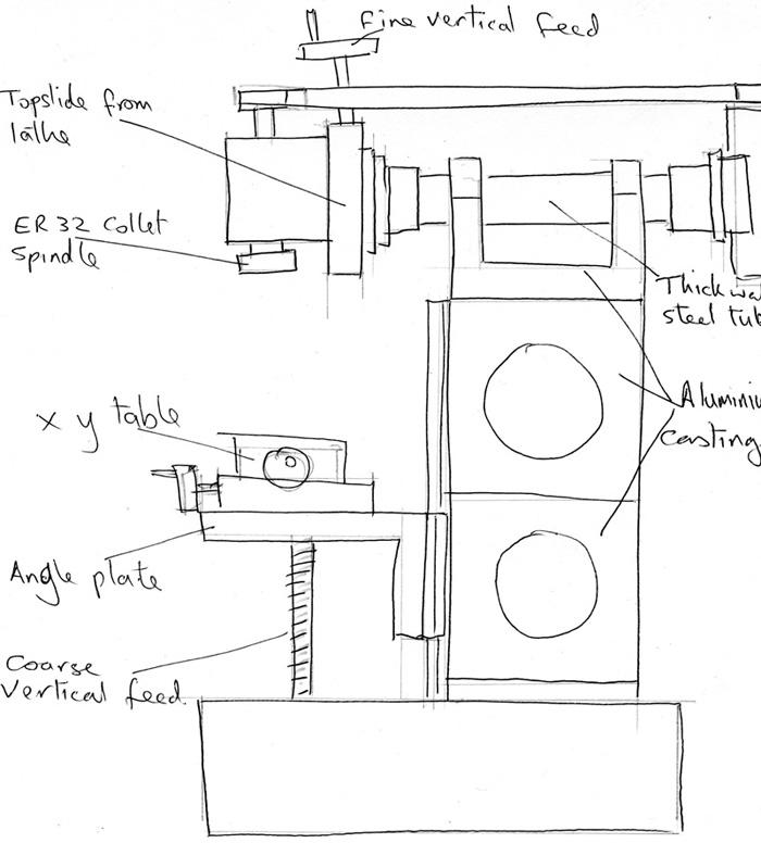

Some of you may have noticed my questions regarding problems that I have been having setting up to cast aluminium. I have been doing this as I am planning to build a milling machine. I have based the design on the body of Dave Gingery's shaper as it allows adjustments to be made to the build to achieve the accuracy needed (I hope). Here is a sketch of what I am planning.

The main body will be aluminium castings and I will recycle parts from old machines where it will achieve accuracy. For example the fine vertical feed is a lathe topslide mounted on a thick wall steel tube that also carries the motor. I have used the tube as it allows me to adjust the verticality of the head in relation to the table. Any comments would be appreciated.

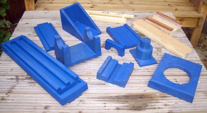

I may use a coordinate table for the X and Y axes in order to save time but I have made the patterns to cast my own in aluminium if I decide to. Here are some of the patterns.

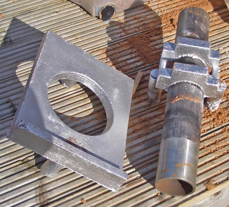

« Reply #3 on: February 28, 2014, 01:45:45 PM »

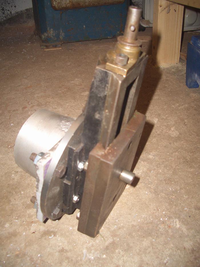

The first casting that I did was for mounting the lathe topslide to the steel tube across the top. I had been having problems getting my moulding sand to the right consistency and the casting turned out very rough so I had to machine it all over. Since then I have not had those problems.

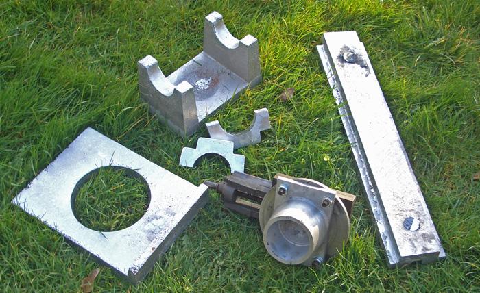

« Reply #4 on: February 28, 2014, 01:58:08 PM »
After machining the casting I attached the cross slide with a steel disc that I had as a mounting plate between the two.
The next casting was for the front of the machine where the angle plate shown in the diagram will mount. My first attempt warped but a second try was successful.

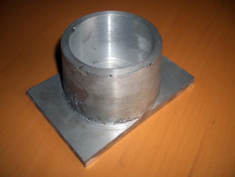

« Reply #5 on: February 28, 2014, 02:02:05 PM »
The castings are getting more straightforward to produce as I get more practice at it. It is a couple of years since I last did any casting. Here's a collection the I have done over the last ten days or so.

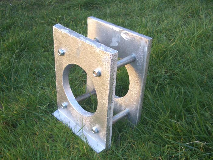

« Reply #7 on: February 28, 2014, 02:05:20 PM »
Yesterday I assembled the base of the body. The holes are were in the pattern to provide support for the sand over the large area of it. I will be casting the upper sections of the body over the next few days.

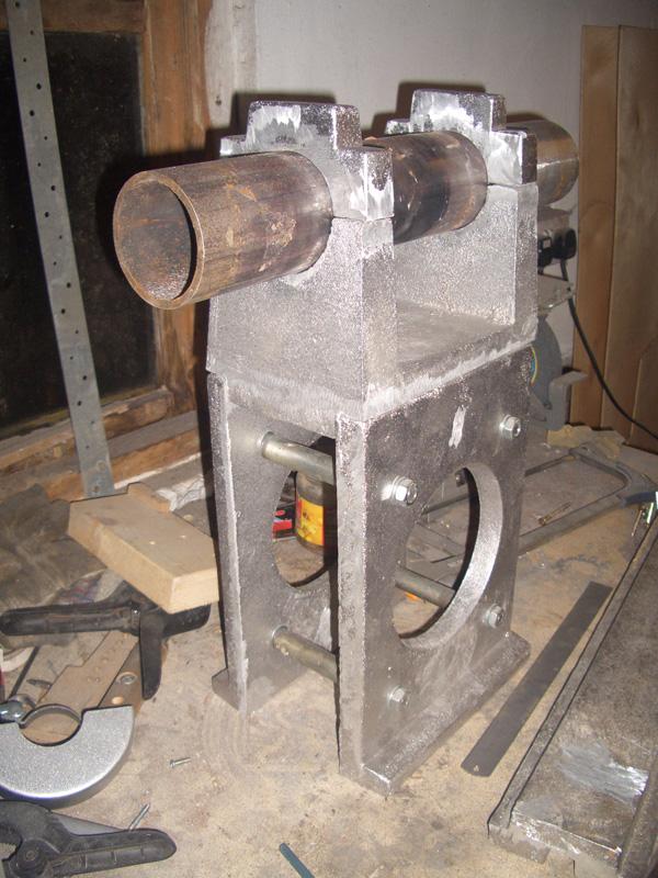

« Reply #9 on: February 28, 2014, 02:11:26 PM »
This morning I loosely assembled the top onto the base just to see what it will look like. The extra side pieces will be in there eventually.

Yes Superc I read your post about your milling machine. The tube that I have used is long enough for me to adjust the overhang but it is not my intention to have it as an adjustment to use in the operation of the machine. I intend to set it the once and lock it in position when it is set in the best position.
As for rigidity I am making the aluminium quite thick, typically 18mm and I will fill all the voids with concrete or an epoxy based filler when it is complete. I hope that that will be sufficient.

« Reply #12 on: February 28, 2014, 02:25:22 PM »
I was particularly pleased with how the casting for the hold down caps on the tube turned out. It is the most complicated pattern so far and I was concerned over how easily it would release from the sand but I had allowed plenty of draught and it released easily. I used the steel tube as a former for the curved section to save having to machine it. I smoked it with a candle and it released easily.
