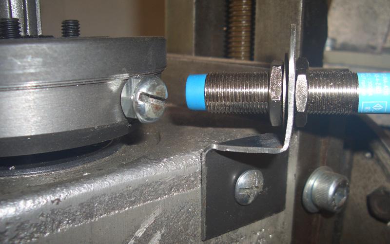

Norman,
I agree with Andrew. It's a proximity sensor and not a Hall effect sensor so no magnet is necessary - just a hole. The problem with 1 hole is that you may have balance problems. If your Tacho has a divide by 2 function 2 holes would be better.
On my mill I did use a Hall Effect sensor and 1 magnet in an aluminium Poly V pulley. To balance it I glued a piece of same size stainless steel 180 degrees from the magnet. It quite happily runs at 10,000rpm.

Drill out the magnet, tap, replace with a grub screw about half the depth of the hole in length. You should be able to balance with the screw proud, which should also trigger the sensor. When both balanced and registering on the tach, Loctite it.
Watch out for the magnet dust -- it isn't healthy stuff.
ps. but first check the sensor on lathe per Andrew.

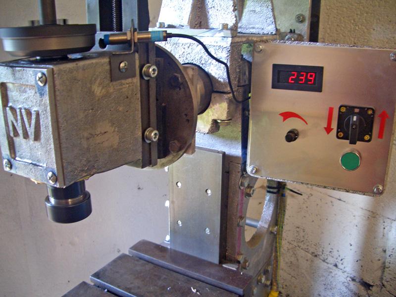

I followed Steve's advice and the tachometer is now working. I've also completed the switch panel, I added some graphics to remind me which way to turn the knobs. I'm quite pleased with it.
I've now got to save up to buy a compound table to finish it off.

But from a safety point of view I'm not keen on the protruding screw. Have you tried triggering off the hole that the screw occupies? It should work.

Andrew, it didn't trigger from the hole alone. I was concerned about the screw sticking out also, I will build a guard to cover the it.

What is the pulley made from -- I had thought you had cast it from aluminum, Norman. If ferrous, I can see why Andrew says it could be done with a hole. Or do these things merely need a conductor of any sort passing by?
It seems like there is a fairly large gap to the transducer -- did you try it closer with the hole?

Most proximity sensors will work on a 1/4" hole in a rotating wheel or whatever. But they do vary in sensitivity. most work in the 1 to 3 mm range.
I've worked on many machines where the detector is sensing the hole for a grub screw that retains the part on a shaft

Steve, I have just been out to the workshop to check it again. The transducer does not see the hole even when it is just 1mm from the pulley. The pulley is in fact cast iron, it is a taperlock pulley that I turned the groove off as I just wanted it for locking onto the spindle of the collet chuck to allow me to fit the screws for adjusting the preload in the main bearings.
Norman,
Try the sensor further away. The sensing area is usually a Gothic arch shape as wide as the sensor diameter at the face of the sensor to a point at some distance from the face. As you move the sensor further away (but still within the sensing range) you might be able to sense the hole.
The sensing distance varies greatly with material with iron being approx 3 times better than aluminium.

Joy oh joy! I tried again with the sensor reading the hole but with the sensor further away. This time I got readings throughout the speed range that agreed with the theoretical speeds of what the motor should achieve and the speed ratios of my pulleys. The readings I got are certainly accurate enough for my purposes.

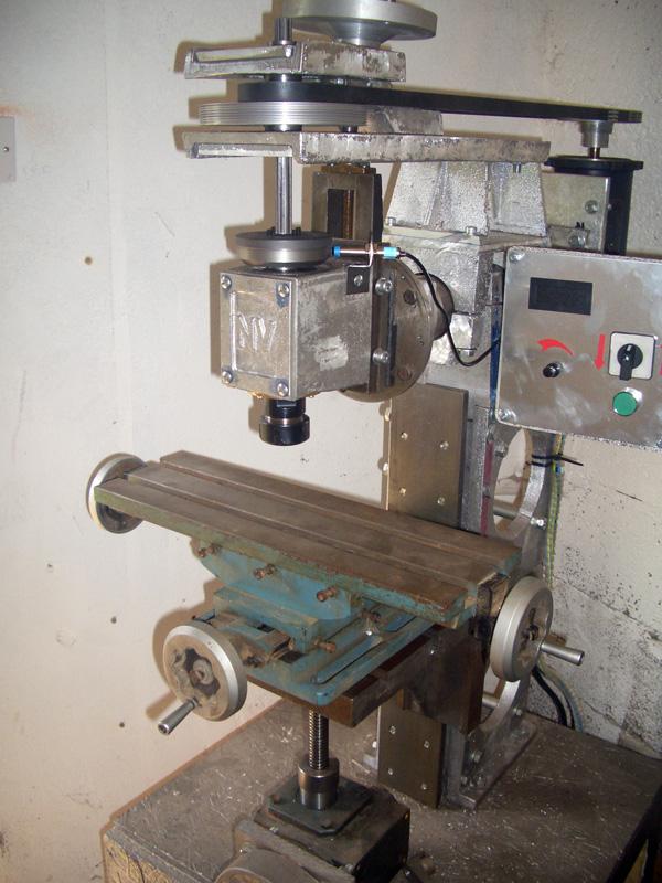

First I squared the head (trammed it). I followed John Doubleboost's instructions using a car brake disc. It worked but was more fiddly than I had anticipated. As I was tightening the bolts to hold it all in place I found that it altered the setting so I had to tighten the bolts alternately whilst keeping an eye on the dial gauge, but I got there in the end.

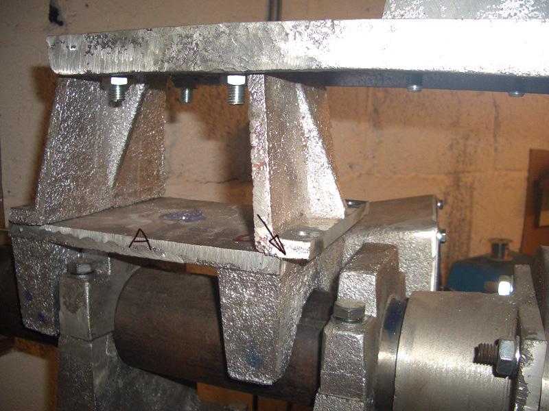

Then the big moment, I placed my newly acquired compound table onto the knee, it looked great. Then I saw the problem, a few posts back Steve commented on how far forward the spindle was in relation to the column. I had placed it there intentionally as the (new) compound table that I had intended purchasing needed it to be in that position. I have instead bought a second hand table at a third of the price of a new one but the front to back dimension is much smaller. As a consequence the spindle is too far forward. I have two options, I could fix a piece of thick sheet steel on the knee and just mount the table protruding forwards but centred under the spindle. Alternatively I could remove all of the castings above the spindle, slide back the mounting tube upon which the head and the motor are fitted and then modify the castings to suit.
It's going to be a lot of work but I think that the latter is the best way to go, at least my time costs nothing and I saved a lot on the table.
Here is a pic of it with the table in place, it really looks like a milling machine now!

Andrew, I take your point about the extra spindle/column distance being useful but I am concerned about the rigidity or lack of it. I know that I will want more space at some time but I expect most of what I plan to do will fit within the available space with the table closer to the column.
I have examined things a little more closely and it appears that I will not have to modify any parts, just rearrange them on the tube. The only drawback will be that the motor will protrude a long way out of the back, but if I position the machine in a corner it may not be obtrusive. As a last resort I can shorten the tube.

I have just stripped it down and reassembled it with the head pushed back. It almost fits. The casting marked A will have to be recast but with an overhang in the position shown by the arrow. In a way I am quite pleased as I am having withdrawal symptoms because I have not cast anything for a couple of weeks!

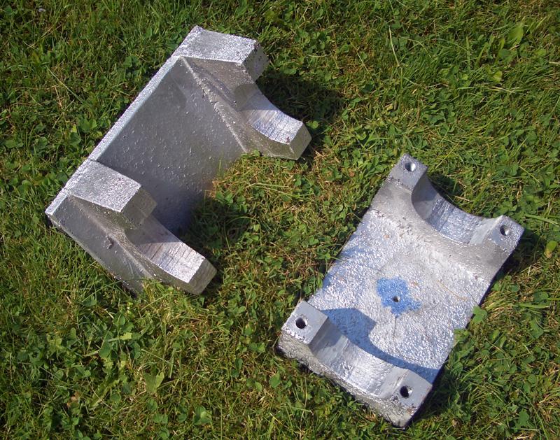

« Reply #174 on: July 27, 2014, 10:14:12 AM »
Thank you Pekka, I doubt that I will paint it. It will need a lot of stripping down to do that and I quite like the look of bare aluminium.

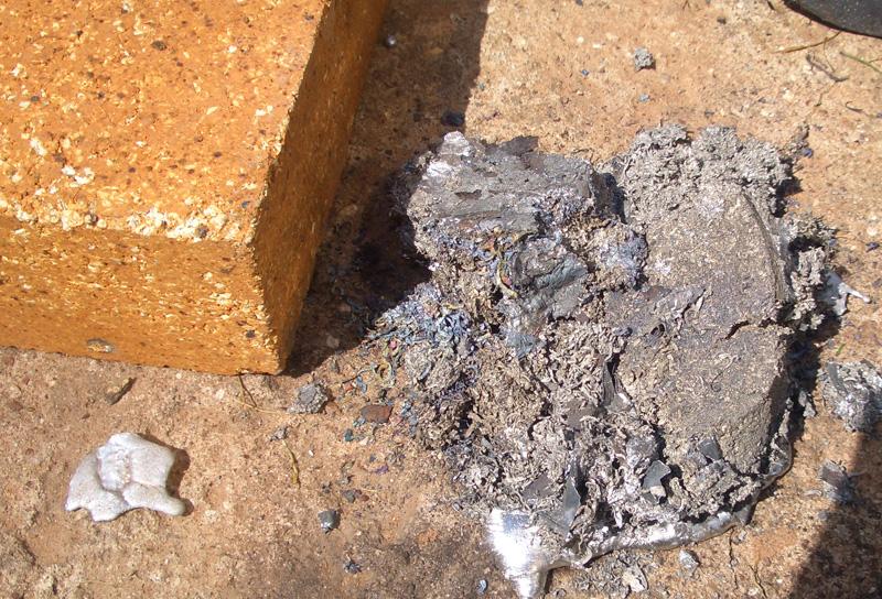

I made the new casting today. It came out better than most of my previous castings, I suppose that I must have learnt something about casting by now!
For the first time I used some aluminium swarf and bits of can in the melt and when I poured it I found loads of crud at the bottom of the crucible. The top of the melt was quite clean, it only needed minimal scraping off. It poured well but there was all this stuff at the bottom. I won't be remelting swarf in the future.
