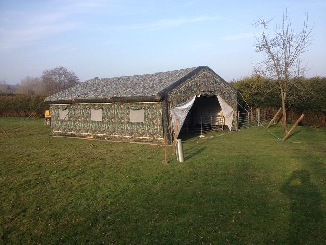

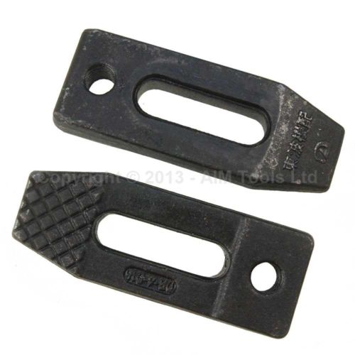

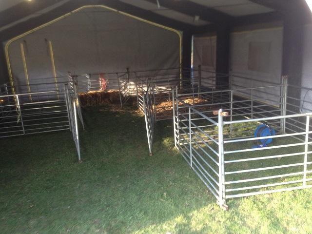

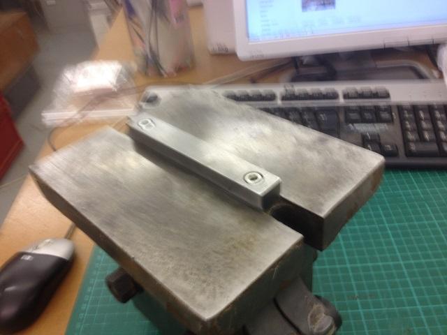

Well today went pear shaped from the start !
Cut a long story short, but because of some early arrivals that weren't expected until the end of the month, no time for clamp making so I bought these
  • Posts: 9051
Re: Servo Driven 4th Axis for CNC Mill
« Reply #127 on: March 12, 2014, 01:57:58 PM »
So what were the early arrivals? Two Ewe lambs and one Ram Lamb
  • Posts: 9051
« Reply #128 on: March 12, 2014, 02:02:06 PM »
So the 'Lambing Tent' that was scheduled to be put up during the coming weekend had to be put up today in a hurry. This is an ex Chinese Army inflatable Field Hospital that is stored in two pallet mounted boxes, and needs a road compressor to put it up.
We got it up  after a few setbacks and the sheep are at least now safe from the foxes.

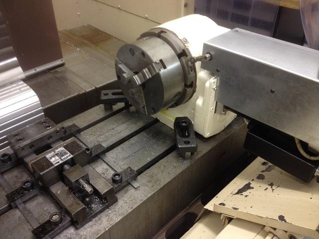

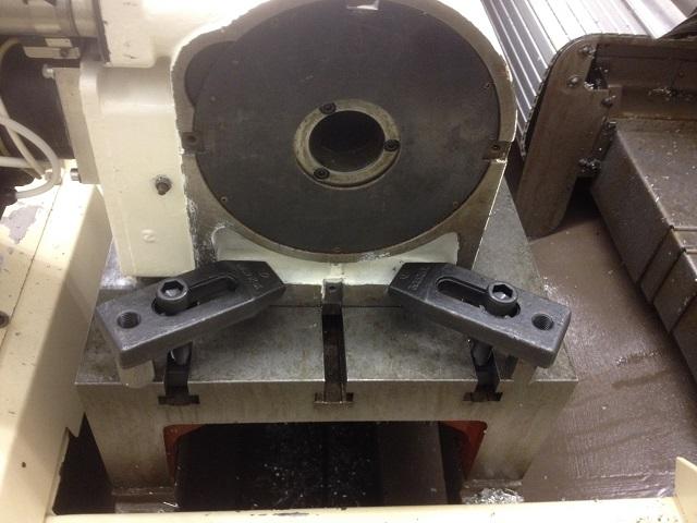

The clamps I ordered arrived today and I managed to find five minutes to fit them
  • Posts: 9051
« Reply #135 on: March 14, 2014, 09:47:14 AM »
They work and certainly hold the 4th axis securely, but in the long run I'll probably make up a custom clamp as these are a bit chunky as a semi-permanent fitting.
To celebrate I mounted a bit of 1" bar and mandraulically milled a square and a triangle, really just using the 4th axis as an indexer. Although the brake is fitted and worked well, I've not yet run compressed air to a convenient point, so this was done with no braking. No sign of chatter what so ever so for many things I probably don't need the brake - but I will run the air anyway.

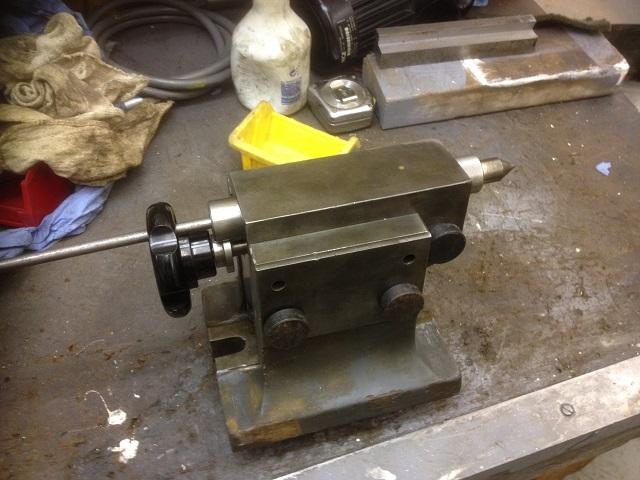

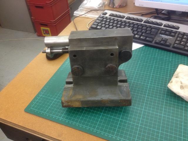

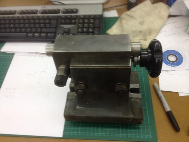

So the next task is to sort out a tailstock for use with the 4th axis.
I picked up this one, which is bored 2 MT and really intended for a dividing head, as it's a tilt and height adjustable one:
  • Posts: 9051

« Reply #140 on: March 16, 2014, 08:13:19 AM »

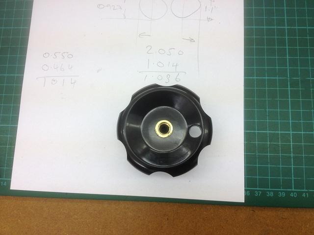

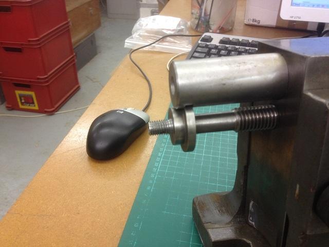

The 80 mm diameter plastic hand wheel was smashed, and it was a bit of a mystery how it was fixed, until I turned the remains off carefully on the lathe. This revealed that it was an 11 mm shaft with loctite and a taper pin. Ebay kindly provided me with an identically shaped handle (but black not grey!) however the mounting was an M10 thread. So the 11 mm shaft got turned down and threaded thus:
  • Posts: 9051
« Reply #141 on: March 16, 2014, 08:16:37 AM »

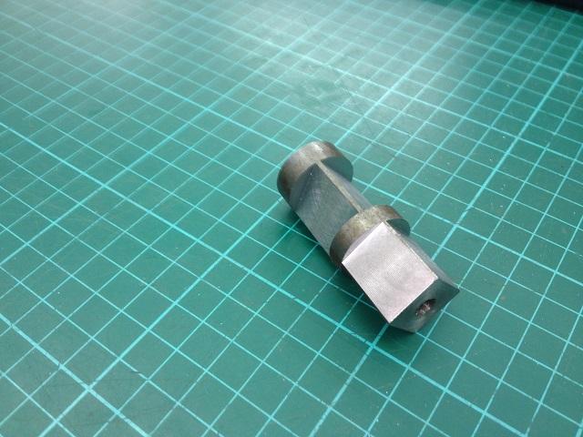

I will need to bore a hole aligned with the axis of the barrel to allow knock out of the morse taper using a tapping rod, as there is no other provision. I strongly suspect this is how & why the original handle was broken.

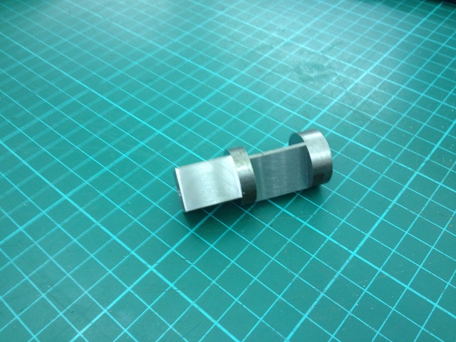

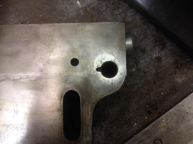

This mornings job was to make a stepped key for the base. The milling machine has 18 mm Tee slots and the base of the tailstock is grooved 16 mm, so a bit of milling this morning produced this:

« Reply #148 on: March 18, 2014, 11:37:14 AM »
The new knob for the tailstock arrived today, and promptly had an extra hole drilled in it to allow the use of a knockout bar to remove the No 2 Morse centre.
Whatever the plastic they made the handle from is filled with it's abrasive stuff - took the edge off an end mill in no time short !

« Reply #149 on: March 18, 2014, 11:42:52 AM »

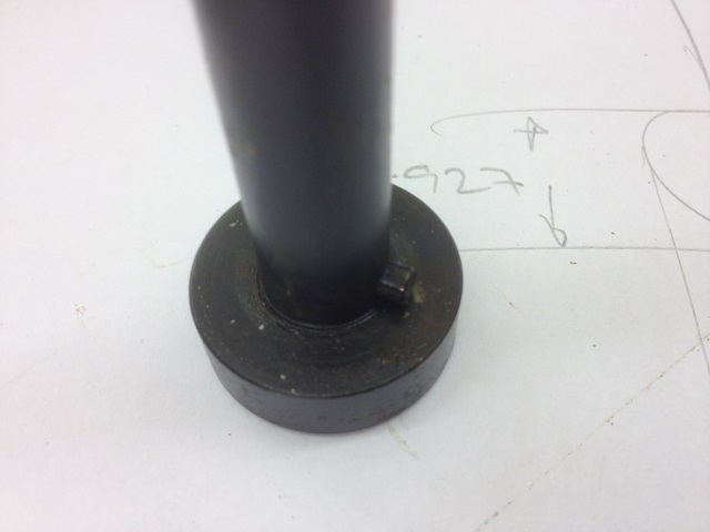

Now the eagle eyed amongst you will notice that the clamping bolts have their nuts on the 'wrong side' for placing the tailstock on the left hand end of a milling table as I must. The pair of bolts used to clamp it at a particular elevation and tilt, once set, should not need adjustment, however the clamp for the barrel will need to be 'got at' every time it is used. It would be easy just to remove the centre section and assemble it the 'other way round' but it would be nice to have ALL the locking bolts on the same side.
Then I suddenly realised that all that stops me putting the bolts in the other way round is a small groove milled to take an anti-rotation peg that is part of the bolt head
