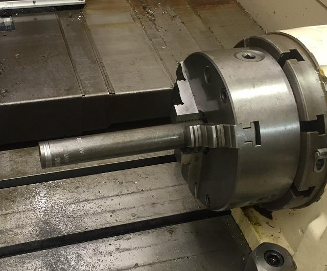

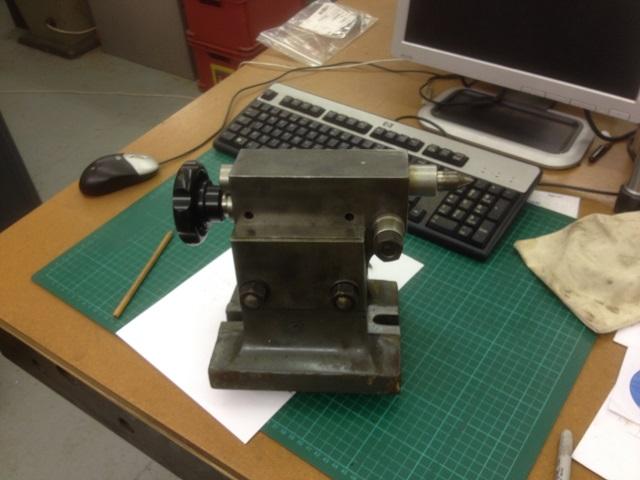

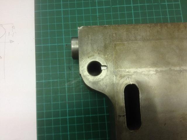

All I had to do was mill a matching 3/16" slot on the other side and I could assemble the bits the other way round !
Re: Servo Driven 4th Axis for CNC Mill
« Reply #151 on: March 18, 2014, 12:14:52 PM »
Hi Andrew, the plastic knob is is very likely to be made of a glass filled plastic as many structural plastic components are(PA 66 maybe?).
It is very abrasive and dulls most tooling very efficiently....OZ.

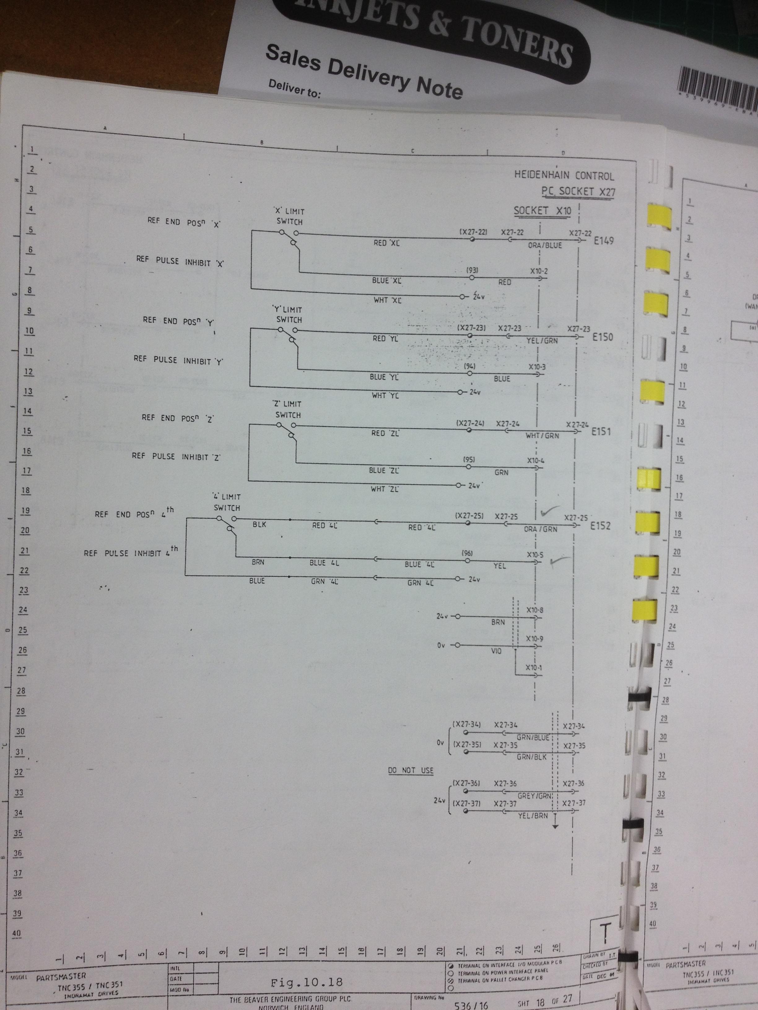

I've pm'd you some info I got when I was struggling.
Also picture below is of my home switch wiring - note it does ref pulse inhibit and home on one c/o switch

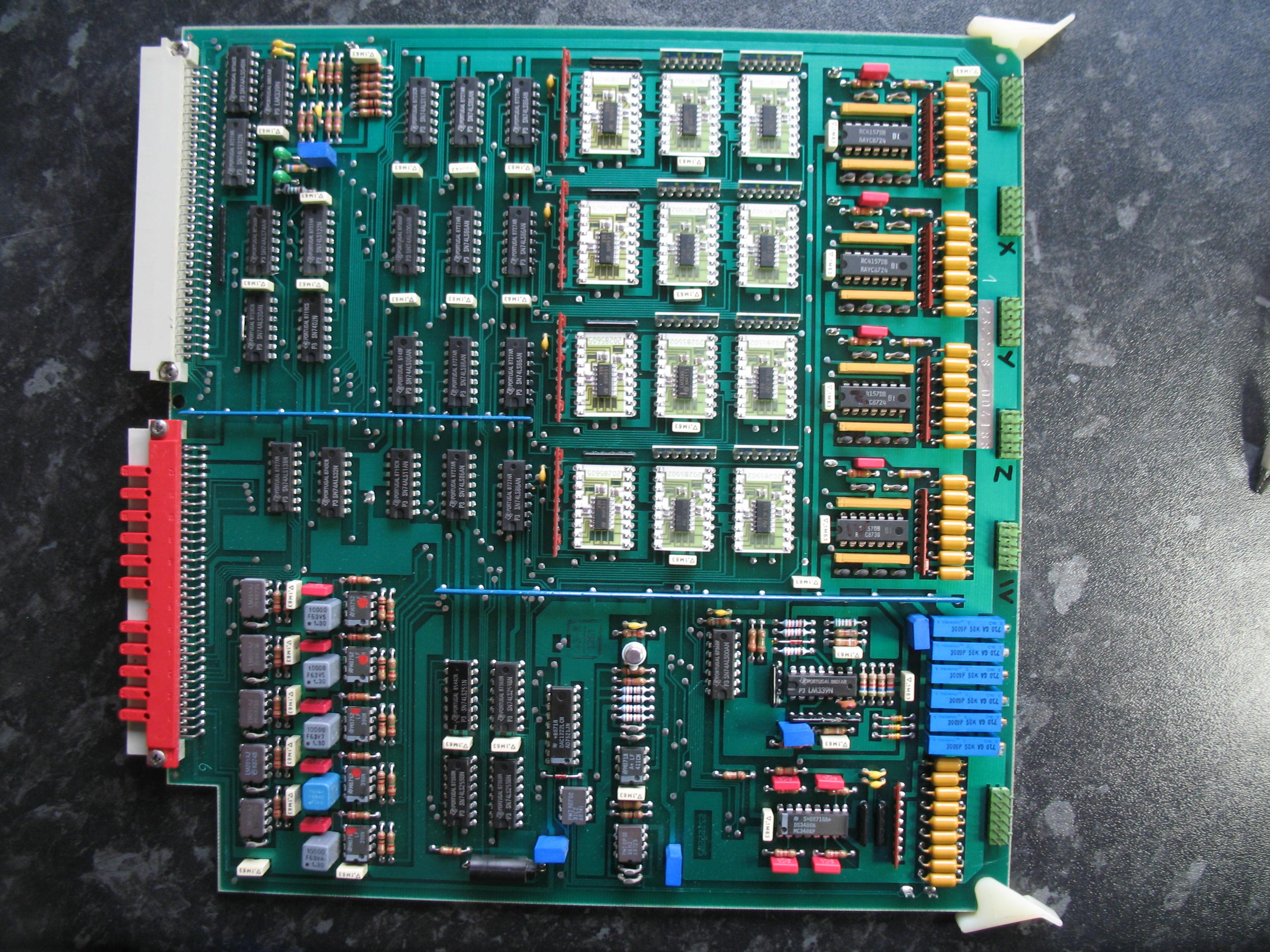

Hi Andrew, again, many thanks. My BP Interact 1.2 only uses the reference end positions for X,Y. Z and I think it uses e-stop if you go over the end of the ref point.
I've given up trying to get the Heidenhain repair places to return my emails. Instead I squandered my time wiring up the Analogue PCB to the appropriate Voltages, and stuck a SEM motor into each axis to see the voltages. I managed to trace it down to a little red module, which I think is a capacitor array or maybe a transorb input protector array?
Offline Hazel
  • Posts: 21
  • -gasp- who let that woman near a milling machine?

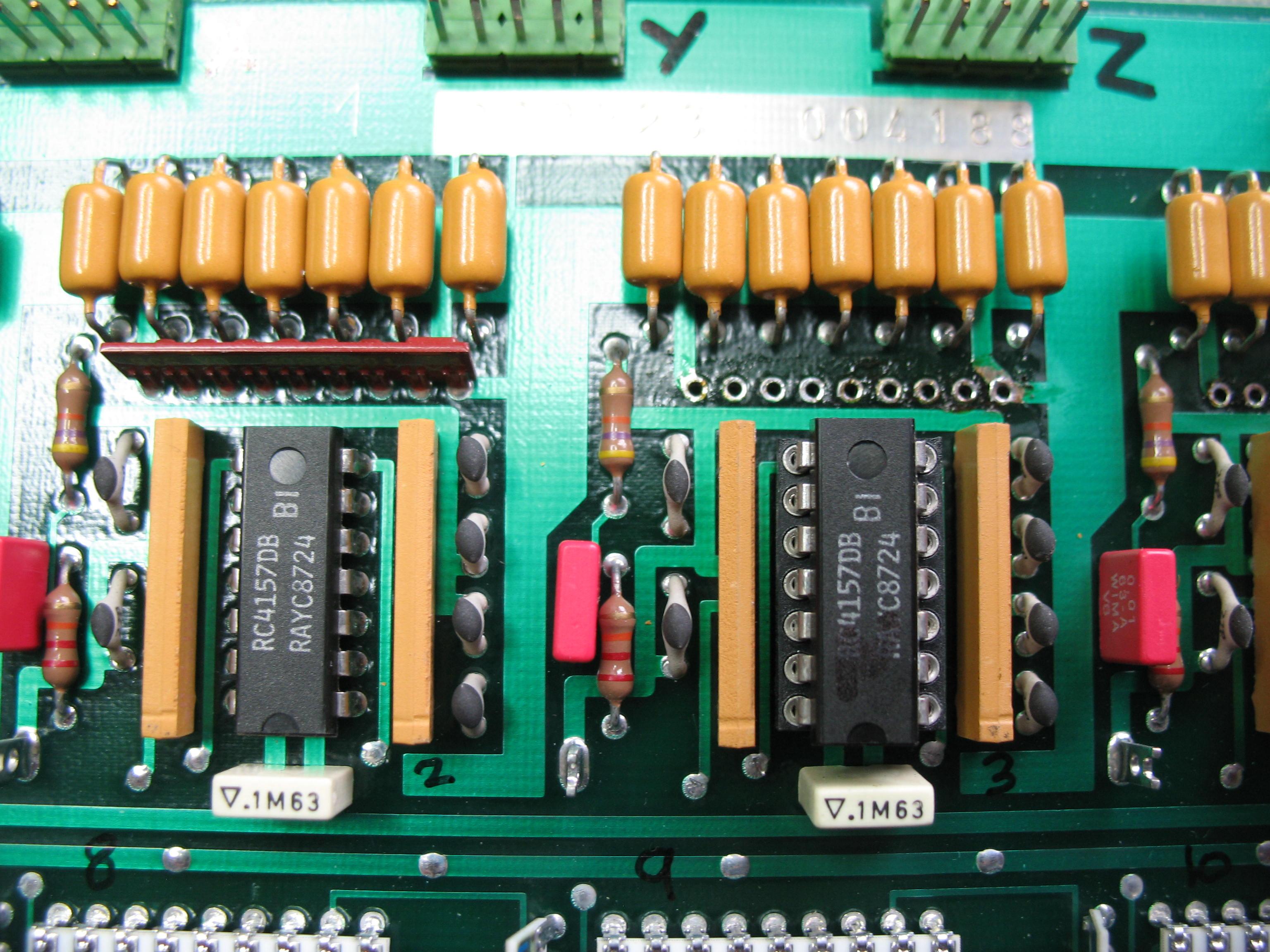

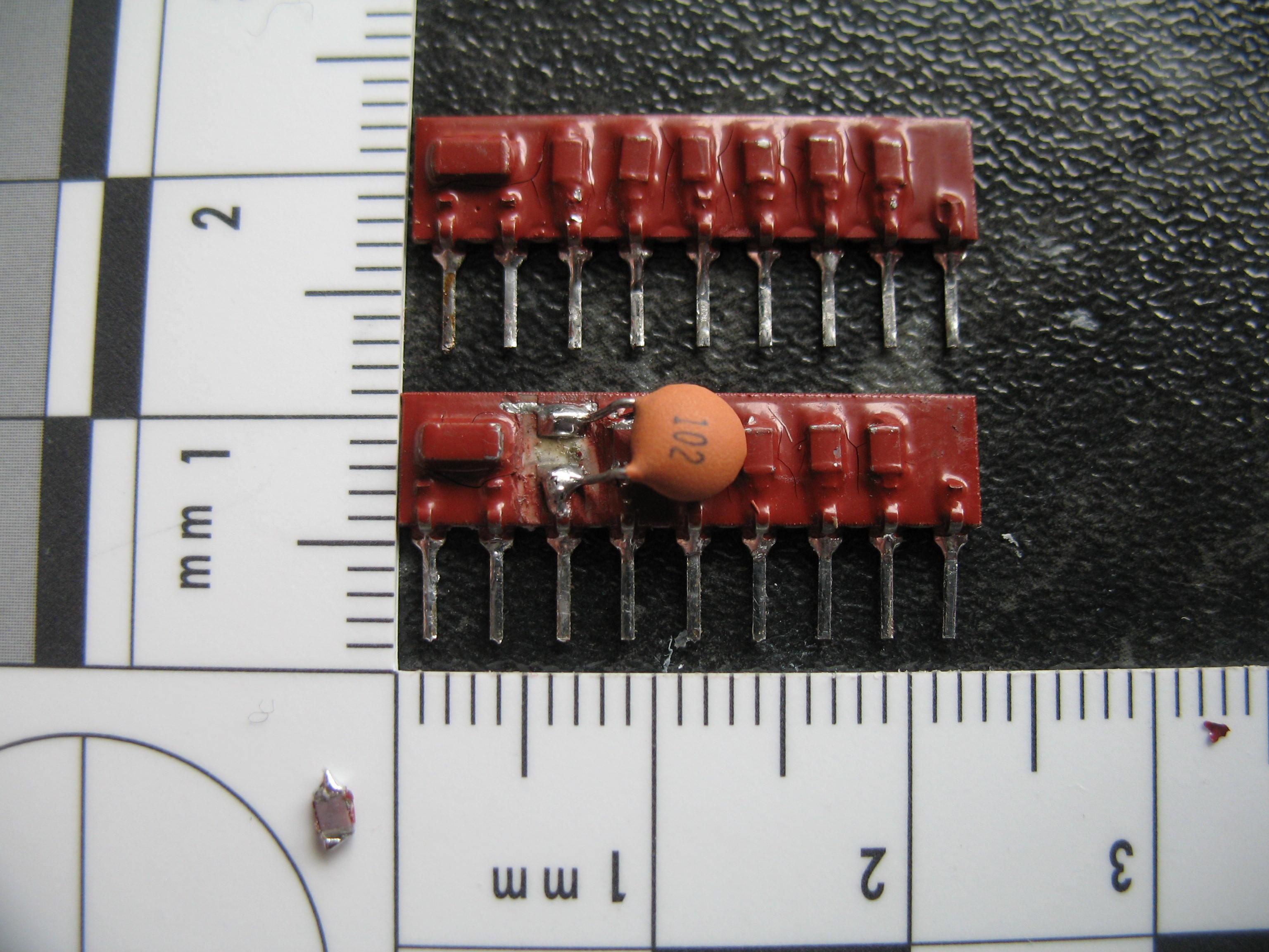

« Reply #165 on: September 26, 2014, 10:26:46 AM »

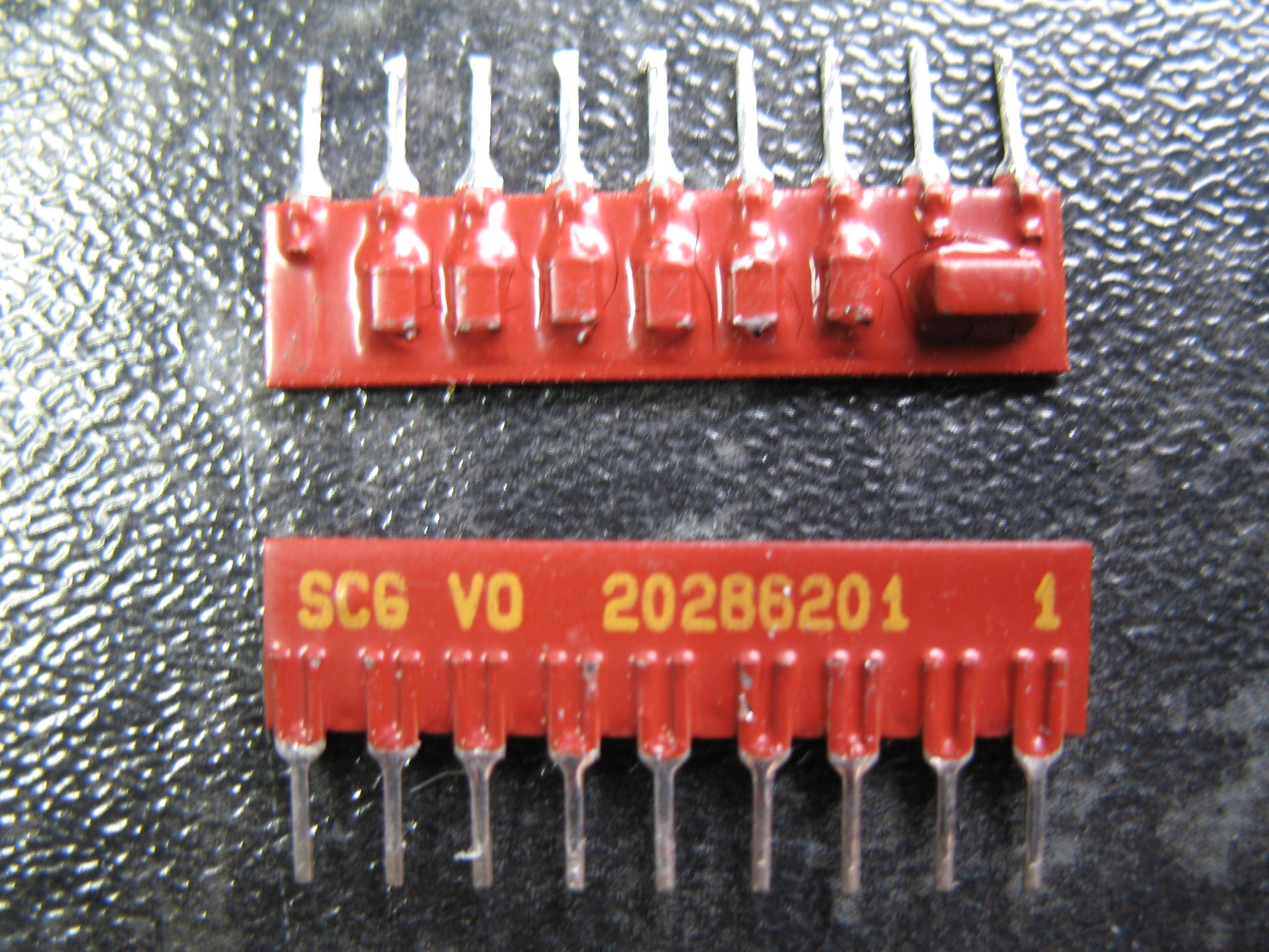

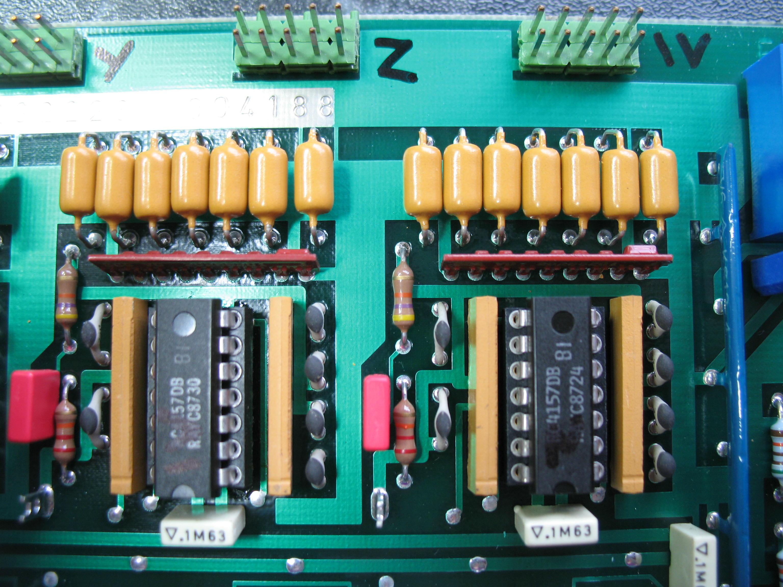

Okay, in for a penny so to speak, I decided to repair the module, seems to be SM capacitors. Reassembled and all the front end 4th encoder amps now work the same as the others!
So, now to reassemble the mill...

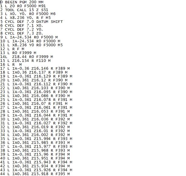

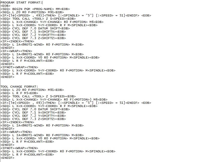

Well it's been a LONG time in the gestation, but at last, as it hasn't stopped raining for days, I've found a bit of time to sort out a suitable 'Post Processor' to allow me to engrave text on the outside of a cylinder mounted in the 4th Axis.  :ddb:
So what's the issue  :scratch:
Well, if you use a CAD/CAM set of programmes to generate the bits you want to make on a CNC mill or lathe, the program has to spit out code that meets the specification of the controller that drives the machine. So most CAD/CAM set ups use an intervening set of definitions and code that take in the symbolic actions, and translate them to actual code that the controller can understand. Once defined and installed, from then on the CAD/CAM should (hopefully) produce the right stuff for the controller.
Now there wasn't a 'standard' Featurecam Post Processor suitable for the TNC355 controller in my mill that understood the 4th axis. There were ones that drove 4th axes. And there were ones that were close to the TNC355 (as the TNC150/151/155 is very similar, so it was a case of making a Frankenstein version, with a few tweaks of my own.
It didn't help that some of the 'standard' Post Processors made mathematical errors when wrapping stuff round a cylinder  :bugeye: All sorts of Gotcha's appeared - like the one that made moves all the way round the bar backwards to get to somewhere close to where it started, cutting a nice groove as it did it  :( Anyway much  :coffee: :coffee: and rather a lot of  :med: got me there in the end.
So what are we talking about: well the first picture below is a screen shot of a very small fraction of the program like structure of the Post Processor, and the second picture is code suitable for my Heidenhain TNC355 to obey
  • Posts: 9051
« Reply #174 on: January 11, 2016, 10:34:45 AM »

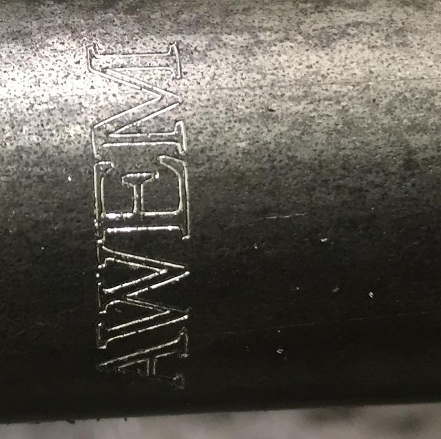

Now there is still quite a bit of tidying up to do to generate more compact code - but hey - it works :clap:
The 32 mm bar in the picture below has been engraved with my initials 'AWEM' using a diamond 'drag engraver' - quite hard to photograph curved surfaces but I'm sure that you get the general idea.
If you look at the over view picture, you'll see several failed attempts along the way  :bugeye:
